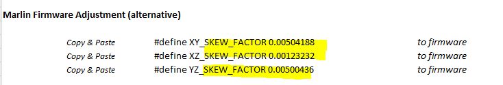

Hello everyone, I am starting to calibrate my old Mendelmax model printer that I built several years ago. My LR2 was printed with it so I have faith in it to print my LR4. I share the results after the third calibration done. I was happy with the score until I saw that the important thing is to achieve 0.07° in all 3 planes. It seems that in XY and ZY I am still far away. I was thinking of iterating again. The “next skew estimated” column caught my attention where it is noted that it would not be better than the current one. Any advice that comes to mind?
Skew 3
Maybe I’m iterating using incorrect values.
What values ​​are being loaded into “Existing Calibration” when iterating? The “mesure skew” values ​​or “skew factor” values ​​that appear in “Marlin firmware adjustment (alternative)”? Excuse my ignorance, I can’t figure it out.
Calibration with exist calibration
measure skew
I think those are there if you have values in fw right now.

Did you get this sorted out? I’m on iteration #3 and have a feeling it’s one of those sets of numbers or the ones from the config file (which may actually match one of those sets):
EDIT: After re-reading the documentation it’s the skew values that get re-entered at the top of the spreadsheet
