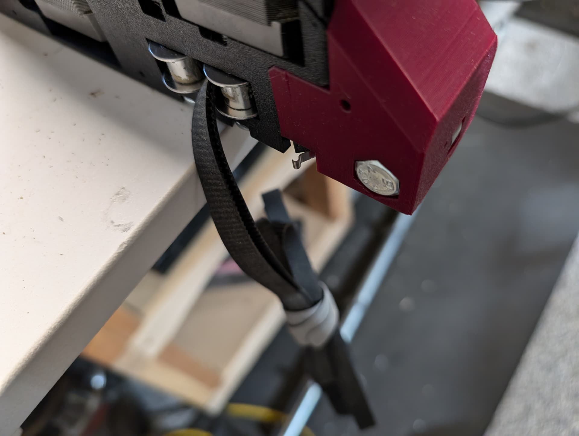

I cut my too-short struts in half to serve as temporary struts (cut hidden behind core.) I noticed I had the roller wheel axle bolts backwards on the min XY side; second pic shows corrected (the whole side should be flush other than limit switch and idlers.)

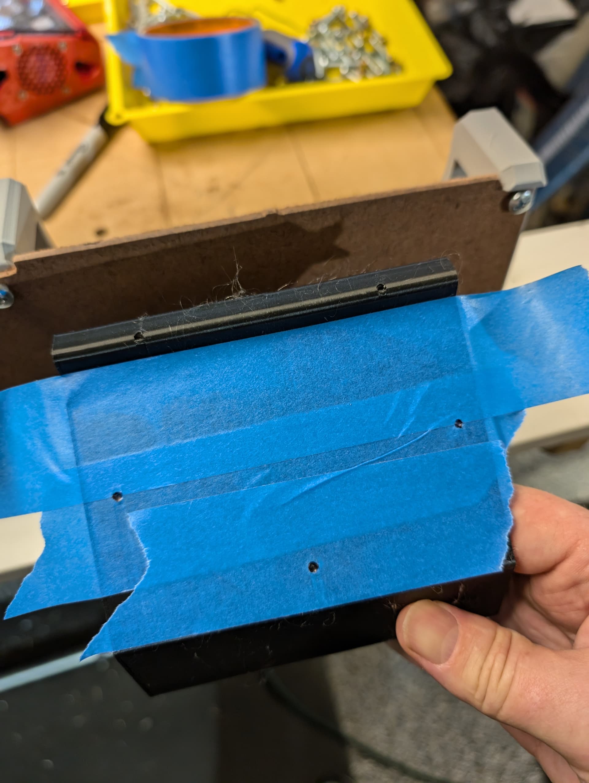

I used the ol’ blue tape trick to transfer the mounting holes for the jackpot case to the hardboard. Saved the tape for the future “correct” ones!

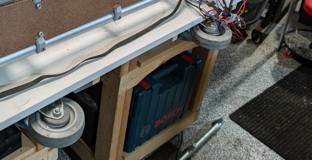

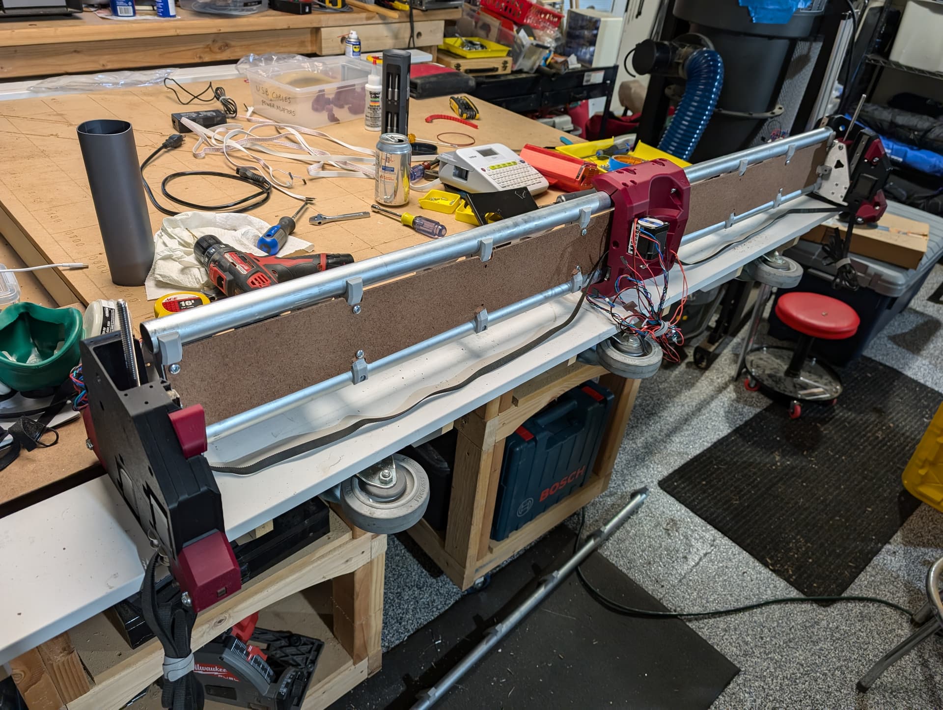

Umm, what are these wheels?
Training wheels!
One of my favorite things about the LR3 and LR4 is that they can be lifted off the table and stored.
These wheels are so I can store the table vertically (I take off the heavy MDF spoilboard first.) The rolling cabinet things it sits on can then roll under my giant workbench.

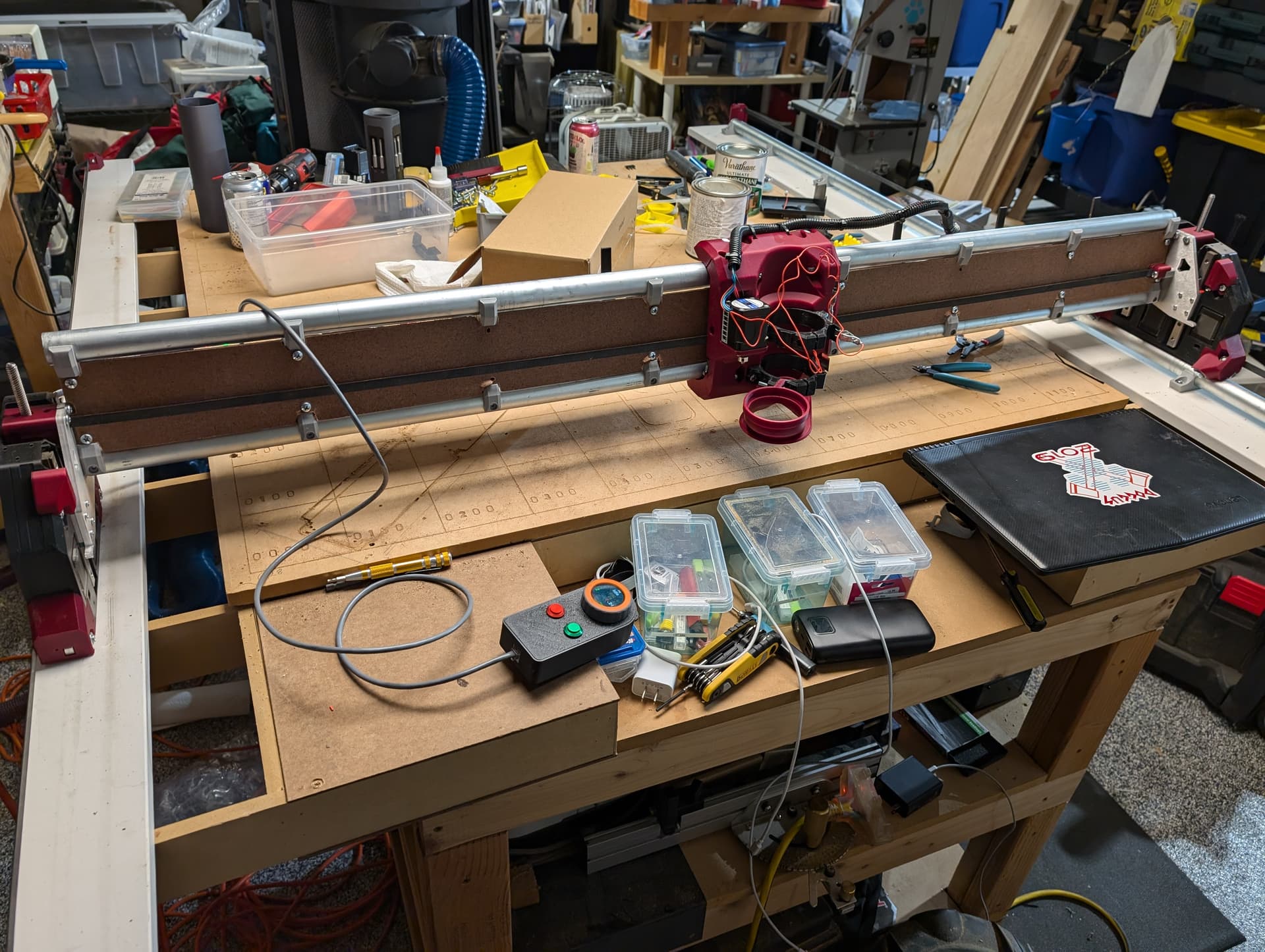

Not the most elegant thing ever, but it works! It’s Ryan’s table design with a cutout for vertical cuts–I’m planning on making a dovetail-slotted fixture to clamp pieces vertically with those Microjig Matchfit clamps for my LR4. In the meantime, the cutout makes a nice place to stand and pretend I’m captain of a ship.

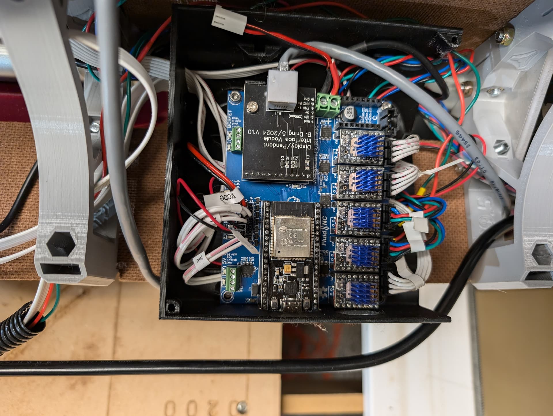

Initial wiring done, kind of a rats nest but it’ll be ok for now. Made the cooling fan disconnectable.
Not pretty, but will get things cutting and revisit.

Every axis is homing gloriously. I had a bad Z limit switch, which was easy to track down thanks to the little LEDs on the jackpot. Interestingly, it was causing other axes to fail to home too, weird side effect.
