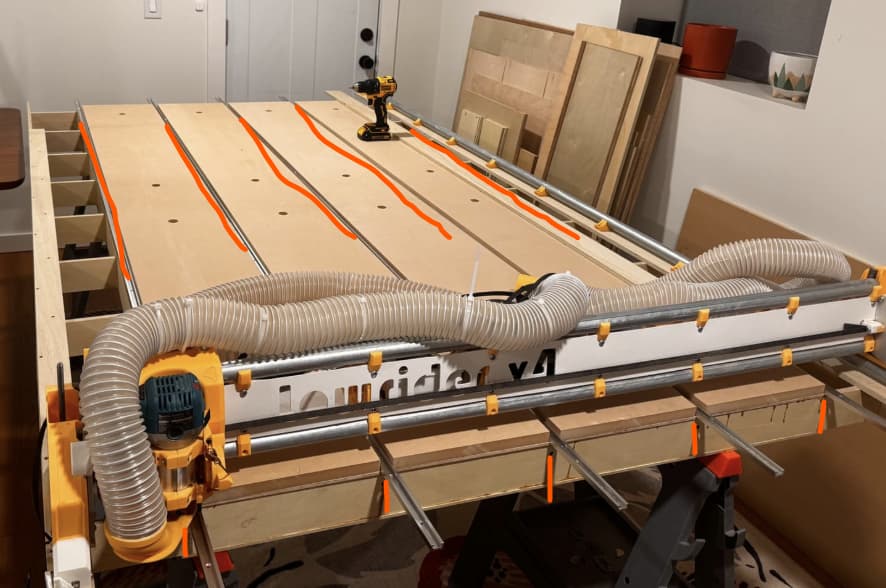

Did you line up the Y axis supports with the T track?
And did you add extra X,Y axis dimensions so you have the ability to clamp a 4x8’ plywood on the edges? I would think it needs an extra 6” to 8” on each side right?
Sorry for all the questions but my head is buzzing. I really need a table but I only want to make one lol.
Yes. You also have a bit of wiggle room to attach the top rails a bit narrower or wider to match your machine.
Not intentionally, it just worked out that way.
That’s why the t-track sticks out the front and back. It’s about 9’ long so I have room to fit clamps on the front X and back X.

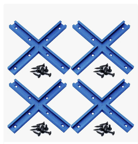

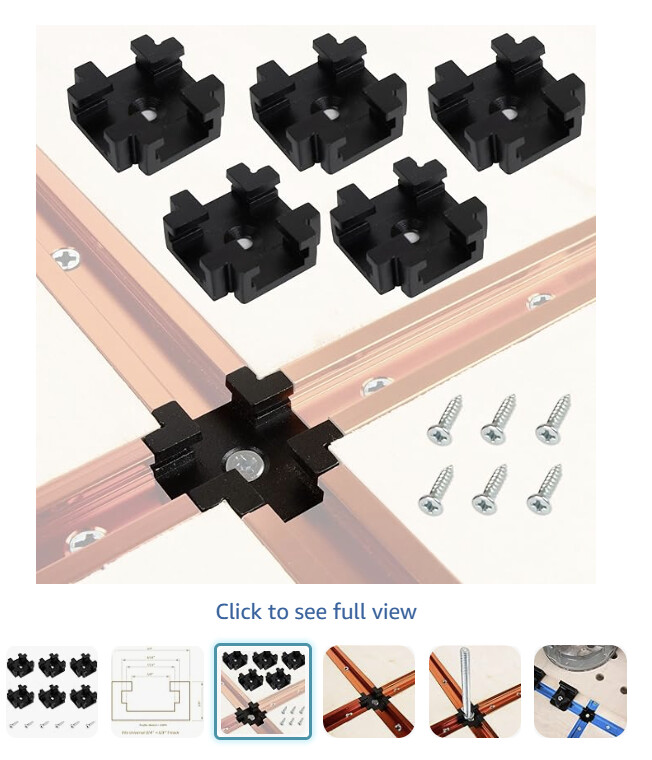

I can see that they stick out on the front and back but how will you clamp along the other two sides?
Honestly I feel spoiled coming into this at the time I am. I am feel like I am standing on your all’s shoulders. Many many thanks!
I am planning to 3D print some kind of arm that can go underneath and prevent movement along the X axis. Normally when I have a big sheet clamped down at front/back it doesn’t move enough anyway for me to be too worried about it.
My 1/4 mdf I was cutting for the strut plates was bowing up in the middle and needed screwed down along the long edge which is why I am asking about it. I was thinking maybe adding these to the table to give clamping along that edge?
Or these

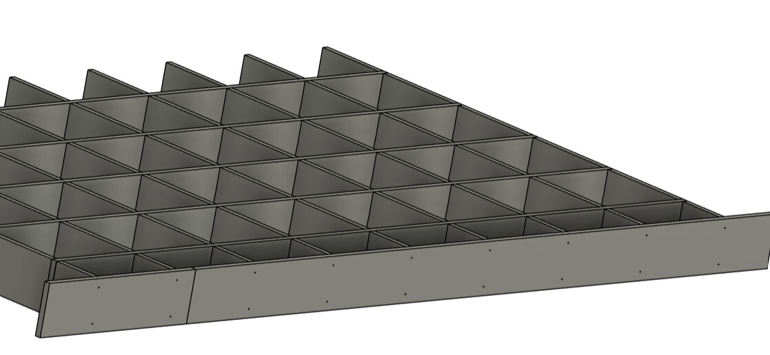

@Colin_S I’ve updated the site to add 5% of the total table thickness as a buffer. So you should have plenty of room to tap the spars flat (in fact they will go a bit past each other, but that shouldn’t be an issue with the skins attached.)

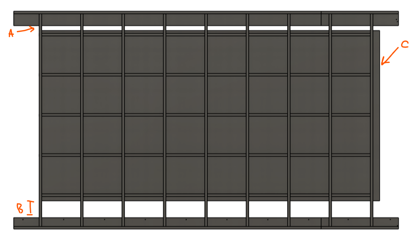

Thanks Zach! I am currently trying to understand what all the parameters do and trying to 3d CAD it in fusion using the SVG file. I am OCD about things. I had some questions about it:
  • Are there any drawings from Ryan that show critical distances when designing a table? I am trying to determine distances A and B in the picture.
  • Should there be an overhand on the Y direction for the top plywood board? See “C” in picture below.

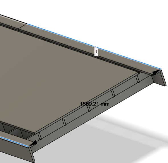

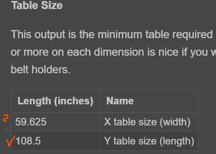

I just measured the table dimensions from your SVG and looks like its off a bit?
The Y Axis distance is perfect at 108.5”
  • Note I did add 2” to the Flat Rail Outside Buffer
The X Axis is 1559.21mm/25.4 = 61.39” - 2” (Buffer) = 59.38”
According to the websites calculator the table should be 59.625”
Its off by 0.24”
No, there aren’t. The best I can do is measure the drawing from Ryan’s table design which I found here . You can see me going through the process in this very topic.
The overhang should be equal on all sides. It’s configurable in the UI.
Your drawing looks right (I see the same error). However, I have built two tables from this and neither were too small (if anything, they were a bit too big?). I will go over my new table tonight and try to confirm all the measurements to see what’s up.
Having the table be slightly too narrow is actually the better case if they are off in either direction, because attaching the rails slightly wide will still give them the full support of the side rails + most of spars.
Ok I see the overhang dimension of 1”. I fixed it in Fusion and now I get these dimensions for A and B.
A = 28.91mm/1.14”
B = 126.25mm/4.97”
I have a floor table built. I might go measure that one.
I think you might have the flat/tube rails on the wrong sides in your drawing. The X is not symmetrical.

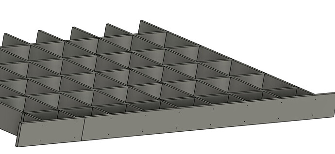

I just noticed that working in Fusion I could not select 4 of the screw holes. Zooming in I see that they are not closed like a full circle.
Yes, that’s expected (they are actually two half circles.) It’s a bit of a hack to make the generator easier for me to implement. All the software I’ve played with (admittedly, just vectric + estlcam) handles this fine.
Its easy enough to fix in Fusion, just put new circles over yours. Just wanted to give the feedback to help out.
