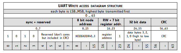

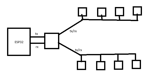

I keep thinking, the datagram format of the TMC2209 is simple enough, one could make a UART “router” that accepts input addresses beyond 0-3 and routes to multiple UART outputs. Like this:
Then addresses 0-3 go to the upper set of devices and addresses 4-7 go to the lower set of devices and the router would overwrite the address portion of the datagram to be 0-3.
Then the client (ESP32) can just treat it as if the addresses go beyond 0-3 and the software is oblivious to the workaround. The bad part is you would have to incorporate and somehow flash the router chip.
This would be a fun little mini-project but unfortunately I think it’s not really practical.
I know, this isn’t germane to the voltage regulator… but, when the number of drivers in the chain go above 3, the serial interface becomes unreliable. Proven in the earlier threads when developing the jackpot.
In effect, the scheme on the jackpot already does this for drivers 3-6.
You could abstract this back to every single driver in the chain is behind the same mux arrangement as used on Jackpot, then one ESP-32 UART could support an arbitrary number of TMC2209s via thier UART interfaces, up to the point where the mux is too slow for responsiveness. (The UART isn’t generally used in FluidNC except when setting up or when responding to errors).
Yes, and having the mux handled in FluidNC makes an alternative pretty much pointless. Even if a hardware mod could make the code “cleaner” for the client, we could never remove the mux code.
It might be a different story for Marlin on Jackpot. I have not checked if Marlin enforces the limited addresses on TMC2209 or if it just passes it along. In the latter case, Marlin would work without extra unofficial hacks.

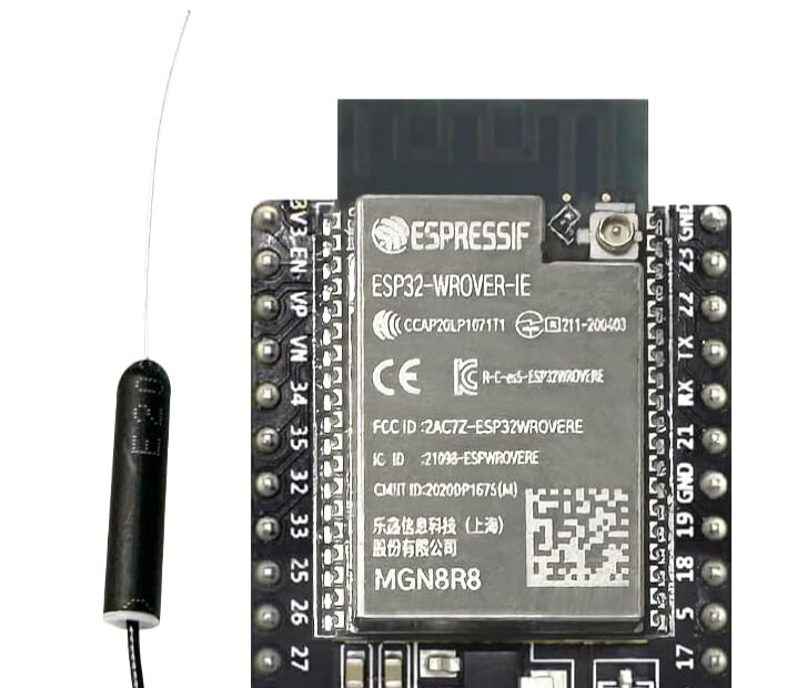

Sorry, I thought you’d have to choose between integrating an ESP32 module that either includes an internal antenna but not the antenna connector or includes an antenna header but no internal antenna. I now see that the ESP32-WROVER-IE module picture has both. I had looked multiple times on my phone, but couldn’t see antenna traces until I looked on my desktop now. :man_facepalming:
Note that FluidNC does not work with the WROVER versions.

This is what is noted in the FluidNC wiki:
Be sure to use the WROOM version and not the WROVER version. The WROVER uses PSRAM and that uses up some GPIO.
Just took a look, for the most part it does work we just lose pins 16-17, for us pin 17 is the most important (I2s), pin 16 is one of the high power outputs. When I flashed and tested it I was at a loss for a while until I saw the difference.
