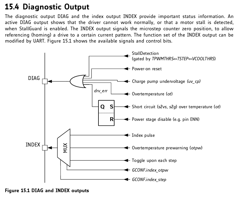

Is it worth it, or necessary, to have the diag pins from each driver go through a switch/jumper block so that you can enable/disable which diag pins participate in the diode-OR?
It seems that you can enable the StallGuard run mode on a per-driver basis (Catching missed steps and stopping - #36 by jeyeager) so no issues there, but are there any other triggers of the diag pin in other run modes that might get used for a 6th driver that should not trigger through the diag-OR?
I’m guessing no (not needed) is probably a safe choice, but I thought at least it should be a conscious choice. I suppose someone could always cut the pin off the driver.

There are other things that can trigger the diag pin. From the TMC2209 datasheet:
