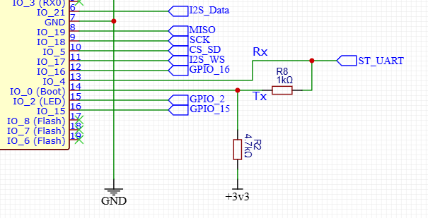

While working on a 2-3 stepper setup (for my silly weeder), for the TX/RX UART to TMC2209, I noticed Maslow 4 uses 1.5k resistor instead of 1k one that Jackpot uses. TMC2209 datasheet (section 4.3 “UART Signals”) recommends 1k. I don’t know why Bar chose 1.5k, but I recently asked…
Help... Maslow disconnected. Broken PCB? - #50 by AzaB2C - Troubleshooting - Maslow CNC Forums am mentioning in-case response(s) there affect what you do for Jackpot update.
Also looks like 3A in our range is significantly more common, anything above that is rare.
Well we also needed the 4.7 to get it to boot right. This UART pin is normally not supposed to be on IO-0…so we had to fudge it a little bit. We did this because we needed one extra pin. This would definitely need to be fixed in a new revision (in my notesd for a later time).
The maslow uses the S3 so maybe it has a different requirement?
Something to note about the TMC2209s and at least why the Jackpot only puts three of them together in a string: The TMCs get device IDs, but as you string them together they end up pulling the signal around. You can play games with the signal, but at least with Jackpot this is why there are three with unique IDs in the first three positions. Then the next three there’s that funky gated scheme and they all share the same ID.

We can have 4 drivers per 2 pins without using the multiplexer right (0, 1, 2, 3)? Pretty sure the multiplexer cost us a single pin so we just need one more to ditch that apect of the design.
No, you would need another UART if you go above 4 drivers. That’s also why the mux exists; Jackpot needs 6 drivers. (Can have 4 TMC2209s per UART without special tricks.). After that, you need a mux or multiple UARTs per bank of 4 TMC2209s. ESP-32 only has 3 UARTS. This is another reason the STM-32 IO expander exists- dealing with UART contention.
The IO expander isn’t intended to deal with TMC UARTs, though- that is more about pendants or other external interfaces.

That is what I meant, it only costs us one more pin to use both UARTs, instead of mux. Then we can ditch the special chip and special firmware. I am willing to give up an output, I don’t think we need 4

There are only 3 UARTs on an ESP-32 and 2 are already in use.
For expansion support: Spindle needs one, pendant needs one- if those are to be supported.
You’re already out.
This.
Well crud, the S3 only has 3 as well, so there is no easy solution other than to keep it the way it is.
