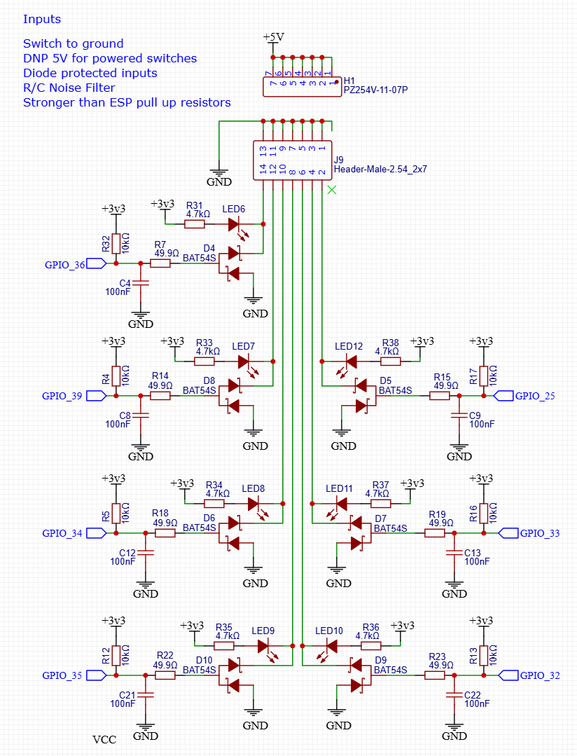

Taking a closer look at the Jackpot and the EE involved with the Inputs
Following down the path of me learning more about my own boards.
Help me take a look at the inputs we use.
-7 inputs seems great to me. We typically use 6, nice to have a spare?? or should we go down to 6 as I have never used the spare. I can’t think of a time we have ever helped someone use the spare. Estop, door safety switch?
Looks like 7 is good, we will need a spare pin from elsewhere.
-Diodes vs Opto’s? Other? Having something to protect the esp is a must, but there an easier way? BAT54S | BORN | Price | In Stock | LCSC Electronics
No complaints or other suggestions the diodes stay.
-The LED’s? I know we all love LED’s but honestly the $limits command is amazing, easy and tells you more info.
Reasults- Keeping the extra input is a good idea, popping out at least one pin (if not all) pre-diode is legit so the pins can be used for other things (at least the non-input only pins).
In this we also got the idea to possibly share the module port pins with something else.
The indicator LED’s are a question mark, $Limits is a fantastic idea for beginners to get over the fear of the terminal.
Yes we do. Consider moving, but don’t even think about removing the LEDs!
$limits is pants compared to Jamie’s fiber-optic/petg-filament light guide mod.
Fun, but It could be a plugin board, or some through holes waiting to be populated with an extension.
I think them being on or off makes them not as usefull as I expected, meaning the probe is off and the end stops are on. A little wonky.
The Current jackpot will not be getting erased from existence, in a new more cost-effective board are these really necessary? (if we had integrated esp or drivers, we will need some space).

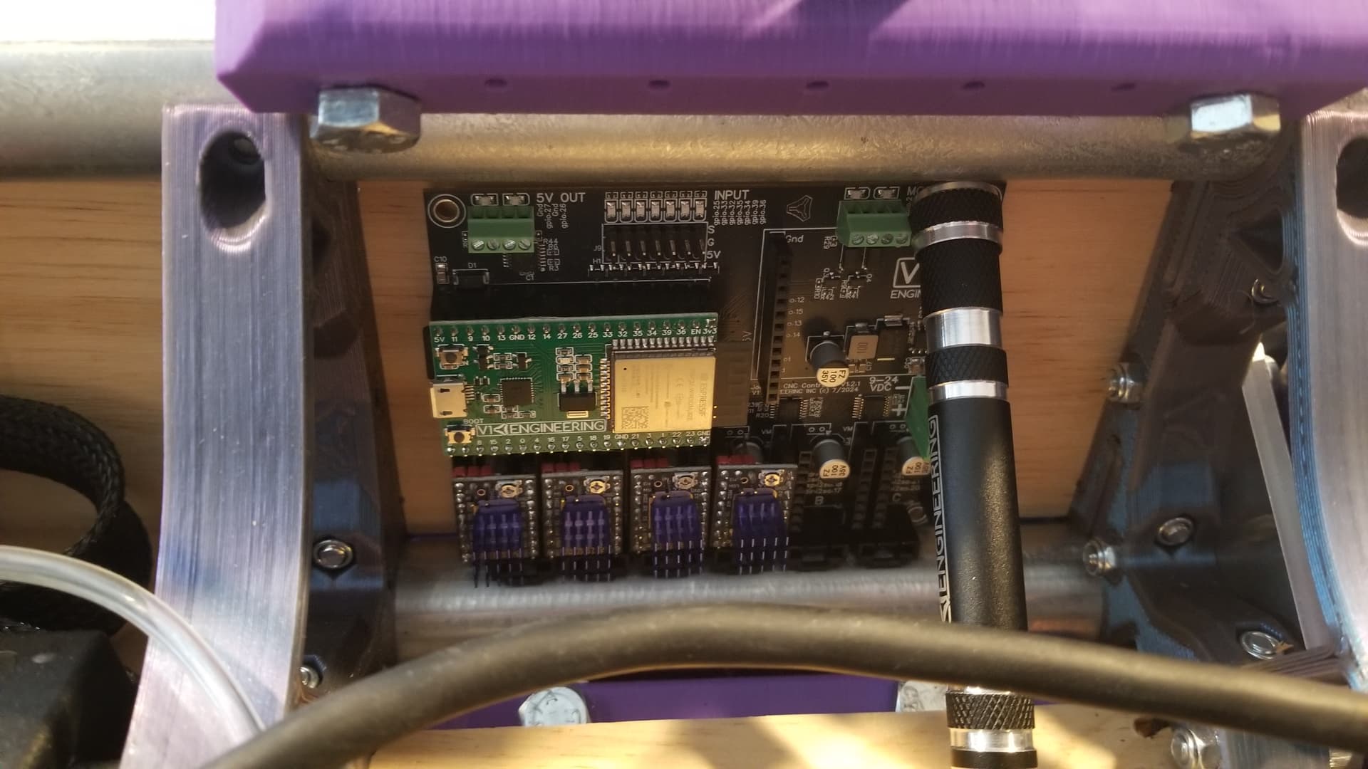

My board lives in a covered box, I do not see the lights.
On that note the 5V led is 100% gone, waste of time and space. The esp’s all have a power indicator LED (if we integrate yes I will add some sort of 3.3 or 5v or power indicator).

I recall a few times where folks have used the spare because they blew an IO- recently someone with no grounding of the dust collection springs to mind.
These inputs are reasonably well thought out and protected for enstop use, but the thing that bums me out about them is there isn’t a good way to NOT have these be pulled up GPIOs.
I wonder if there could be footprint to optionally cut a trace and install a pin so that I get back up to 7 GPIOs to use for other things. This doesn’t have to be expensive, just give me a spot to cut a trace feature and manually solder a pin.
Note also there’s the whole discussion about FluidNC IO expansion which is now possible via the UART side of things with the awesome STM-32 IO expander (AKA the Airedale board.)
Consider some footprint to make it easier to do the fiber optic indicators that Jamie an Aza have done. (Maybe a registration hole or something?)

This and the regular module fill the gaps of anything we might WANT, that is not included. The module socket is taking up 4 precious gpio.
This is why I am trying to boil down this to the basics. hopefully we regain a pin or two, save some money.

Built in esp’s and drivers saves me time in assembling the boards, sourcing, inventory, tariffs, and a little bit of cost in manufacture since it is one board not three.
