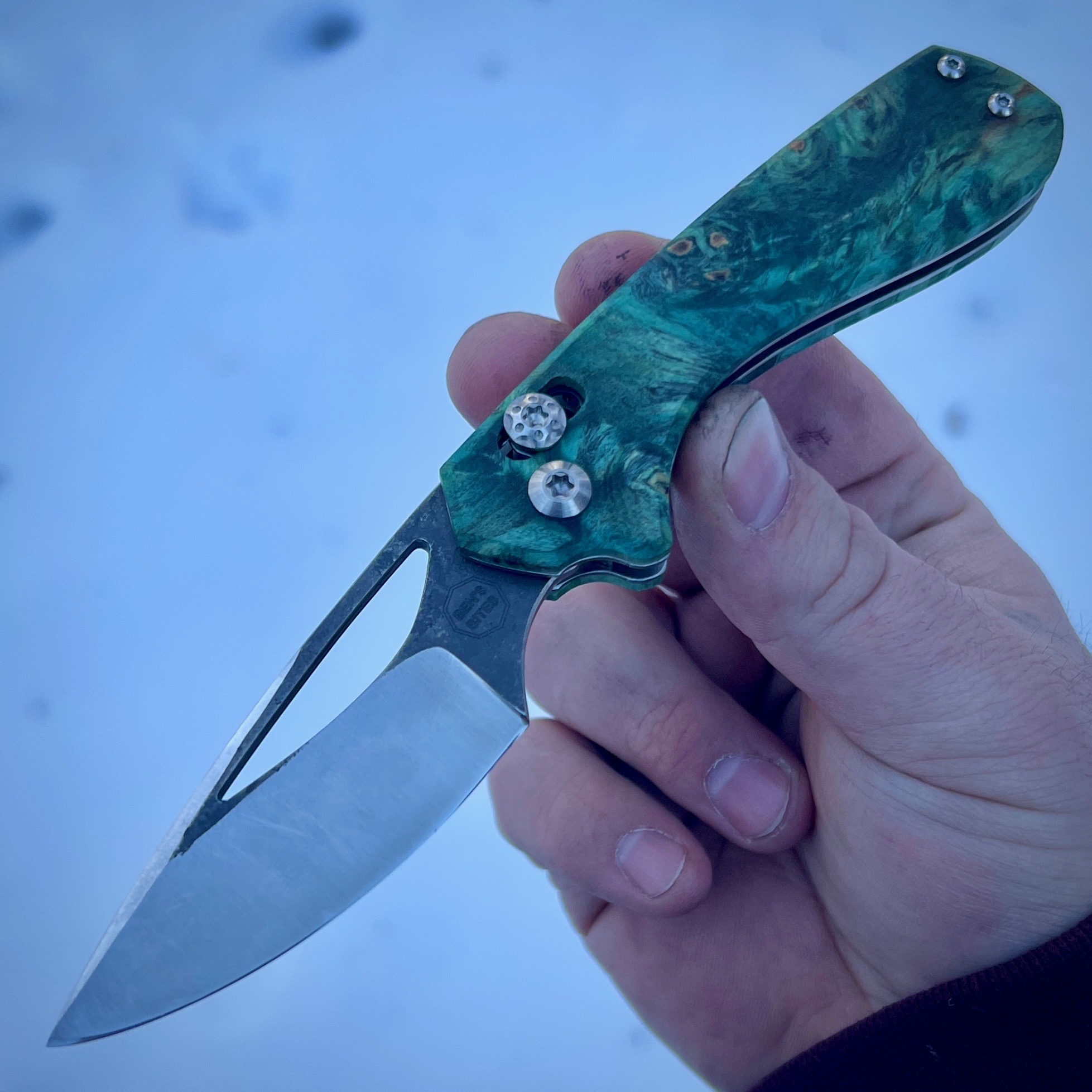

I have been around here off and on for several years. The mpcnc was a fun build for me to learn a ton. I haven’t done any upgrades to the burly I built and it is great for what it is.
I have started making folding knives and the MPCNC has been a great gateway to cnc and producing the scales. The steel and titanium are laser cut by vendors beyond my capabilities.
One of my problems, I need to tackle my skew issue. I think this is something that can be solved once I dig into testing and shimming the end stops.

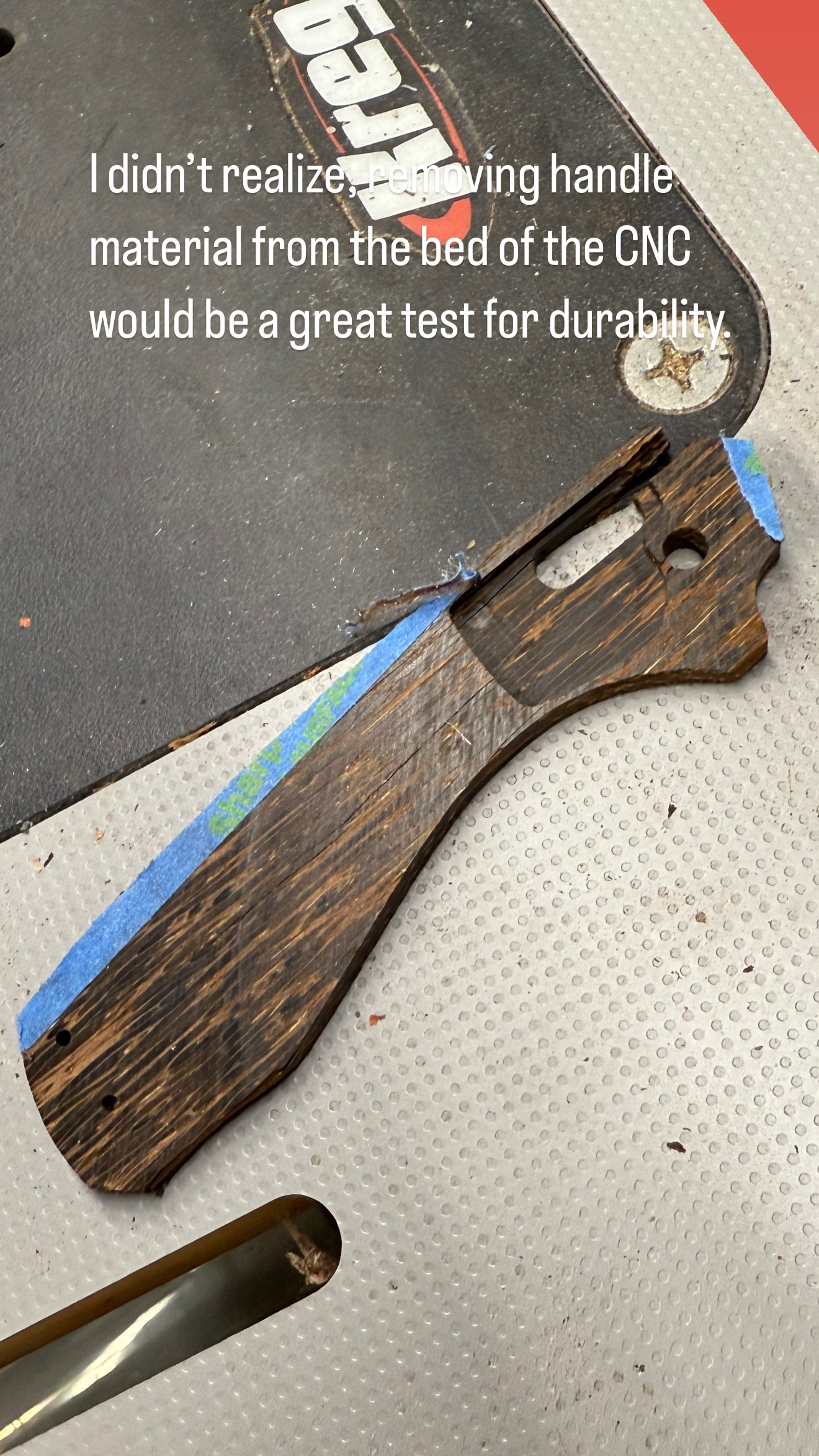

I would like to be able to make these wooden and micarta scales with enough accuracy and precision to mill one side, flip them over and mill the other side.
Right now I mill the inside on the MPCNC and use a bench top router on the outer bevel. There are many options if I can get make both sides on the MPCNC

Pics to show the what I have been able to do.
Skew as in X/Y not being square, so if you try to cut a square does it come out as a parallelogram? Are you running the dual-endstop firmware? That’s the solution for skew on the MPCNC. Either way, that might be worth a separate post to chase down if it’s something that you’re having an issue with.

Those are some great looking pieces there.
