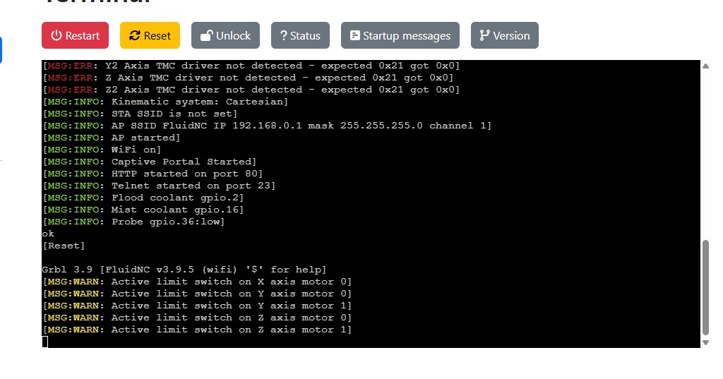

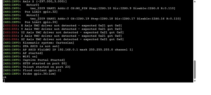

3.9.1 has the endstops working as they should. 3.9.7 starts them floating. That is not good. If you had your machine homed (endstops triggered) when you booted it would not know until you moved it.
3.9.5 works as it should, 3.9.6 and 3.9.7 are “floating”. I tested all this with the Jackpot v1, V2UI…
Are we seeing any impacts from this with weird behaviors “in the wild” with our user community?
I am not sure. Nothing off the top of my head. I think it would cause an issue if your endstop was triggered during power up, that is a rare situation.
this shows in .9.5
That is missing in .96 and later.
I don’t think that is how it should be. Looking for the right PR.
So there is a completely different boot scenario here.
3.9.5 and earlier does not boot all the way if the endstops are triggered. boots to the endstop error shown in yellow. This does load the UI, if you try to home you get a pulloff error.
3.9.6-7 boots just fine without the endstops but when you try to home…it tries to home, when in this case it would already be home and grinds. This also loads the UI, if you try to home on a triggered switch it lets you crash the machine.

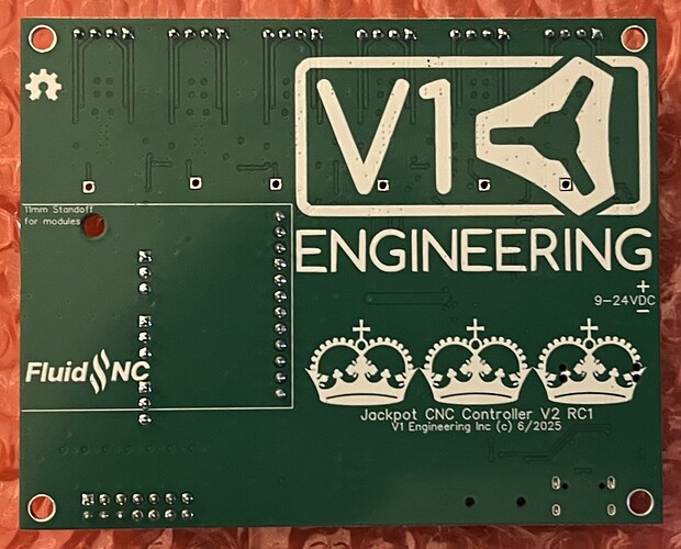

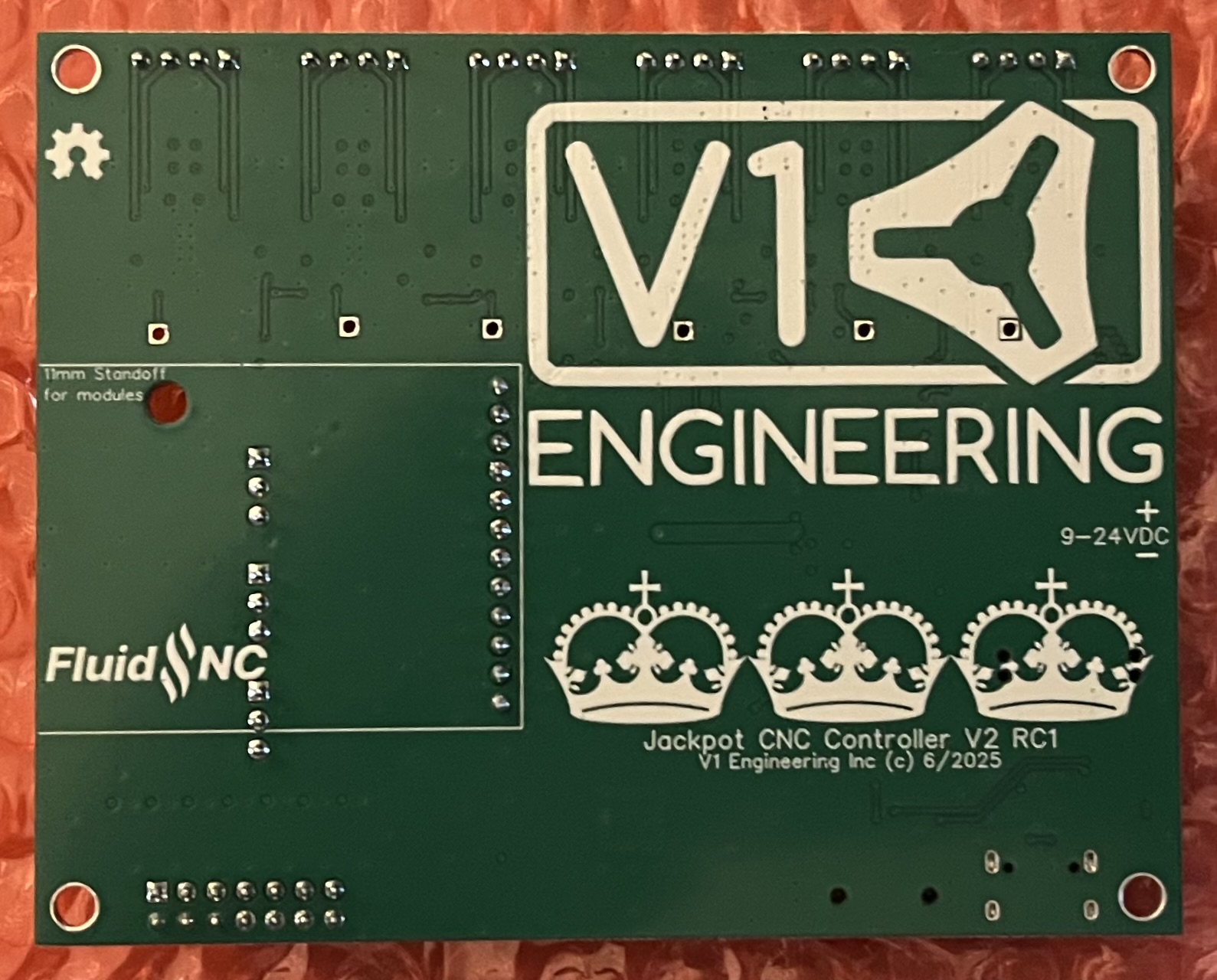

Ok. It’s always a good day when a goodie box arrives from V1.
Also a good day when the goodies have that beta silkscreen. (Sorry, board details will change a bit for RC2 so a bit more wait for a front side sneak peak)
I’m moving test stuff around to put Jackpot 2 RC1 into service. It’s going on the JL1.
Now, on to some observations.
Embedded ESP-32. I think this will be a big plus.
Remote antenna- I love having the option, but I think it would be a mistake to have that the default. I bet we get a lot of discussion about this in future topics. The micro SD card already sticks out a bit so it’s not like having a gap in an enclosure for the chip antenna is terrible.
Not sure Ryan wants two SKUs for having an option. again - warrants discussion.
Expansion connector- I say do the same as BART on the latest integrated driver board and shrink the header size. I’ll test this with an M5 version of FluidDial, and the CYD version when all the parts get here to finish one.
USB-C connector- I’m a fan.
New terminals and headers- the final versions of these (“winner”) will work fine. A couple of the iterations were a bit of a bust. I still prefer the pluggable style Phoenix- but the one Ryan selected looks good to me.
Heat sinks- I think Ryan is going with the stick-on individual sinks instead of a spreader. This will be fine.
lots of open copper on that backside. The 2oz might really help. I read a couple papers about it and they said the Via’s don’t do nearly as much as just conduction so no point in going crazy for heat spreading vias unless they get copper filled and are larger diameter.
I would love to not have the antenna. This would reduce the BOM and price. Anyone else feel strongly about this? For me it is an easy swap to get rid of it, and not have to deal with ordering antenna, and the fallout from people breaking the tiny socket.
