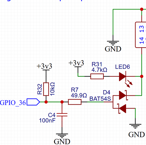

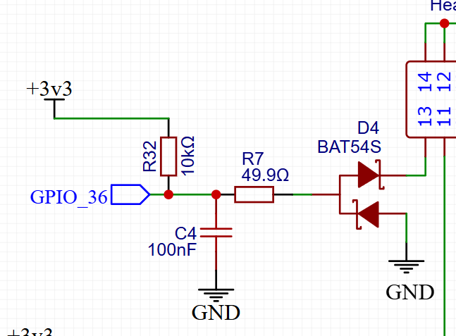

Anyone understand why the v2 input’s boot floating? I can trigger them and then they work fine but they boot as if the switch was closed.
The jackpot v1 are the same with the addition of the LED, so I have to guess the Diode is the issue here.
datasheet, BAT54S | Datasheet | BORN | LCSC Electronics
Oh…do I still need to pull it up on the other side of the diode?
Add another 10k resistor, or can I wire this up a little differently.
Hmm, that doesn’t make sense. You wouldn’t need another pull-up. Something else must be wrong.
Can you elaborate on that? That barrier diode is really there for ESD protection of the GPIO.
As drawn, GPIO_36 should be pulled up through R32 and only pulled down if you close pin 13 to pin 14.
What is the configuration of this pin in your YAML?
Something else has to be wrong here.
The input pins on the ESP32 don’t have pull up or down available.
Yaml is the same as the jackpot V1 for the inputs.
Let me double-check a V1 with the same exact yaml, and firmware version. FluidNC_Configs/LowRider CNC/JackPot V2/config.yaml at main · V1EngineeringInc/FluidNC_Configs · GitHub
