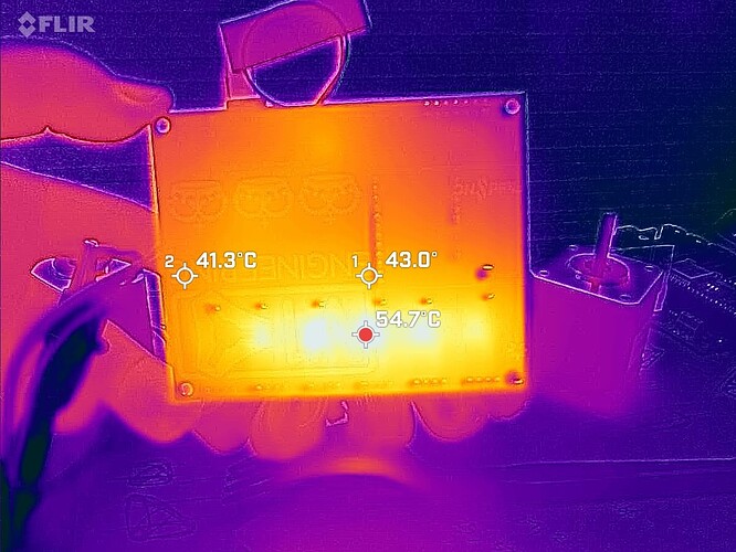

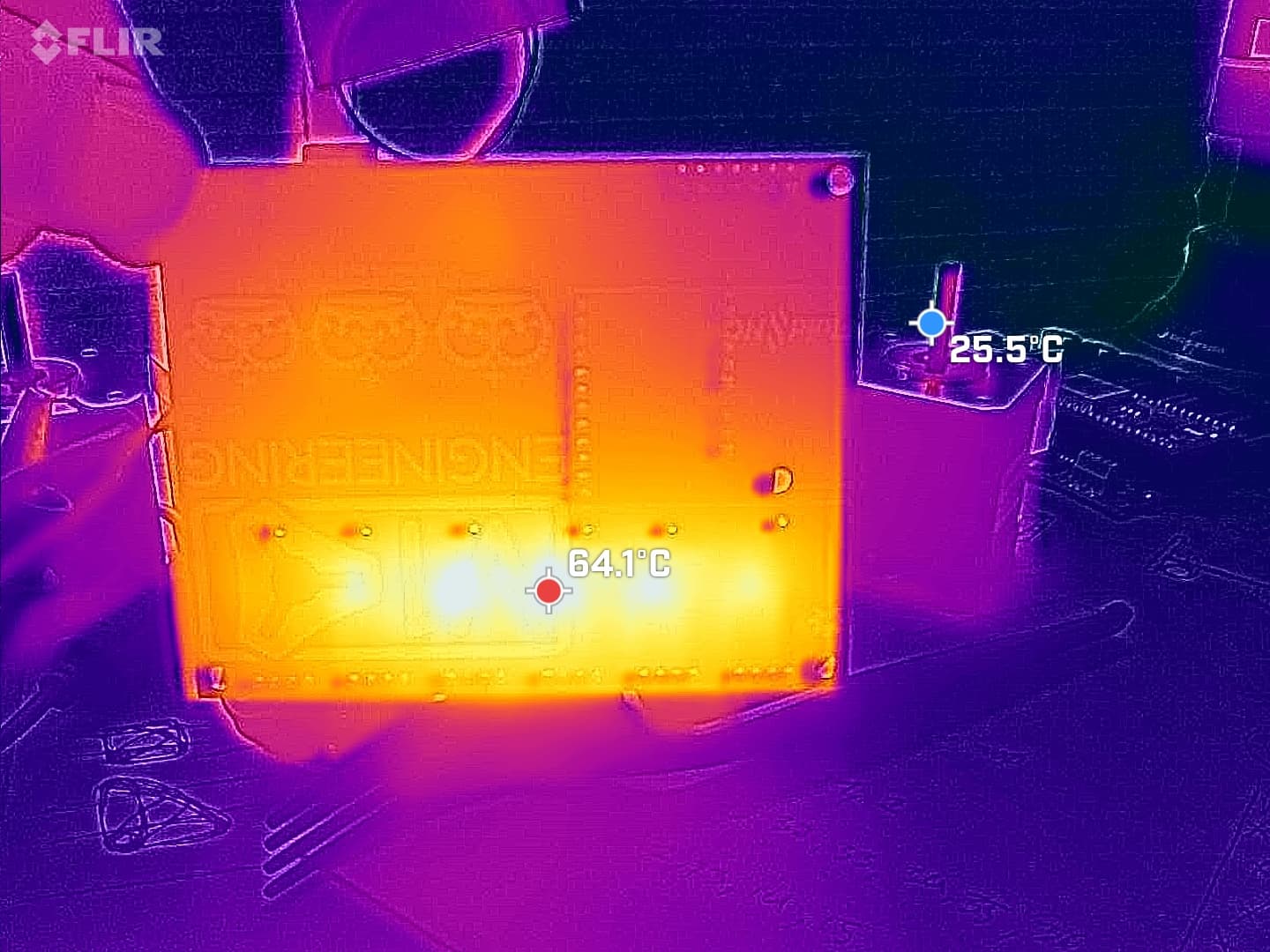

The Jv2 uses 0.52A at no motion with 5 steppers (Jv1 uses 0.55A margin of error), and 0.75A while all 5 steppers are in motion (Jv1 uses 0.76A).
Heat…
While holding.
In Motion, all 5 at once for a few minutes so I am sure it would get a bit hotter. Thermal shutdown on these is 120C…
There is an obvious difference in esp32 temp between this and the dev kit. This is barely even warm, vs hot as heck. I know heat sinks are the right move, but a fan moving air over the top and bottom of this board should easily be enough to run it, right?
I can spread the drivers out a little bit more to get even better heat dissipation but that is a lot of work for what I assume would be not much gain. But you can clearly see the heat is in the middle. So maybe I suck it up and spend a couple hours moving everything.
Maybe I just add as many via’s as I can to transfer the heat instead of moving everything…
The FLIR pics are neat, how do temps compare to Jackpot v1

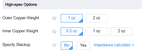

Using 1oz, or 2oz copper for the PCB? If 1oz, would using thicker 2oz copper work good enough, and work out cheaper overall than including heatsinks for Customers attach? I like heatsinks, but appreciate it’s neat to strive for removing/simplifying components if/when possible.

Guessing you have 1oz, which layer(s) are you dissipating heat? For 4 layer board, the inner layers are only 0.5oz by default? JLCPCB Copper Weight

For 2oz copper, I know this was the approach that Duet uses for their boards, and it appears to work. Genuine Duets using 2oz copper appear to have a significantly reduced failure rate than the knock-offs with the same layout and mostly the same components but 1oz copper.
I do not know the mechanism, but suspect that greater thermal conductivity effectively increases surface area. Duet also advises that the boards be mounted with the underside of the stepper drivers exposed and vertical if no forced air circulation is present.

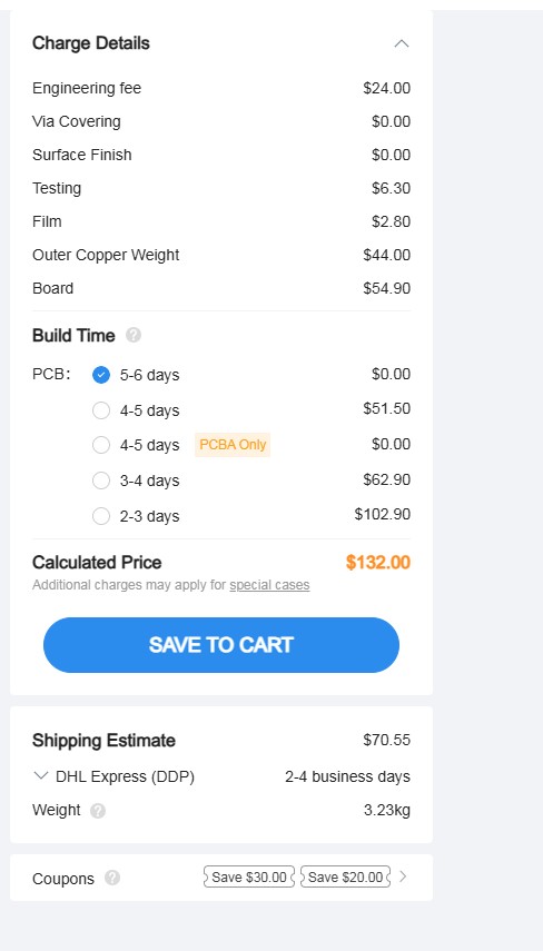

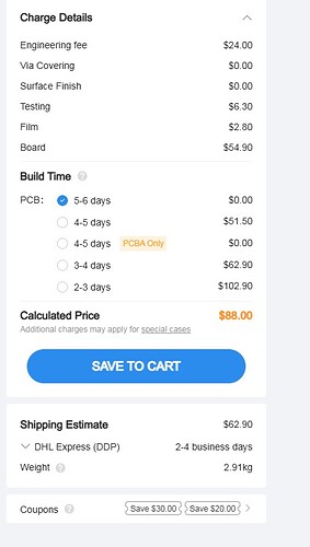

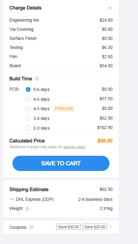

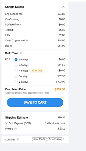

$0.44 per board for more copper.
Worth it or no, or am I going to have to get a batch and see if there are any noticeable differences?
I don’t know, am mainly watching to learn if/how better thermal conductivity increases area for heat dissipation.
Was the 44 cents increase for small batch size. Thought I saw increase drop to 30 cents when seeing what 100 to 200 boards would come out to.
Have you already explored using smaller but good enough heatsinks that get packaged but not assembled? Maslow 4.0 and 4.1 comes with no frills black roughly 9x9*5mm heatsinks, which seems to be half height of the Bigtreetech ones. They’re already permanently pasted to the chips, same heatsink part used for TMC2209 and the brush driver chips. No heatsink on the regulator which was surprise, but I haven’t FLIR’d or checked current draw to see if that’d help anything. I don’t know whether or not Bar is happy with them based on Customer feedback.
Already looked at their layout for ideas?
This is confusing to me, it basically doubles the price of the board?
