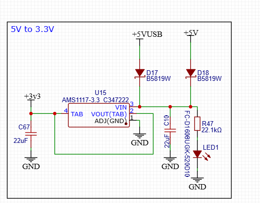

You had some kind of weird 3.3 / 5V issue. Something about VMOT also?
What open questions do you have at this point? I’m still willing to pay for some release candidate boards if you want me to put some run time on them.
USB +5V → 3.3V regulator ← +5v from Vmot.
The 3.3v feeds everything. I just needed a diode from +5v from Vmot so I do not back feed the the 5V PS.
The only question I am not 100% on is if Vmot is powered and the USB is plugged in both will feed the 3.3V regulator at the same time. There is no issue with that right?? 5v is 5V it will take from either/both.
Normally the ESP32 devkit has the 3.3v on board and we only diode the incoming 5V, this needs both.
At a high level, not really. If you consider the diode ideal (fixed voltage drop regardless of current) then whichever voltage is higher will supply the current and the other will be effectively disconnected.
With a more real world consideration of the diode (forward voltage is relative to current and ramps from up from zero volts at very low current levels) then you’ll get some current sharing based on the voltages of the supplies, which is worth considering. For the same configuration you could have effectively 100% from the USB, 100% from Vmot regulator or a mix in between.
I don’t think there’d be an issue with this. The main thing to be aware of when putting diodes in line with supply rails is that your 5V is no longer 5V, it’s 5V minus the diode drop at the rated current. I can’t offhand remember what the current draw from the 3.3V line was being sized for but assuming it’s ~250mA then you’d go to the graphs on the diode datasheet and look at what Vf is at If.
At 250mA it’s around 0.35V so you’d then calculate what the minimum input voltage to that regulator is. I usually consider voltage rails as +/- 10% unless otherwise specified but for something supplied externally like USB with unknown power supplies and cables, I’d consider that it could be even lower depending on load. Ignoring those aspects for the moment, at a nominal 5V we’d end up with 5V - 0.35V = 4.65V after the diode. That’s already a little close to the dropout voltage of the AMS1117 (1.3V max at 0.8A) so having that diode there it’s worth considering that your +3.3V rail will have the potential to sag under load. In reality, the drop-out voltage will be less than that at lower currents but there’s no info in the datasheet to go off, although the 5V rail will have tolerance as well, so it’s a bit of a crapshoot…
This is why I’d normally try to find a better quality regulator for that job, which I think we’ve previously discussed. 5V to 3.3V with a linear reg can be a little tight. TI has some
Alternatives to that are to simply live with the 3.3V varying and just hoping for the best, considering that variation downstream and making sure it won’t upset anything else, using a regulator with a lower drop-out voltage, using a higher voltage to supply the regulator, checking enough of the AMS1117 parts under actual load to be somewhat confident in their specs at actual target current…
Yeah I double checked those. The 5v to 3.3v can take a wide range of input so that part seems safe.
I will triple check the output. My 5v was 4.93+ on all boards, and the 3.3 was 3.31 on them. So I think it is good but I can fire it up again and check everything under load as well. Just need to solder the diode in place first.
Thank you!
Just to clarify a bit further, it’s not the input range I’d be worried about, it’s the dropout spec:
That gives the minimum voltage needed between input and output to maintain regulation. So if you’ve got 0.8A coming out of the regulator, you’re going to ‘lose’ 1.1V typically across the regulator… So that’d be 3.3V out, 4.4V in, minimum. Spec is only guaranteed to be 1.3V so 4.6V to never have to worry about it. It’ll likely be lower voltage with lower current, but with no information provided by the datasheet, it’s tough to make a call on how much that’ll actually be…
If you have less than that then typically the output voltage from the regulator will sag a bit below 3.3V but it will also start to be modulated by the load current, so if you get a big pulse current draw the voltage will sag further, etc. That’s generally best to minimize as it can cause other unexpected secondary effects.
Okay so we need to be specific about the 5V outputs capabilities to prevent that, which is only during Vmot power ( we have 3A and a extra 100uF cap). USB power only runs usb and the esp.

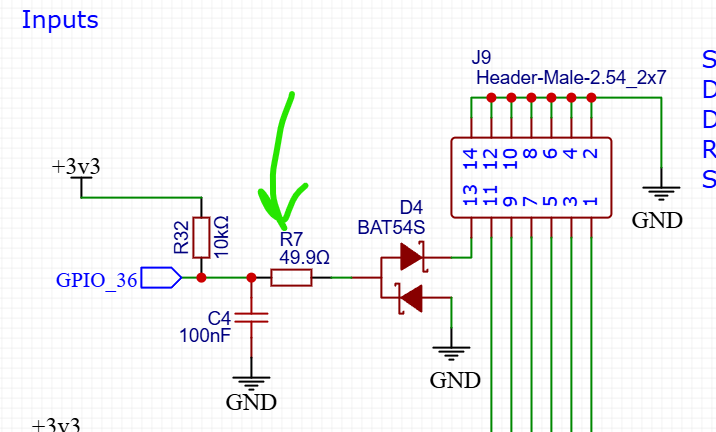

This value is not doing anything critical is it? If I can go to a 47.5ohm I can eliminate a BOM Item.
Short answer:
No issue with that change. Always a good idea to try to land on values from the E12 series like that, where possible.
Long answer:
The way that component is selected is that it’s primarily creating a low-pass RC filter with C4, so changing it will change the cutoff frequency of the filter. For filters like that, the actual frequency isn’t usually critical. Typically you’d either think of the frequency if it’s an AC or pulsing signal coming in, or the rise time if it’s a edge trigger like an end stop or on/off line.
There are a ton of on-line calculators for that etc. My favourite is:
http://sim.okawa-denshi.jp/en/CRlowkeisan.htm
If you plug in 50R and 100n it shows the corner frequency as 32kHz and a step response of 11us. So I’d look at that and think to myself that an instantaneous signal change will take around 11us to make it through the filter to the microcontroller and that any frequencies over 10x the corner frequency, so 320kHz, will basically cease to exist in any meaningful way. That’s naturally a ‘little’ simplified, but not too much. Technically you’d consider the effect of the 10K pull-up as well, but there’s enough difference here that it’s negligible… If you’re interested, I’ll explain how to calculate it properly sometime! :slight_smile:
Because of the diode, that step response only really counts in the pull-down direction so then the next thing is to consider the same thing in the opposite direction. It’s a 10k/100n in the rising-edge direction so you can use the same tool to get the step response with 10k/100n and it’s 2ms. So in general, 11us to respond to it being externally pulled down, 2ms to respond to it being released and being returned to a high state by the pull-up.
The final part of it is the voltage states under the 2 conditions. With the switch open and the line floating high it’s reasonably simple, it’s just the 3.3V rail and the 10k resistor. Technically you’d look at the bias current for the input which is how much current comes in/out of the input in different states, but that’s usually low enough that you don’t need to consider it for a 10K pull-up, maybe 100K+ you might. For the switch closed/low state then you’d consider it as a voltage divider being created by the 10K and 49.9R resistor, with the latter connected to 0V. Again, that’s enough difference that this isn’t ‘really’ worth doing, but for the sake of argument we might as well. I do this by adding the two, so it’s a 10K + 49.9R so 10,049.9R resistor and then working out the current through it. 3.3V and that resistance leads to 328uA. Voltage would be 16mV, total power in the divider is around 1mW. Both completely negligible in this case, but still useful to specifically consider.
I often put some of these numbers on the schematic as well to make it easier to review and remind myself what the parts are doing in the future. Typically the frequency response and rise time, at least. Power in any resistors that it might be getting close to ratings or important, etc.
That sounds like a lot, but I usually do that in a spreadsheet for each design I’m working on so that I can easily document it for the future, do a couple of versions of each, see the effect of changes easily etc. and add extra calculations to anything that is needed. When adding another section it’s copy/paste a previous design section and add it in to a different part of the sheet, etc.
Something like this:
So I can easily see that it’ll barely change anything.
Edit: Usually with a screenshot of the circuit itself next to it so I can refer to the actual designators because sometimes it gets quite a bit more complex…
