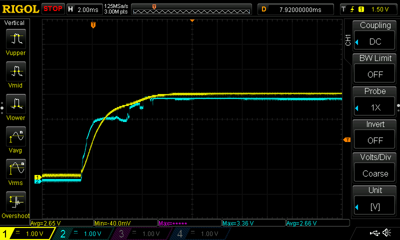

Good news----
The new board is here, I made one tiny mistake all, a little hot air and remove the extra capacitor and add a jumper and they work.
As far as I can tell everything works, inputs, outputs, steppers everything.
Issue—
The issue I am having is I have to hit reset to get the webui to load and the drivers to initialize correctly. 24v or USB only, same deal.

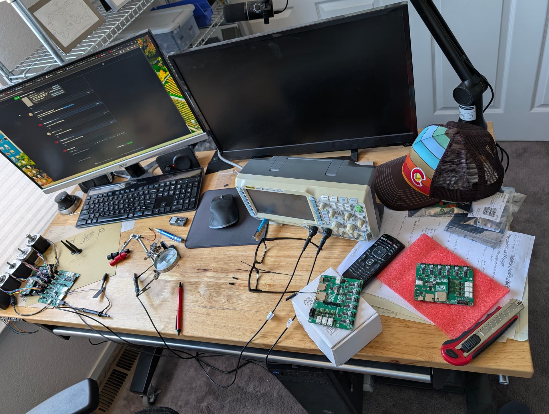

With the scope I have checked the timing of the enable and 3.3v pins on the esp32 and it seems close but I guess not close enough? Let me get some screen grabs to see if any of you can help.

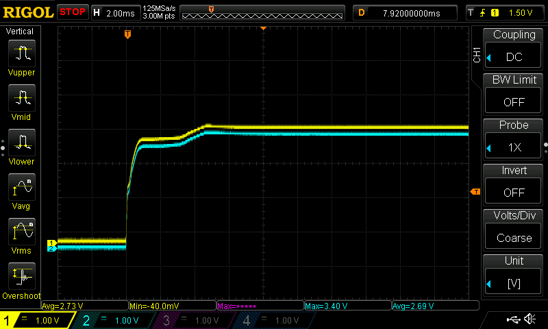

Blue - 3.3v @ the esp, Yellow - Enable @ the ESP
genuine naked esp32
V1 naked esp (I used this for the V2…)

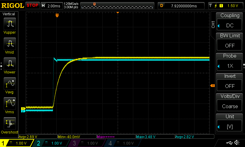

First V2 boot from USB, WTF, maybe a bad probe…

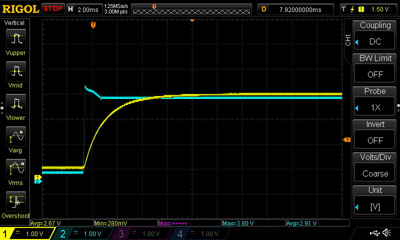

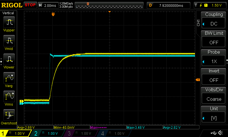

2nd v2 boot from USB, Is this tiny little dip the reason? ~0.2V lag, too much capacitor?

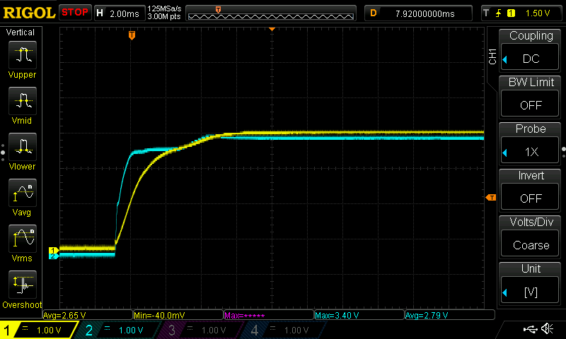

Jackpot boot with v1 esp
probe at the 3.3v supply, one at the 3.3 port on the board. HMMMMMMMmmmmm
Shoot, while the steppers are plugged in and no 24V supply, just USB the steppers make noise and I can feel tiny little pulses. That is new. Even after I issue an $MD
Something is drawing down that power I suppose.
I need to ship one out to you ASAP Jim.
Maybe a noisy uart line?
Okay, USB only somehow the Vmot has 3.77V on it. That is not right. Making progress.
I’m a bone head. The diode is supplying the 5V AND 3.3V power supply when is should only feed the 3.3v.
I need to try and do some surgery to correct this.
