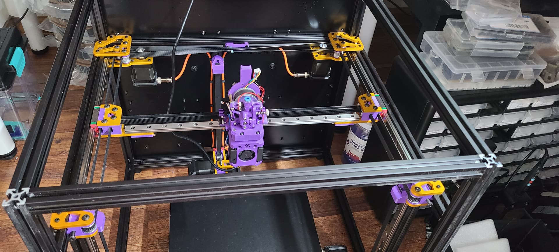

SW VA V5 with a DragonBurner, DragonCutter and Filament sensors on the toolhead
Working on the bed for a little bit today. The build plates and heater came in. discovered two small issues.
  1. The Dragon Burner hangs down much farther than the H2 I think. Wondering if the Fusion model can account for that in measurements when you use the parametric items for the x and y offset for the nozzle? This is not a huge issue as I sized the printer to do 250mm in Z and will still have at least 200mm when all is said and done.
  2. Having the nozzle centered on the carriage causes the bed to be centered in the machine. Again not a huge issue EXCEPT if you had decided to use a full 300x300mm heater. The center bolt on the back of the bed is dead center on the plate and that is where the wires come out. I am using a 280x280mm heater so I offset it forward to give me clearance for the wires. I am using silicone spacers to mount the bed but if I changed that to something else it might be adjustable some.
The chances that I am using the FULL depth of the bed are usually pretty small and I think that there will be enough heat transfer to the excess section of the bed plate that I wont notice it. I need to get one of those FLIR cameras sometime soon.

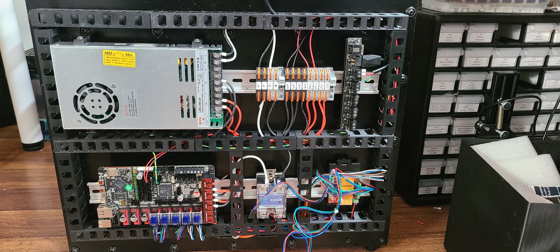

Added the DIN rails to the back. The plan is to eventually put panels all the way around but I want to get things up and running to test out the hotend. Wondering if @orob or anyone else has a DIN mount for the Z brakes board…
I used some silicone mounts I had on hand. Just moved the heater forward a bit and it worked great. The front mounts needed a little trim to clear the bed heater but it is all super solid!
I get that! I went with a full size heater lol. I had to use my thermal camera to see where I could trim a little bit to make the screws clear. The TPU mounts touch the heater but they havent cared in the last year of use.
What are those clips you are using to attach the wires to the extrusion?
I like those motor caps. Super clean build. I haven’t started my next build yet. There is no din rail mount for the brake board that i know of yet. You could make one… Or maybe I could.
do you have the dimensions for the board you can share? I am sure I can gem something up for it!
https://www.thingiverse.com/thing:4612080
These. different sizes for different cables. So far the .250 ones have fit both my orange wires and the bed heater and thermistor but I still have a ground wire for the bed so I may have to make one a little bigger.

Was working on wiring the toolhead to the EBB36. Let me tell you… putting 3 wires into a single pin requires the strongest cheater readers you own!

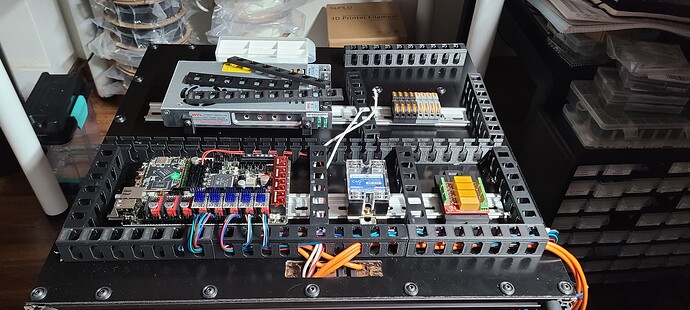

Perfect! Started working on some of the wiring!
Love that layout and cable raceway. What design did you print for those?
Cable Raceway Customize Size by Scott | Download free STL model | Printables.com
This one. One note. The parametric’s are off on it. You want to put half the width you want in to make it work.

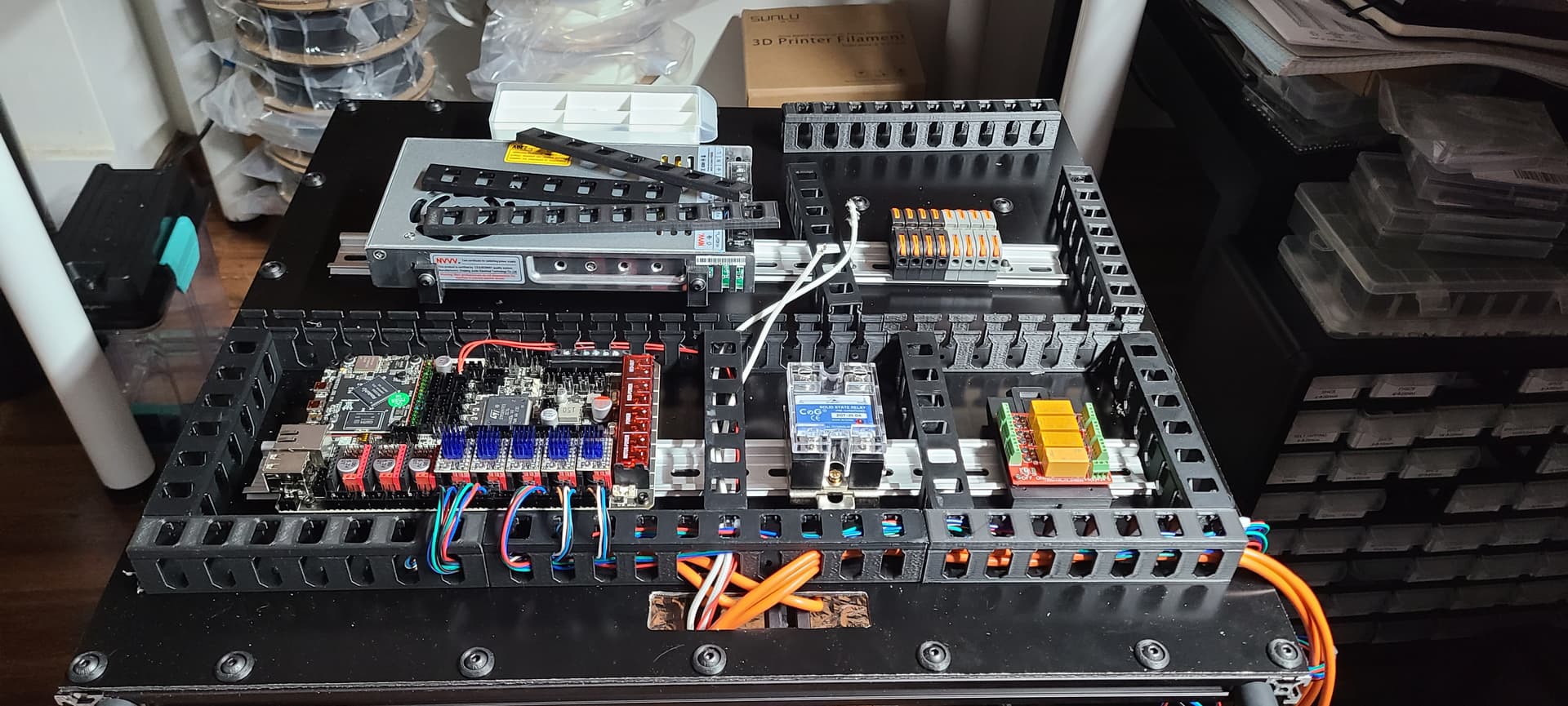

Just a couple progress pictures. Waiting on insulated ferrules for the motor wires to arrive. They were supposed to be here today…
At first I thought your wiring panel was above the top of the printer… Then I realized it was 2 pics :crazy_face:
Man that is looking good. My V5 started out looking similar to that, but sadly didn’t stay that way after adding/changing things a few times.
