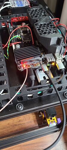

Nope! On the back. My V4 has it all on the bottom and I like the compactness of it. Admittedly it is a pain to work on…

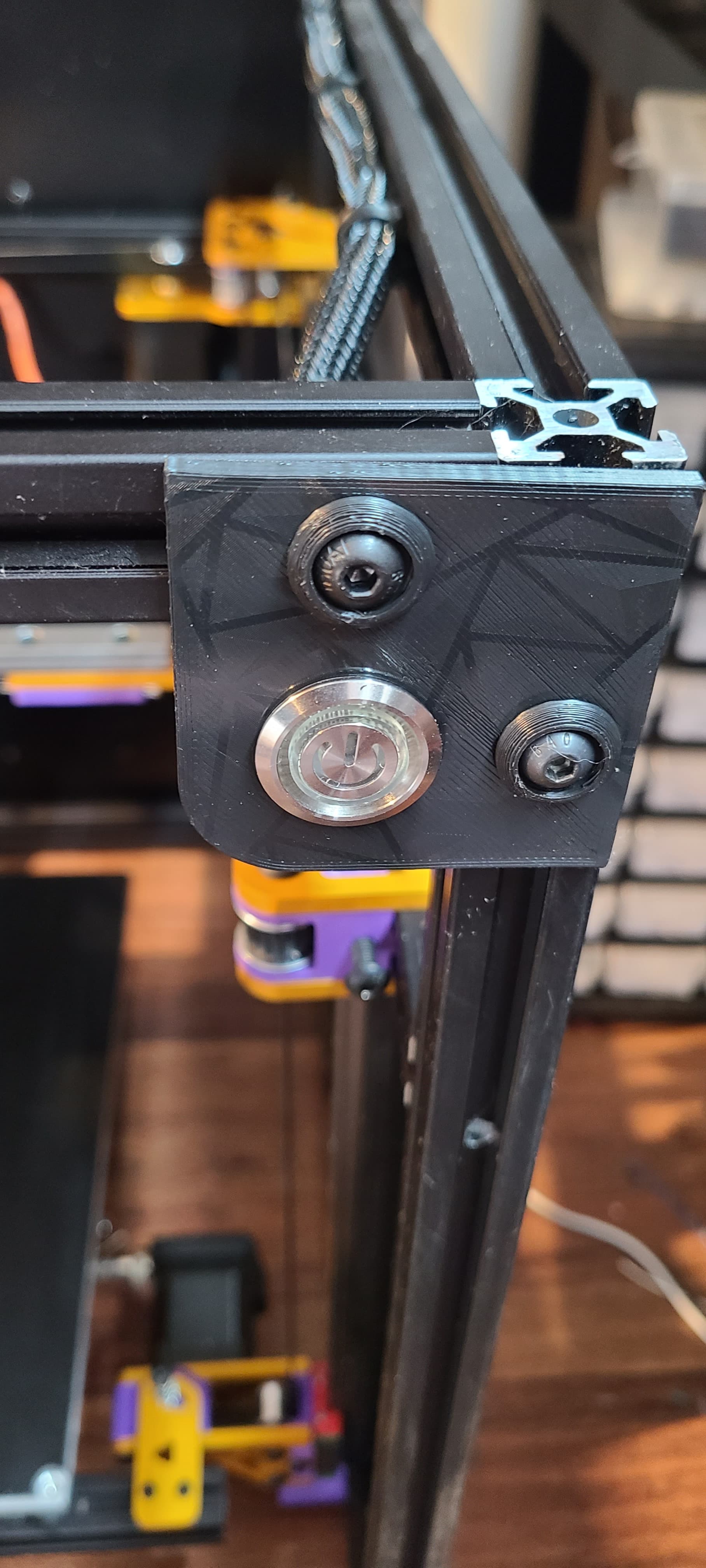

Well, I thought I was readdy to put power to thjngs and start programming. Apparently my LRS-350 power supply had other ideas. On the bright side, my power switch is sexy…

I have to say, having the electronics out like that would be quite a nice way to work on them. But I don’t think many cables are long enough by default.
I often have a hard time making cables and electronics compact and hidden. So I like the aesthetic of doing the reverse and making them obvious.

As promised. Sexy power button!

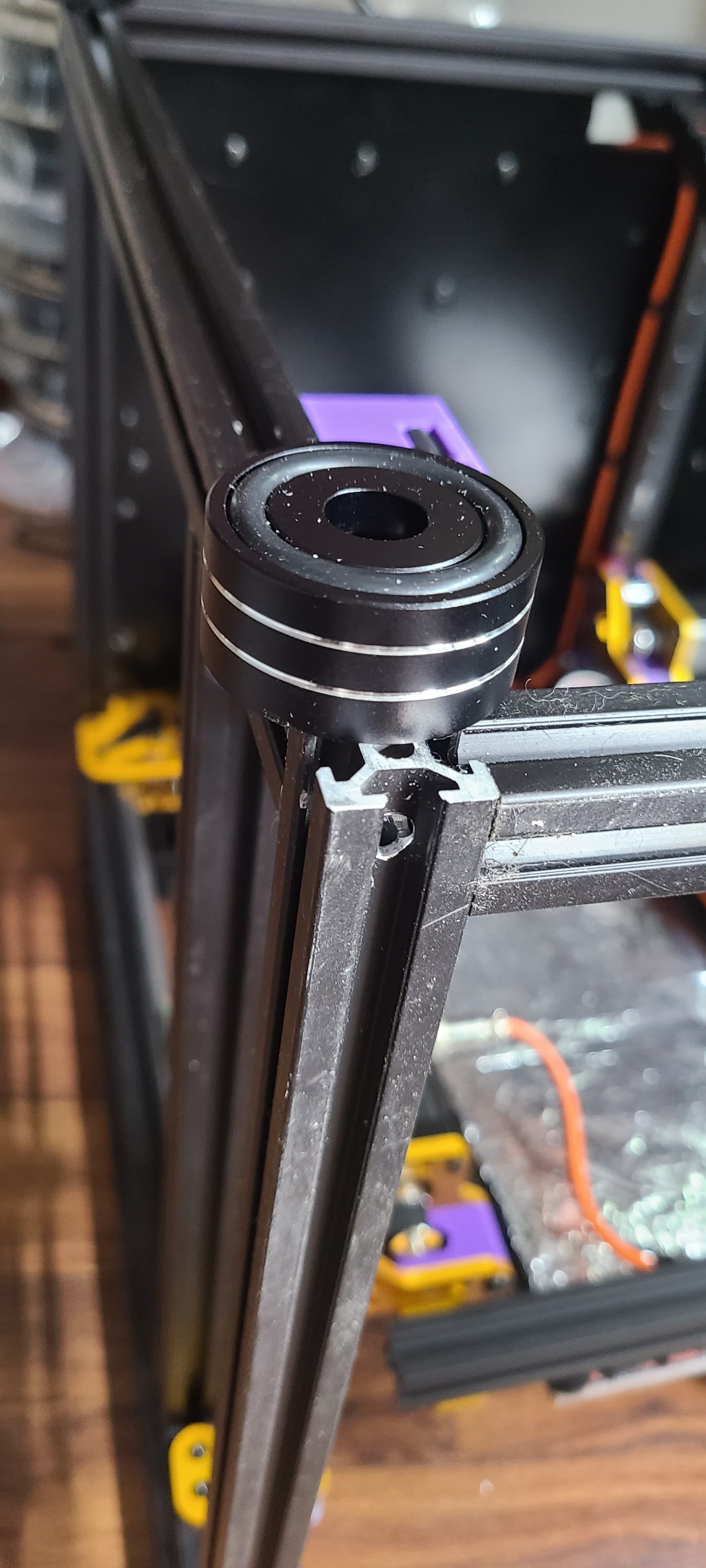

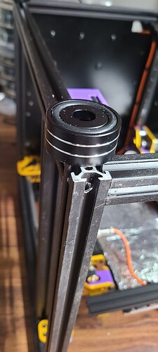

Found the cool feet on Amazon. Designed to isolate speakers. 4MM bolt and hole so a couple t Nuts and we are in business!

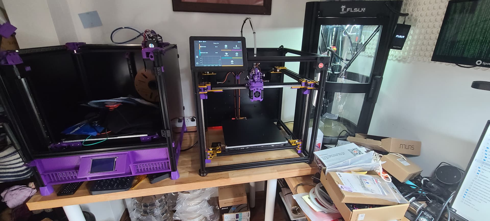

Cleaned off its space on the desk and set it up. I have the microprobe installed and have successfully homes all axes and done a Z Tilt.

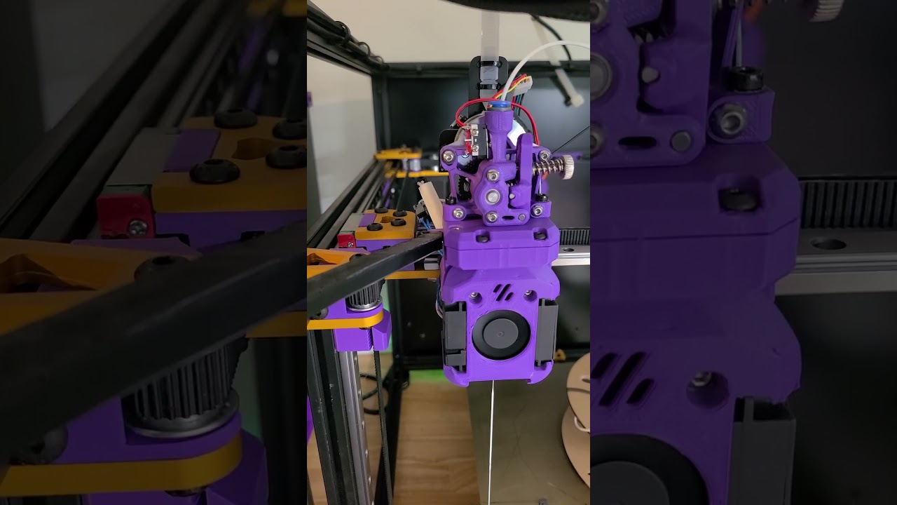

Your cutter is lever actuated with a mounted attachment?
I have a servo on mine and it is way too big. Photos if your cutter or a vid of it in action would be if interest.
That is great it works!
Working on the lever part today. As soon as I get it worked out and implemented i will document!

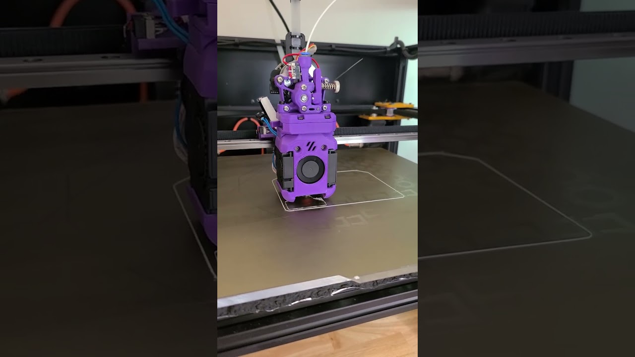

Sequence:
Move to the start point
Retract filament to shorten the stub
Move forward slowly to cut the filament
Move back to start point
Push filament in to move stub back into nozzle
Retract filament to above the extruder.
When the TradRack is installed and configured the two filament sensor switches will figure into the sequence.

Is it just me or was your extruder skipping quite a bit in that clip?
Probably! Go figure it started when I filmed it!
Download free STL model | Printables.com
@Naralu here you go. Please feel free to ask me any questions. You SHOULD make modifications to your frame to accommodate this.
Almost seemed like your feed rate might have been too high in your macro. Hard to say for sure though
I turned it down. Had it at f1000 so I went to f500. Should help!

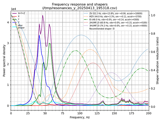

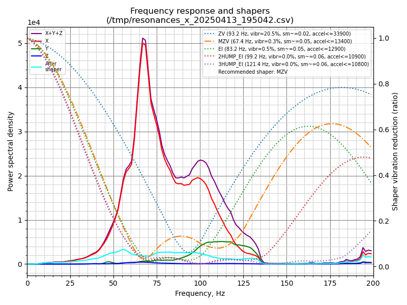

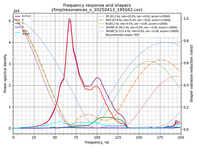

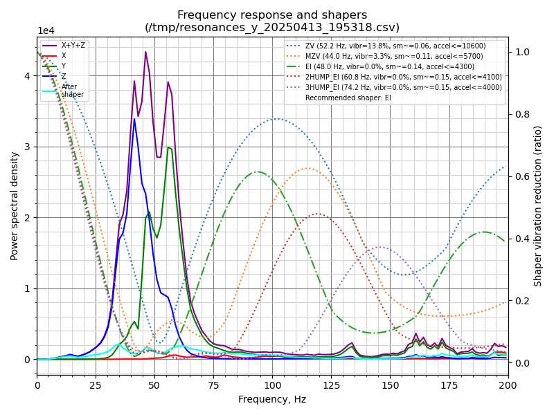

I am not sure how these compare but this is what I got when I ran my resonance compensation.
