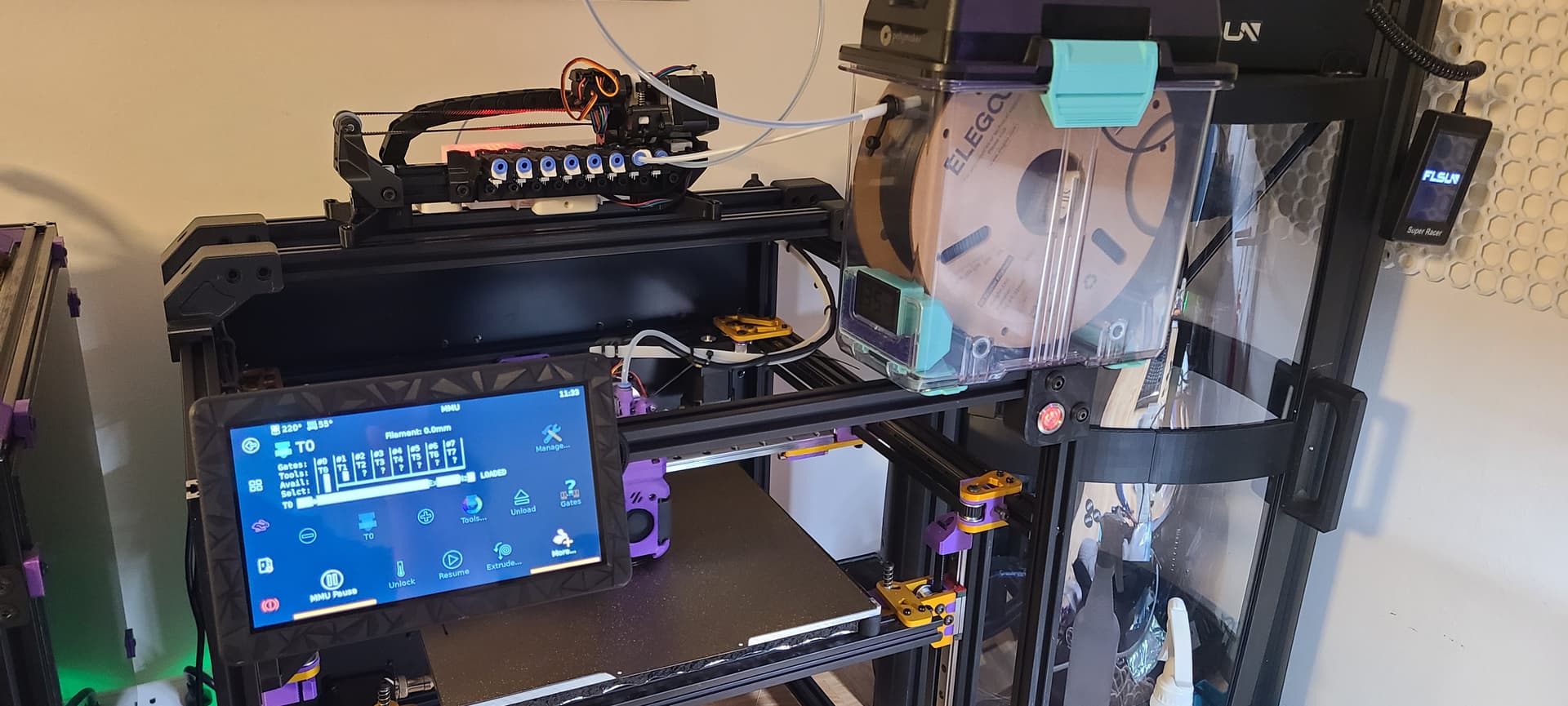

SW VA V5 with a DragonBurner, DragonCutter and Filament sensors on the toolhead

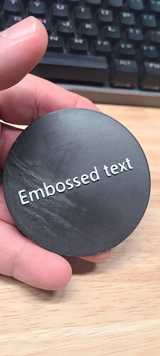

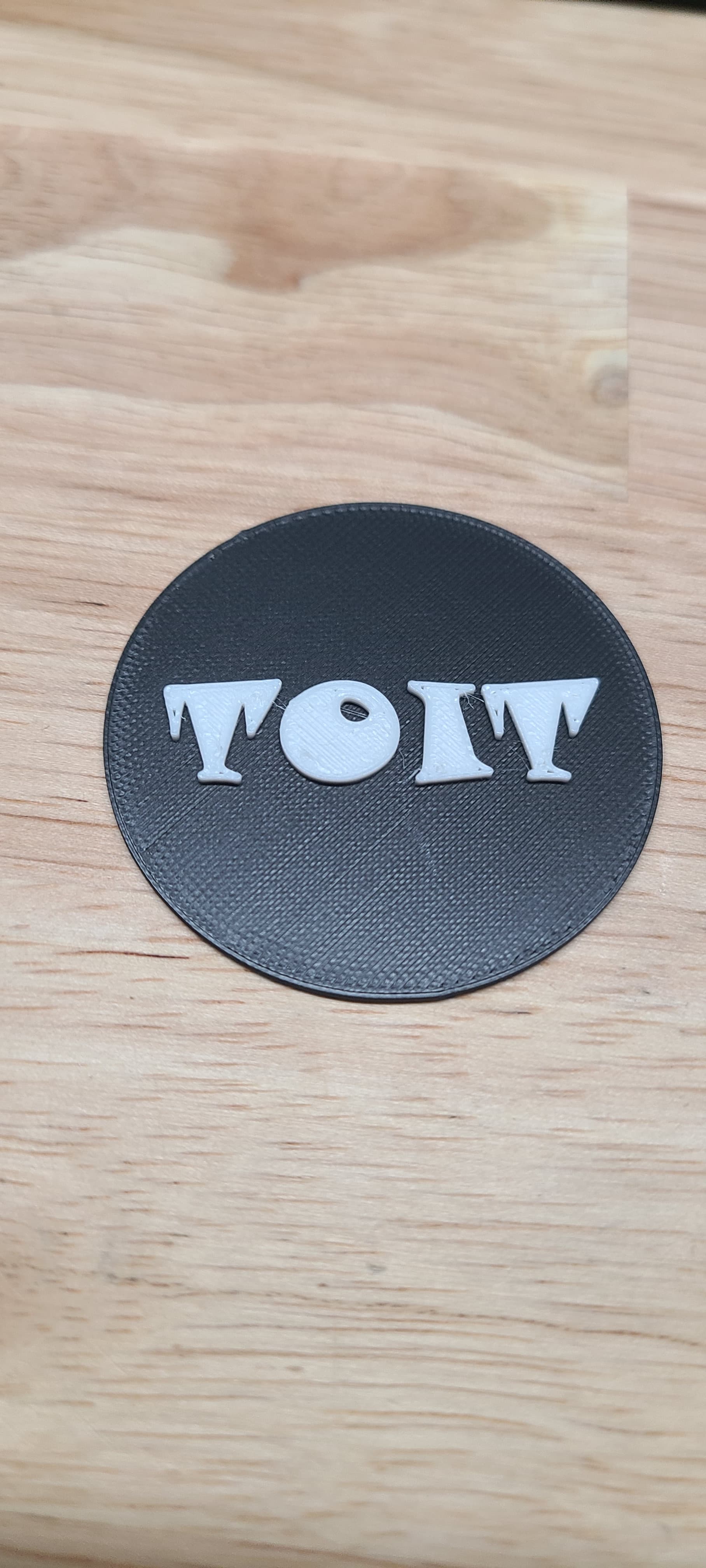

Teaser…
Another one…
Tradrack working?
Yessir! Working a couple issues out. It pauses the print when it changes tools. Not sure why yet.
Will take some videobor it doing a change in the next couple days.
I paused messing with the chameleon because it tangled the roll when it tried to swap colors… rewind needed. I haven’t had time to figure one out that will work inside my drier box. Glad you got yours working
using polymaker dryer boxes and putting the rewind inside with the spool. works pretty well after you loosen up/use some of a new roll.
Filament cut, retract and change with purge.
I want to rig up a system to make it make “poops” and then brush the nozzle. Still working on that. Also i am having an issue with Happy Hare parking the toolhead and pausing after a tool change. I have to go in and press play again to finish the print.
That polymaker box has a rewinder in the lid?
It does not! It just works out that it will loosely spool just enough in there around the spool.
