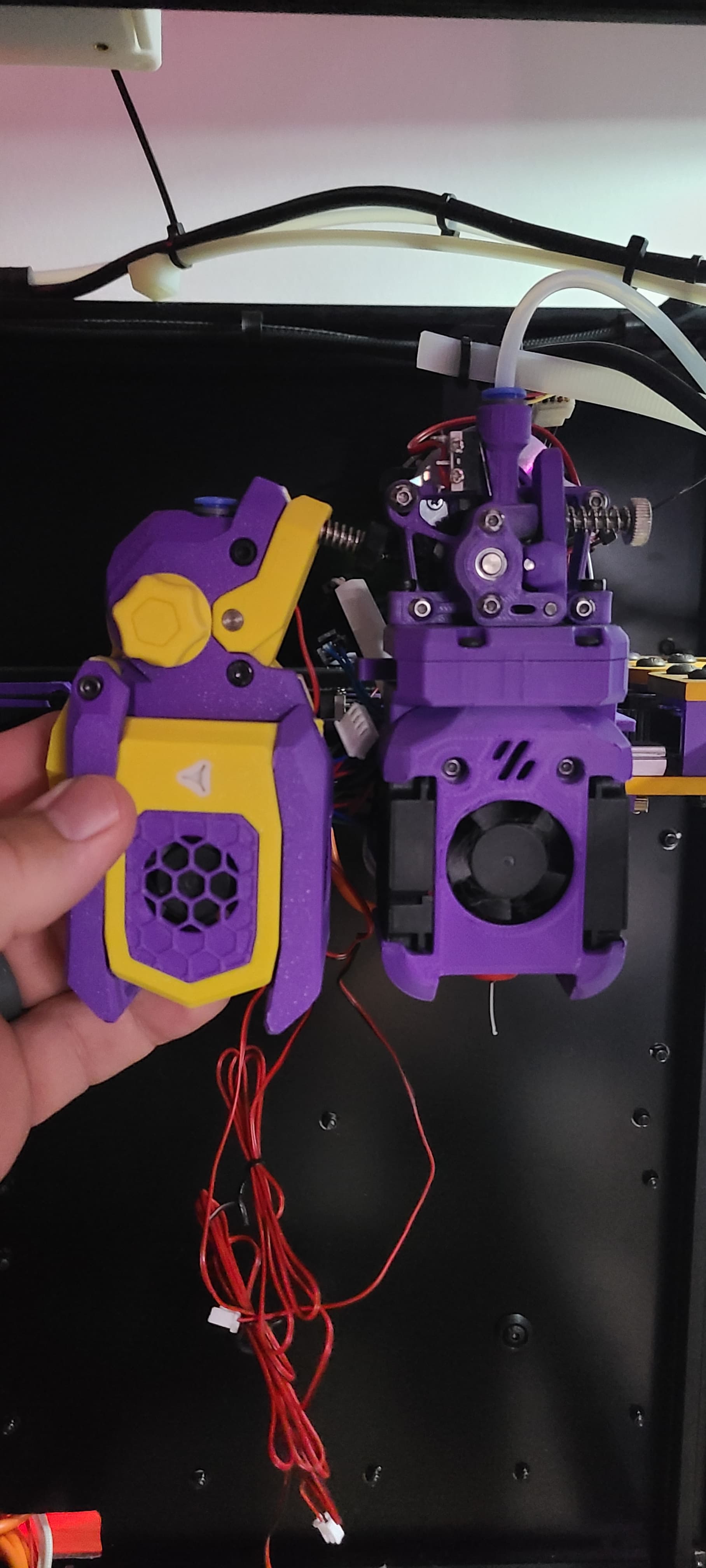

I am working on printing a new toolhead!
The DragonBurner works great. I was looking at the Yavoth to replace it and in the process stumbled across the AntHead. It bolts right up the same way and is SEXY. Plus the new one integrates a cutter into it so it does not increase the height like the DragonBurner and Yavoth do with the sandwiched cutter. We shall see. Printing the Ducts on the V5 now (hopefully, I am at work). More later

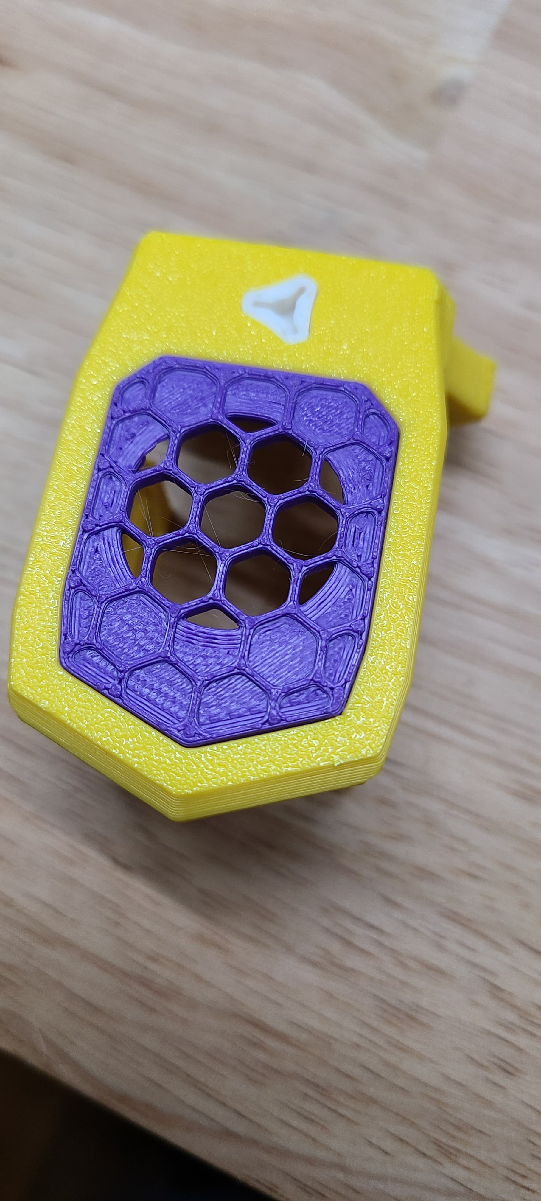

Found a workaround!
Selected the files I needed in OnShape and then exported them as .Step files and opened them in Fusion.
I am printing some of the files while I am at work but if I did my alignment right I will have a V1E logo that lights up on the shroud!!! Pictures layer!
As promised. I made a little insert for the middle but think it may end ip being way to fiddly to put in. This is just a mockup while drying the translucent filament. Honestly the white might work though.
Nice!!!

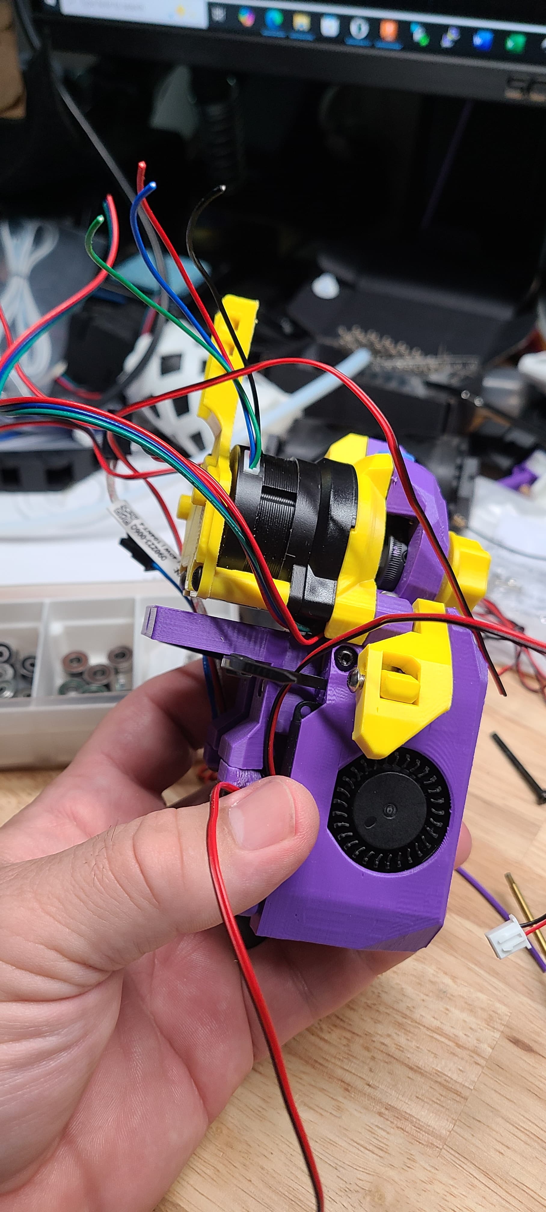

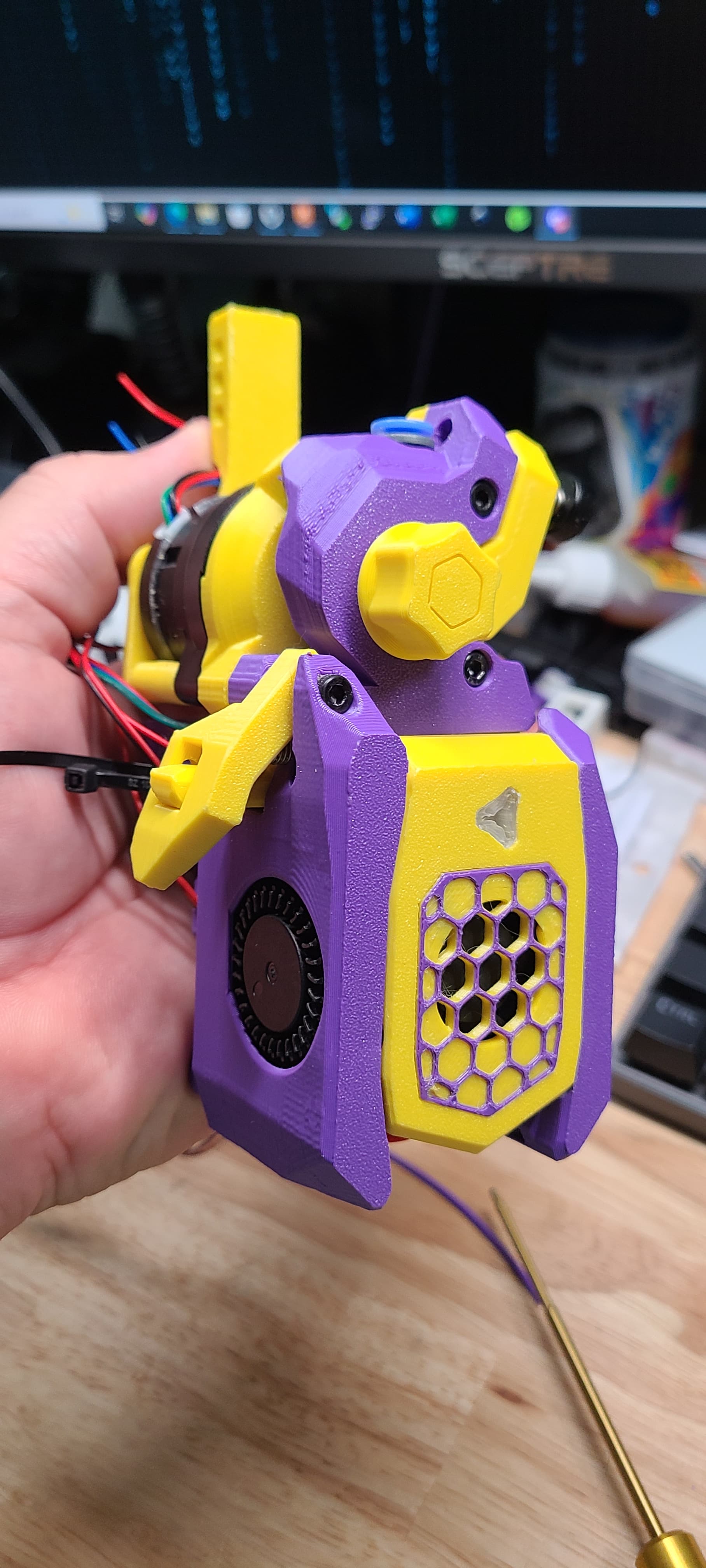

One more for the night. Looks like roughly 1 inch shorter overall. Still has a filament cutter and pre and post extruder sensors.
Little more work on the Anthead Hotend. The Doomcube Discord has an Anthead section and those people are fantastic with helping get this sorted.
Mine has a WWG2 with the Galileo Gearset but they have a new mod to use the WWBMG now. Waiting on a EBB36 board so I can get all the wires setup and routed.
It looks like I might be able to use part of the frame for the cutter. I am not sure yet and the only thing that will stop it is the length of the belt holder part. I am thinking I might be able to shorten it and get more travel out of the whole machine using these hotend mounts. More to (slowly) come.

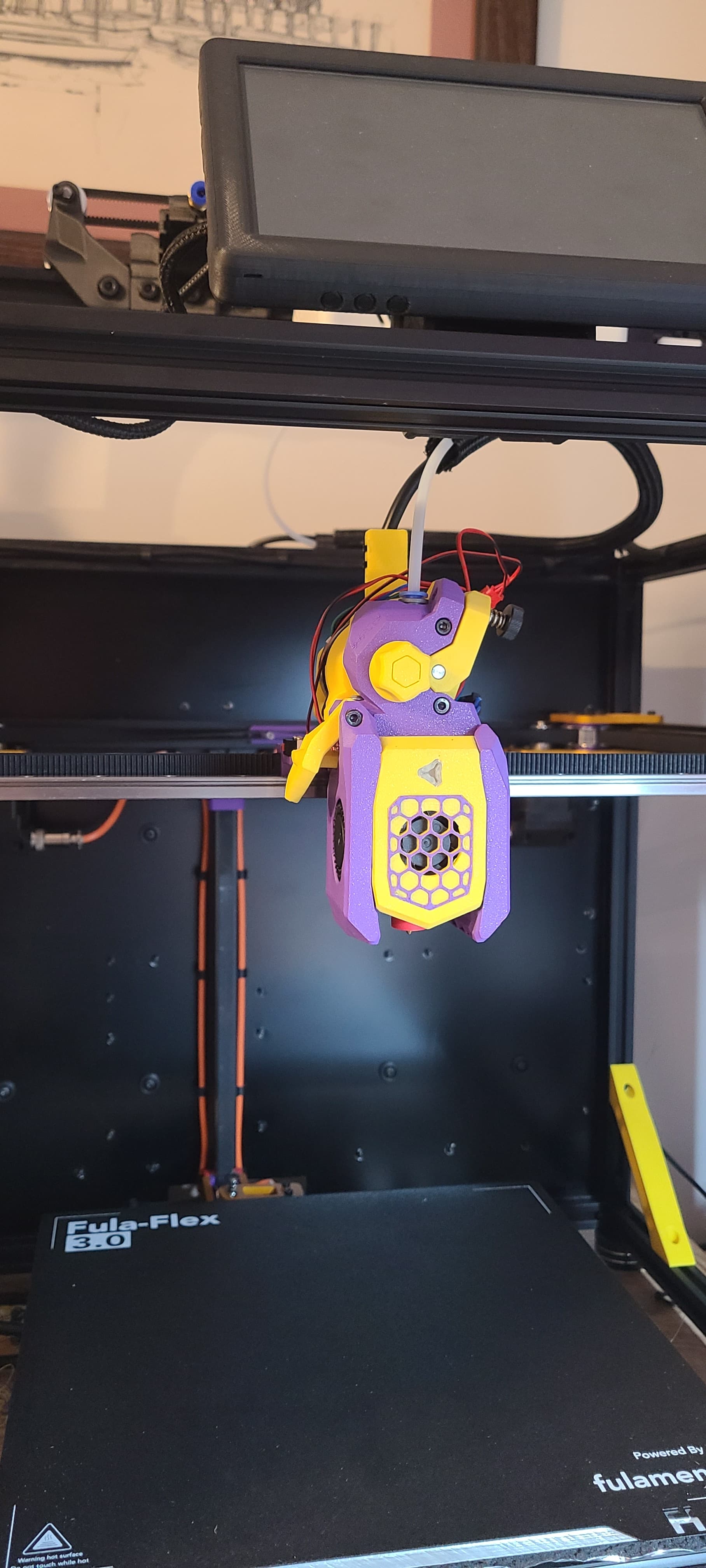

Printed the grill on the front with the existing Dragon Burner and Tradrack!
Slowly…
Made some modifications to the TradRack. Discovered a loose hotend on the DragonBurner and a lot of burned filament (the dog has been freaking out when I was running it and that was not normal) on the heater block. Went ahead and swapped out for the new AntHead with Leafcutter
A little more progress. I think i have ironed out the cutter issues I was having with thebAntHead!

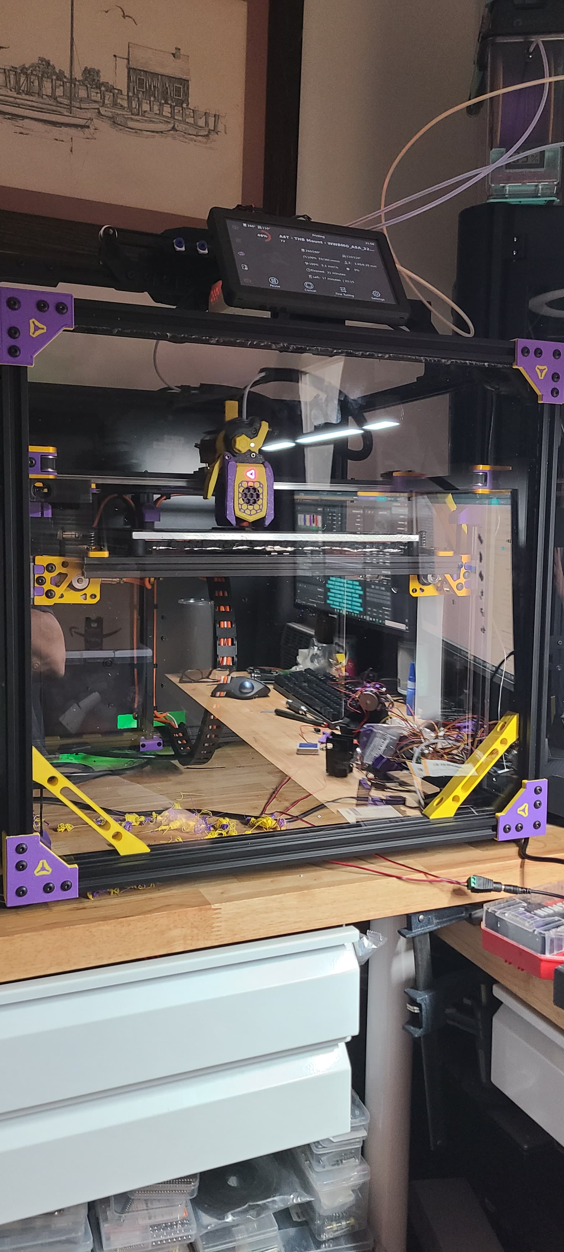

Printed the door corners and cut the Acrylic panel. I hate cuttjng that stuff.
That is when you call someone with a laser… I might know a guy.
