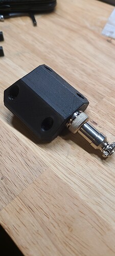

Some progress pictures. I am using 12mm 4pin aircraft connectors on my steppers to make it just that much more sexy.
Motors installed and belted up. The order is a little different with the rear belt mod I and doing but if you start at the pass through and count that way it works just fine.

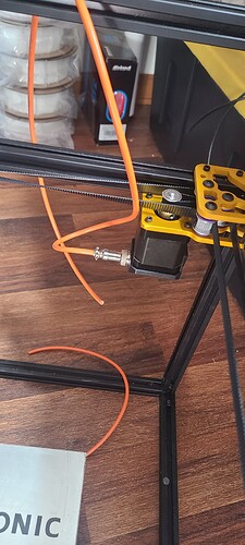

Another picture of the aircraft connectors on the steppers with the wires connectorized.

Silicone tube works as well.
For the most part they are not actually needed.
