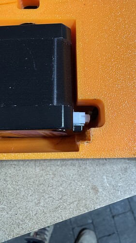

Here are the photo, as I promise
I’ve done only for Y axis motor, if you want I can do similar for Z as well, to be clear for you.
By the way, separate from the question of the physical fit, your motors are wired differently from the usual motors that we use.
Normally, two pairs of adjacent wires on the 4-pin connector are connected to coils, but as listed from the store, the ordering on yours is different, where the first and third are one coil, and the second and fourth are another coil.
Since your wires are black, it seems you may have re-wired them already, but if not, you will want to check the wire ordering.
Thanks for mention, but I know, I already used them to previous LR version.
Thanks, will be great!

I’ve noticed you word it this way a few times and just so you don’t run into issues when you start to run the machine I wanted to mention this. The motor you made clearance for is the Z motor. Your Y motor is the one you were able to turn and make work.
Great job on your modification. Looks really good
Yes, you’re absolutely right, and I apologize for the oversight. This is a mechanical mistake, but even if there’s an error, it can be easily fixed by swapping the wires on the controller. I’m confident everything will work out fine.
Thanks for the suggestions, yes definitely I will hopefully this evening.
No need to apologize at all! I was just hoping to save you the hassle later :smiley:
