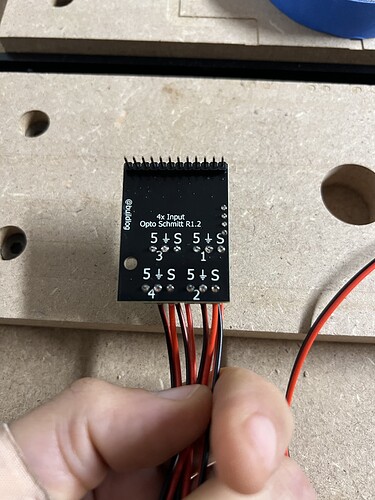

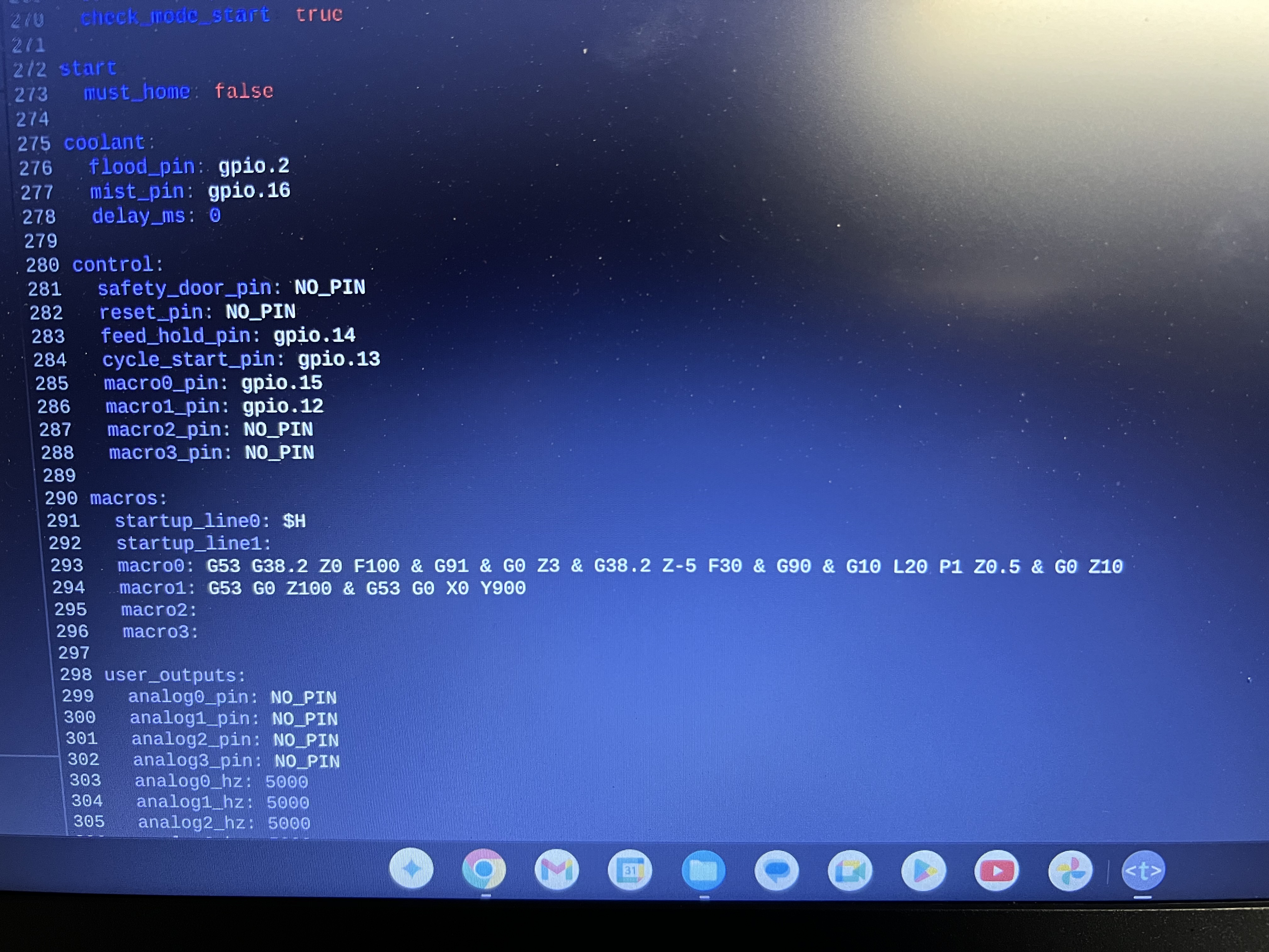

That said, I added a 4 input I/O module to the spare slot of the Jackpot Board, and modified the config file:
The config file relative to this mod will be like this:
The macros are wrote directly inside the Config, no external .txt (pay attention, this create conflicts with V1E’s standards Macro).
The macros I create are made to work in every position of the machine, you can start probing at whatever Z position you want, the only limits are the real travel of the machine. The same is for clearing the workspace, it doesn’t consider the starting position and workpiece coordinates.

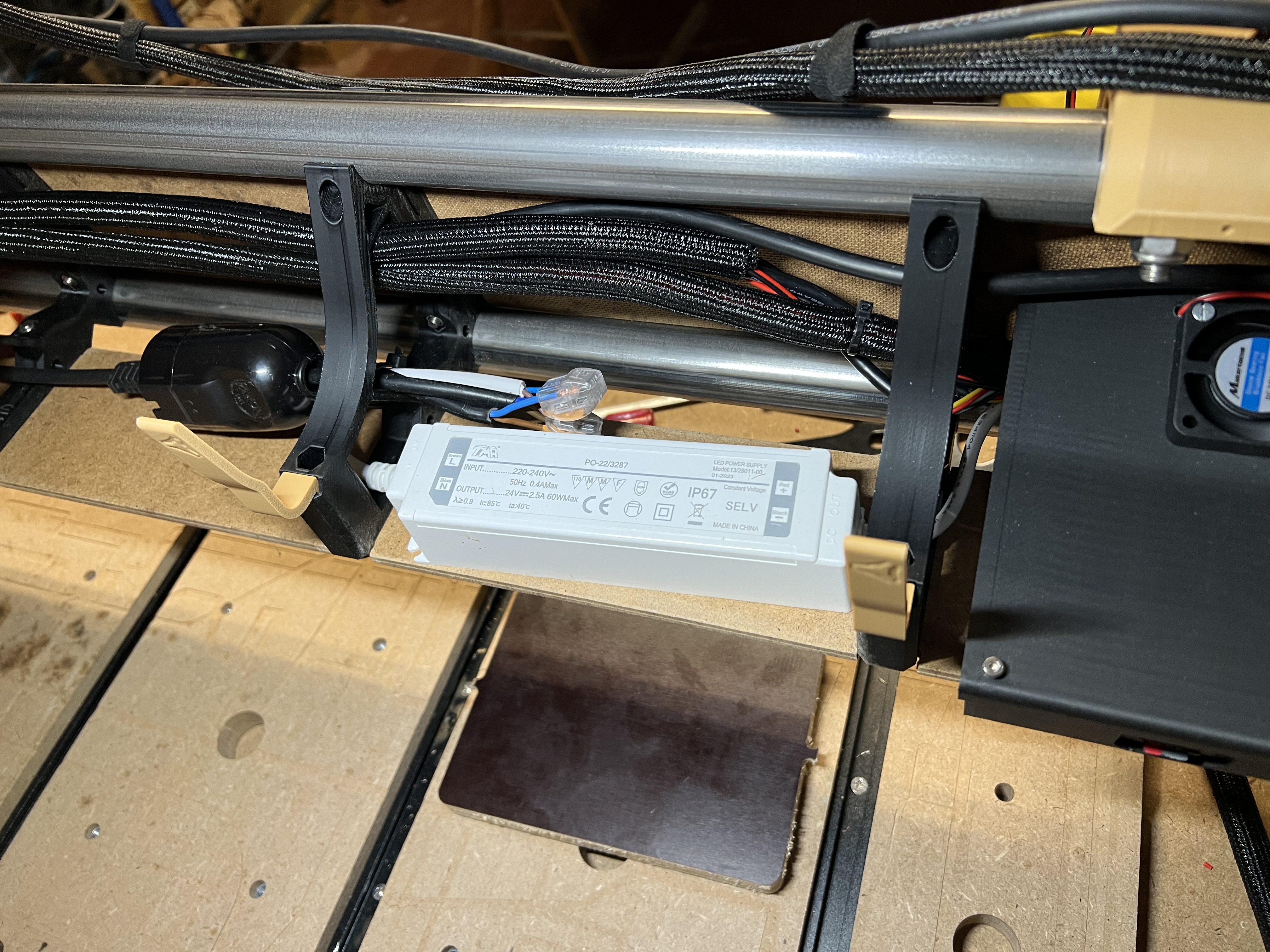

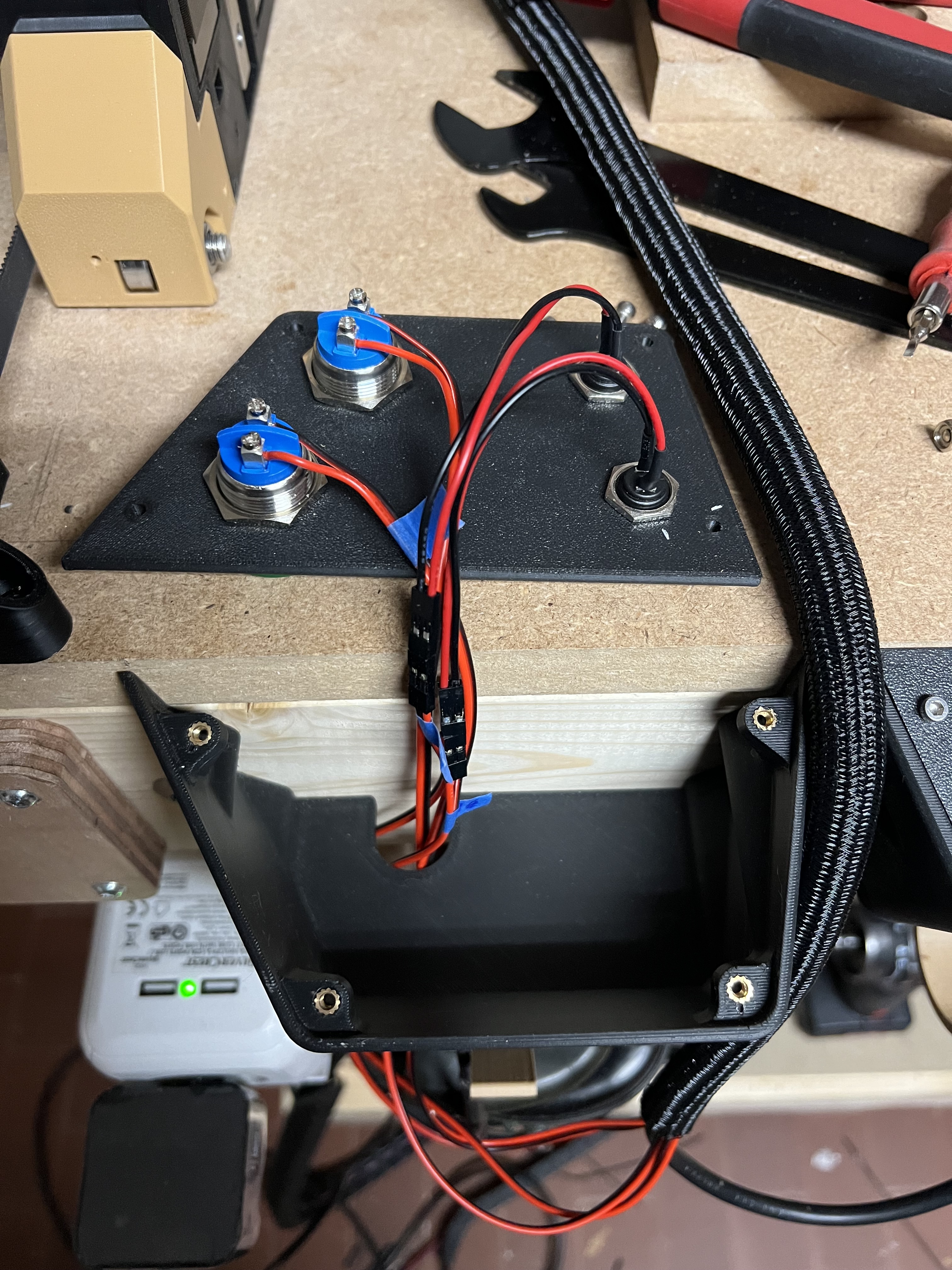

And this is the result:

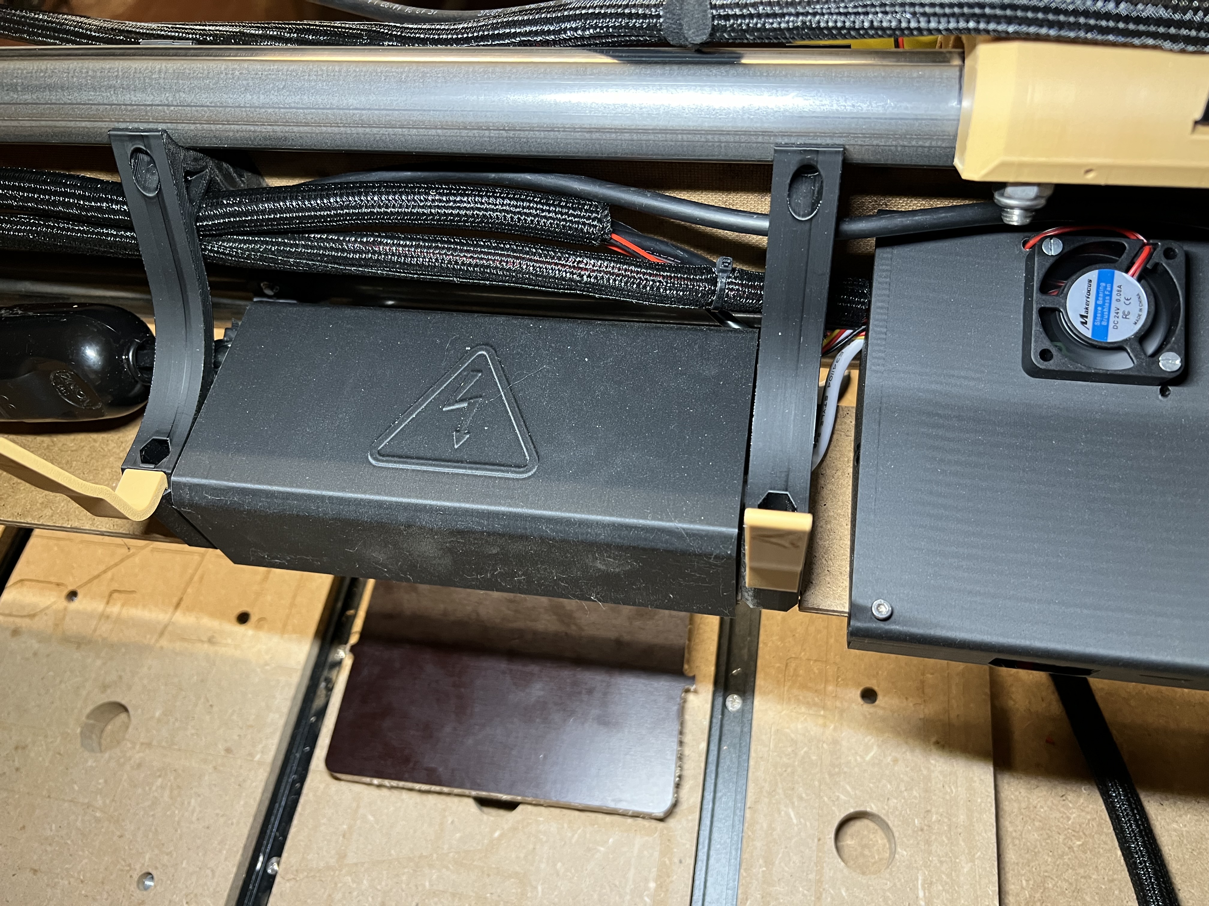

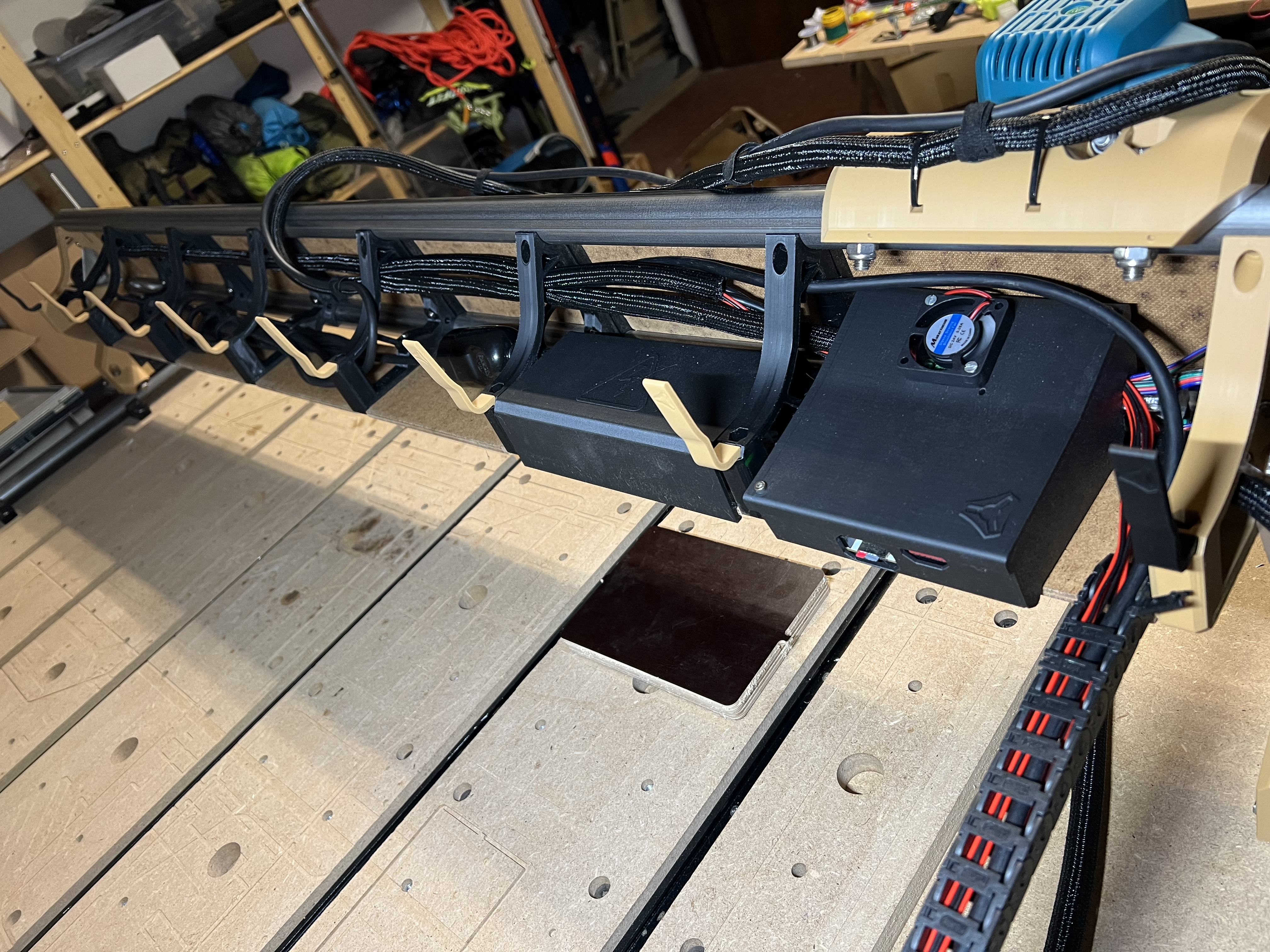

This is the cable managment:

That looks amazing! What do your y stops look like? I’m most of the way done but the documentation isn’t ready yet so I might be able to figure it out if you have a picture!
I’m not in the workshop anymore, but anyway I placed them without any advice, so would be better to wait official documentation for a proper assembly.:sweat_smile:

Do you have a build thread for your machine?
I probably sound like a broken record- but this great information will get buried in a sea of posts here in the status thread and that’s a real shame.
Your great work deserves to have a build thread that we can refer to and learn from as you continue with your machine.
If and when you have a chance to do so instead of screenshots of configs, posting it here as preformatted text also helps folks trying to follow in your footsteps.
Again, great work and thank you for sharing!
So you have 4 buttons are 2 gpio.14 and gpio.13 and 2 are the macros?

The new LR4 has openings for limit switches on both ends of the YZ plates and both sides of the core, and has end stops built into the belt tensioners on both ends (and ability to home X to either direction)! The stock configuration is to use only one set of those, homing at X min and Y min, but homing at X max and Y max is doable, and @Rico_LRS loaded limit switches into all the unused empty slots too!

4 gpio : 14, 13, 12 and 15.
There is also the 39 still free, but I’m leaving it unused for future needs.
I more meant like where the belt attaches, the new design was confusing me because it’s so small maybe?
Yes, I will definitely do it in the next few days, this was only a quick overview made for @DougJoseph and another guy who asked
They are wrapped around a M3x10 screw and slided inside
The “front” (min) belt tensioners are “holders” only, while the rear (max) belt tensioners have screw-adjust tension deals built in. Both ends have little printed parts the belt goes into, wraps around an M3 screw, and then feeds back in. When it gets pulled in, it brings the screw in, where it gets captured and ensures the belt cannot slip out.
The M3 is used like an holding pin.
All the belts locks in this way, on both sides
