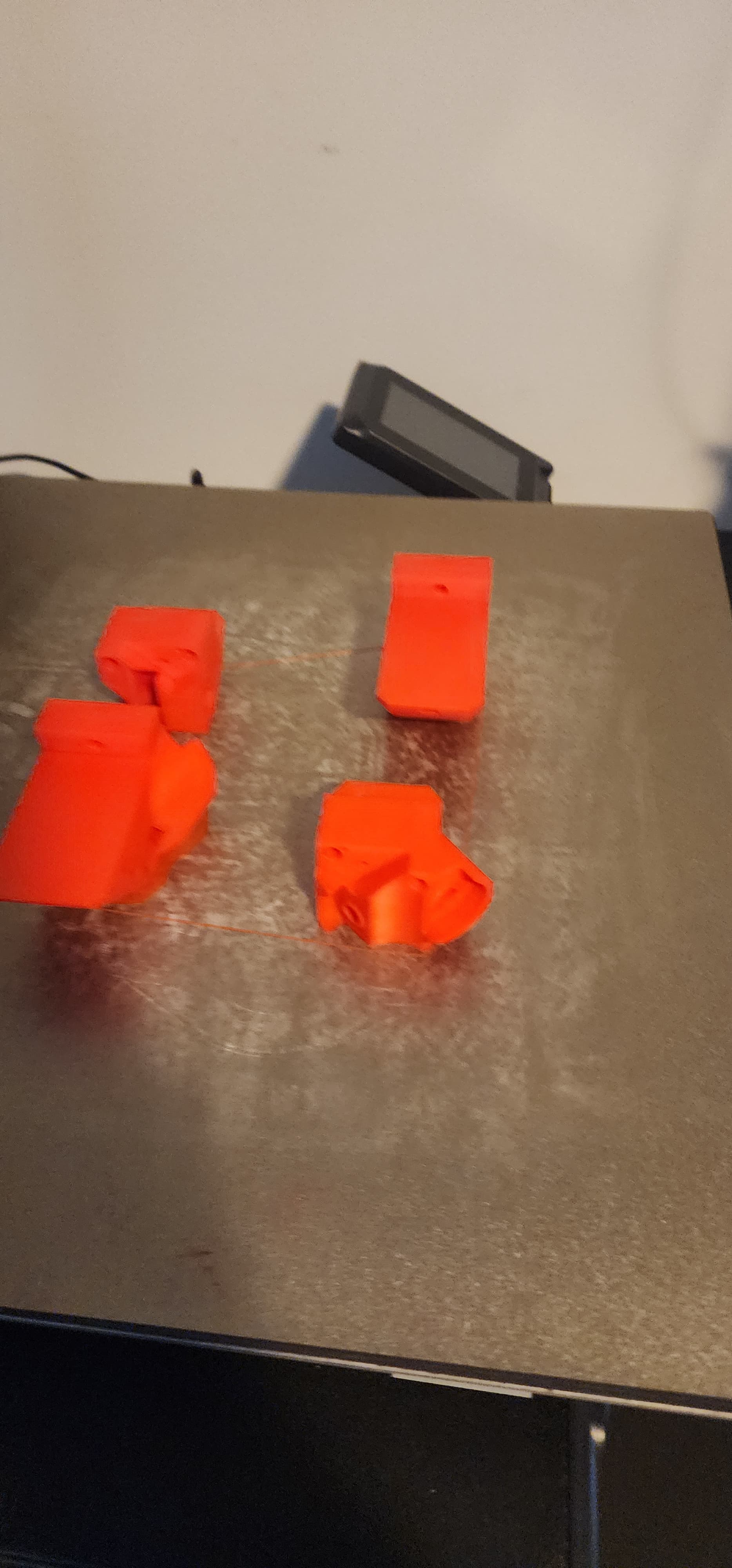

I have done it 2mm, but than I realized that it is not so important, go with 1/8
So that will be ok yeah?
That is the gap for the belt to slide down into the X min Z stub. Larger with the 1/8” will work or you can use a dremel. Either way will be ok.
Imo yes, maybe @vicious1 can confirm that
It’ll be fine.
Thanks, they printed nicely, so if 15% is OK, I’d rather move onto the next parts :slight_smile:
If you have problems later, those are possibly the easiest to replace!

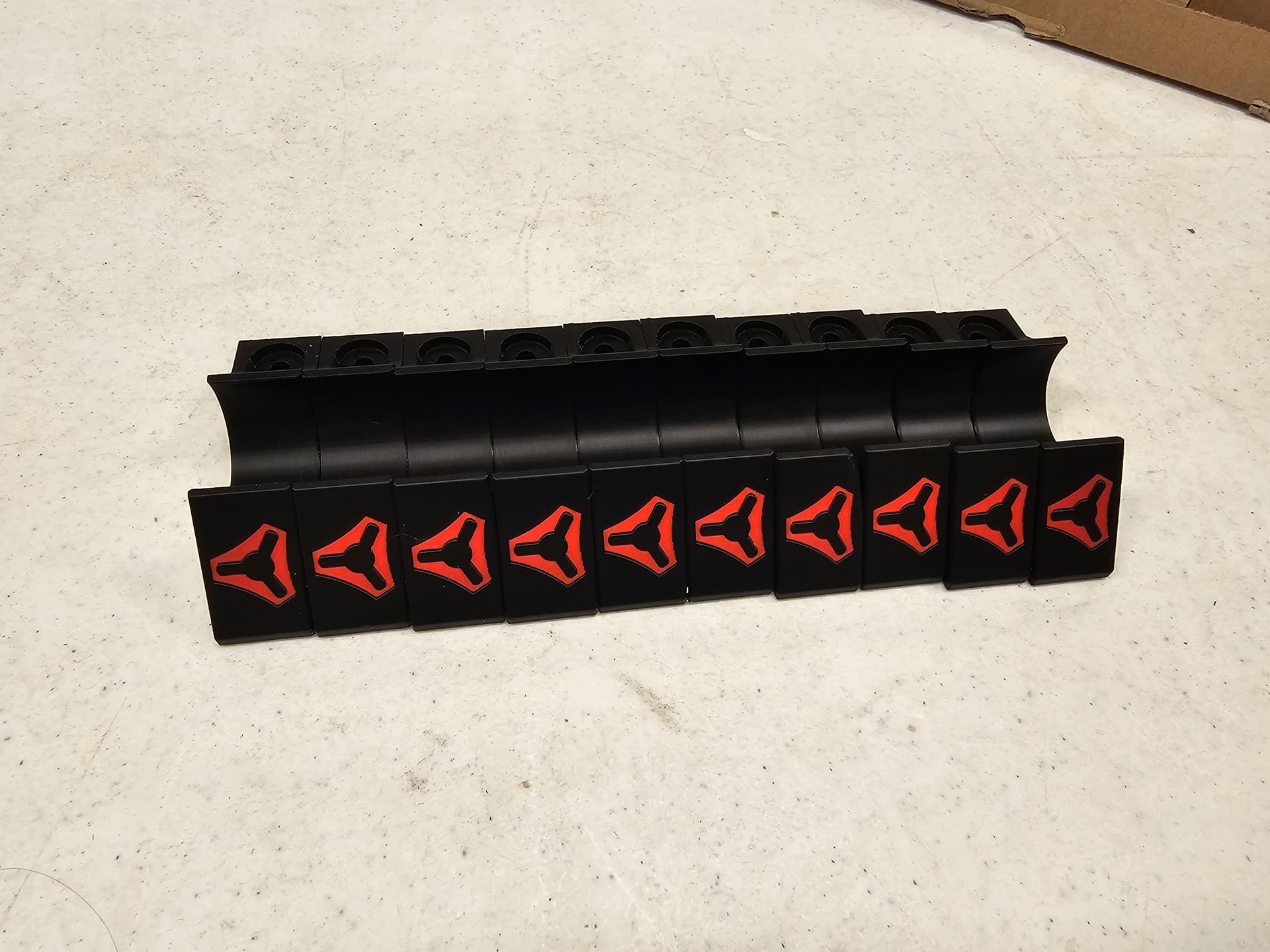

I’m surprised you didn’t print everything all at once on that Big Boi plate!
Hey ryan, you need an LR4 3d printer to print out a ton of parts all at once. one 4x8 print bed, voilla! Set it to print a row at a time so the lr4 can go up and down. A row of cores for you, and you and you :slight_smile:
And for that you can connect a 10 kg roll :slight_smile:
I do need to start getting some larger rolls again.
These days, I bet the mesh bed leveling is good enough to easily do a 4x8 bed now, but I don’t think my power grid could handle it.

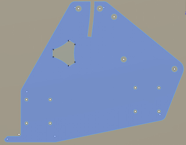

I used the LowRider to cut the wide part of the slot, and used band saw to cut the narrow part of the slot.
