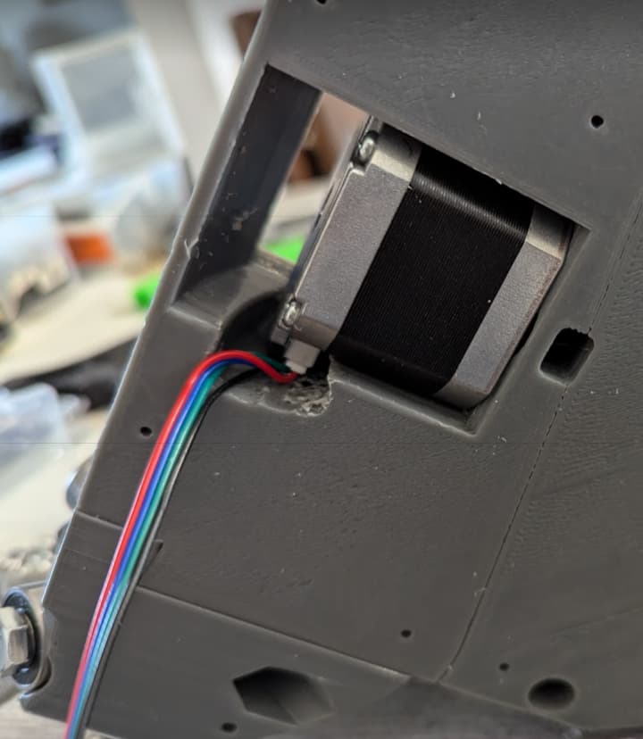

I was sure this had come up in the beta process. I remember measuring the motors that I have with this style connector, though admittedly after that measure, I didn’t try to fit them in the YZ plates. That 5.08mm measurement looks really familiar…
I will apologize now for not trying this again in the beta process. I was/am using the same motors that Ryan provides through the shop, but I have some of that style as well.
I think, however that mine are 44mm deep, and not 48mm. They were bought for a ZenXY table, and are much lower torque than I would use for a LR4.

I did this in the beta, but i used smaller motors that were not rated for the full torque and they were shorter. My gallery thread is still in the lounge because it was so far off of the norm I didn’t want to pollute the LR4 rollout with nonstandard stuff.
I used a big drill bit and “made” it fit. farmered it, hacked it… whatever. Here’s a photo:
oh and it works just fine. I’d recommend 24 guage wires for the JST-SH connectors on the motor though because getting those crimped connections on the 22 guage wire insulation is somewhat difficult to get right. the JST-XH connectors on the control board are no problem with the bigger wires that are typically used and available.
(this is like deja-vu)
I think that’s the same as I have, and the reason I didn’t try to fit them. :man_facepalming: The connector is the same size, but on shorter motors, wrong place…
This is on the beta version - first draft with all the spare parts and extra filament I had to build it. the second one I built - RC3 - had the V1E motors from the shop and not the spares… trying to build to spec.

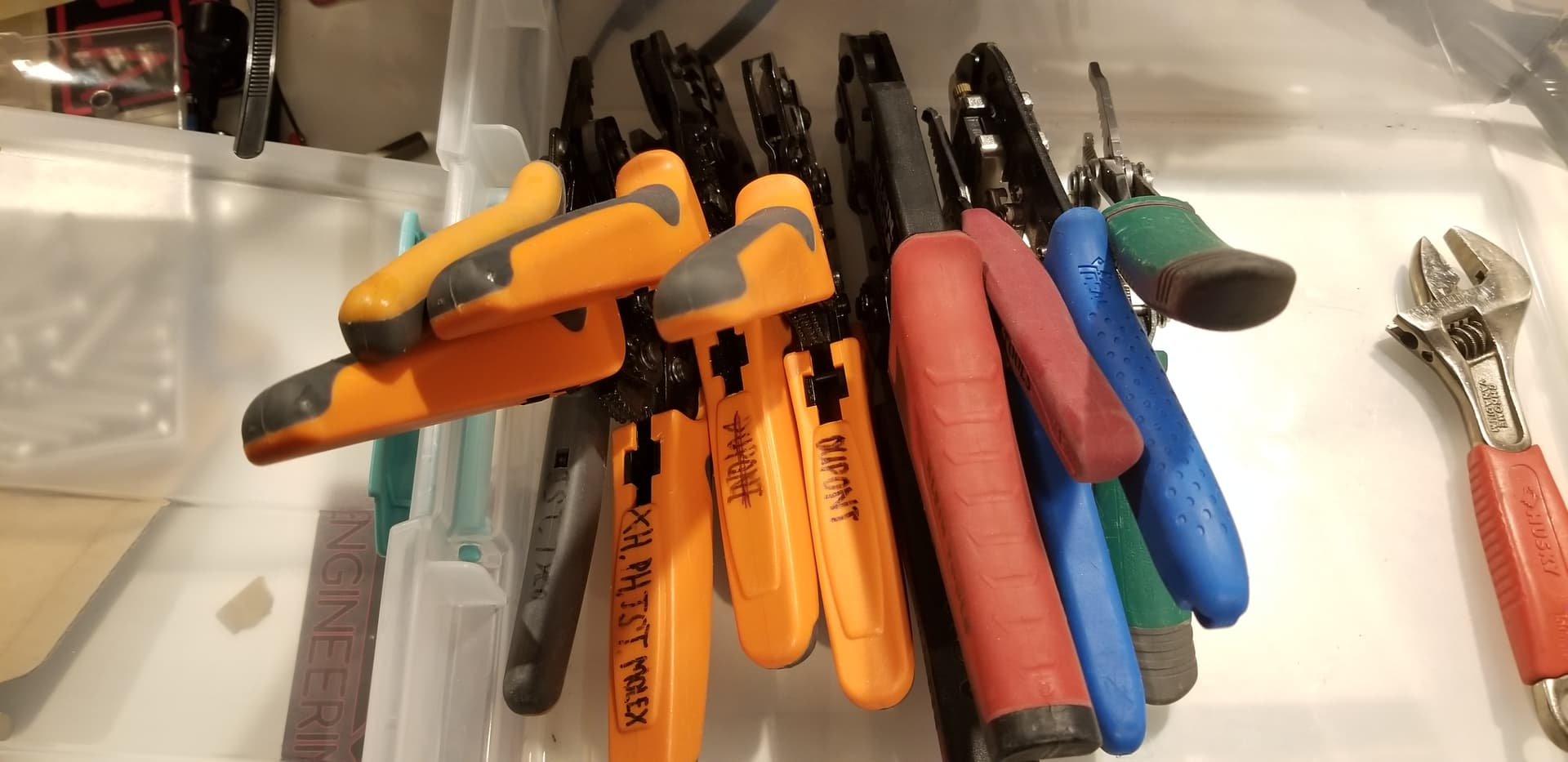

Been using SN-025 Dupont Crimper recommended by Jamie with 22AWG for low stress crimp experience. Some pros and cons…
I have the sn-28b I believe… either way, my fat mitts and those small connectors don’t do well. JST-XH → 90+% ok. JST-SH → ~50/50 and painful to fix.
Used to use SN-28b (the striked through crimper in pic below), but would struggle and curse almost every time when trying to get crimped connector to fit in the plastic shell.
Life’s been so much better since switching to SN-025 for crimping 2.54 Duponts
Jamie has some great details and pics in this post.
