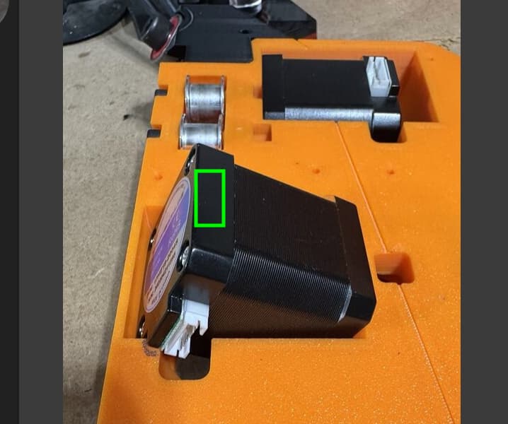

What you can do is rotate the motor so that the connector faces up, and then route the wires across the motor and down into the cable routing slot.
Put the connector oriented where the green box is in my markup.

It’s not an option, as I mentioned in the previous post, the connector will obstruct the Y-axis belt.

If I had bought motors that didn’t fit, I’d probably be busting out some side cutters and hobby saws and modifying the entry to the cable routing slot so that I could fit the motor in.
Probably you are right, I will.
I’ve sorted it with the Dremmel, just sanded it down.

With the wires plugged it do they fit the channel that is there, after you chipped away that little corner?
Not sure if I should make a bigger hole, or just make a not they don’t fit.
The wiring fits fine. I’ll take a picture tomorrow when I’m back in the garage. The notch is necessary for the metal plate beneath the connector.

How about warming it up slightly with a heat gun to soften the opening a bit so it could slip in. Not sure if that would weaken it or cause it to deform permanently.
