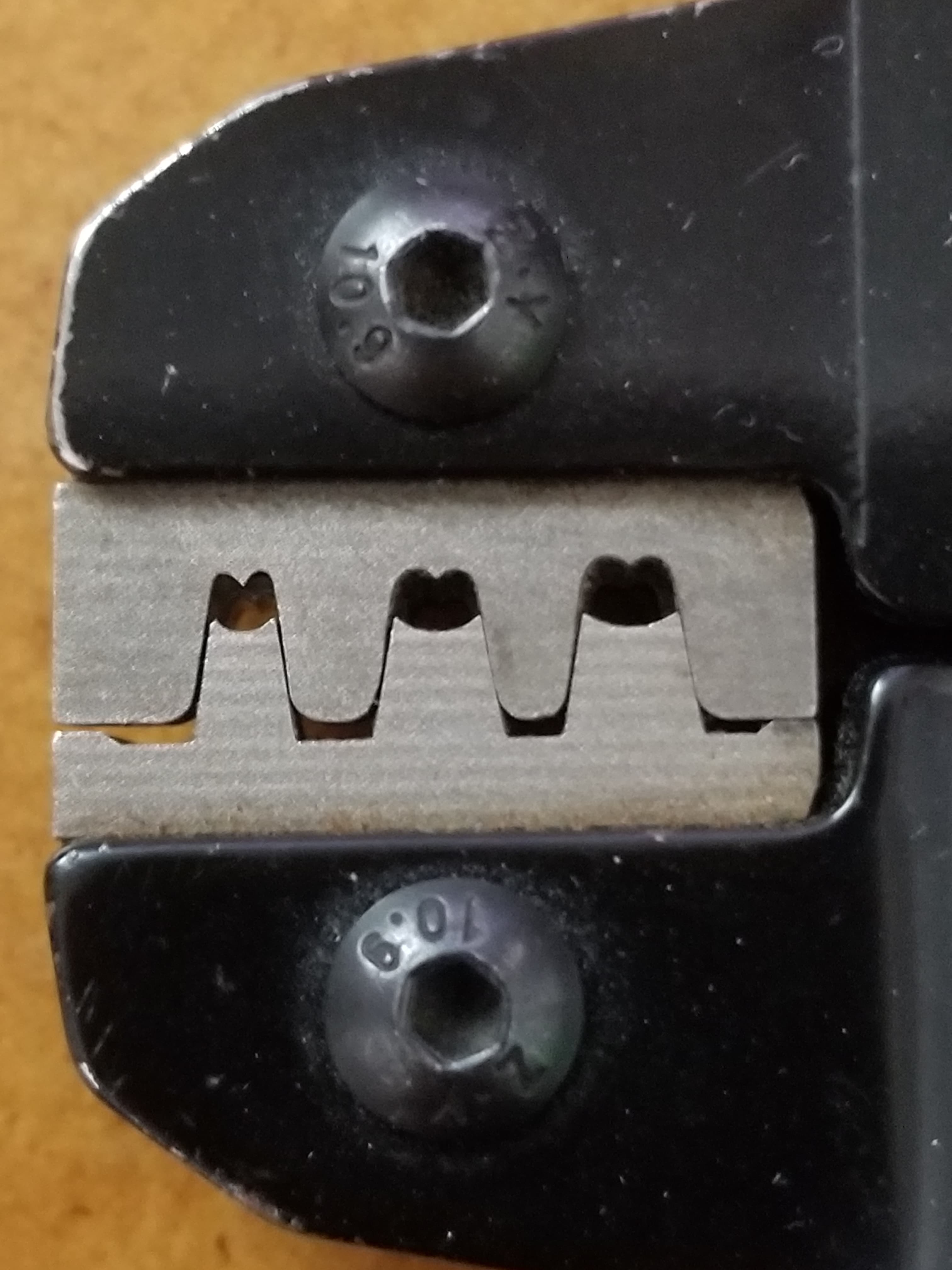

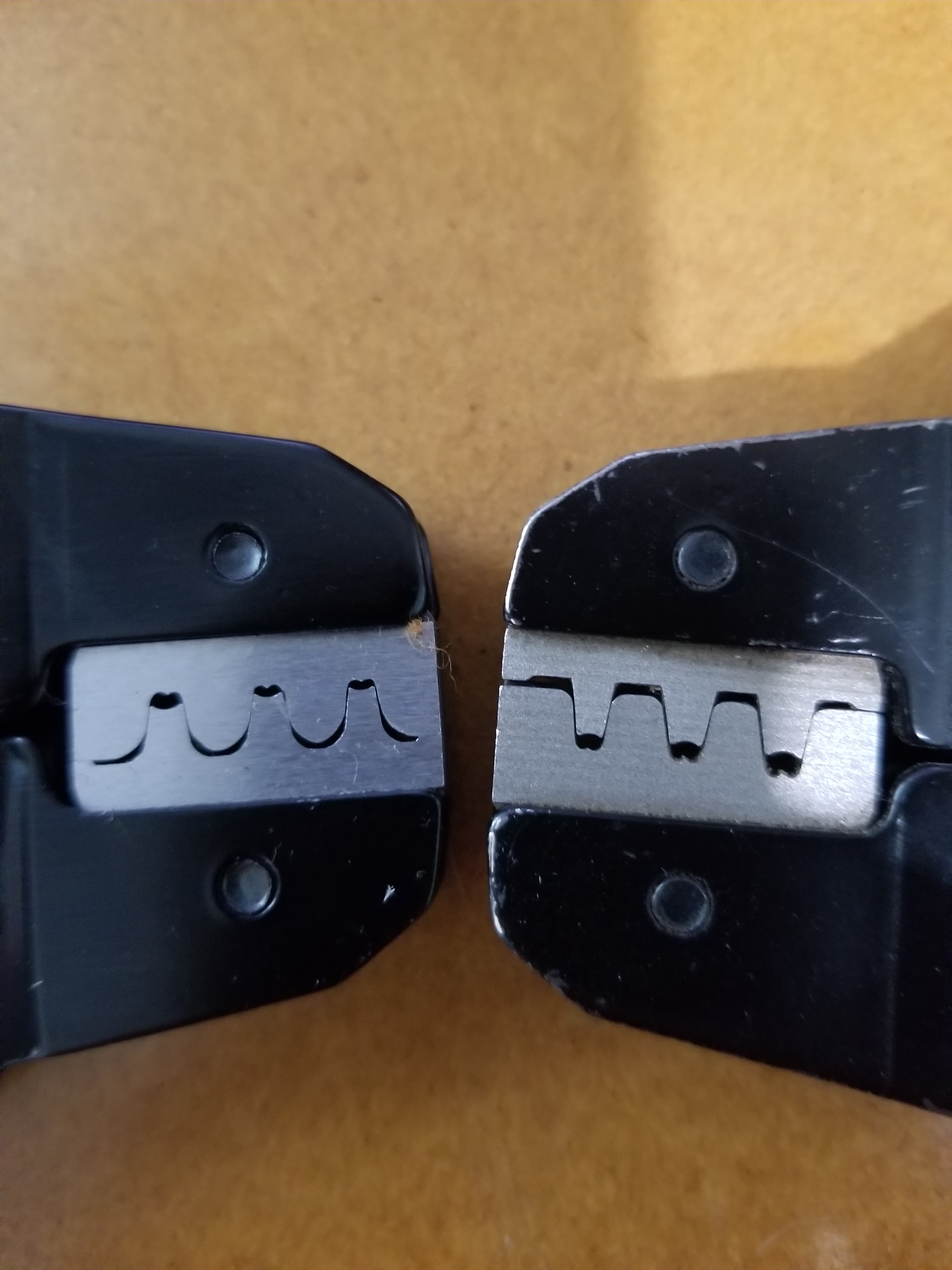

Based on some reading, it sounded like the SN-025 is the correct tool, so I got one to find out. This is the one I got.
It’s not any more expensive, but you have to look specifically for SN-025, rather than just looking for “a crimper” which will usually get you SN-28B.

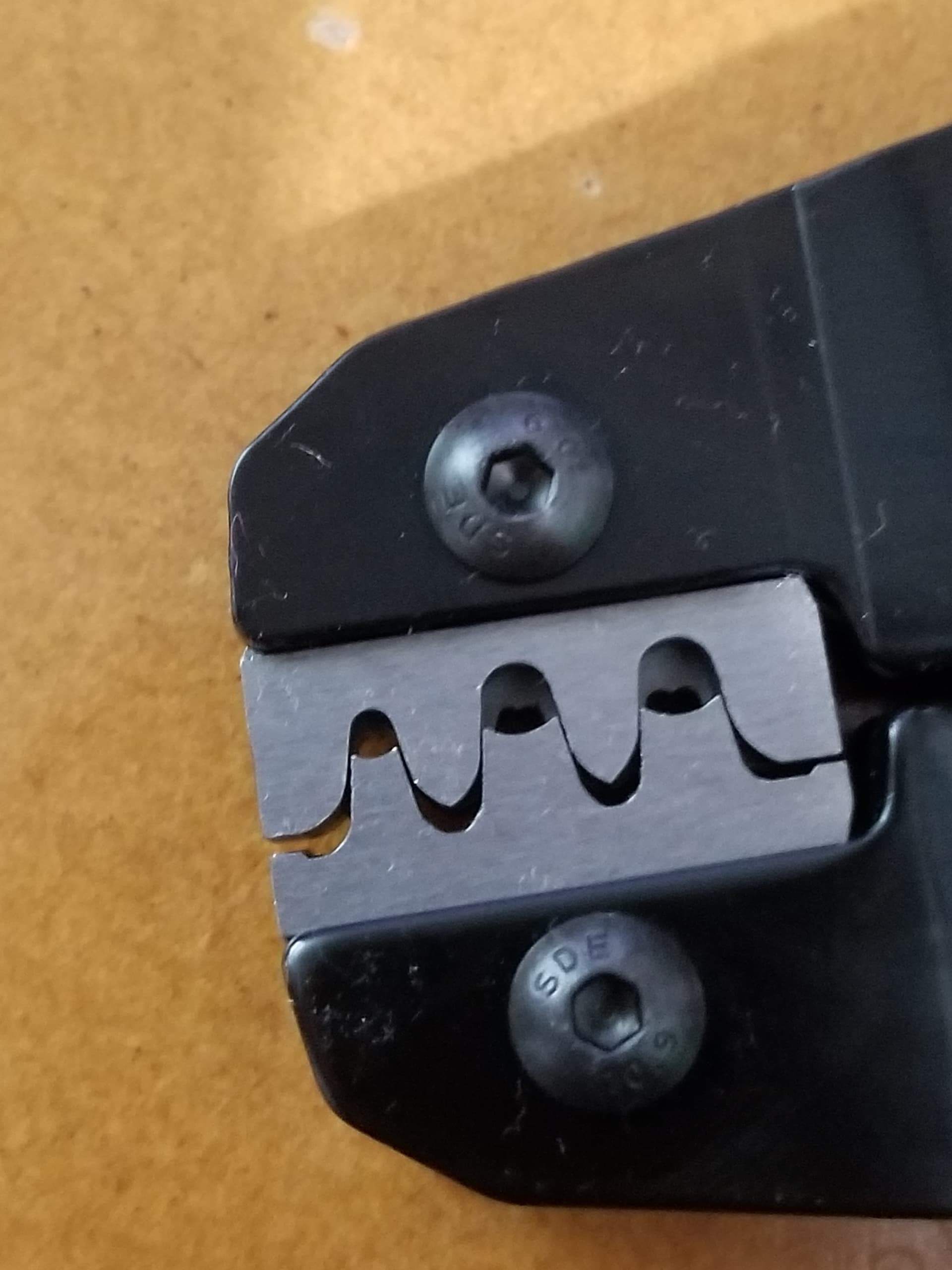

One obvious difference you can tell from looking, is the crimp on the insulation is “O” shaped rather than “B” shaped.
SN-025 (good):
SN-28B (bad):
The “O” shaped crimp on the insulation solves the problem of being too wide to fit in the housing. I tried several times and so far it’s 100% success in fitting in the housing the first time.

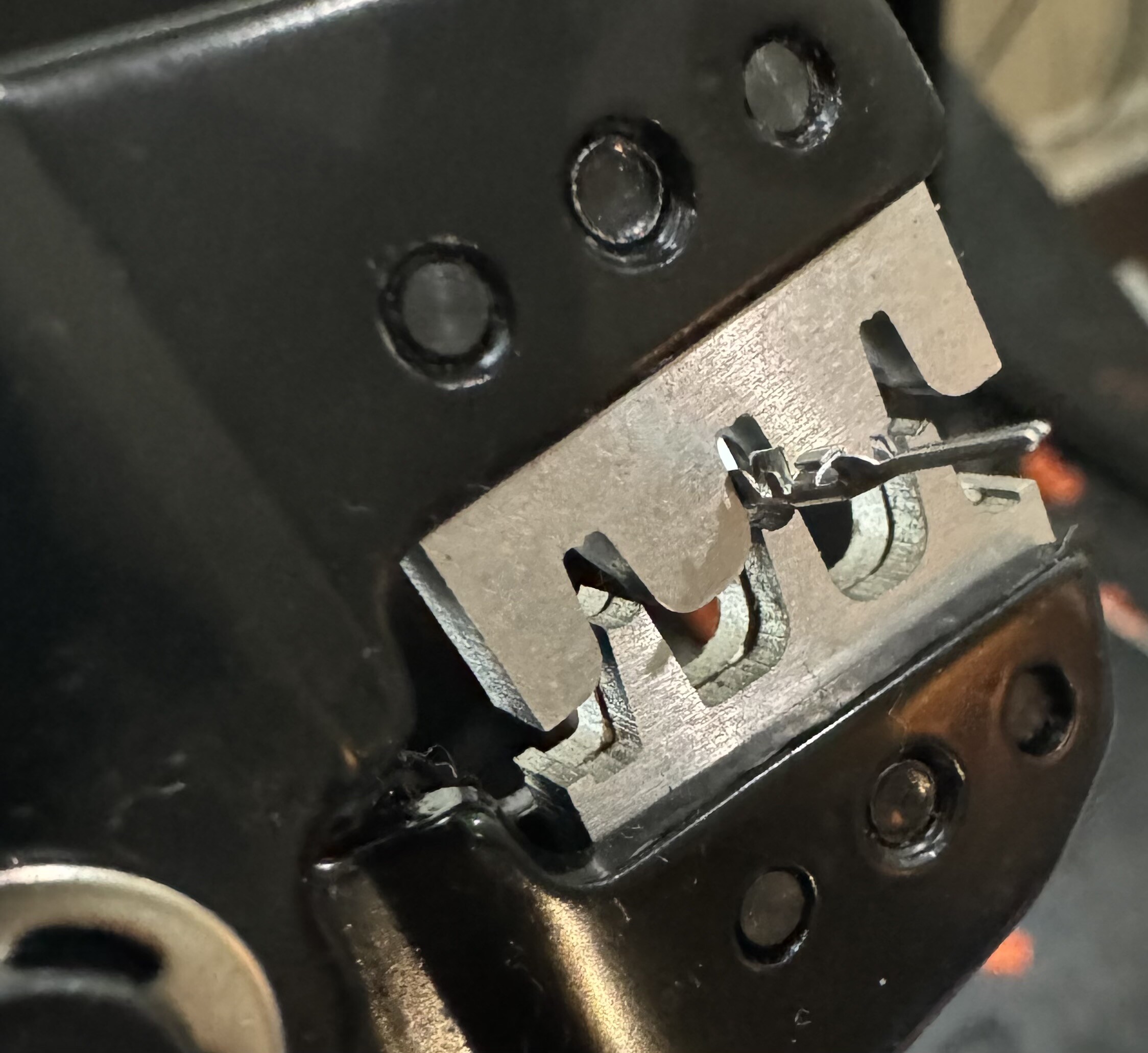

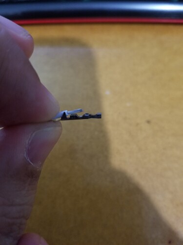

The second difference is the crimp on the wires is much tighter.
Left side is SN-025 (good) and right side is SN-28B (bad). Both are clamped all the way and the good one is visibly much tighter.

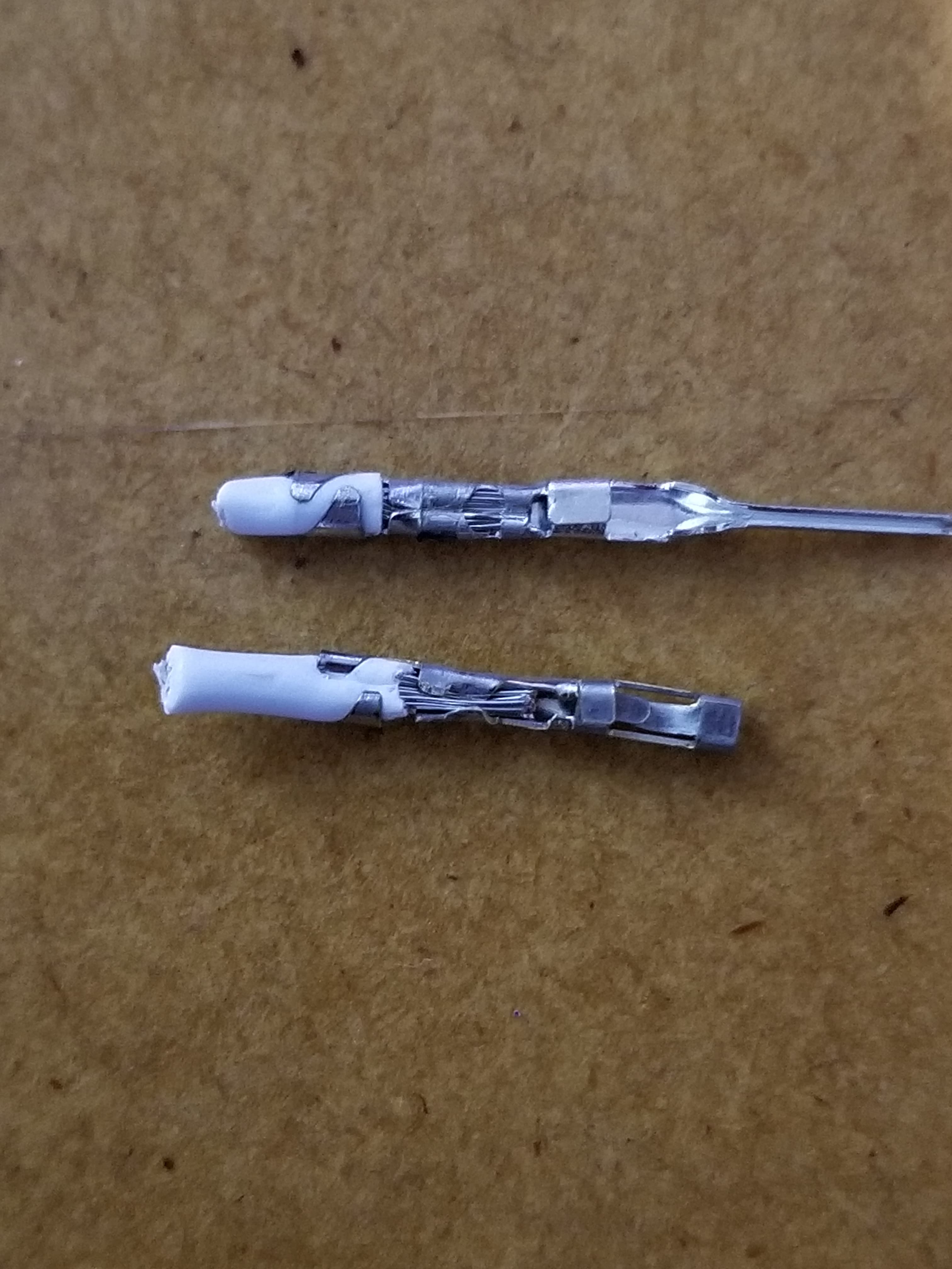

Finally here is a side by side of the results. Top result is SN-025 (good) and bottom result is SN-28B (bad). The good one wraps the insulation nicely and the bad one sorta grabs, which maybe is ok but it’s usually too wide. The crimp on the wire is the bigger difference where the SB-28B (bad) sorta halfway grabs the wire but just barely, whereas the SN-025 looks and feels much better.

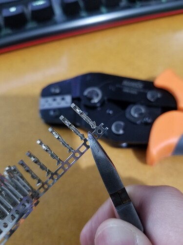

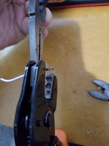

There is also something if a technique but it is 90% the tool and probably several techniques work.
Here is what I (now) do:

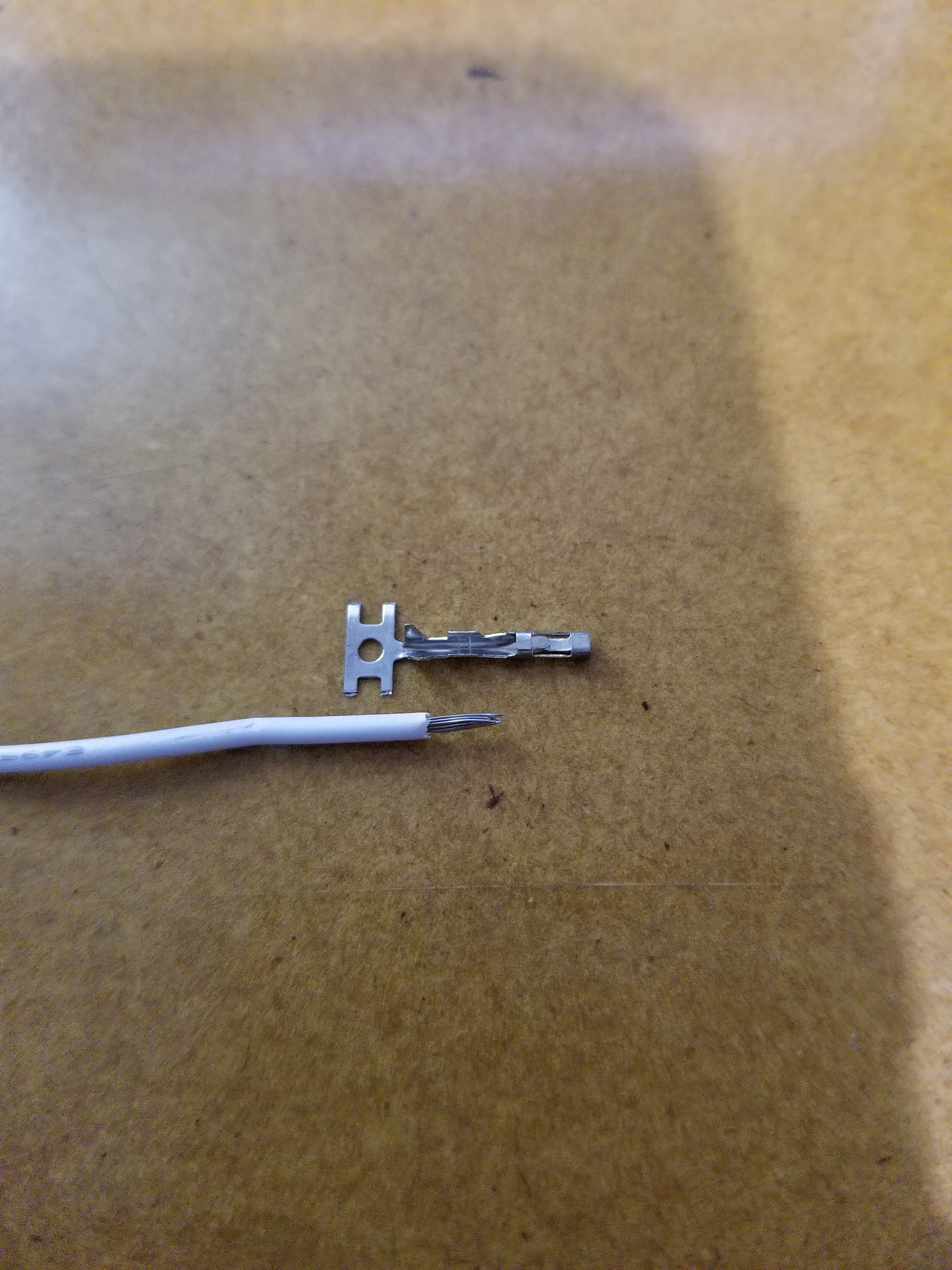

Cut the pin from the other pins with the little tail attached.
Strip the wire with just a bit exposed, approximately the length of the matching tabs on the pin. You can strip more and cut afterward if necessary.
Line up the end of the insulation with the gap between the insulation part and the wire part of the pin.
Hold with pliers (facing toward you) where the right edge of the pliers lines up with the edge of the tail.
Place the right face of the pliers against the left face of the crimpers and hold the wire and pin within the notch. You should see the right amount of the pin sticking out the right side.
Then squeeze.
This technique is just an example and you can of course do whatever works for you.
And once again, the tool makes more difference than the technique. The SN-28B will be bad even with the best technique.

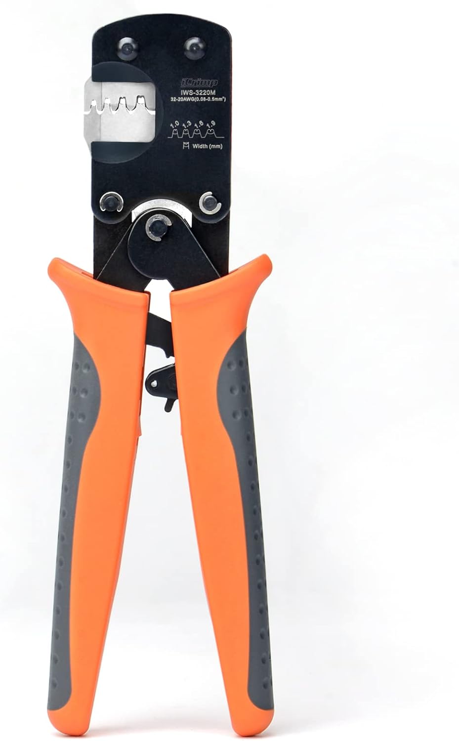

I notice that the brand on the good one you’ve recommended is IWISS, which is same brand as the crimper I have and recommend for smaller wires/connectors, which is this one: Amazon.com
iCrimp IWS-3220M Micro Connector Pin Crimping Tool 0.03-0.52mm² 32-20AWG Ratcheting Crimper for D-Sub,Open Barrel suits Molex,JST,JAE
Now if only I could find the SN-025 jaws only without absurd shipping costs.

Interesting, in the lineup, they are saying SN-28B is the proper tool for what looks like Dupont connectors in the picture. This is unsurprising given how SN-28B is sold ubiquitously for Dupont connectors.
But in the end, even if SN-025 is technically the wrong tool, it changes nothing as to what works and what doesn’t. Maybe this is where Dupont and “Dupont” connectors differ? You would think the purpose-built tool would not be so terrible on the connectors they are ostensibly made for. Perhaps SN-28B is truly the best for Dupont connectors and for cheap Chinese “Dupont” you are on your own and some alternatives like SN-025 work a lot better. Or perhaps IWS-3220M too as far as I know.

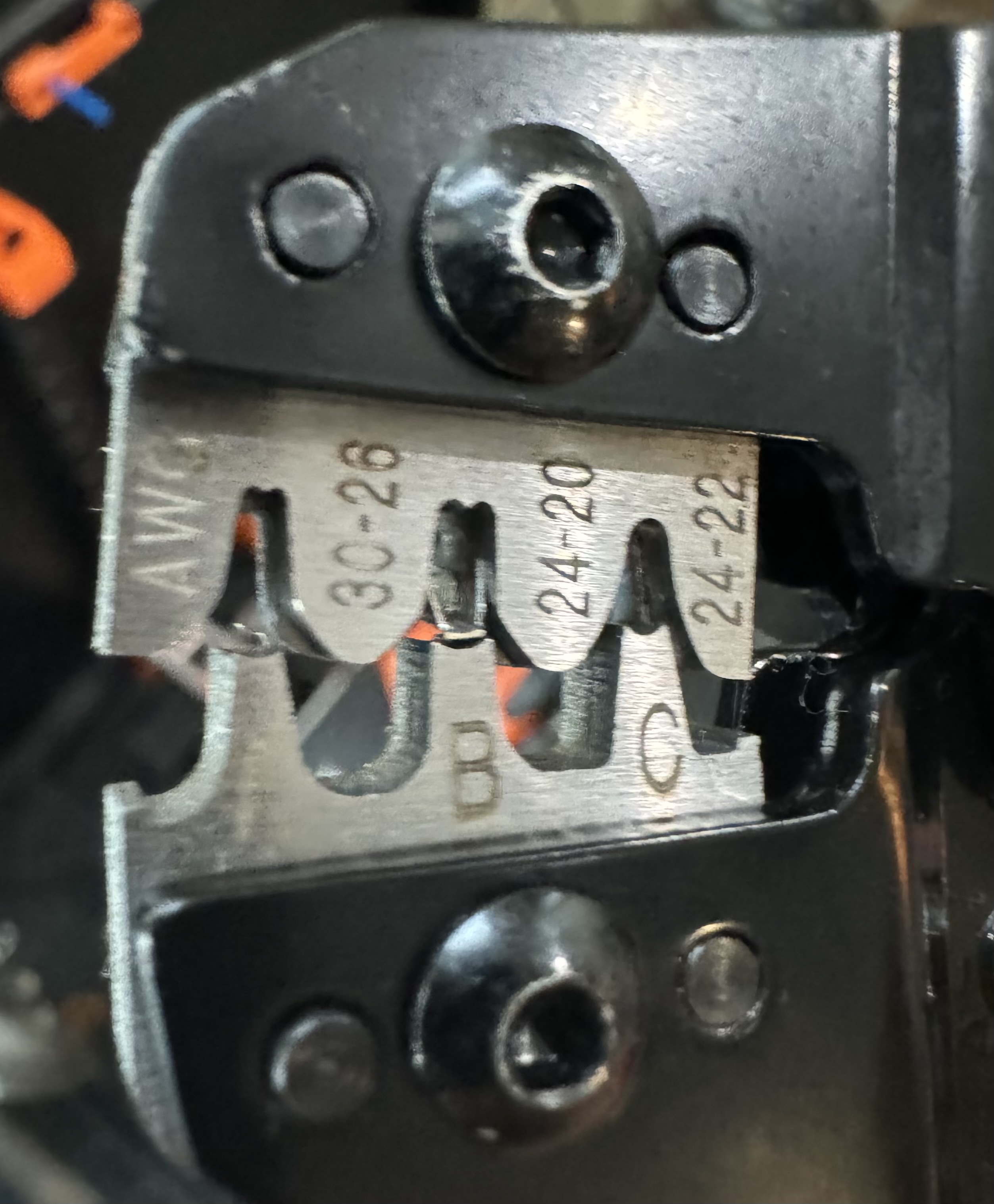

I bought my Dupont crimpers off of an RC website many many years ago with a bunch of connectors for shortening Servo cables on helicopters. I don’t know what ‘number’ they are, but they work well for me. They’re int iCrimp brand and seem to be a combination of the two crimp heads that you show.
I’ll go ahead an throw my $0.02 in here…but keep in mind that I have never crimped a JST or Dupont connector up until I bought this set to use for building my MP3DP v5
I, of course, had no idea what I was doing, and the set, of course, had no good instructions. So it took me a day or two before I was able to get decent looking crimps out of this, but I don’t really have any complaints now that I’ve “figured it out”.
I don’t know which set mentioned above is what these are, but it’s the ratcheting style people tend to not like.

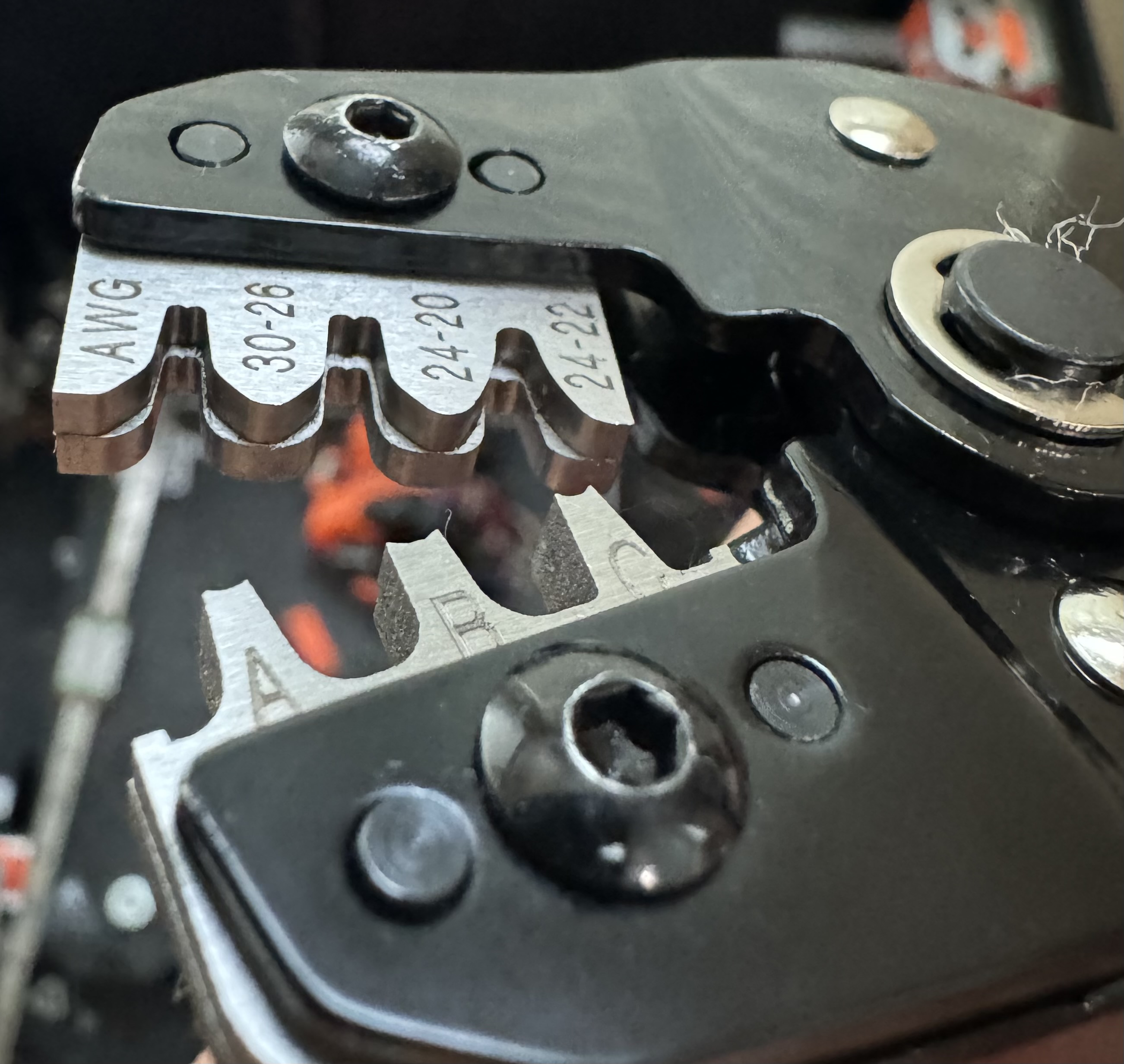

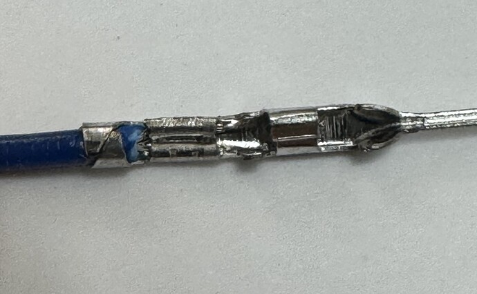

What I’ve learned to do, is to pre-load the connector in the tool, and squeeze down until it clicks once, locking it in place. I make sure when I set it in, it’s pushed as far as it will go, such that the part that wraps the wire is all the way up against the side of the part that goes smaller. It’s hard to get a good picture, but I found that if I didn’t do that, it would ruin the JST connectors by flattening out the retainer clip.
Then I stick the wire in just enough to make sure the sheathing will get wrapped and crimp.
The other thing I learned, is that I have to use the smallest hole that will work.
For instance, I have some 24AWG wire. There’s 2 options. 24-20, and 24-22.

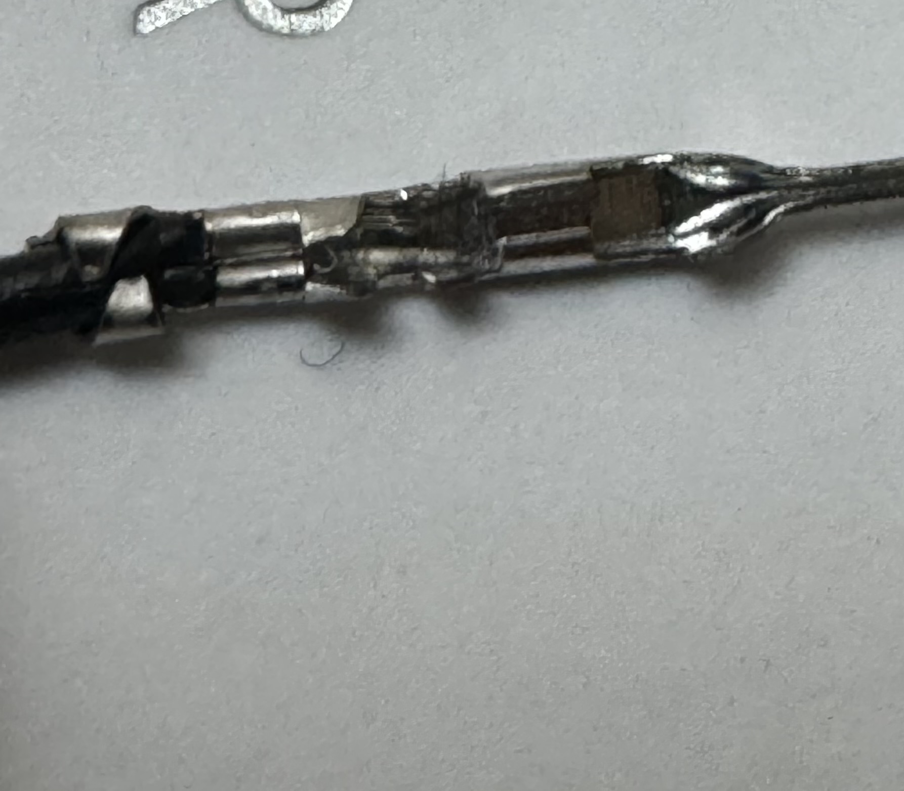

This is crimped with 24-22.
This is crimped with 24-20
I use this set for JST and Dupont and they all have been holding really well once I figured out how to make work right.
