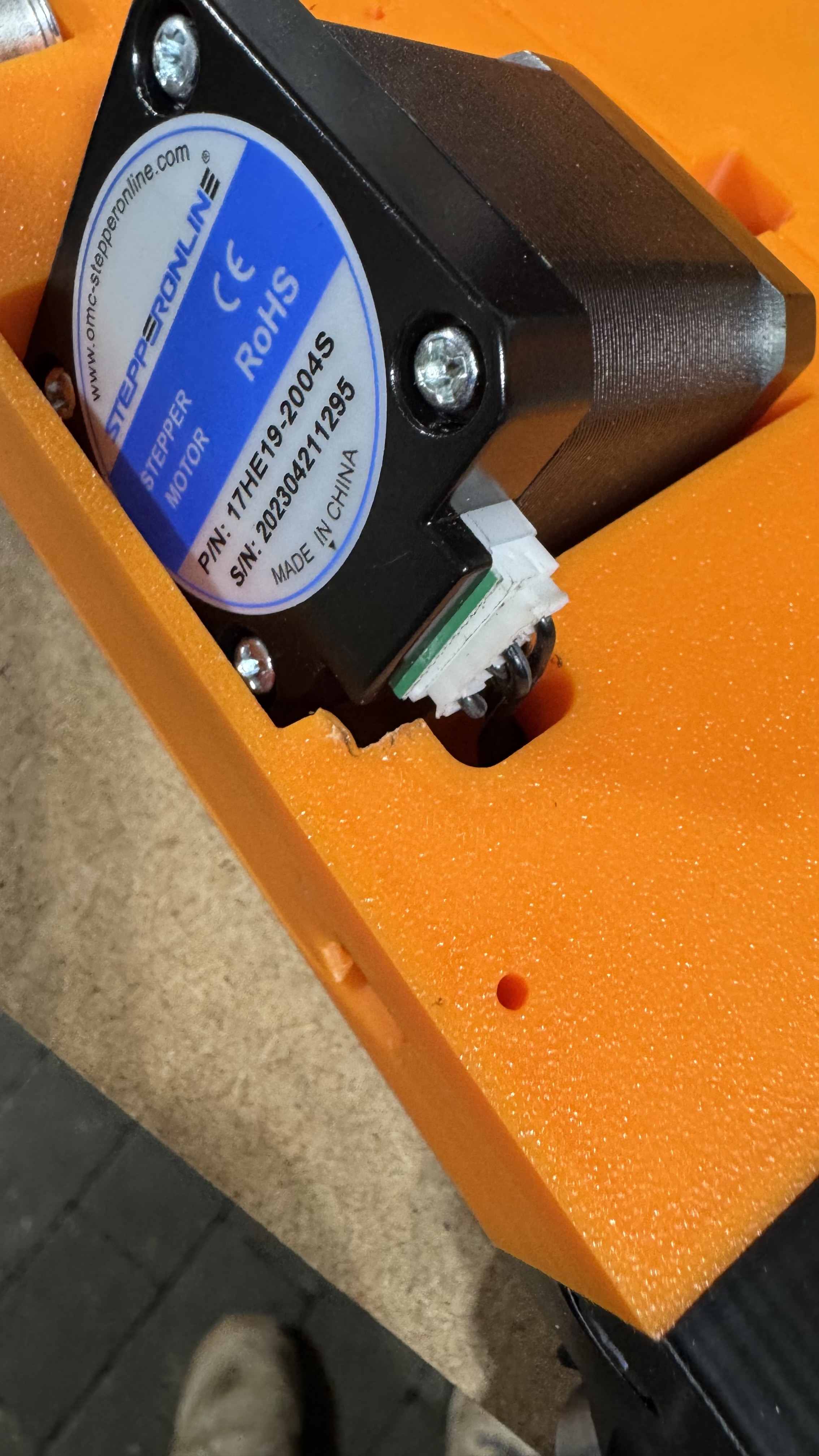

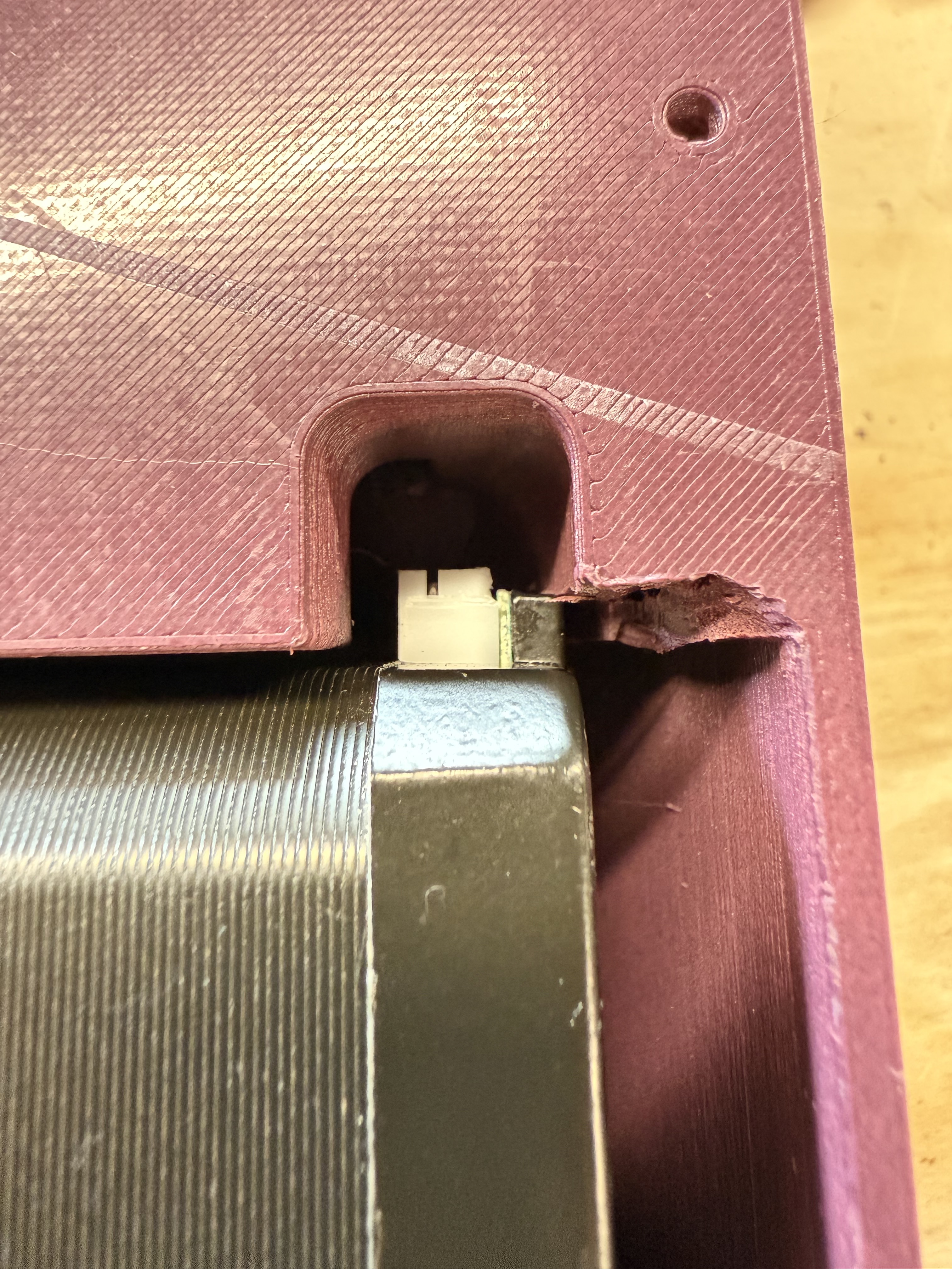

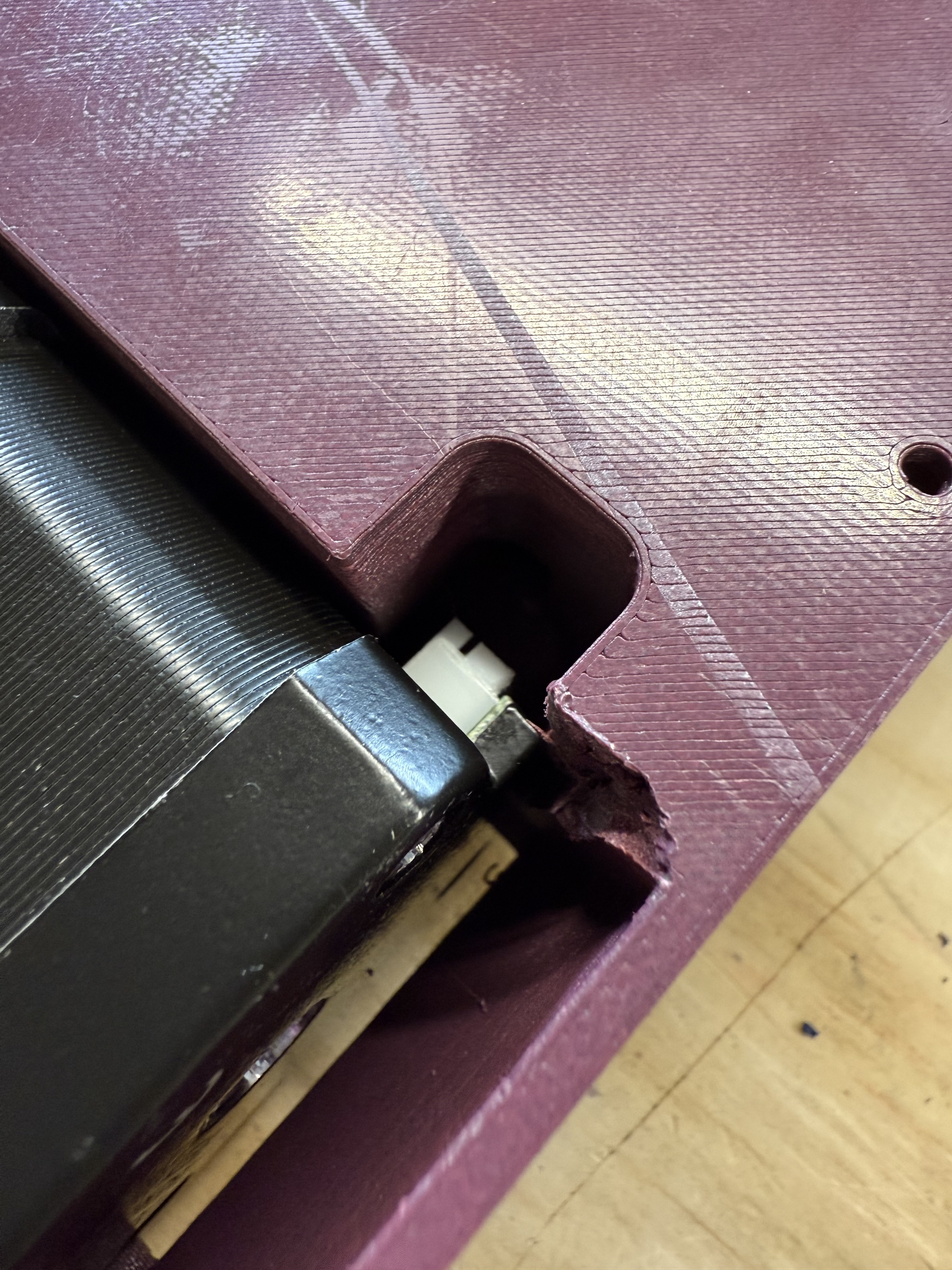

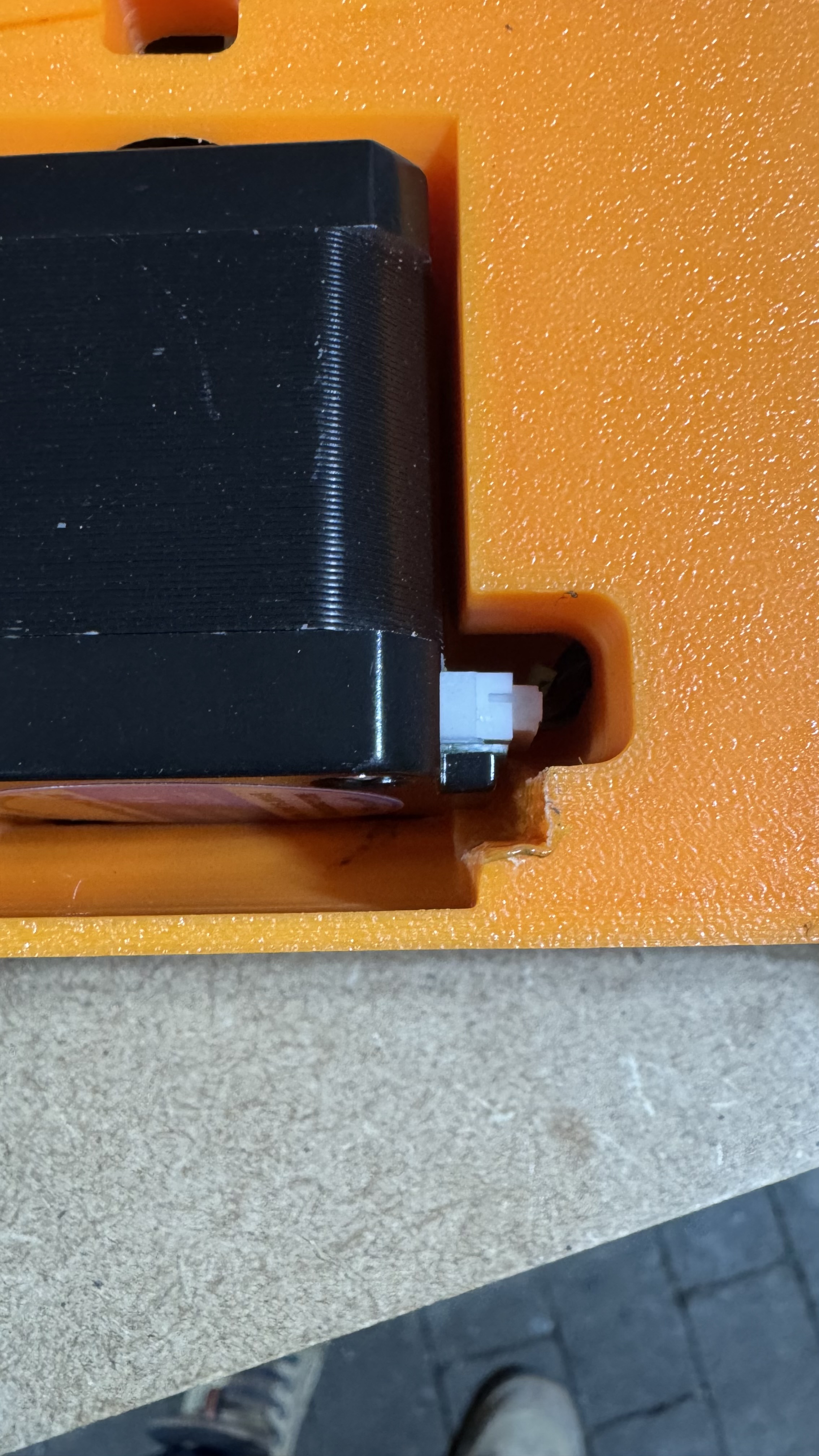

I actually started building my LR4 yesterday and ran into this exact issue. I’ve got full sized NEMA17s (LDO-42STH48-2504AC) and they don’t fit without modification.
I took a chisel to my prints and made them fit.

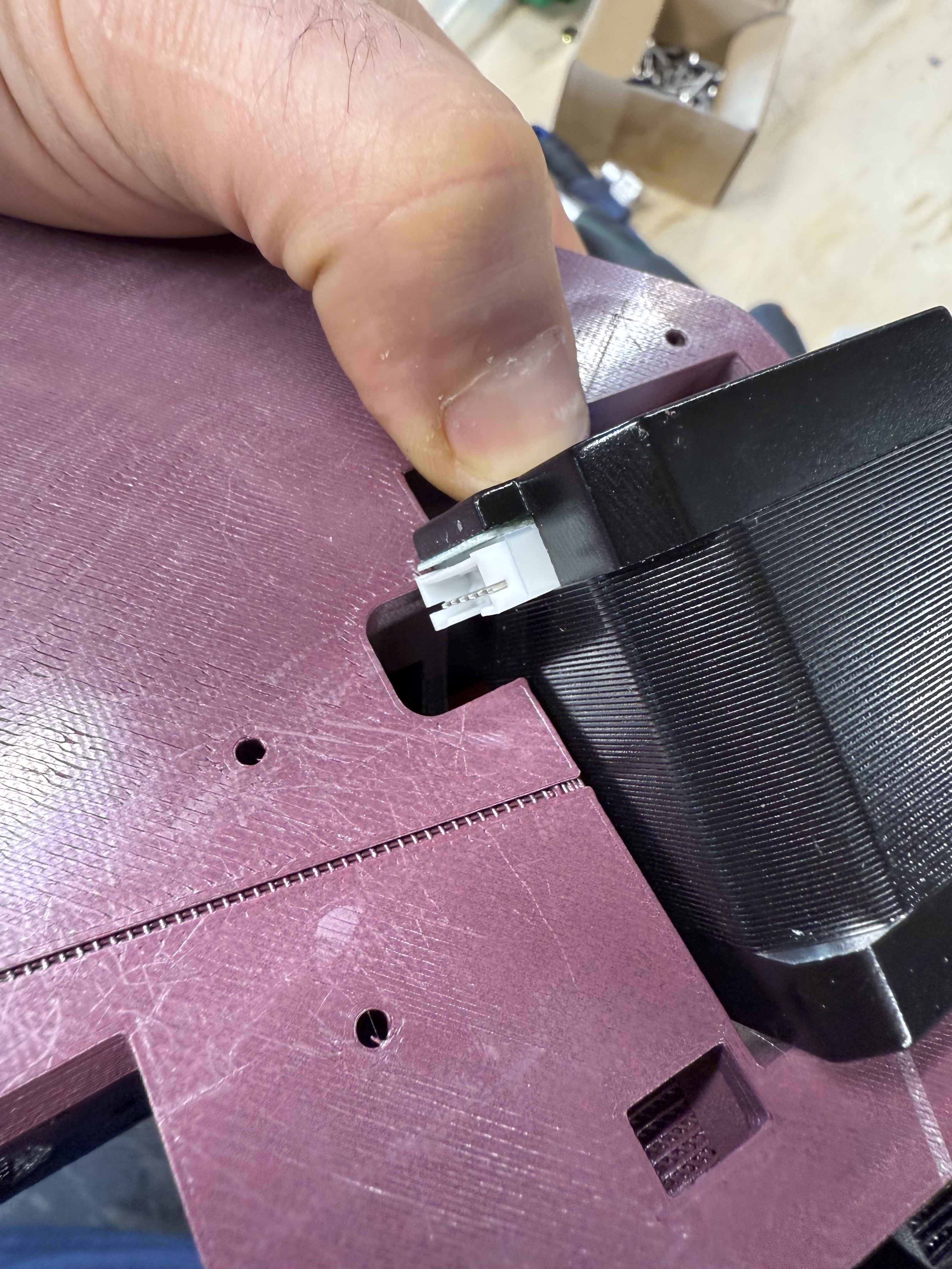

Those are the one with the extra metal bump? Can you send a picture of as close to fitting as you can. I think those need the hole opened up the other way.
This is the part that is funky If I open that hole up on both sides to fit every single side plug nema 17 I think it might be a bummer.
Yes, unfortunately, the files haven’t been yet adjusted, probably because Ryan is too busy, I have done some work on the file, maybe not the best but it works if you want I can share them with you, soon I will share some photographs with work I’ve done.

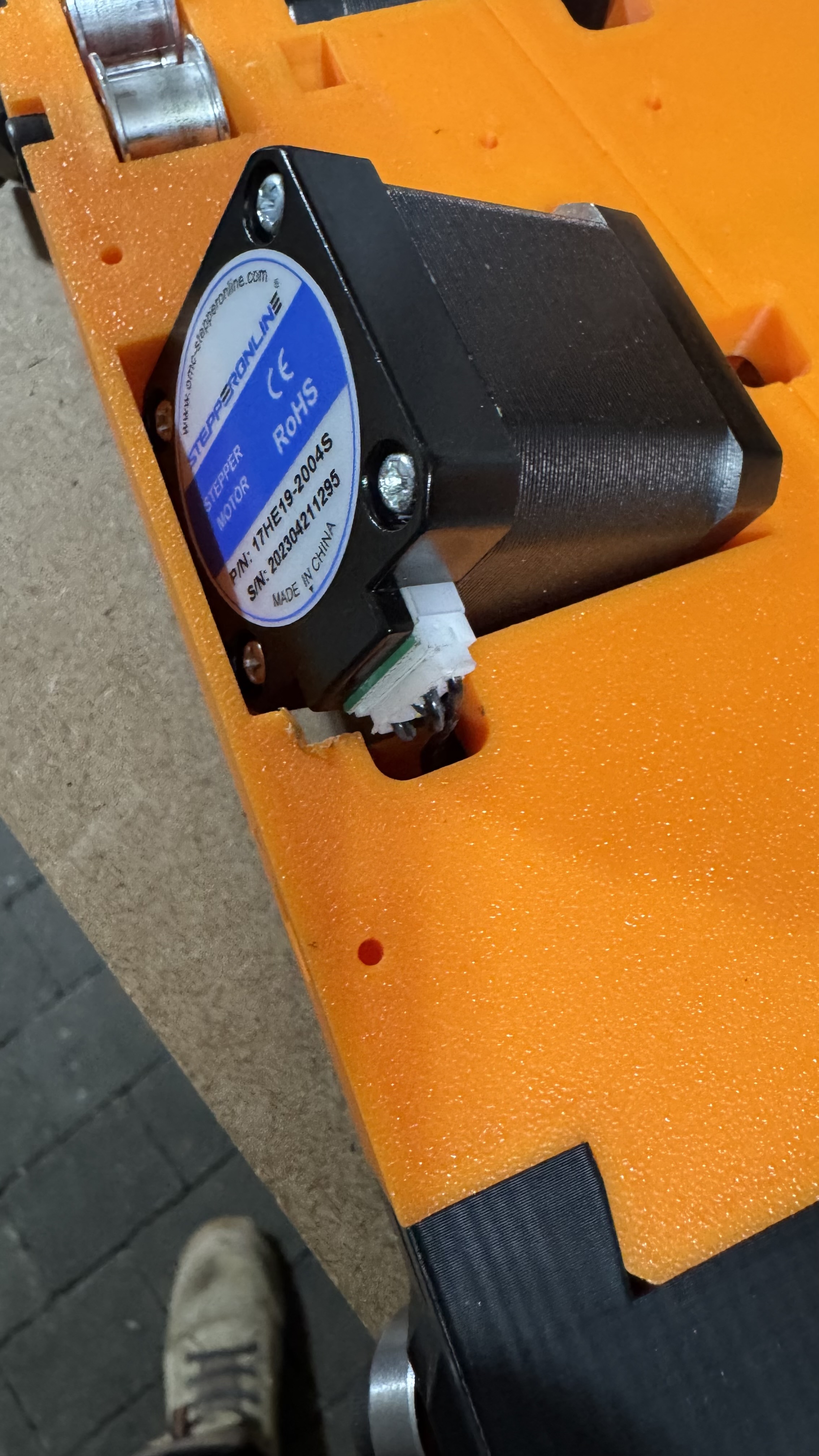

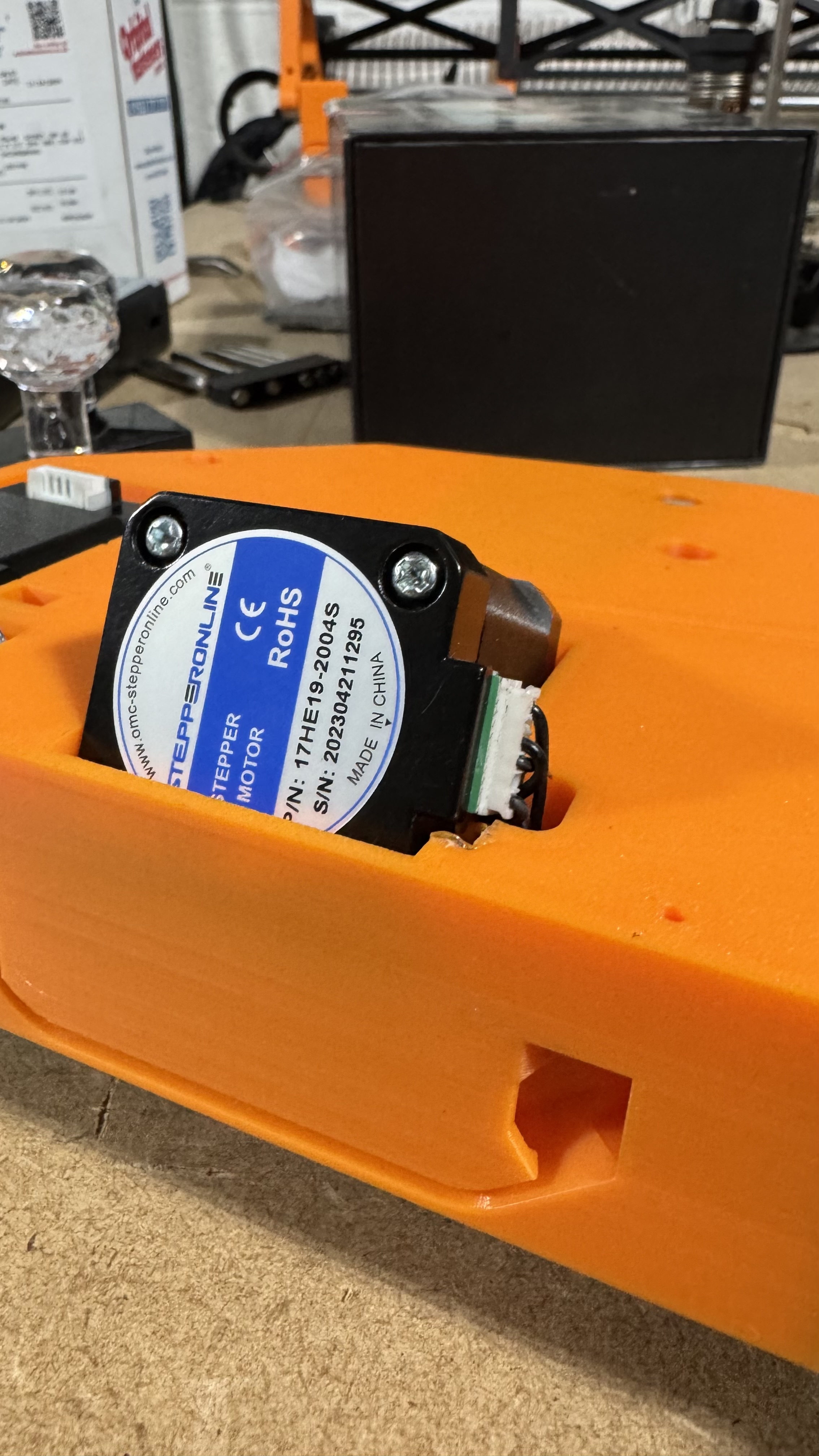

Yes, they are. My OMC 17HE19-2004S are the exact same size and shape and don’t work either.
That is so close it is annoying. No other steppers have the extra bump.

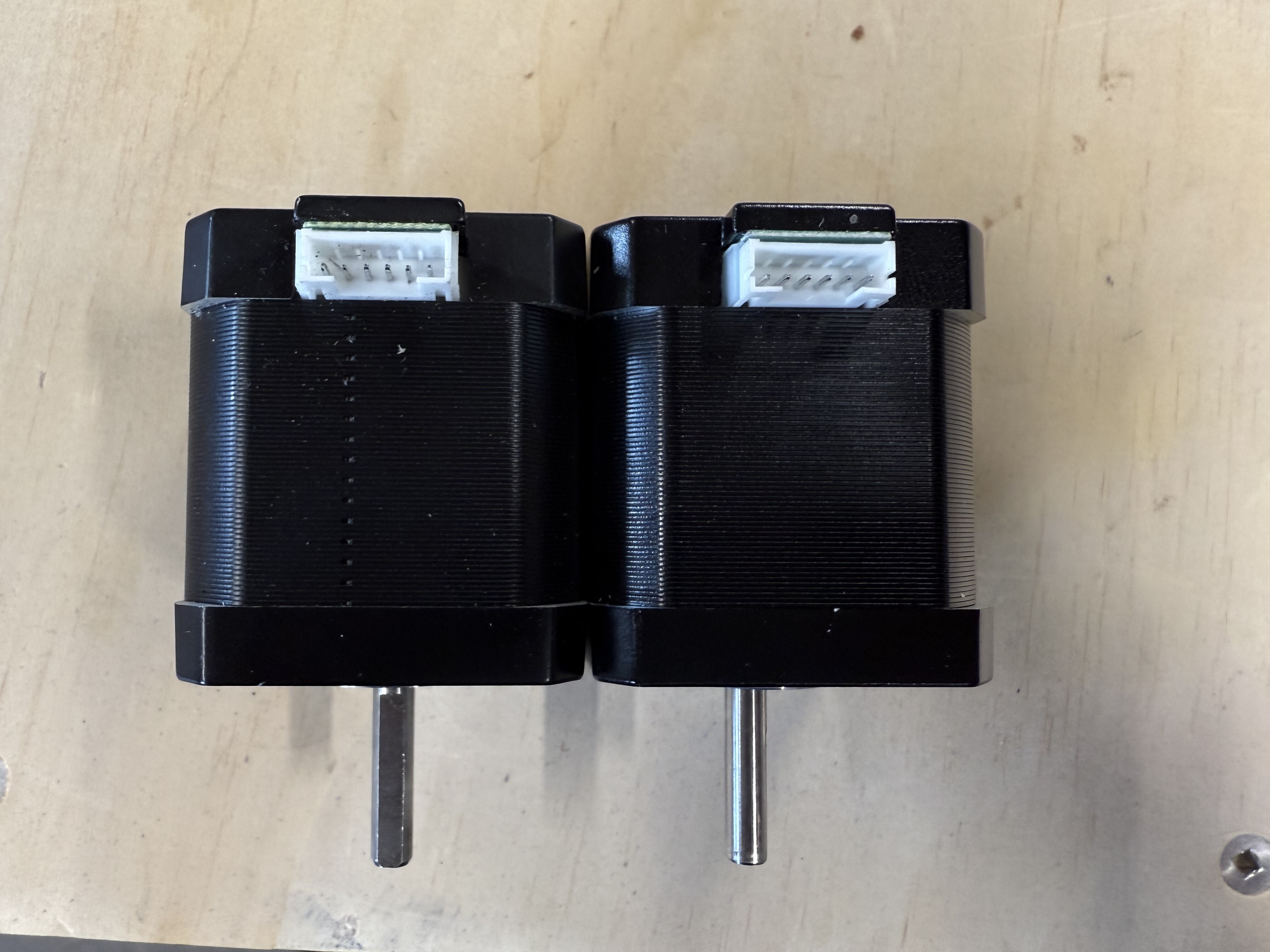

What is the distance from the stepper mounting face to the top of the white plug?
Easily I missed something but it looks to me it’s the steppers that have a plug in on the stepper itself opposed to having the wires integrated in the casing
They do, I need to add some space so those steppers fit the new YZ plates.
I thought i had posted this back in July when I made them in the lounge thread, but I just searched for it and couldn’t find it. It must be in the private group thread, so here they are:
total motor height: ~39.2 mm (not including round offset bearing seal around the shaft. that makes it more, but that shouldn’t matter for this)
Motor flat to bottom of plug: 29.5 mm ( that is to the bottom flat of the motor, but due to perspective, it looks too small. It isn’t. it is measuring the bottom of the motor closest to the paper the caliper is laying on)
Plug flange width: 16.6 mm (6 plug so wider opening) offset by ~13 mm from each side for a total motor square side of 42 mm
