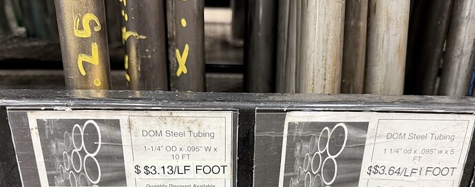

If we have our choice of tubing (29.5mm, 30mm, 32mm) which size should we do?
I think I found what I am going to use, but don’t want to assume bigger is better. This will cost me roughly $20 more than EMT conduit in my area, and they will cut it within a 1/16" for me.
Is 0.95" the wall thickness? Because if so, that’s 2.413 mm, which is really thick compared to the 1.5mm wall thickness of my 1" EMT! It will be heavy, but I have no doubt it will be very strong! I’m not an engineer, so take as FWIW, but I’d say go for it!
Yes, and that’s roughy what it measured with my calipers.
They also have a .065" and .120". Maybe I go even lighter, which is still more than conduit.
It is all basically the same price, I just don’t know which is best.
Nope, 32 max, sorry
Larger diameter is more rigid is all else is the same. Thicker walls is more heavier than it is adding strength. Once you get past strong enough there is very little rigidity gained by internal metal, the skin does all the rigidity work the thickness resists the bearings crushing it.
Weight takes away accelerations. So it depends on the work you do. Lots of carving, you might want lighter. Lots of full long cuts, no issue.
Always a tradeoff.
