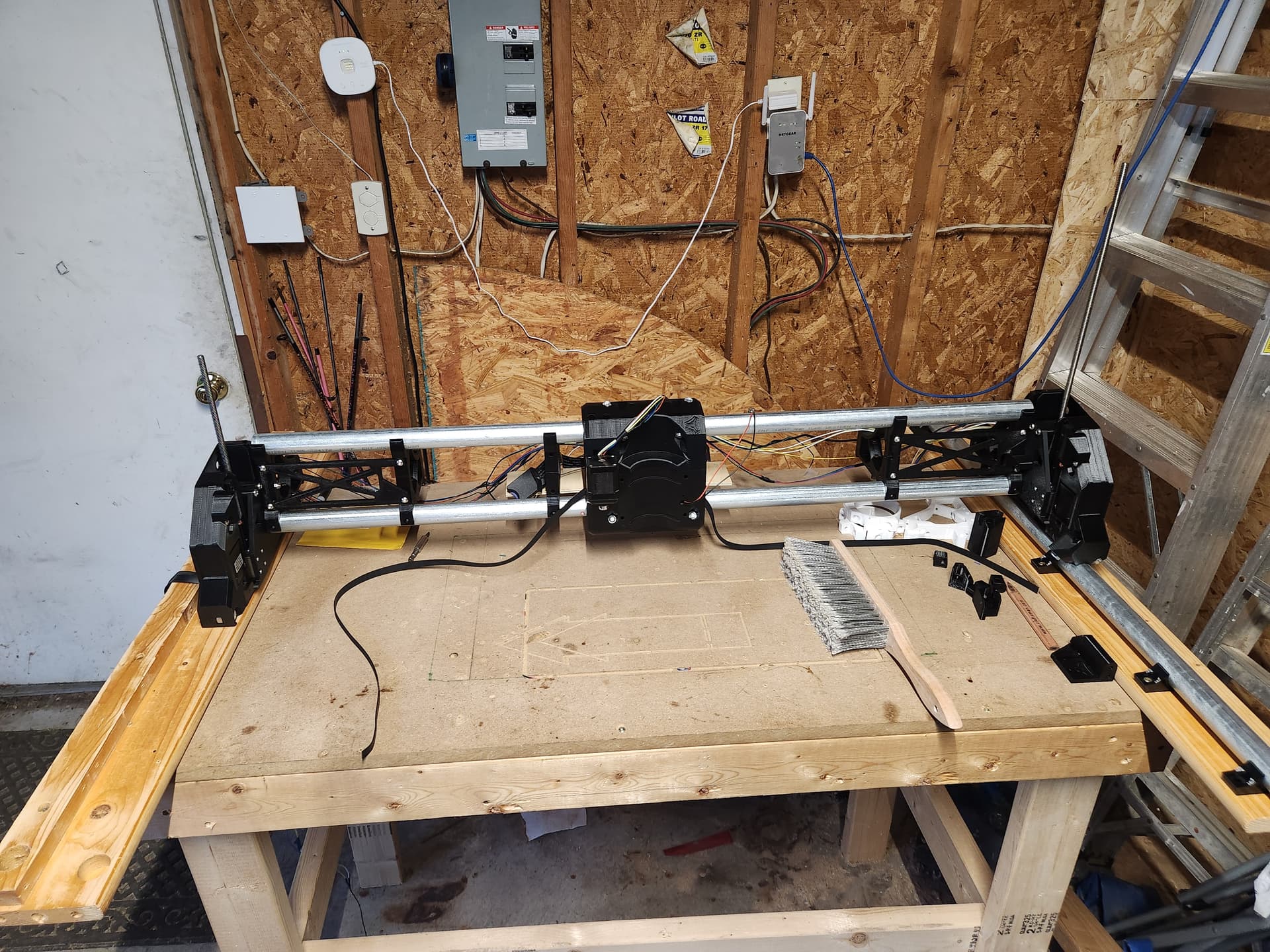

Mine is almost built, I will show it soon. I am hoping it runs this weekend.
I have it on a 2x4 table. I am at work now, but I believe my emt was 42 long. I almost, and still may, shorten it and put it the other way. I want a bigger table, but right now I built to what I have.
I can show you mine soon.

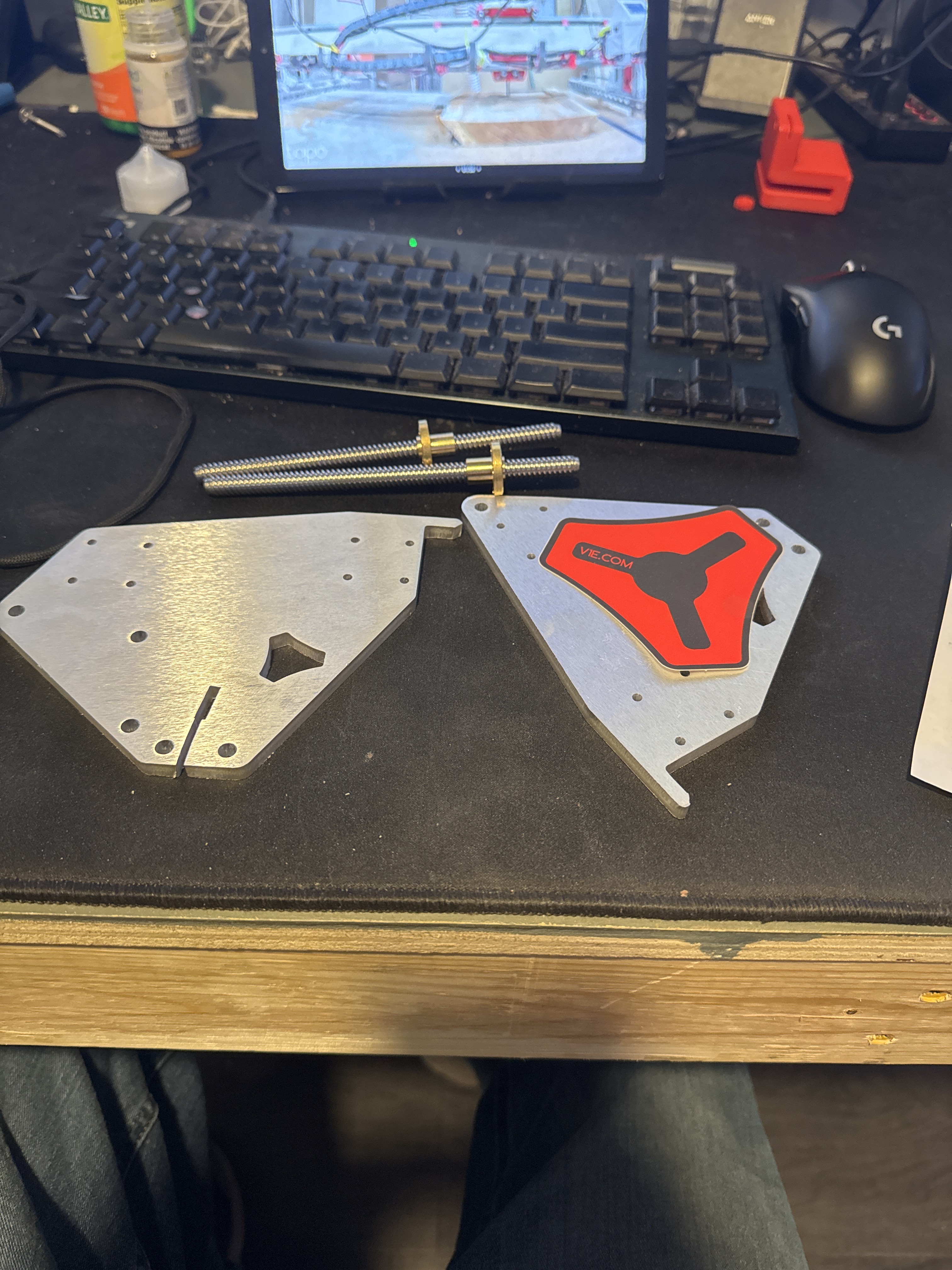

Got my upgrade kit today too!!
No problems, printed the beta and RC2 with a 0.6 nozzle and 0.32 layer height.
Fancy sticker, never seen those before!

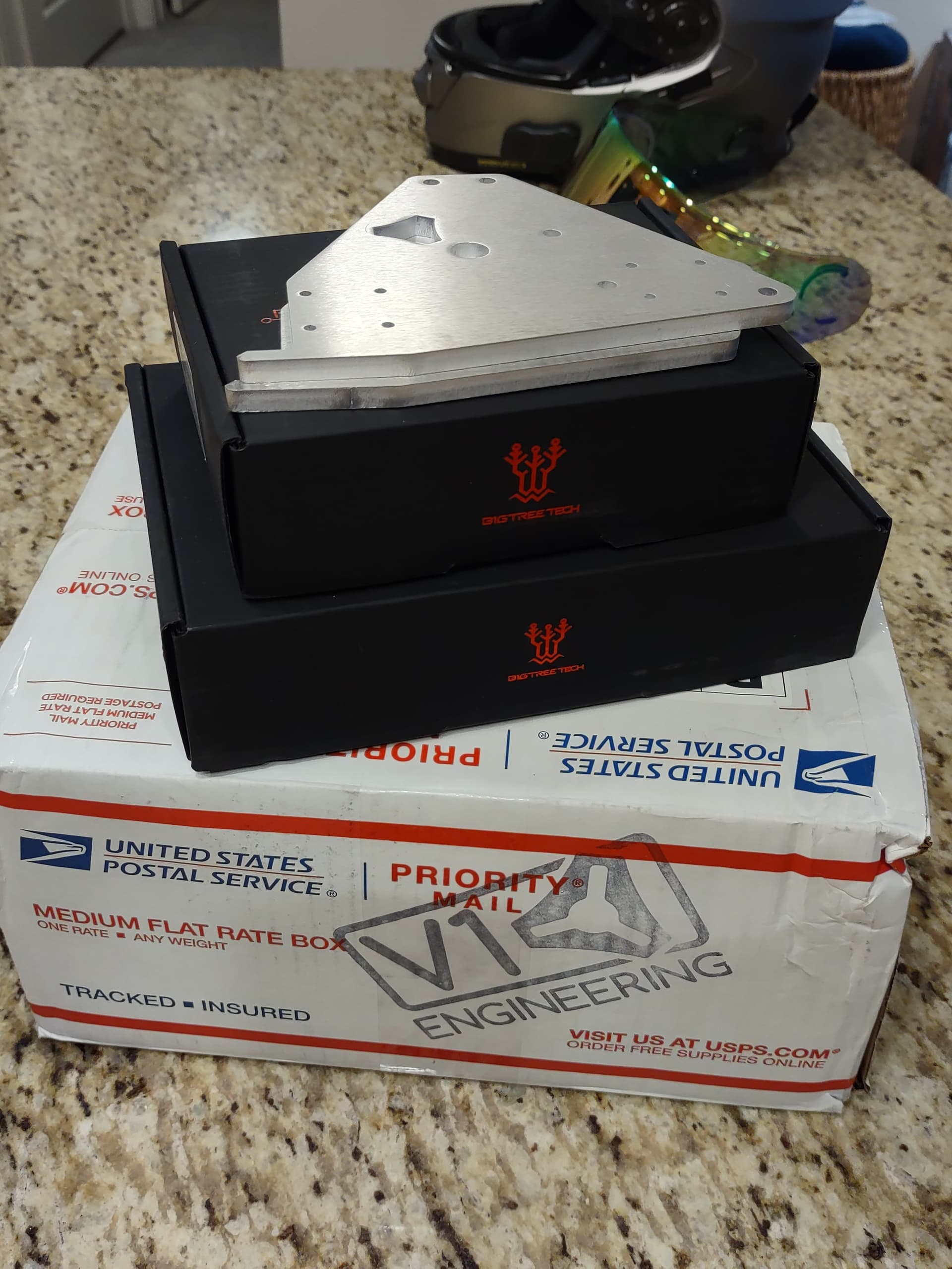

Parts arrived! Thanks Ryan! Now I have wait for some filament to come in so I can start printing. This will be the first time I’ve started up my printer since I moved, I hope nothing got throwed out of whack!:woozy_face:
I would definitely start with a Calilantern!!! For sure after moving it.

Here is mine. I am so close now.
Did you go 4 X 3 Y?
Are you planning to expand or do fullsheets?
