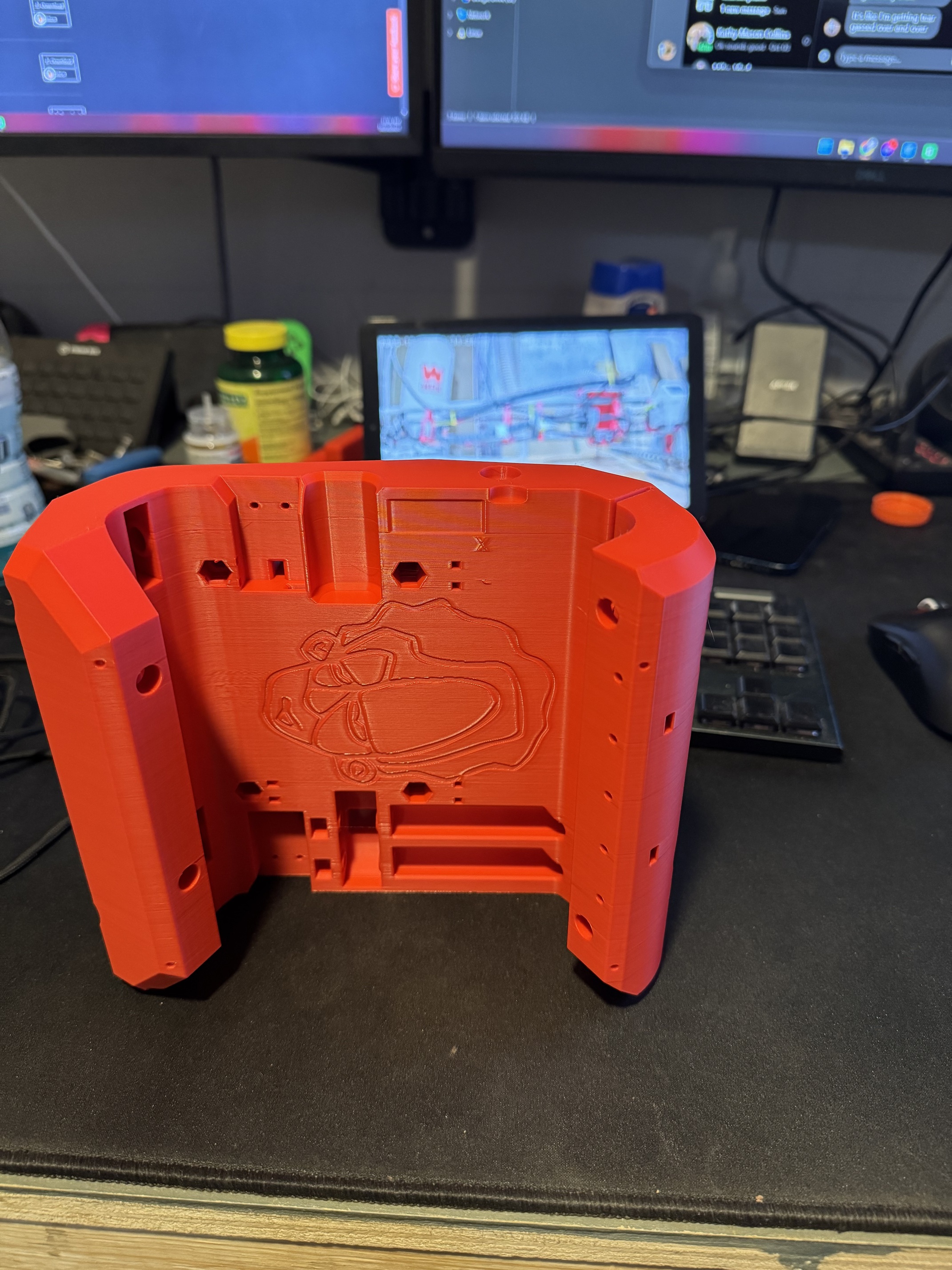

Who is this handsome guy on my core🤣
You found the hidden easteregg. Like, not that hidden. Actually adds a bit of stability maybe? :smiley:
Your drag chain on the LR3 is screaming for an aluminium profile as a support. :smiley: I‘ve got it somewhere in my Froschkönig build. :stuck_out_tongue:
Ohh nice, I didn’t even think it was an issue, I’ll find it on the build!

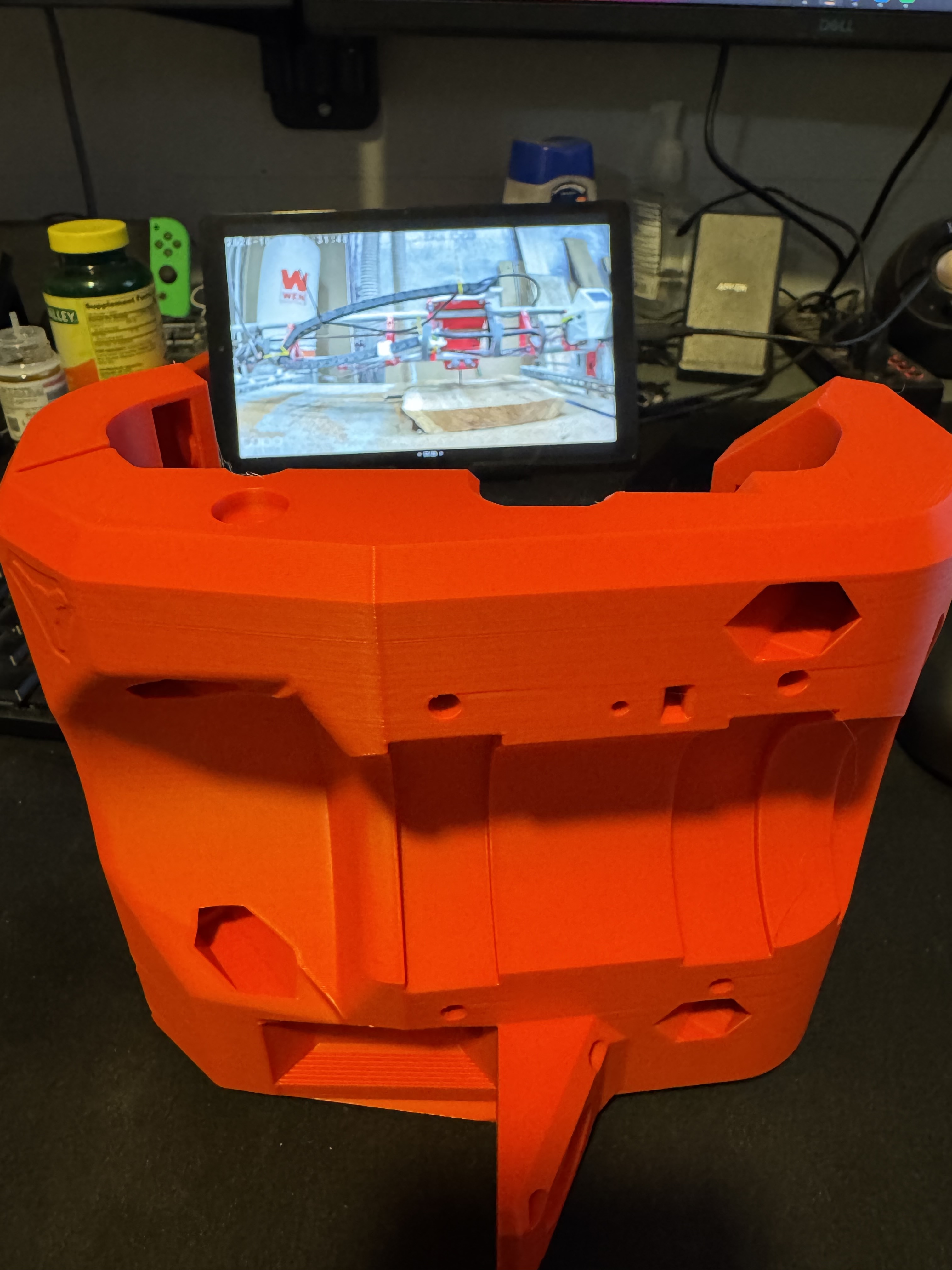

Also my phone isn’t pictured, but I run my LR3 while working and keep the cam on it, with the emergency shut down on my phone right behind it!

Jeff, did you print that on the X1C? It looks great!
I did, it’s a bone stock x1c with the same nozzle I bought it with a year ago
