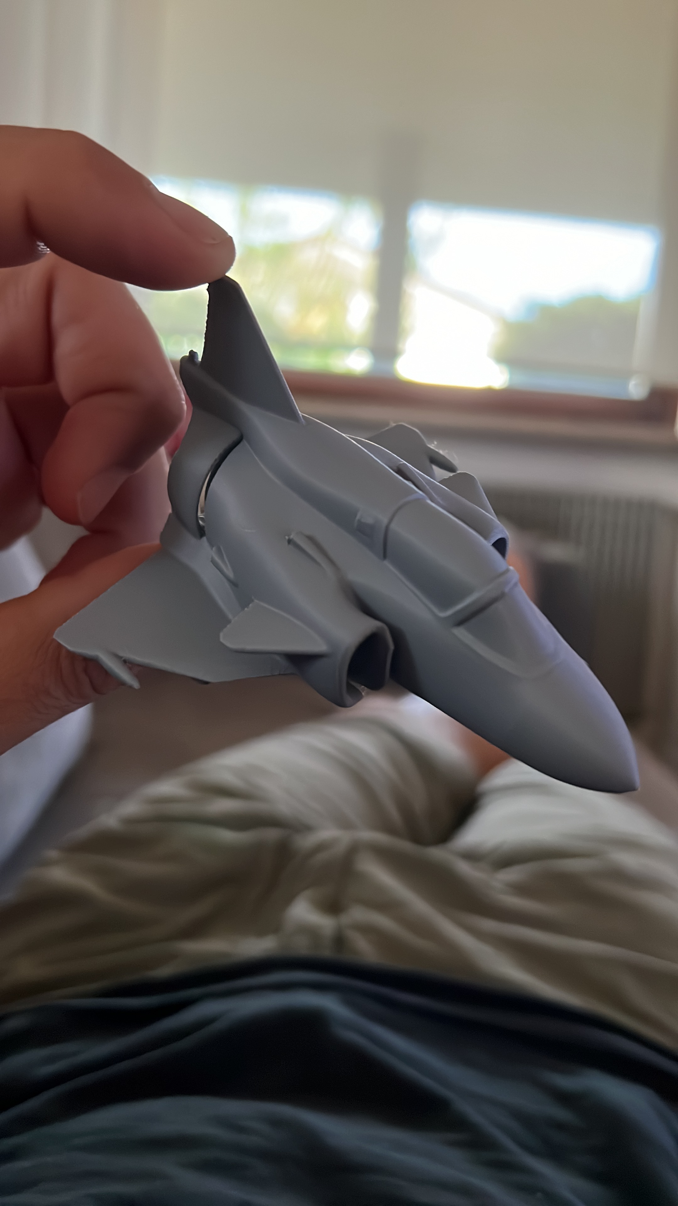

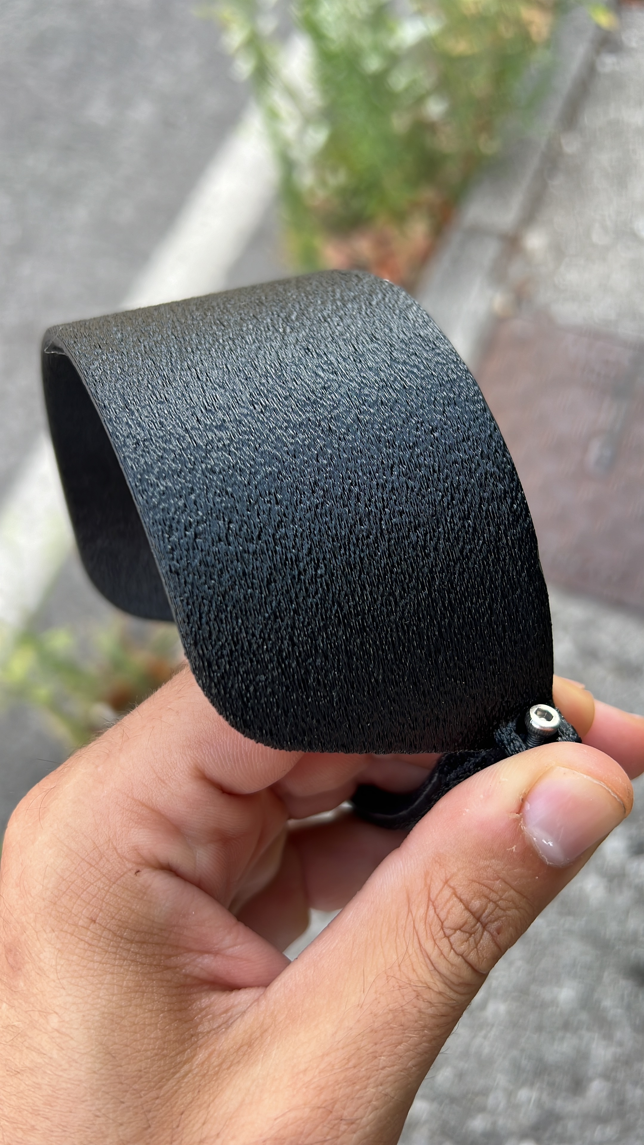

It’s over one year that I use mostly Overture filaments, PLA Pro, PLA Matte, TPU HS, and PETG and I’ve never had problems, even with the older Sovol SV01. No stringing, perfect layer adhesion and nice finish. My V4 Will be made out of Overture PLA Pro, and probably I will try PC for the compact V4 (or maybe a rebuild of my actual V3, have to decide).
These are couple things made with Overture filaments:
