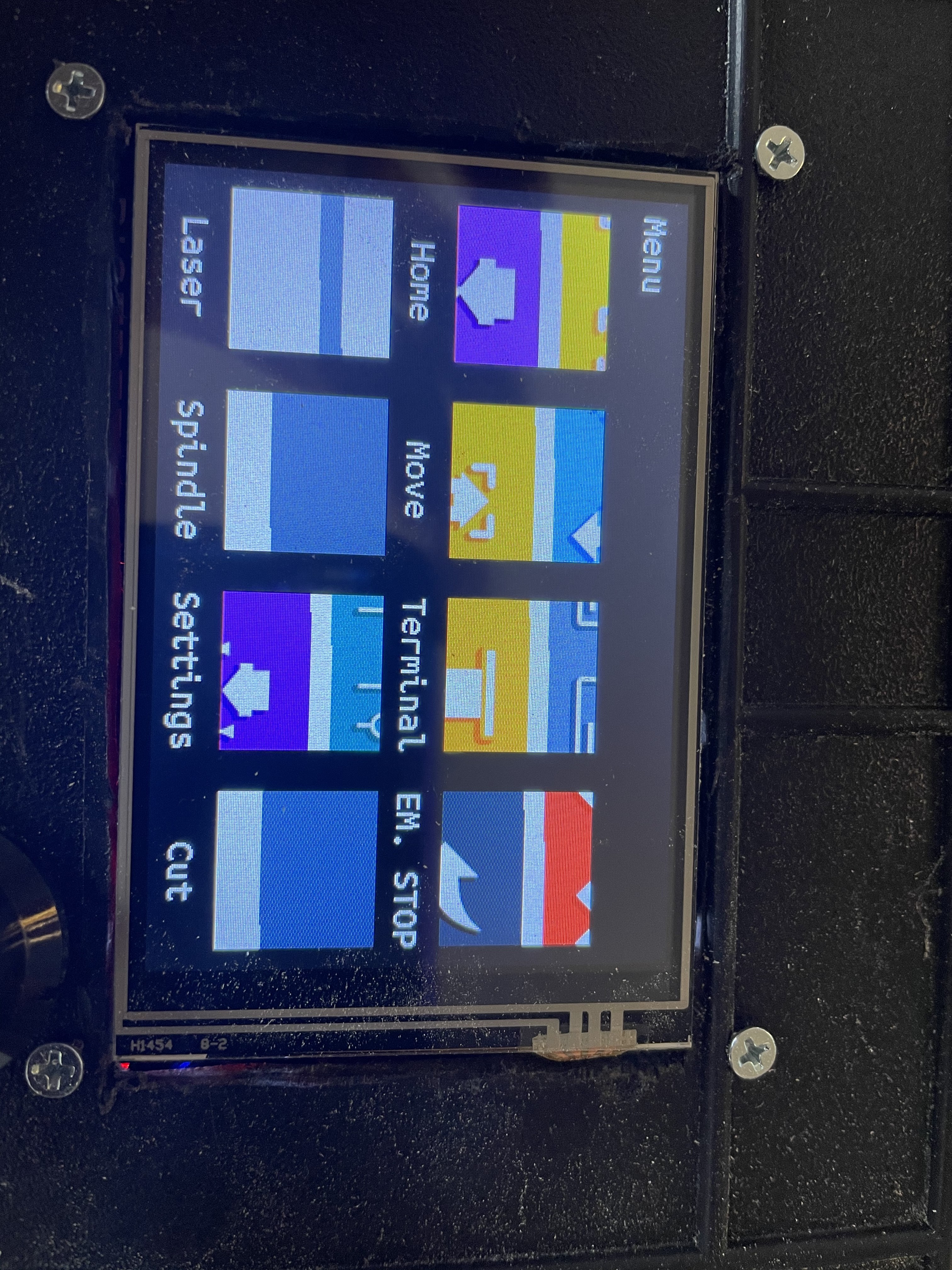

Put the firmware on… lcd12864 sim now has a bunch of other nonsense with it… v1cncn 509 ready at the bottom
the bigtree screen says no printer attached at the top of the lcd now, it would flash quickly before but go away. now its steady
The baud rate should be set to 250k now, not 115.2k. That should fix that. It may tell us a new error.
The tft needs to be flashed too. There are more files, but it is the same process. Go get the zip, unzip it, put the folder, .ini file, and firmware.bin on the SD card and put it in, turn it on. The firmware for the TFT is linked from here:
https://docs.v1engineering.com/electronics/skrpro/#tft-files

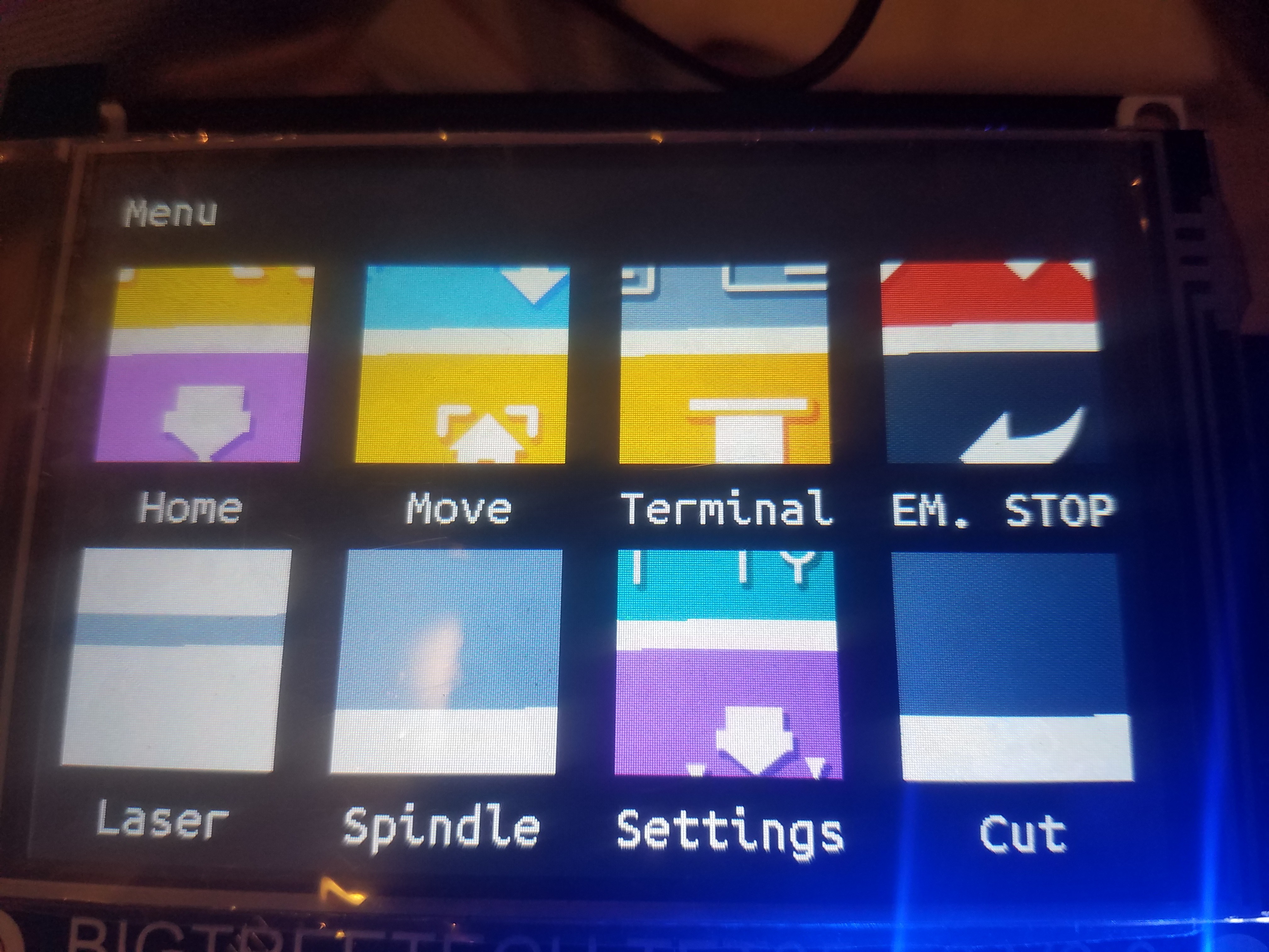

done and done… kinda wish I hadnt though as the little icons for the buttons are so badly formatted that its hard to read the screen now.
I used the v3.0_E3.bin, config.ini and the tft folder. I’ll take it out soon enough to test it. Any thoughts on the poor formatting?
Huh, there’s another topic somewhere around here with that exact same problem. Looks like it was solved by flashing without the gray cables connected.
I removed the tft35 subfolder to the root and it seems to have cleared it up… Well its still updating but i’ve done it 3 times and havent seen the icons flip thru like they are
its done… that is the fix…
maybe in the next patch have it check 2 folders deep for icons? or add a move tft35 subfolder to root in the tutorial
