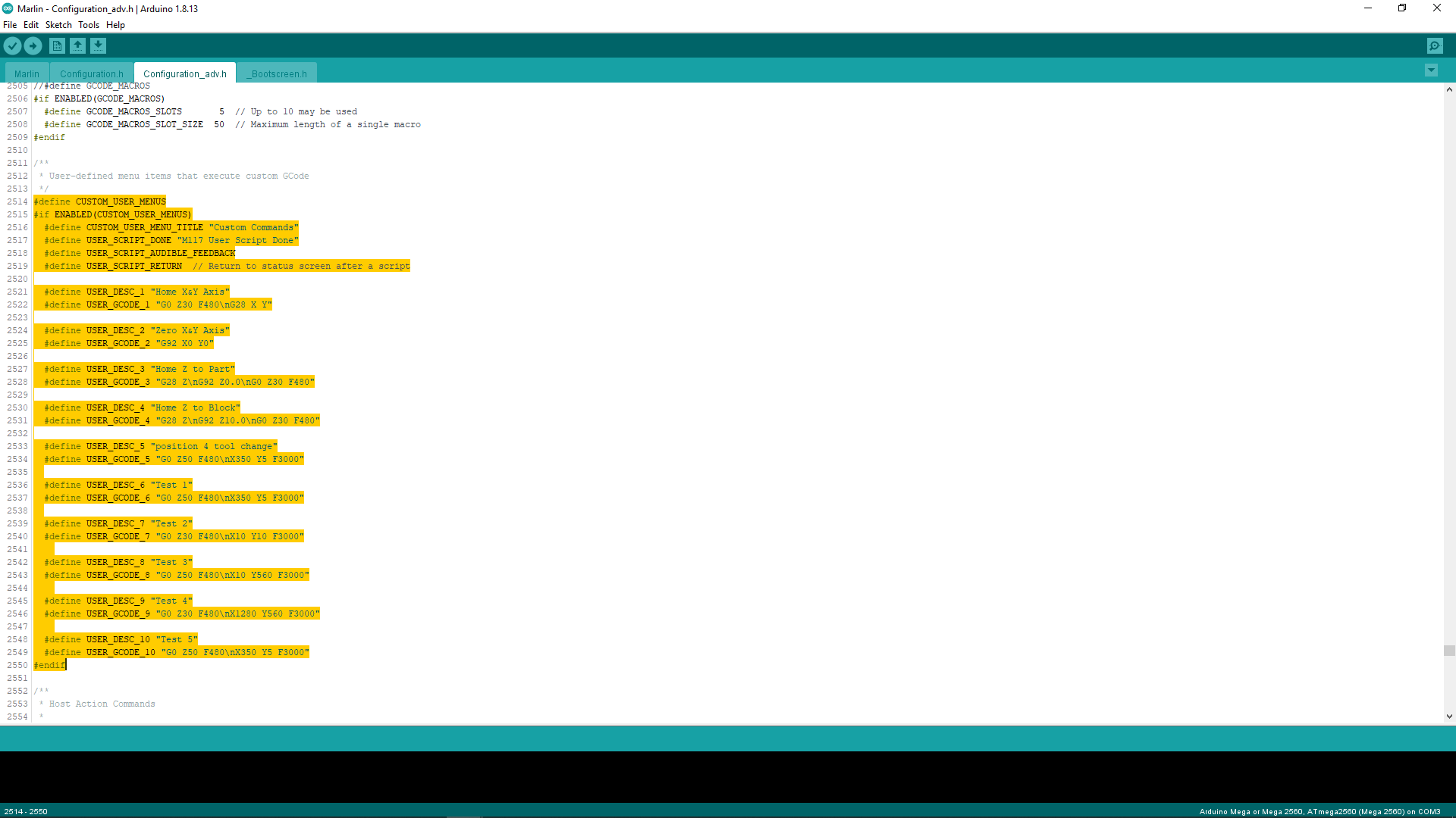

As for the z, you can add a menu command in marlin and reflash it to include a z zero macro of sorts. Or, if you’re running from a computer most interfaces have an option for this (I like cncjs, repetier host is also popular).

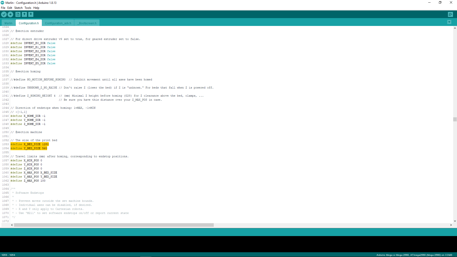

  1. First, my build has a usable area of 19’‘x39’’, but when my code or when I manually try to move passes 200x200mm the unit seems to hit a false stop of sorts. I’m not sure if its the firmware or what but something is locking out the steppers.
You will need to set YOUR bed size (physical cutting limits) within the firmware. (see picture)

  1. Are you using a Z probe or are you manually setting the height, reason for asking is that if you are using a probe it will be easy to to write a couple of scripts to cover what you need and put then into a custom command, like picture below.

The reason i told him to set his bed size is that you can turn the soft endstops on and off within the screen menu under motion and that may well be the case, as he is only travelling 200mm in X/Y and the default clean firmware states that table size as 200 x 200mm it is likely that he is hitting those soft endstops. I fully understand that if the soft endstops are off you can push it beyond the 200mm default, but i don’t see why asking him to set his bed size in the firmware should be a wrong call, with the machine homed and the soft endstops on it will only stop the machine crashing and causing further issues. Confused?

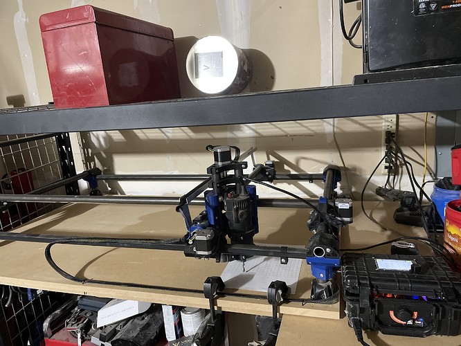

Excuse the mess, still getting its final home ready.
