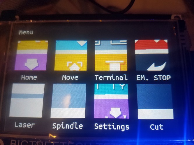

Hello everyone,
I am a newbie to all this Programming and stuff. I recently got my Low Rider 2 set up and flashed everything onto my SKR Pro and the TFT as per the directions. However, I have a major icon issue with my TFT screen. Can someone tell me what I did wrong?
I would try flashing it again. Make sure you put the icons on the sd card when flashing too.
I was recently flashing TFT35, I never run into something like this but had all sorts of flashing problems.
What helped eventually was to disconnect grey cables, keeping only TFT cable plugged in. After that, smooth ride.
Did both of those options and we are back to normal. Thanks for the help!
