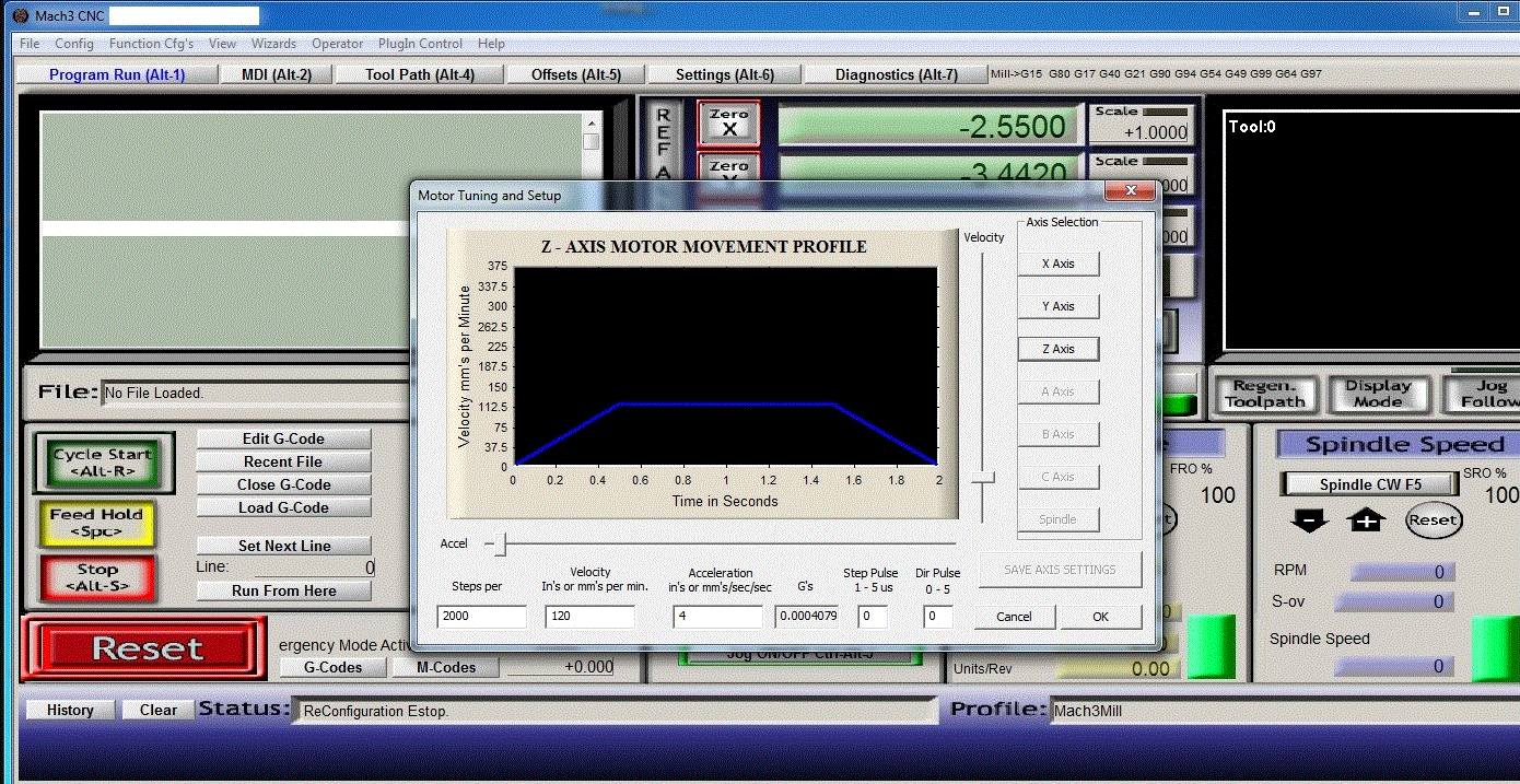

Sounds like a good idea, thanks. I’ll have to try to figure out how to do that in Mach3.
I don’t see any option to input gcode commands directly. There’s nothing like a live console that I see. Like I said before, I need to do a little more research…

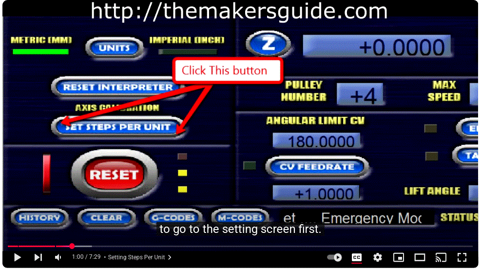

I agree this will help find your problems.You do not need to remove the belts, if you do the distance test.
I don’t know what version of Mach3 you have. But I’m sure that in your main screen you have a Setting tab and also a Config tab. Under the Config tab you will find one labeled Motor tuneing. Click on it and choose which axis you want to set. You should see a steps per unit and also Units. You should be able to set the steps.
You will see you also can set your ramp speeds and max speeds here.

Thanks Larry! My Mach3 looks like that top image, but nothing like the bottom image.
I tried going into motor tuning, but it threw an error 9991 and crashed the program.
I need to figure out what that’s all about.

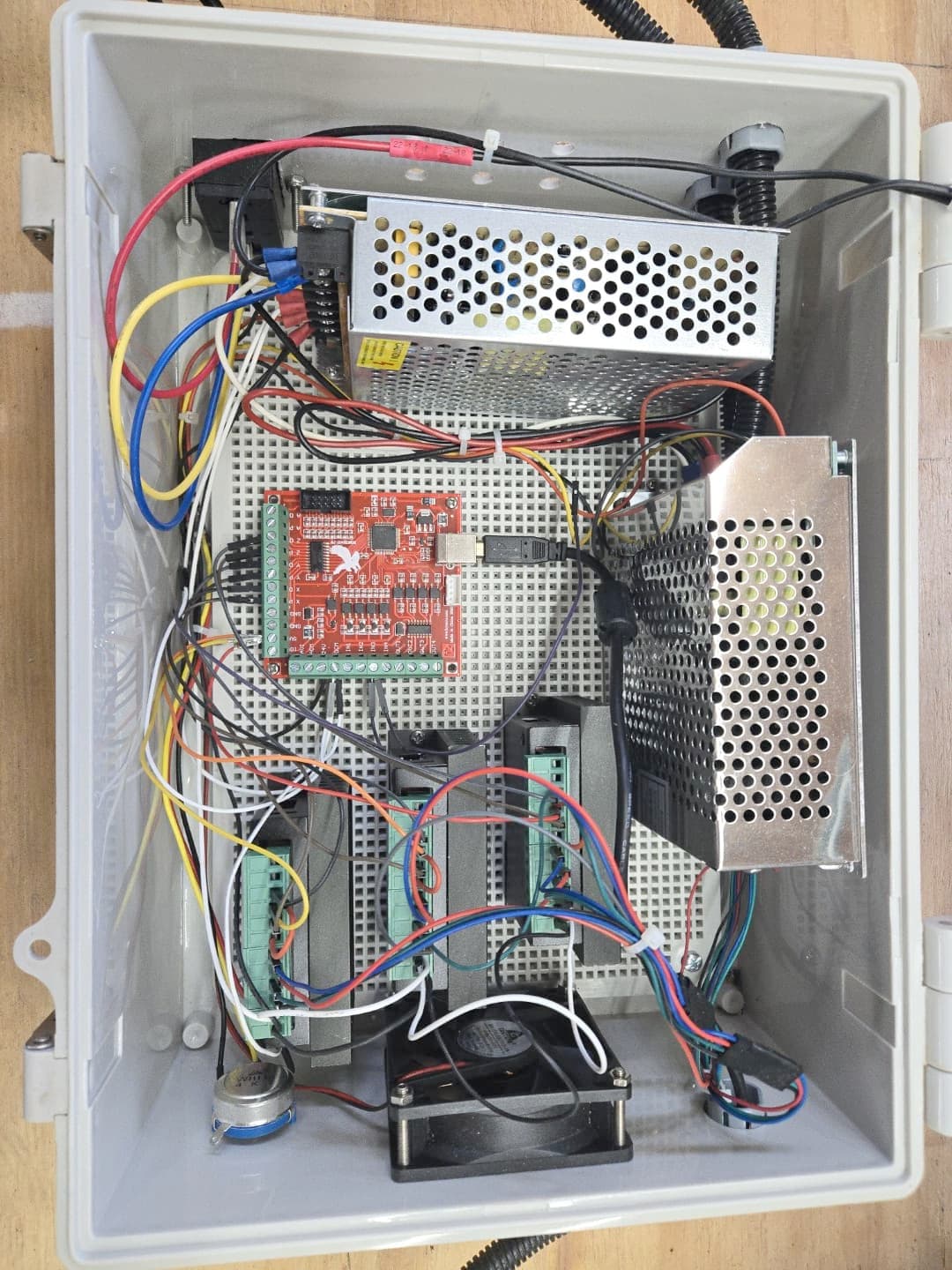

Different how? I can’t just mount the Jackpot in the place where the Mach3 board was in the enclosure I have now?
Also, I have dual 12v PSUs. I notice the docs mention using a 24v PSU. Will this be an issue, do you think? I don’t know the total power of either of my current PSUs, I’ll need to check.
You can install the Jackpot in your existing box (enclosure), but the hole pattern isn’t the same as the Mach 3 board.
You have a really nice enclosure which I’ve taken the liberty of re-posting here below. I’m not sure if someone made a shim/mount or just drilled holes in the grid to mount the Mach3 board, but you’ll need something to mount the Jackpot.

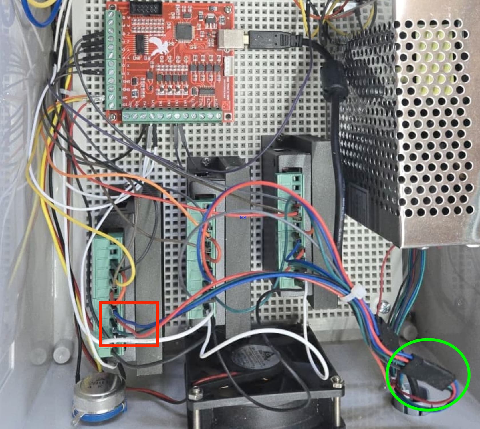

In re-reviewing this, you have external drivers, so you’ll need to pull the stepper wiring out and put connectors on those to plug into the Jackpot.
Sorry, I thought you had an SKR pro, not remembering it is that Mach 3 board.
Remind me why your current setup needs dual PS? Does one run a spindle and one run the controller? I think that’s what your first post picture shows. If one runs the spindle, it looks like that spindle has multiple wires, implying perhaps the Mach3 board has a spindle controller.
This will be something we’ll need to work on, so lets start lining up the details and documentation for what spindle you have, and how that spindle is currently wired to the Mach3 board.
Jackpot works fine with 12V or 24V power supplies, so the voltage is fine. We just need to sort out why your original setup had two PS.
Yeah, I plan to pull the drivers, which will give more space in the box anyway. :slight_smile:

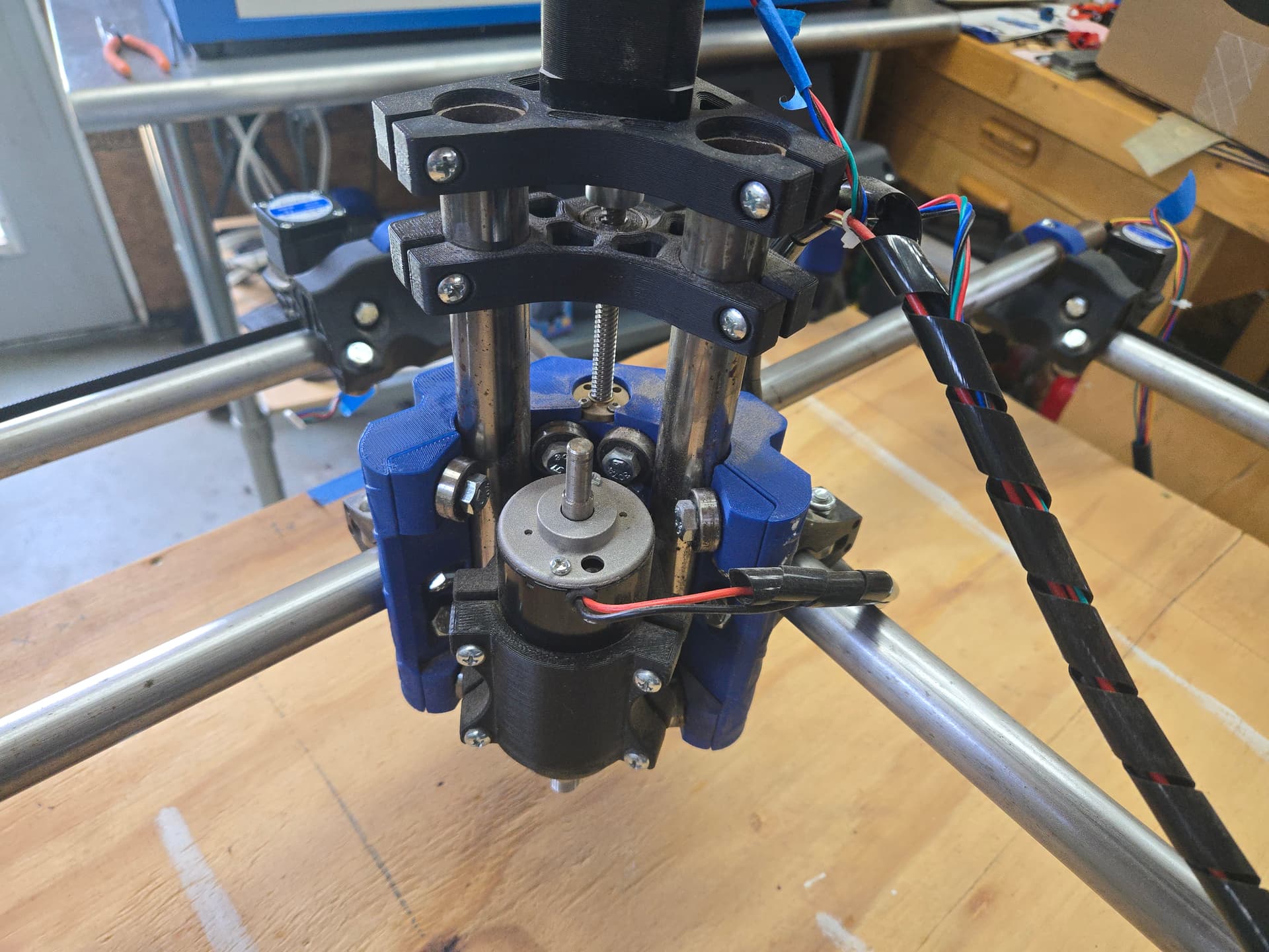

Correct. One drives the spindle through a manual rheostat. I have no idea why, as it means I can’t control spindle speed in software. I assume that will no longer be a thing when I switch to the jackpot, right? I’m guessing it handles spindle control?
The spindle is super simple, just 2 wire direct drive, as far as I can tell…
OK, taking another look, It appears your external drivers are wired with an extension pigtail. On the left and in the red box is where one of your stepper motor wiring is terminated in the driver. Over in the bottom right is where that set of wire pigtail comes to mate with the existing stepper motor wiring. If you separate that harness, then the stepper motor wiring should be able to plug directly into the jackpot.
OK that’s cheesy- but it works.
That means your spindle appears to be just a simple DC motor. We need to compare the ratings of the power supplies. I suspec that the reason you have the PS dedicated to the spindle is that it is electrically noisy as all hell.
You will be able to keep this setup with the jackpot, and I’d leave the spindle power supply and speed adjuster alone to start with. It does mean that you will have to manually controll the speed just as before.
Eventually you may want to upgrade to a different/better spindle. If you do, then you could swap to a trim router and still manually control that from it’s own speed control. You could also upgrade to a spindle that the jackpot can electrically control the speed from.
That’s a much more advanced setup so I’d do this in steps/phases.

If it’s anything like the garbage one I had, those spindles are ~100Vdc or something so that power supply is the power supply and ‘speed control’ (for whatever that’s worth) combined.

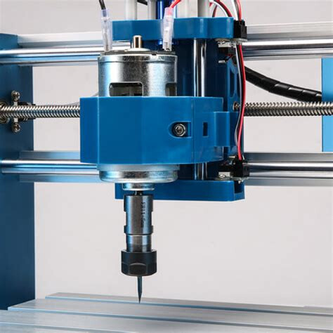

@Elmojo Do you have a photo of the spindle? There’s a good chance that it may be a worthwhile thing to consider upgrading…
That looks to me very much like one of the “775” spindles you see on a 3018 CNC. If so, it’s either 12V or 24V DC.
More details are surely worth gathering.
These are surprisingly capable in a machine like the MPCNC or even like the MPR&P- as @dkj4linux has shown. Though he’s also moved up to a trim router as he contines to explore the considerable performance envelope that the MPR&P turns out to have.
Looks more like the typical 500W spindle, to me, just with the fan removed from the top.
It may well be that you can get good enough performance from them for a MPCNC. I certainly don’t think the performance of mine was holding my machine back in its previous long-rod configuration. I’ve also seen enough people complaining about runout issues with them and with mine the bogging under any load with the speed set to anything slower than maximum really made it difficult to get the machine to work well. For me, at least, moving to a trim router removed an entire set of problems and made my machine actually usable.
It wouldn’t surprise me at all if there’s a trim router upgrade in this thread’s future.
I’m really curious now to see what the specifics of this machine’s hardware is.
These are big complaints with the lower end spindles. I have a ‘775’ spindle in my junk box that came from a kid at the local makerspace. I gave him one of the '775’s from my no-longer-used Twotrees CNC 3018 Pro. The one I had was respectable. The one he had with his machine was garbage.
Back to watching with interest as we discover more about this topic’s MPCNC and get a chance to make recommendations or do some benchmarking of what’s there.
