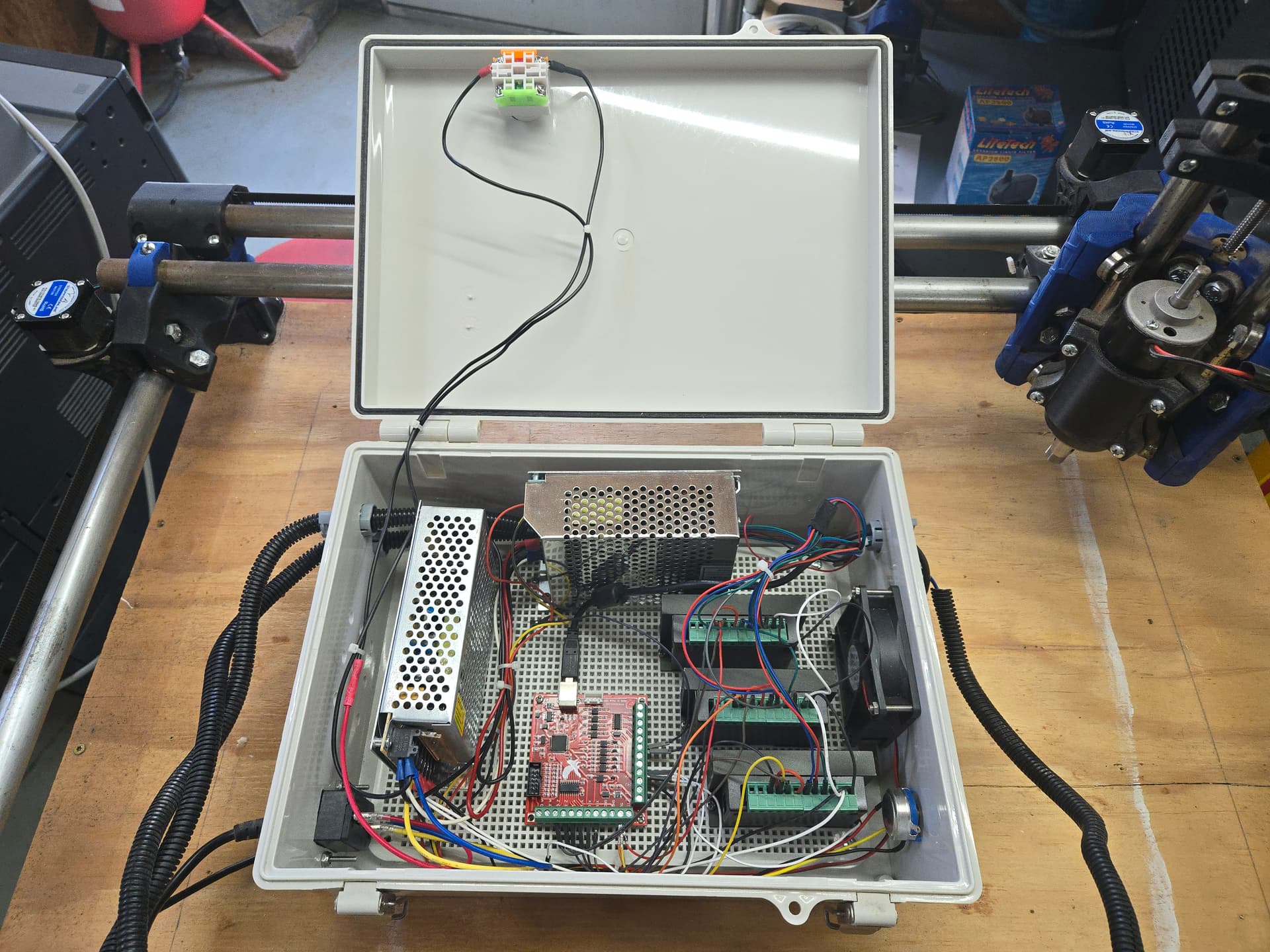

No, it’s a medium duty exterior plastic comms box, or at least that’s what it looks like to me. It has a gasket seal, 2 flip-lock latches and a mounting grid in the bottom.
This image gives a little better view of it. The thing mounted to the top is an emergency stop button.
It’s exactly this one. I even have the fan and aluminum mount in a box. :wink: That’s the “speed control” knob it’s using as well.

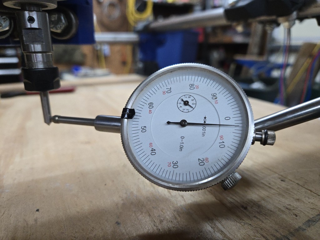

What I did was chucked up a drill and then tested the runout both at the collet and about ~10-15mm (1/2") away from the nut. The runout at the collet was actually pretty good (edit: Actually, I think I even had a comment from someone here that those spindles were garbage so I tested the runout at the nut originally and responded to that post that I must have got a good one). The runout at where the end of the cutter would be was terrible, like ~0.5mm. My issue was that the taper on the collet holder was ground off-axis somehow.
I don’t even know if I’d technically call that runout, but it meant the cutting surface of the 1/8" single flute bit (which you should definitely get if you don’t have any yet) was 0.5mm off axis from where it should be randomly based on where I had chucked it. Measuring where the ‘high spot’ was and then marking it meant I could chuck it so the cutting edge was following the outside of the arc which helped a lot, but by the time I figured out that bodge I had already cursed a lot, ordered and received my replacement trim router.

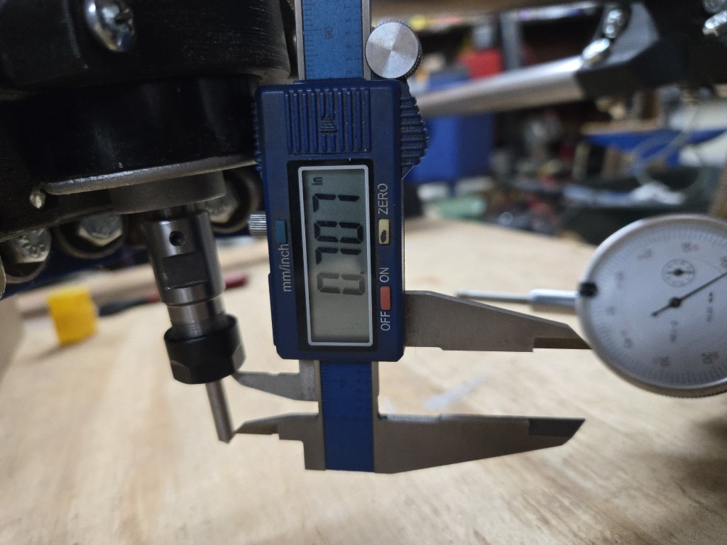

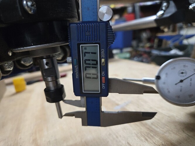

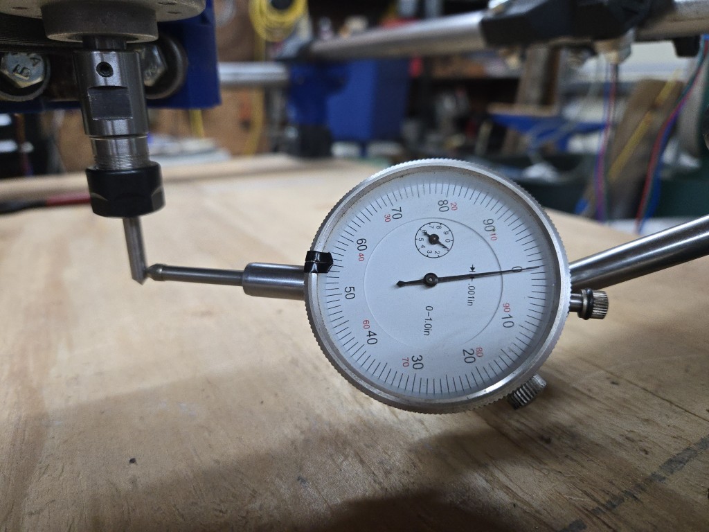

You guys got me curious, so I went out this evening and checked.

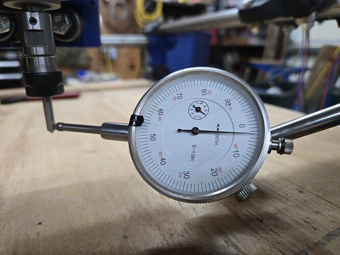

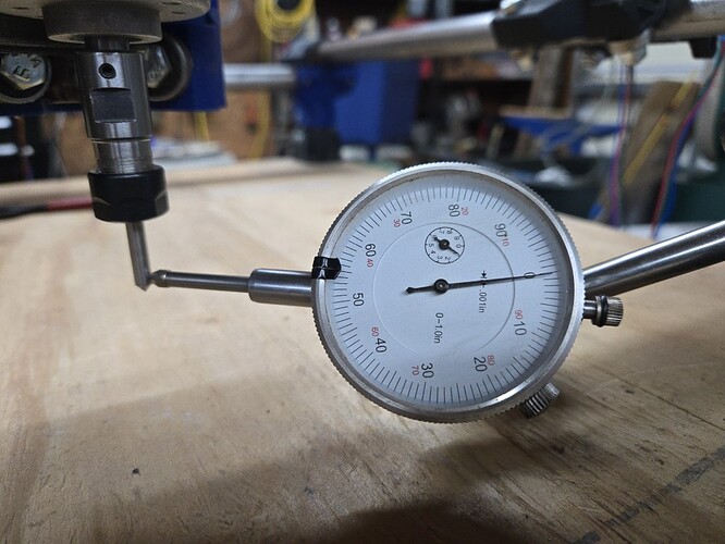

I first checked the runout on the spindle itself, and got…nothing. I mean it was so little that I had to check to make sure my indicator was in full contact with the shaft! I was getting maybe a half thou of wiggle through the range of a full turn, and I think a lot of that was from me turning it by hand and putting uneven pressure on the top shaft. (EDIT: Here’s a short video of what I mean)
So then I chucked up a 5mm dowel pin, and extended it as far as I could, which turned out to be about 0.7". With that extension, I’m seeing about 0.00275" of total variation through a full rotation.
Is it just me, or is that really good, for a cheap DC spindle like this?
Images below for you visual types. :wink:

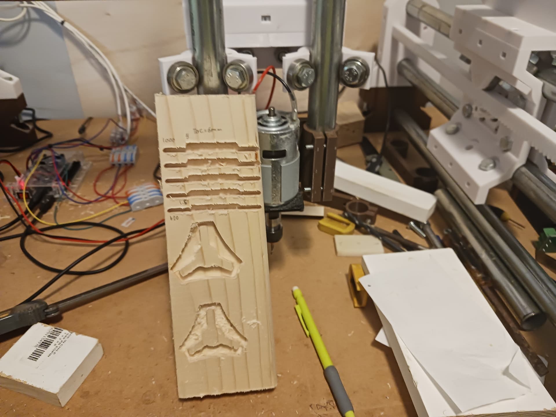

Plenty usable, I’d say. I think you’ll still find it’s relatively underpowered at low RPM which is really where we want to be running them unfortunately but at least that’s more of a speeds and feeds issue than a ‘why is this cutting like absolute garbage’ type issue.
Really? I thought high speed was your friend, when it came to getting a clean cut. Where’s a good place to learn about cutting parameters for these machines?
There are a ton of threads about it and a section on the docs, from memory. The high cutter speed thing is something that I thought initially, too, but it’s actually kinda backwards.
It depends a lot on your tooling but the short summary is that you want each rotation of the tool to take a big enough bite to cut and create actual chips, not dust (in the case of wood) or to not cut and rub (in the case of metal). The faster your bit is turning, the faster you need to feed into the work. Feeding faster into the work needs more force accordingly. These machines are typically rigidity limited rather than speed/force limited so the faster you feed the more deflection and the less accurate the cuts are.
That all gets worse with larger cutters, cutters that aren’t completely sharp anymore or with deflection under cutting forces, too. A larger cutter at the same speed will be clearing more material and generating much higher cutting forces. A dull cutter at the same speed will be generating more heat in the cut, have higher cutting forces and be more liable to rub instead of cutting. Deflection during the cut is the same deal.
