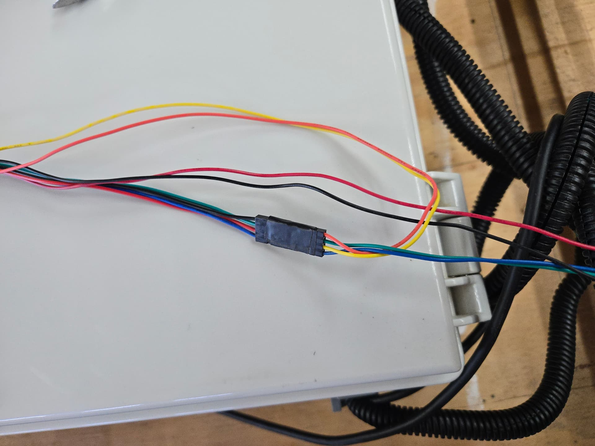

I think the plugs you mean are the ones in the steppers which are some sort of jst, possibly jst-xh, since the other end of those are just screw terminals into the drivers I would make any swaps. You can get the pins out of a JST plug just with a pin to bend the plastic locking tabs up out of the way.
If you flipped the wrong dip switches you might have changed the steps on the driver. The on/off direction is often not clearly enough labelled.
I mean the plugs that are inline, like this:
These cables are made up of a couple extenders between the driver and stepper. I believe they are JSTs. That sounds familiar from my RC flying days. They look just like the connectors on servos. :wink:

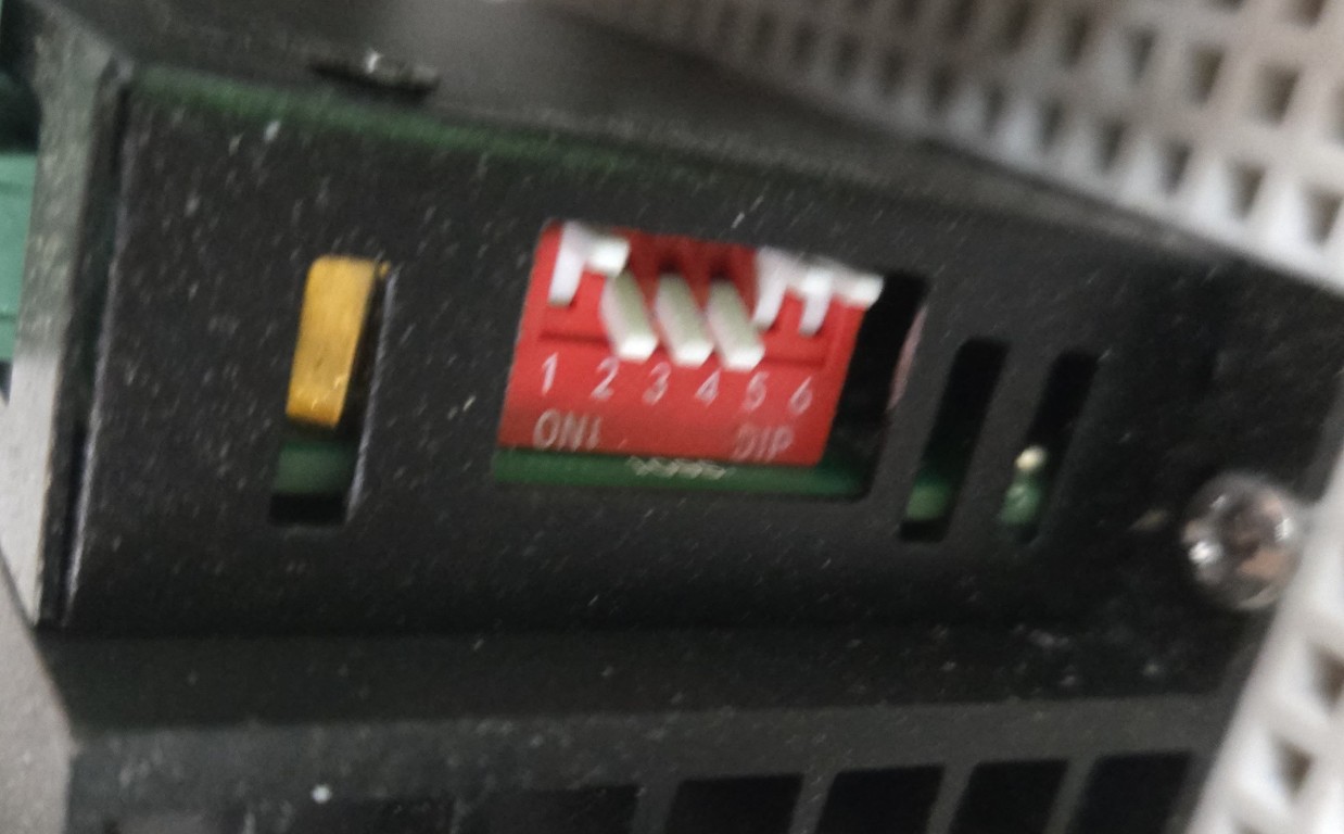

I’m fairly sure I did not (flip the wrong DIP), unless my driver isn’t the one we think it is. It looks exactly like the diagram, and I checked everything 3 times before changing to the pattern posted by Larry (S4-ON, S5-OFF, S6-ON).
This happens because your steppers are in series. Any break in the ciruit is a complete open
Changing the switches #4,5,6 just affects the power. Switches #1,2,3 only affects the micro steps, they will affect the speed

Unfortunately, I don’t think this is the case. It’s running slow, even with jog functions, when there is no gcode file loaded, or running. Also, I’ve already set the units to mm. I haven’t found the setting for steps per unit yet, but I’ll keep looking… I need to confirm what pulley size/teeth I have, but I need to pull a belt back off for that, which is a pain. I wish I had thought to check that before.
As you can see from this (kinda blurry) image I took before I changed the settings, the DIPs are set to 400 pulses/rev right now.
IF you have standard V1 Motors and Pullies I believe that should be set to 200.
