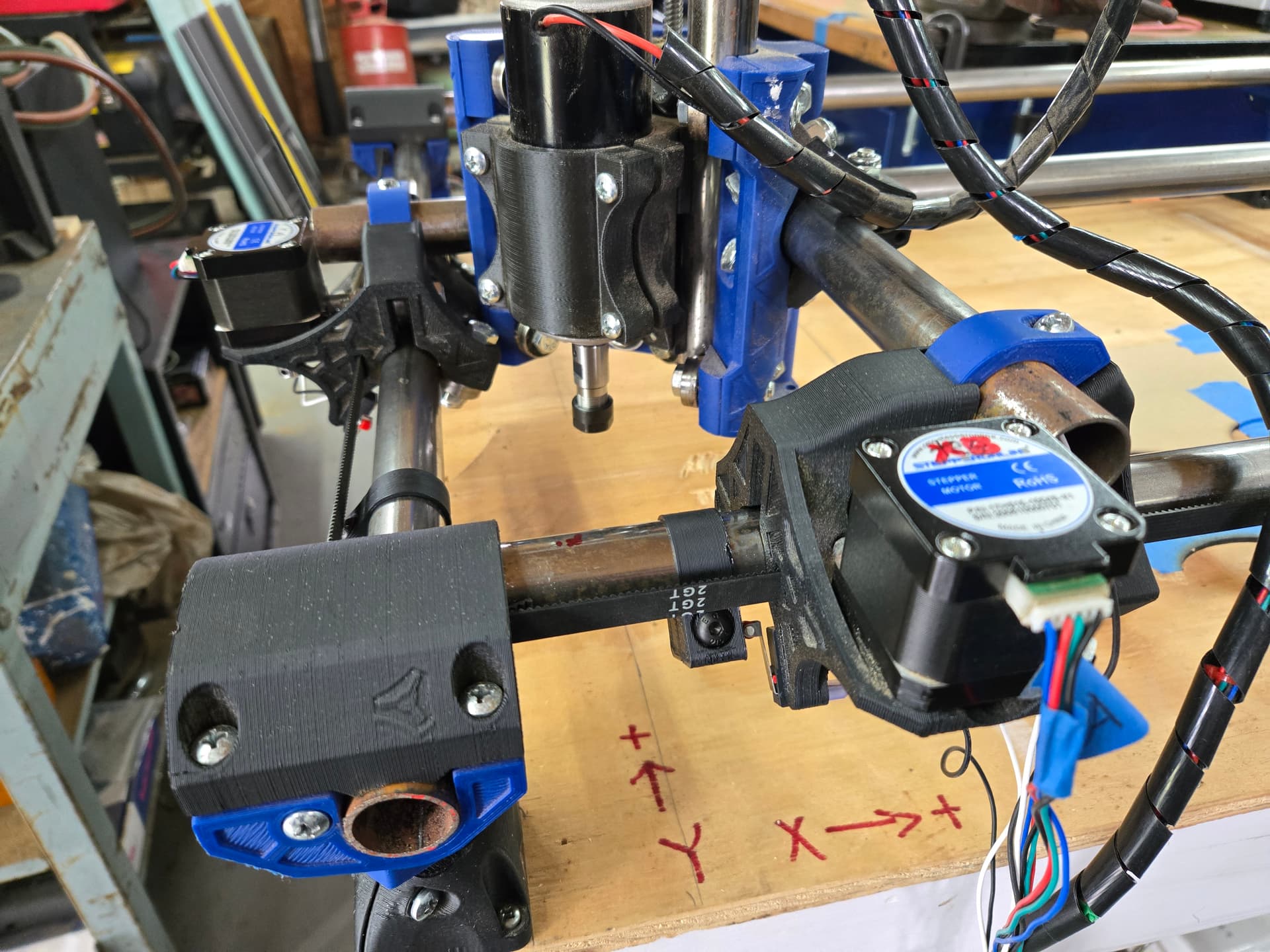

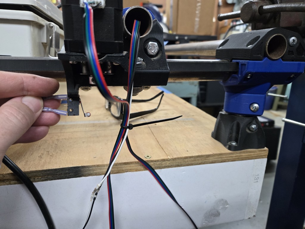

If so, then the origin side (machine zero) looks good, but how do the endstops mount on the other truck for each axis? Take a look at these images for what I mean.
In the first image, my finger is on the switch for Y0, and machine zero is to the right. Everything looks good.
In the 2nd image, I’m holding a switch in place at Y1, machine zero is to the left, and the endstop would trigger on the right, to limit travel in the Y-max dimension (in this example). How would that work? The switch would reach the stop block (not installed), because the truck is in the way. What am I missing?
On your second pic, flip the endstop around 180°

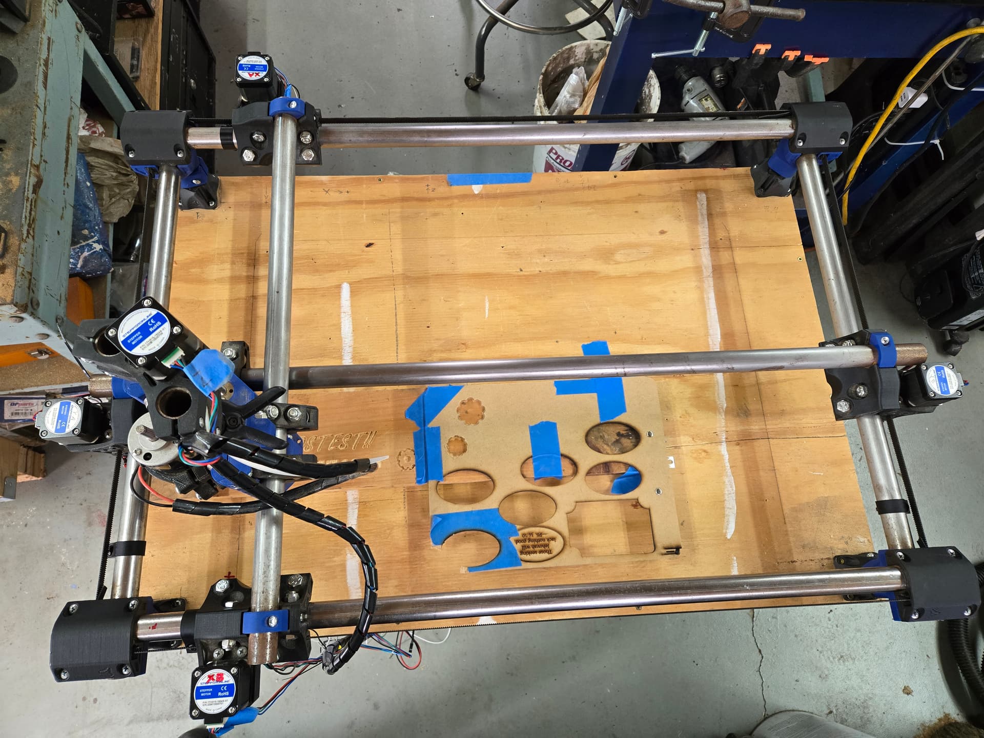

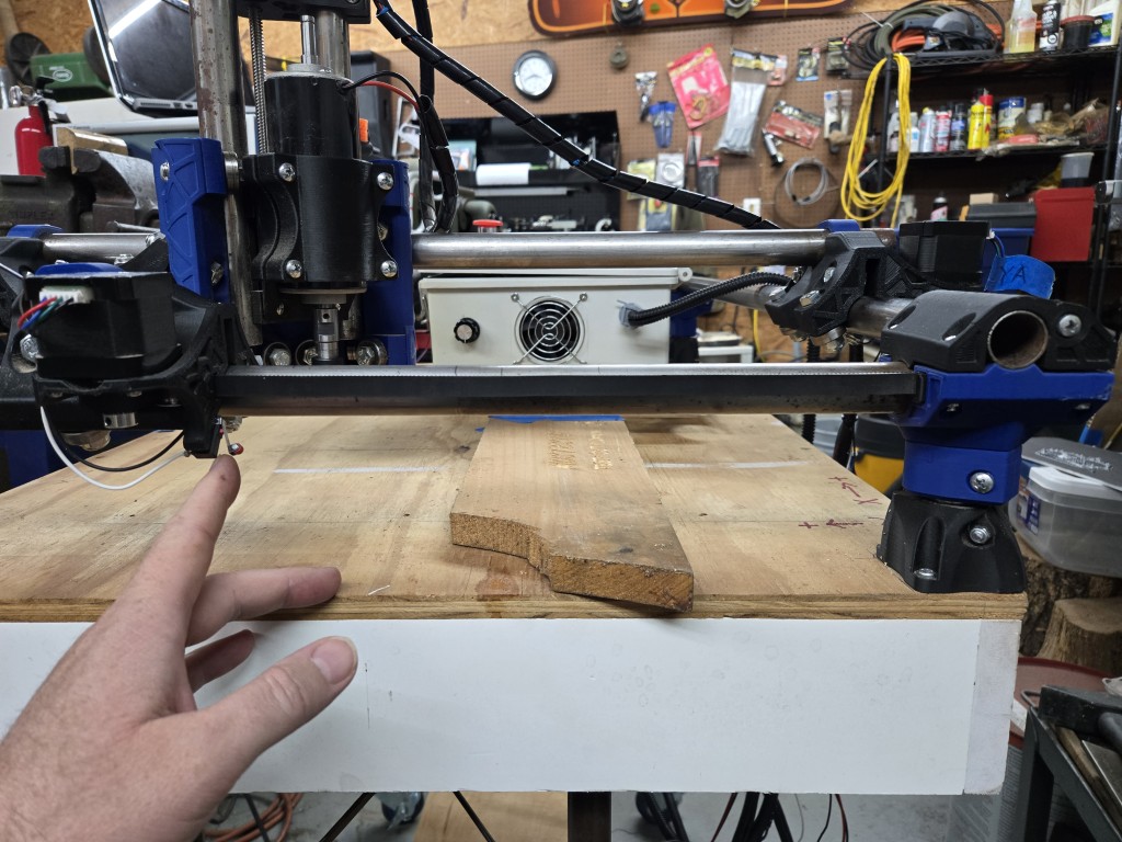

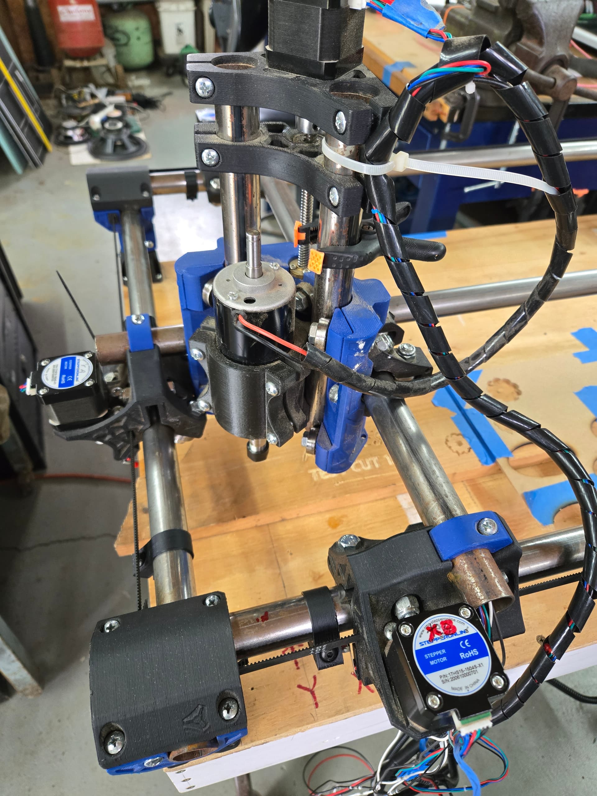

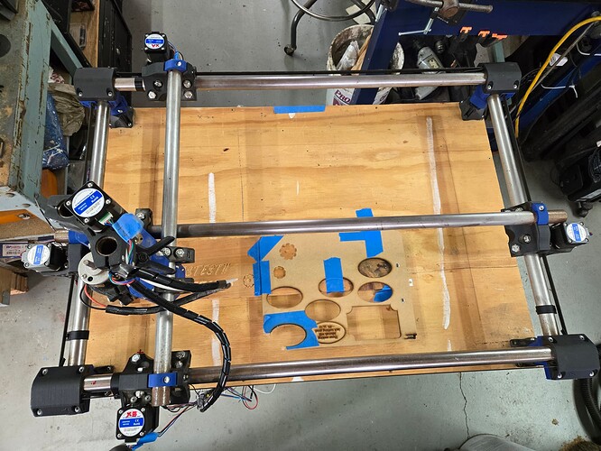

Here’s the setup as it sits now. Does this all look correct?
In the first 2 images, it’s in the Y-home position. The switches are just tripped.
The 3rd pic is an overall of the current setup.

That’s the X home position - as far to the left as it will go.
Looking fine, time to draw a crown and get ‘er movin
Oops, sorry! You’re right, I was looking at the Y in the photo when I typed that. :rofl:

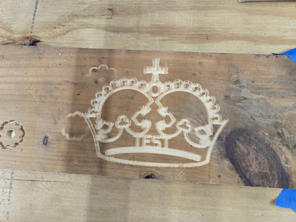

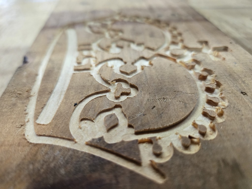

I ran the crown, and it came out fine, except that I was using a too-large bit. :slight_smile:
The finish was quite good, considering that I didn’t have the workpiece fastened down properly, and it moved around a little as it was cutting, plus one side is deeper than the other because it wasn’t flat.
