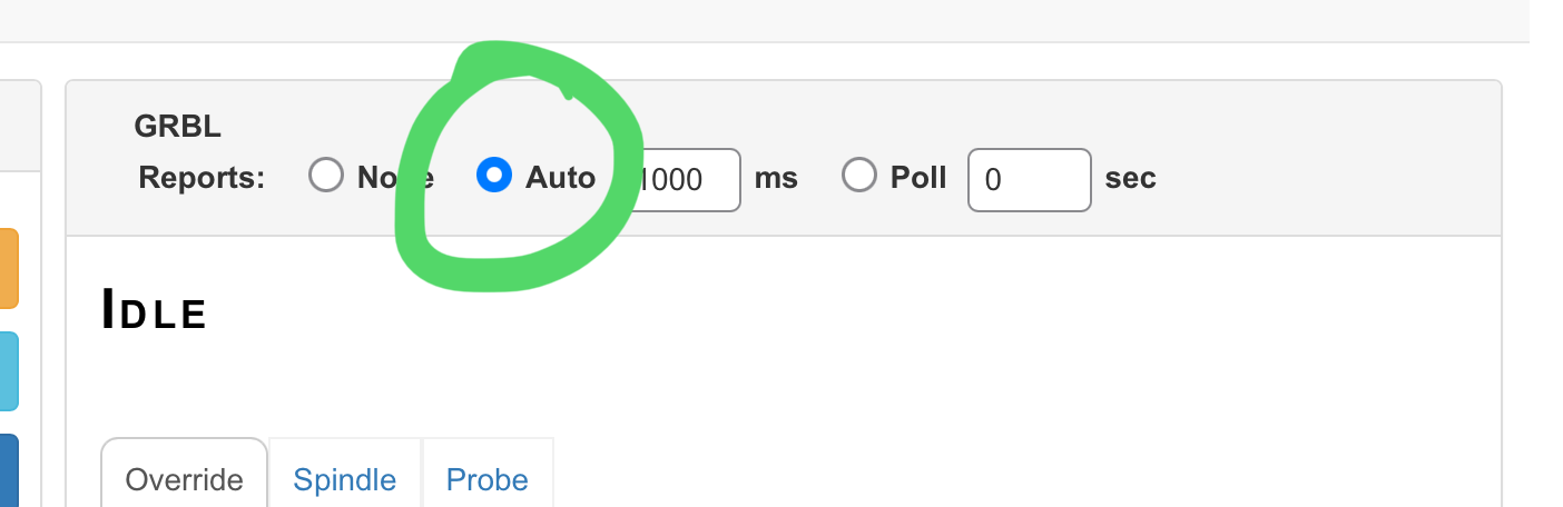

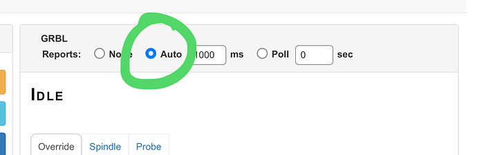

For the ‘why does it refresh’ question - check this part of the UI, it controls how often the webpage updates

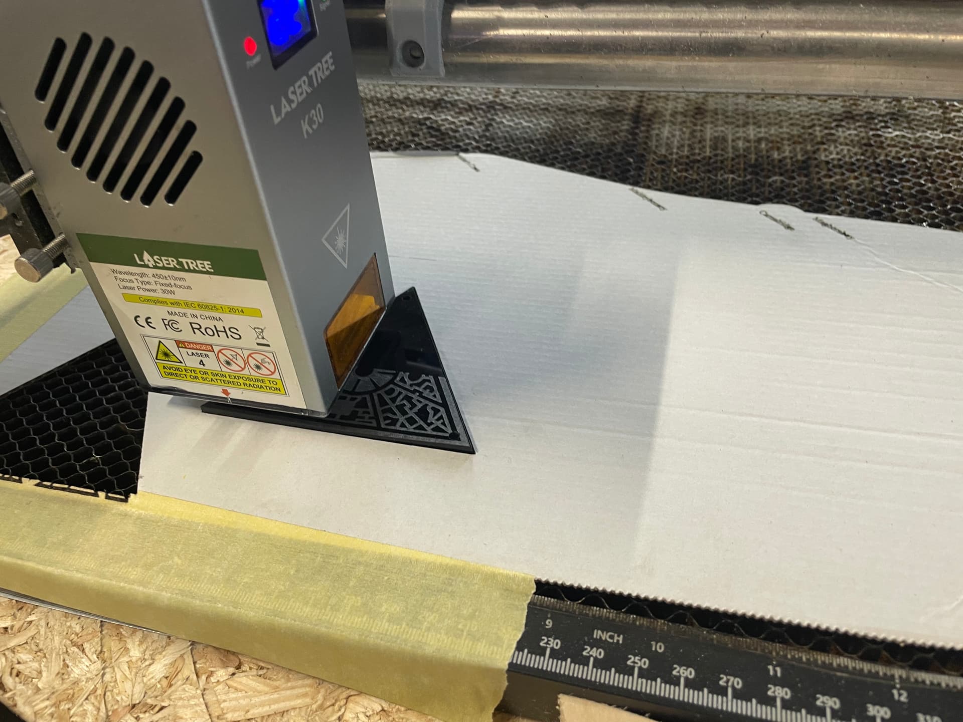

Using this feature I can take a bit of stock, set it on my bed, move the tip of the tool to the bottom left of the stock and set that as workspace 0,0. So say I put it 300mm from the machine XY origin at the front left corner of my spoil board.
when I home the lowrider again it will be 0,0 for the machine but -300, -300 for the workspace so I can always go back to the same spot if I need to.
Handy if you’re doing things like laser cutting where the tool head couldn’t get to the absolute machine 0,0 because it hangs off the right of the router.
I think my GUI is already set to auto refresh, but I’ll check again. What I’m talking about is that when I hit the zero axes button, nothing happens sometimes. Sometimes it does. It’s not a matter of time, waiting for a refresh.

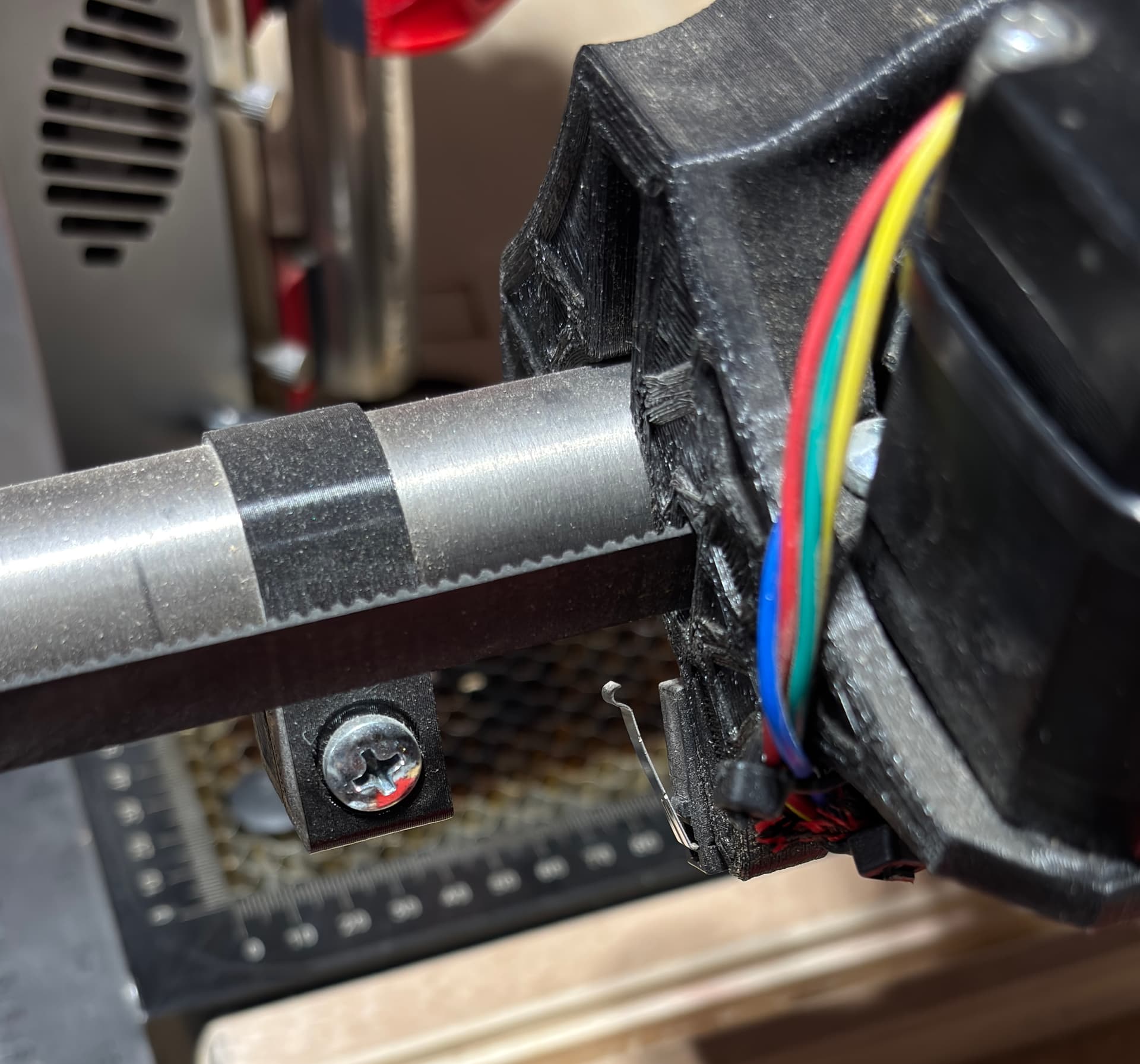

Can I not just move the gantry to the desired 0,0 position and press some button to tell the machine that this is “HOME”? That’s how it’s worked on every other cartesian machine I’ve worked on.
My laser does that. I can set home anywhere I want, although it does have hardware endstops to prevent crashes in the even that I ask it to travel beyond the limitations of the machine.

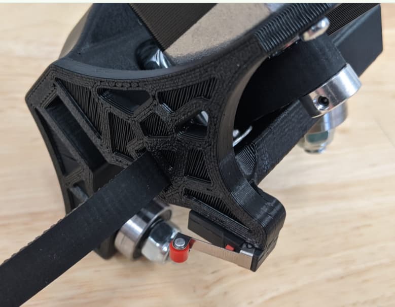

The MPCNC Docs show where to install the endstops. 3-Trucks - V1 Engineering Documentation
Here’s where they should be mounted:
Then you mount the stop block on your tubing like this.
Connect the wires to the appropriate location on the Jackpot and power up. You can manually trigger each endstop to make sure they are connected correctly. The light will go off when you press the lever.

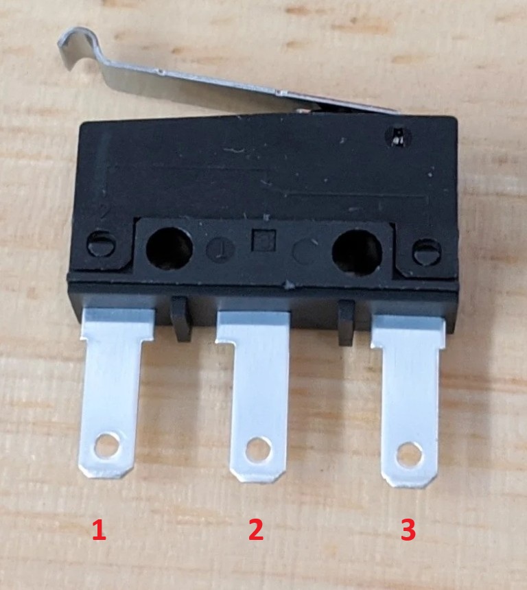

In regards to the switches themselves, which 2 legs am I using?
I apologize if that’s in the docs, I didn’t see it covered.
Here’s a switch image, with numbered legs for easy reference.
1 and 3. If you look at the other side, they are labeled. C and NC

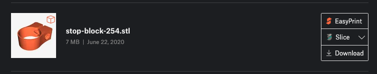

Those are the Primo trucks, what kind of files are you looking for? :slightly_smiling_face:
They are all on Printables. I’m not sure what size tubing you have, but here is the file you need to trigger the endstop:
Cool thanks. Ok…what’s C and NC?

Aha! The sizes reference the tubing diameter. I see, said the blind man. :wink:
The different modes for the endstops, normally open and normally closed. You want them normally closed so that it also registers when a cable is broken or not connected.
Gotcha. I assume “C” is Common?
Guess so. :sweat_smile:
