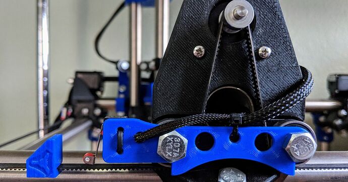

Speaking of endstops, I assume there’s info somewhere about how they’re supposed to be installed, and files for the mounts and such? I can be working on all that…
There’s some docs here, which you might have already found:
I’ve never built the MPCNC, only the LR3/4.
I Think the latest enstop parts are here (I’d like Ryan or an MPCNC owner to confirm)
The dual endstops were once considered unnecessary until the auto-squaring coupled with homing became well tested.

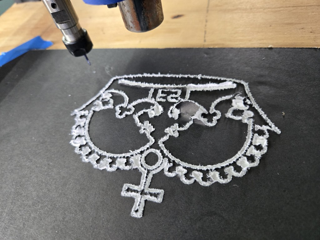

I decided to temporarily wire it up, so I can mess with EstlCAM a bit, and see if this spindle is worth anything or not.

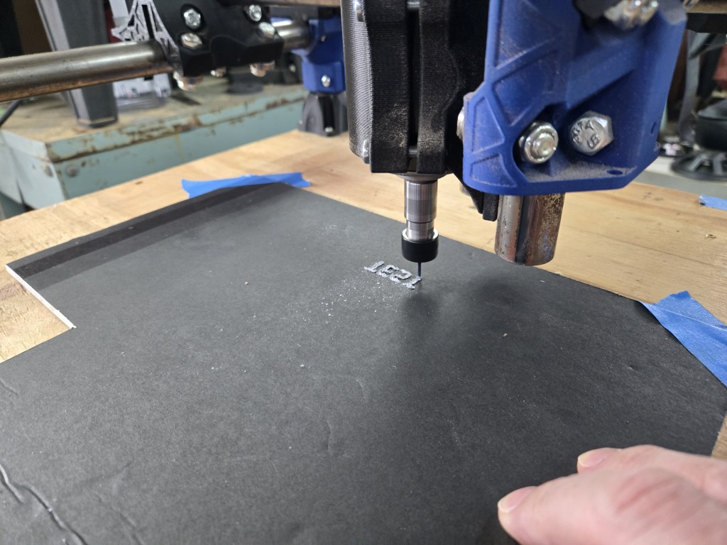

Long story short, I got it to run, and cut the test crown!

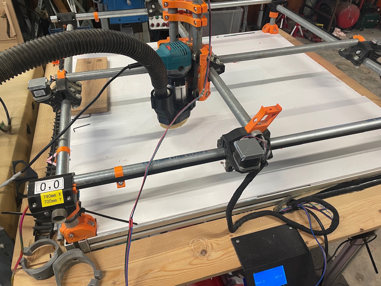

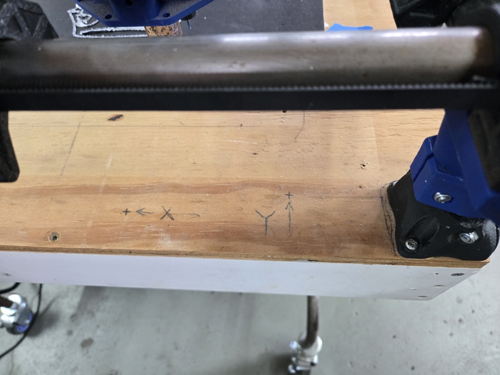

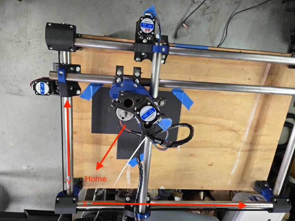

However, the whole machine is mirrored, by which I mean that X0, Y0 (machine origin) is not the lower left corner of the machine, it’s the lower right, for some reason. It looks like the previous owner built it that way, because the bed is labeled (see photos). How would I go about fixing the axes so they are correct? I know I’ll lose a little bit of working area, since the carriage is actually set up for the current orientation, but I’ll take that over all my cuts (and especially text!) being reversed. :roll_eyes:
EDIT: Now that I look at the photo… I’m not sure it is set up for lower right origin. I think it’s just wired weird, right?
The cuts are all fuzzy because I was using cheap foamcore. It’s all I had handy.

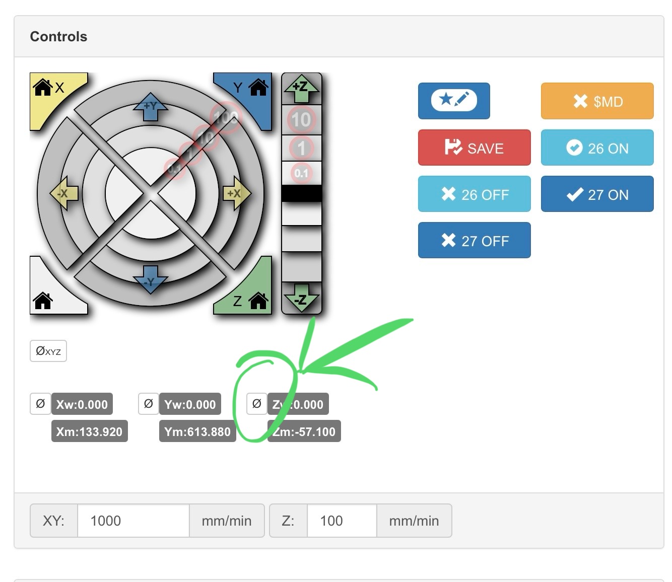

Also… How on earth do I set the home positions in the web GUI? I accidentally touched the home button, and it crashed the machine into the X-axis limit until I could power it off.
There’s also no STOP button on the GUI. Should there be? I mean, there should be, but is there one that I’m not seeing?

Homing is what the endstops are for.
In your first photo 0,0 should be top right.
Yes, it’s wired weird. This is where home should be.
Ok, I see that now. Thanks guys.
Very clean machine, @Dreyfus ! I like the size, also.
EDIT: Ignore all that (if you happened to see it), I got the axes fixed. It was a simple matter of just swapping the cables from each motor to the opposite channel on the Jackpot.
Now the machine origin is where it should be! Rejoice!

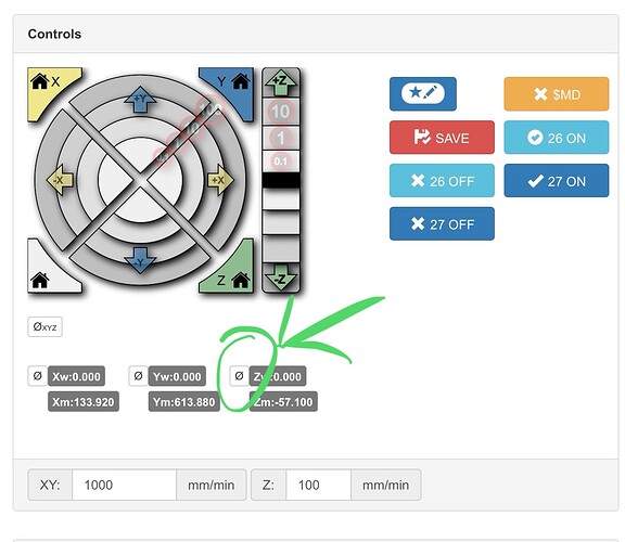

You’ve told the machines it’s at x0 and y0 but not z0, it could be that unless you already moved the tooltip to the surface and sent a G92 z0 command.

Are you saying I need to include that “G92 X0 Y0 Z0” as part of my startup code, at least until I begin using the probe? That makes sense, I’m just trying to be sure I understand correctly.
Yes. Oh that’s right you have a jackpot now.
in that case just use the zero button on the ui
