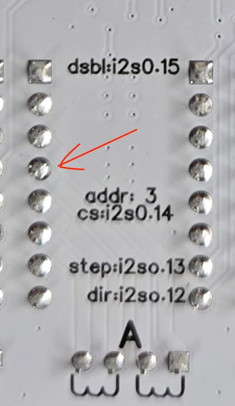

Your $SS results show that the TMC2209s are responding to commands during setup.
Your harness swaps show that the issue is with a specific physical location on the Jackpot, the location for your X1 motor.
Swapping drivers shows that all the drivers’ output sections are working and capable of motion.
Every stepper motor is known to turn.
Your DMM results show that FluidNC is commanding Step/Dir/Enable to the bad position.
We’re now really in the weeds.

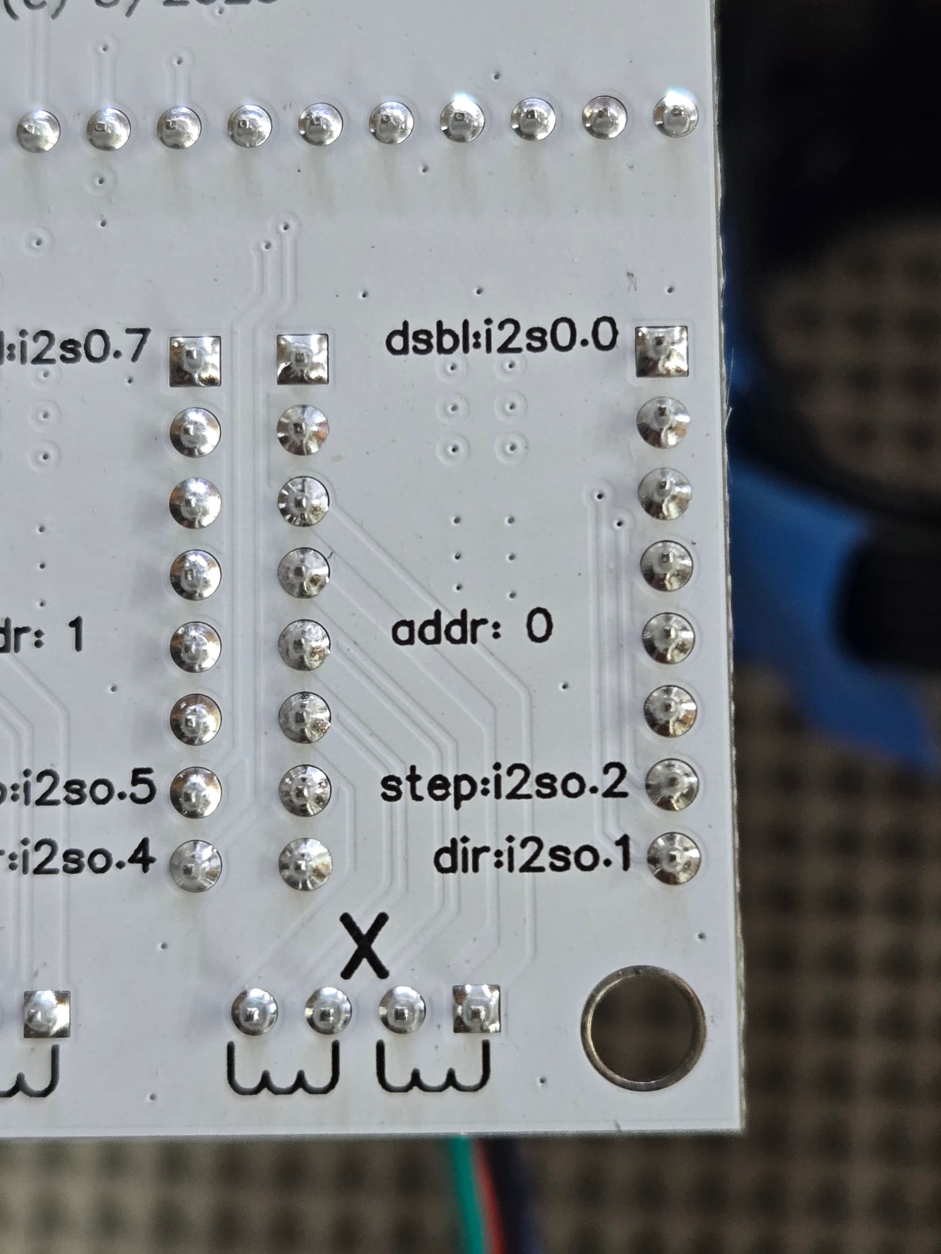

Next up, can you flip the board over and get high resolution photos of the solder work on the headers for the problem location TMC driver and of the associated 4-pin header?
You’re almost out of things that make any possible sense for the issue.
Did you get your Jackpot board from V1 or from Elecrow?

Like this?
Directly from V1E.
Note that if you can’t get that driver position to work, you’ll likely be able to get it to work using position ‘C’ by switching the address and pin addresses in the config.
We’re all eager to see if it can be determined what is wrong with the X1 position, though. The same problem has happened before once or twice and I think it may have been with the same position.
That’s where we’ll head next if we can’t get “A” working.

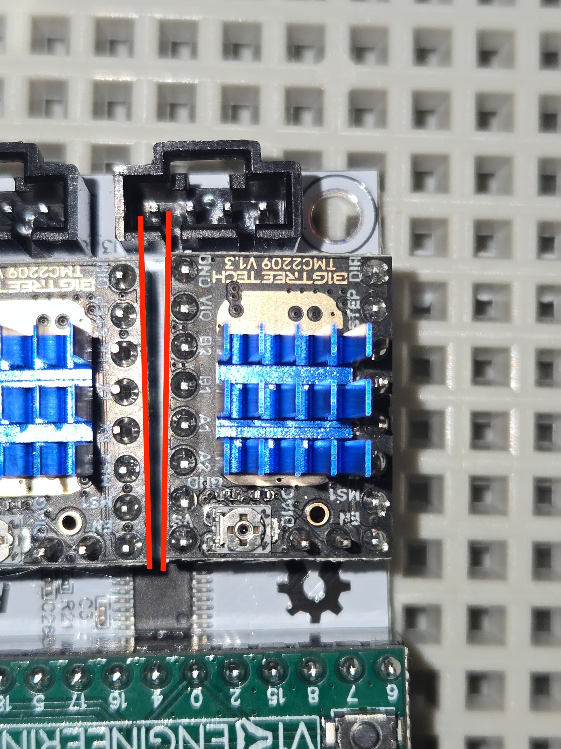

Can we get a better resolution picture of just “A”. Nothing screams bad here, but there is a location that looks mildly out of family.
Can we also get a picture looking at the opposite side showing the pin header for “A” with the stepper motor wire connector not plugged into it (to see the contacts.)

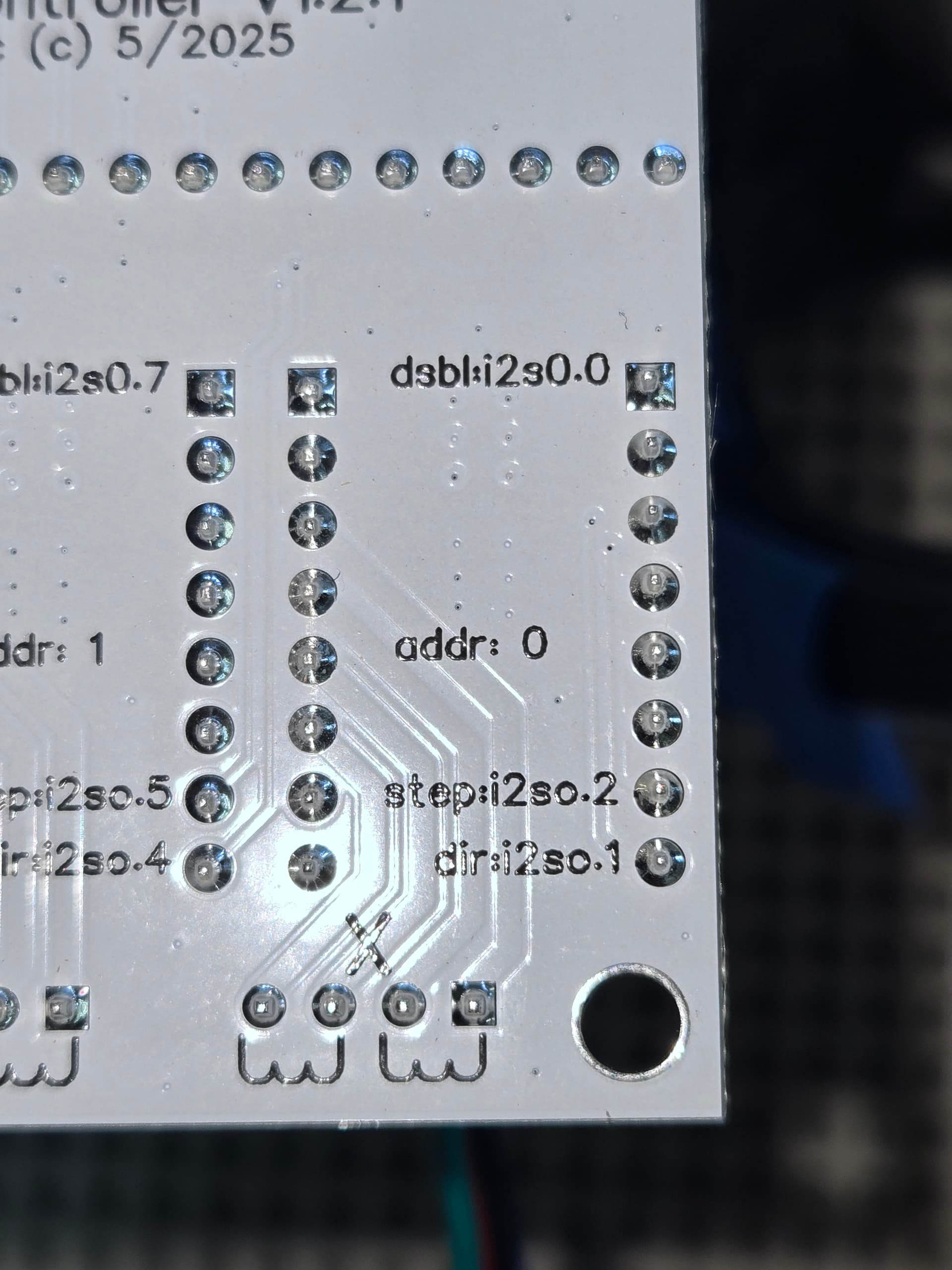

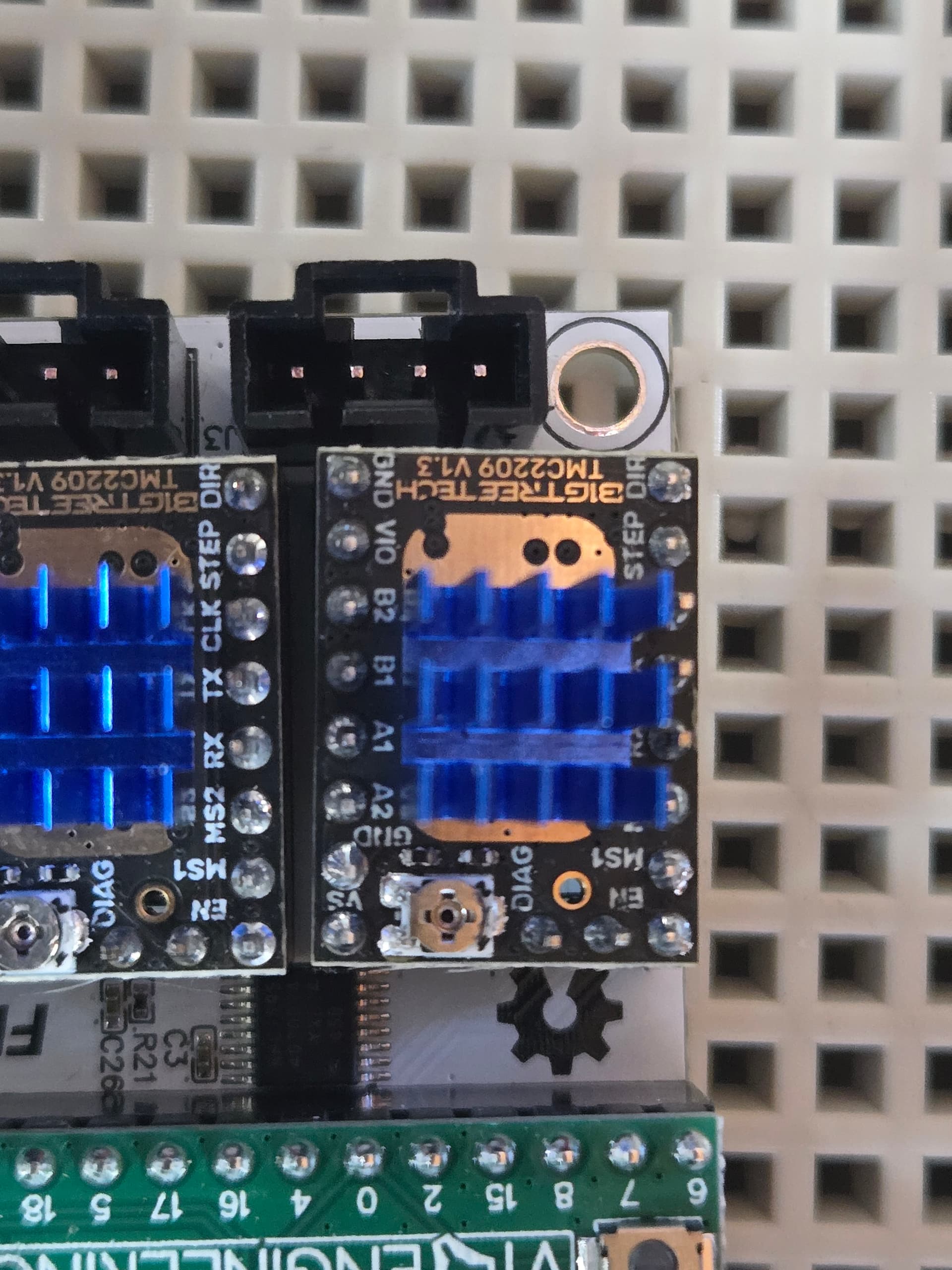

I mean, sure, but it’s actually “X” that isn’t working. I don’t mean the X-axis, I mean channel “X” on the board, the first one, on the corner. This drives motor X0, per the documentation.

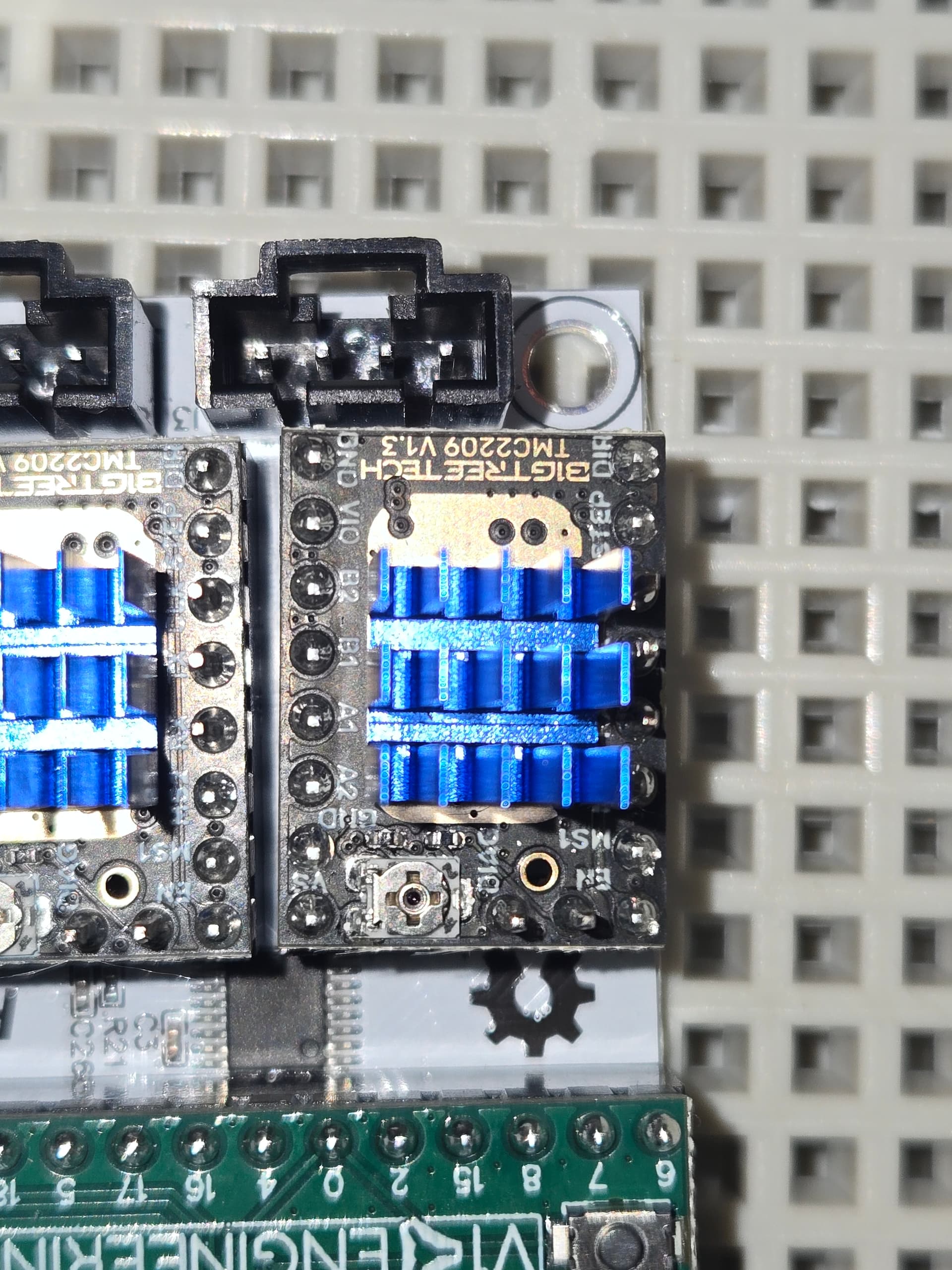

Here are closer images of “X”, with and without flash, along with a topside shot.
If you still want images of “A”, I have those also.

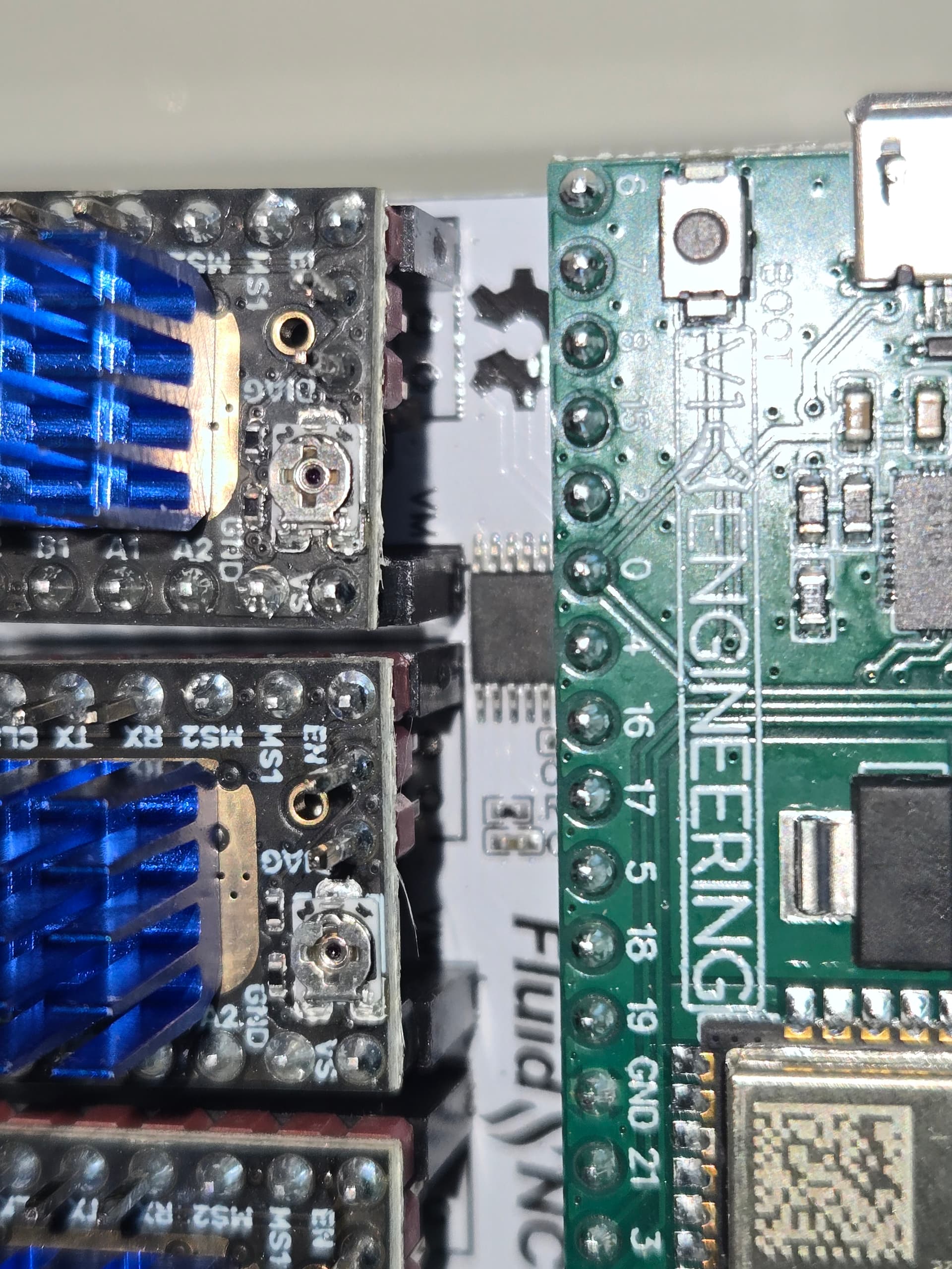

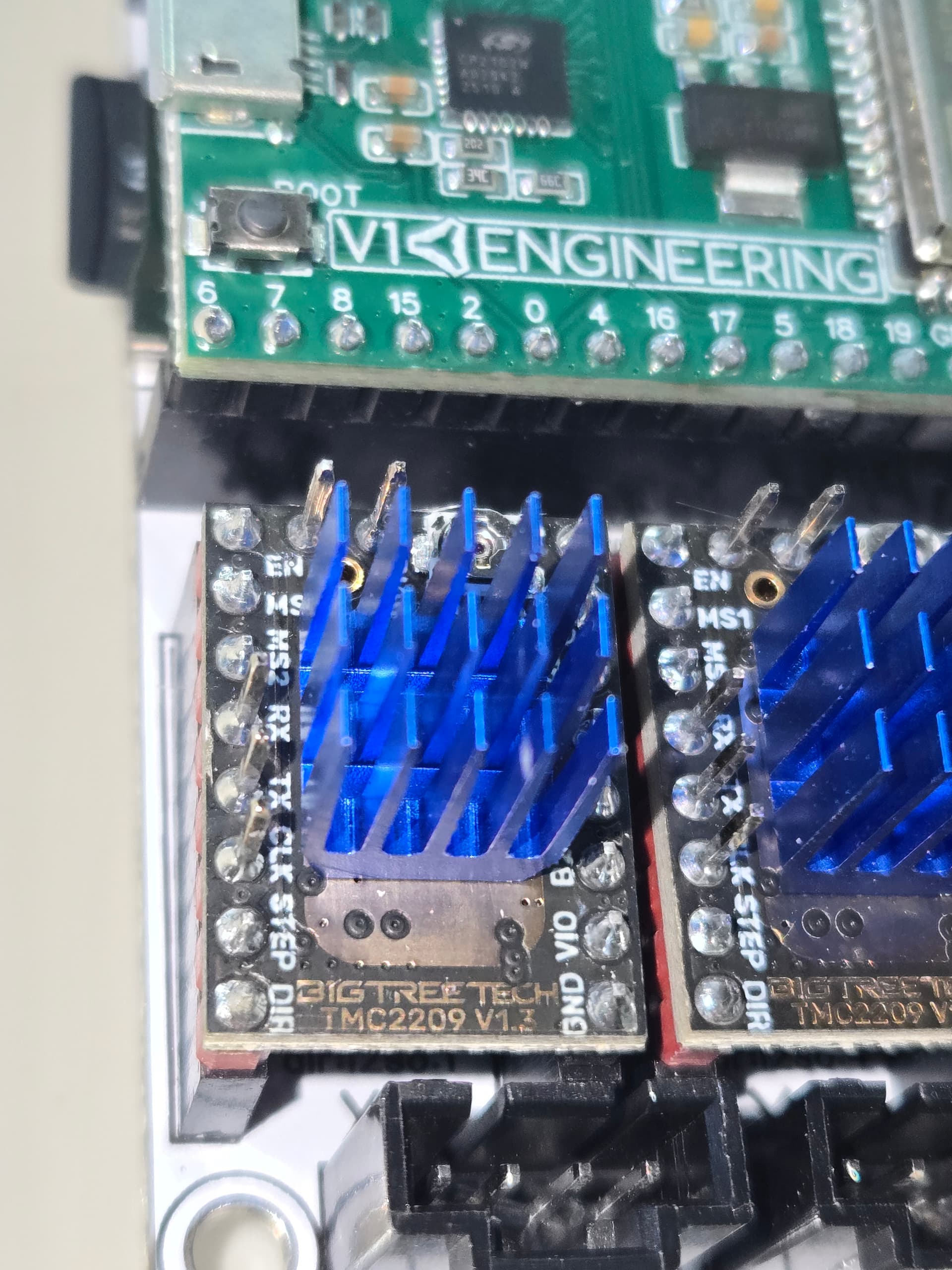

any chance that heatisink is touching the top pins?
I noticed that too. Also, that driver isn’t parallel to the other driver. I looked at mine and they are all parallel. You’ve seen a lot more of them @Ryan .
no, it’s just the angle of the photo.
Yeah, the socket is soldered crooked onto the board. I thought it was a little bit shoddy, but there’s nothing I can do about it.
EDIT: Here are a couple more shots, showing that the heatsink is clear, and how the socket isn’t straight.
I don’t really think that’s necessarily the problem, though. It looks solid, as best as I can see.
Time to build a config.yaml that moves this motor to the last position on the jackpot. Then move the TMC2209 over to the last position.
After the driver is moved, I’d ohm check the copper from the X motor connector back to the pins on the driver header.

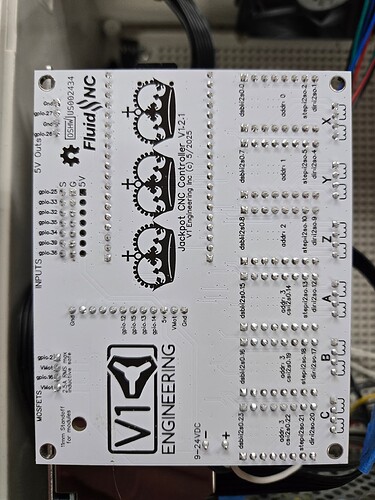

Same as you did for disabling the limit pins. This time you just need to change the three pin addresses as found on the picture you supplied.
For X axis motor 0, change the address from 0 to 3, the step pin from i2so.2 to i2so.21, the dir pin from i2so.1 to i2so.20 and change the cs pin from no_pin to i2so.22.
Quick change. If it works you’ve super-confirmed the problem. What you do about a board exchange after that is up to you, but it should get you running today.

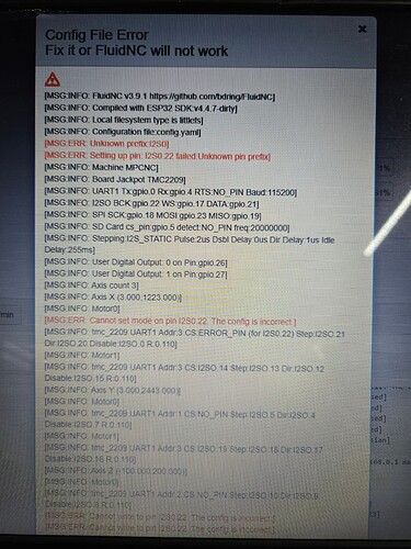

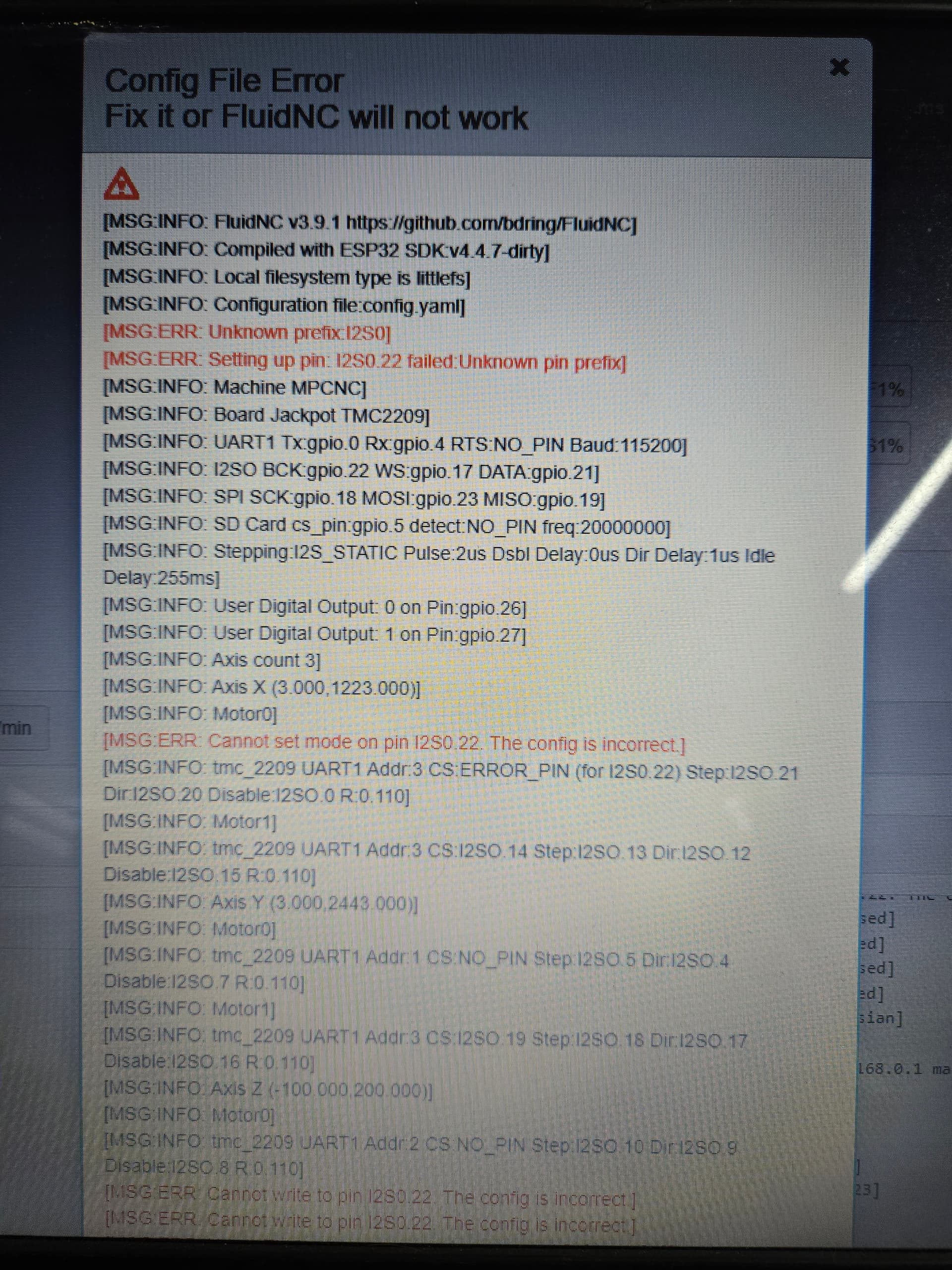

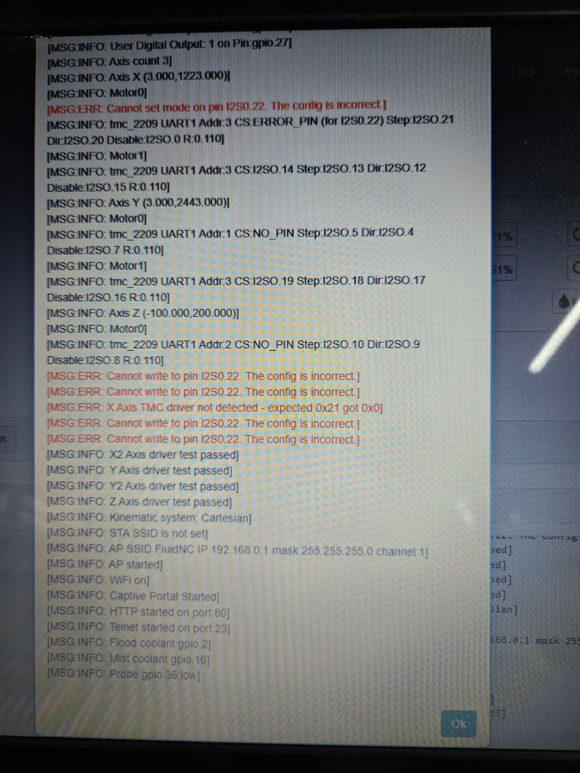

Ok, that was a no go, but I’m not sure what I did wrong…
Can someone check me please and tell me what I missed?

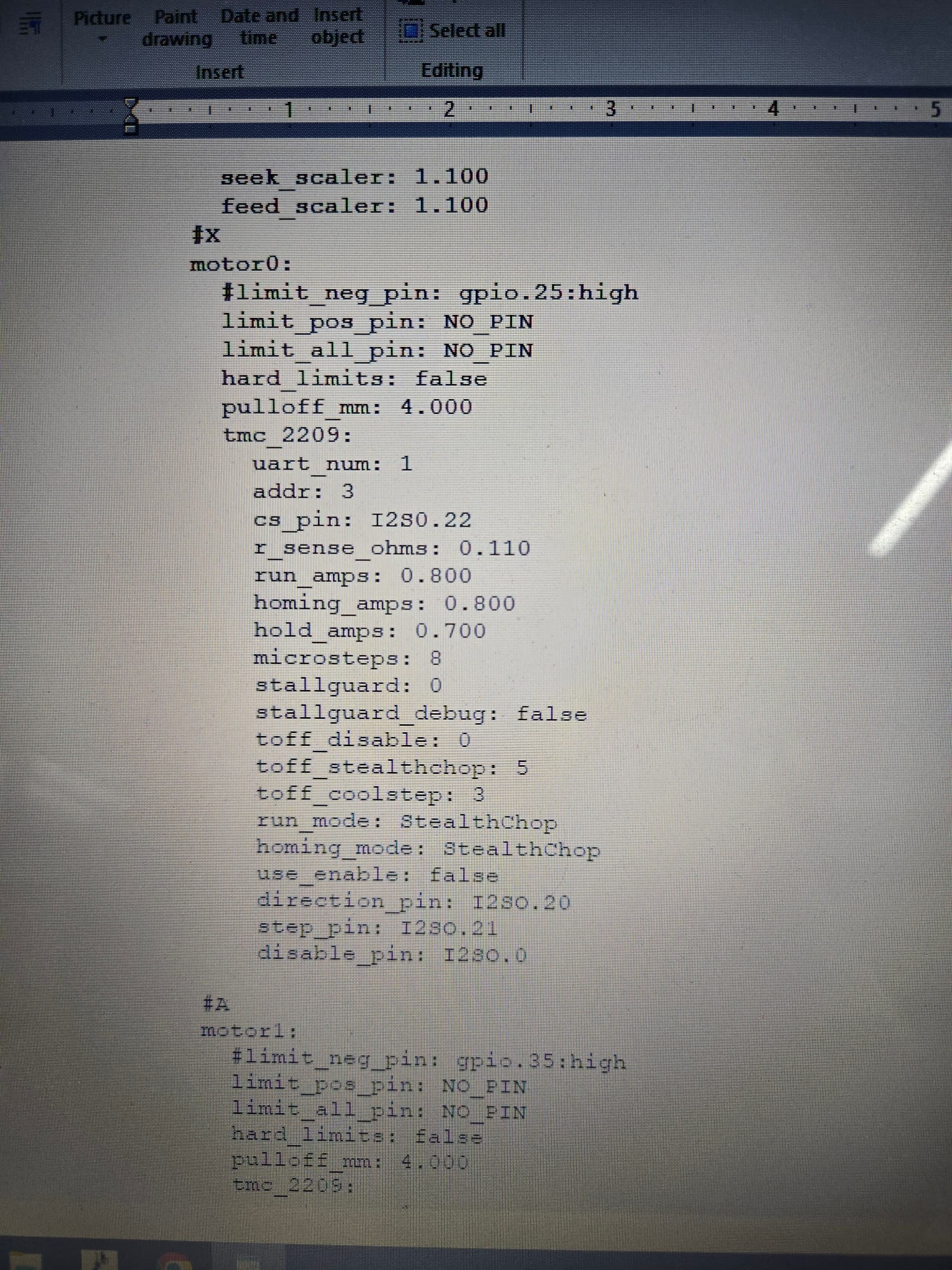

The top image is the portion of the config.yaml that I edited. Nothing else was touched.
Looks like you used a zero instead of a O… which I typed. Sorry. Fixed my initial post.
Sorry, I also missed the disable pin. Change it to I2SO.23.
Also, I am fairly certain WordPad will destroy the formatting and that can cause new issues.
I need to read through this thread to figure out what is going on. Looks like a lot has happened since I last saw a post.
you need to use notepad, or vscode.
Whatever he’s using doesn’t appear to be causing his problem. It read the entire config, and only complained about the 0/O typo. It would be ideal to use something better, like Notepad or VSCode, though.

IT’S ALIVE!!!
With the code edited, and driver swapped to channel C, both motors move as commanded! :smiley:
