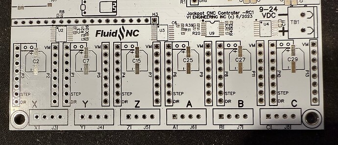

Since that swap doesn’t seem to make any difference, this leads me to believe the issue lies with the commands not being sent to the driver at all.
Next step is to bust out the DMM.
Tie the DMM - lead to jackpot VMOT power -
Use the + lead to compare the step, enable, and direction pins on the TMC2209 position that won’t move with its neighbors. Do this while commanding a large move so you can see what’s happening.
How do I identify those positions? Is there a pinout diagram somewhere?
EDIT: NVM, I think I found one, assuming this uses the standard pin mappings
It is screen printed on the board, but impossible to see with the drivers installed. See if this helps…
Edit… Step and Direction are easy. I’m not sure which one would be enable. Hopefully what you found tells you or @makerjim knows
