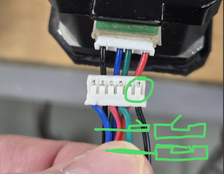

Changing the order of the wires is really easy. Use a pin or exacto blade to pry the plastic tabs up a little and the terminals slide right out.
Then push the tab back down into place. You’ll see the terminals have a little barb on one side that faces towards the tab so when you slide it back in you should feel a positive click.
I think this is the best description I’ve seen of how to do the pin change. The green on the lower right makes it. Very nice!

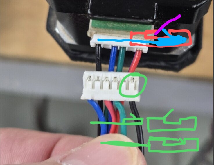

That is an excellent description. But I usually don’t bend the tab back that much. I just slide the tip of a knife in that gap and that lets the barb go past the plastic tab.
Here, the purple knife tip allows the blue barb to go past the red tab.
