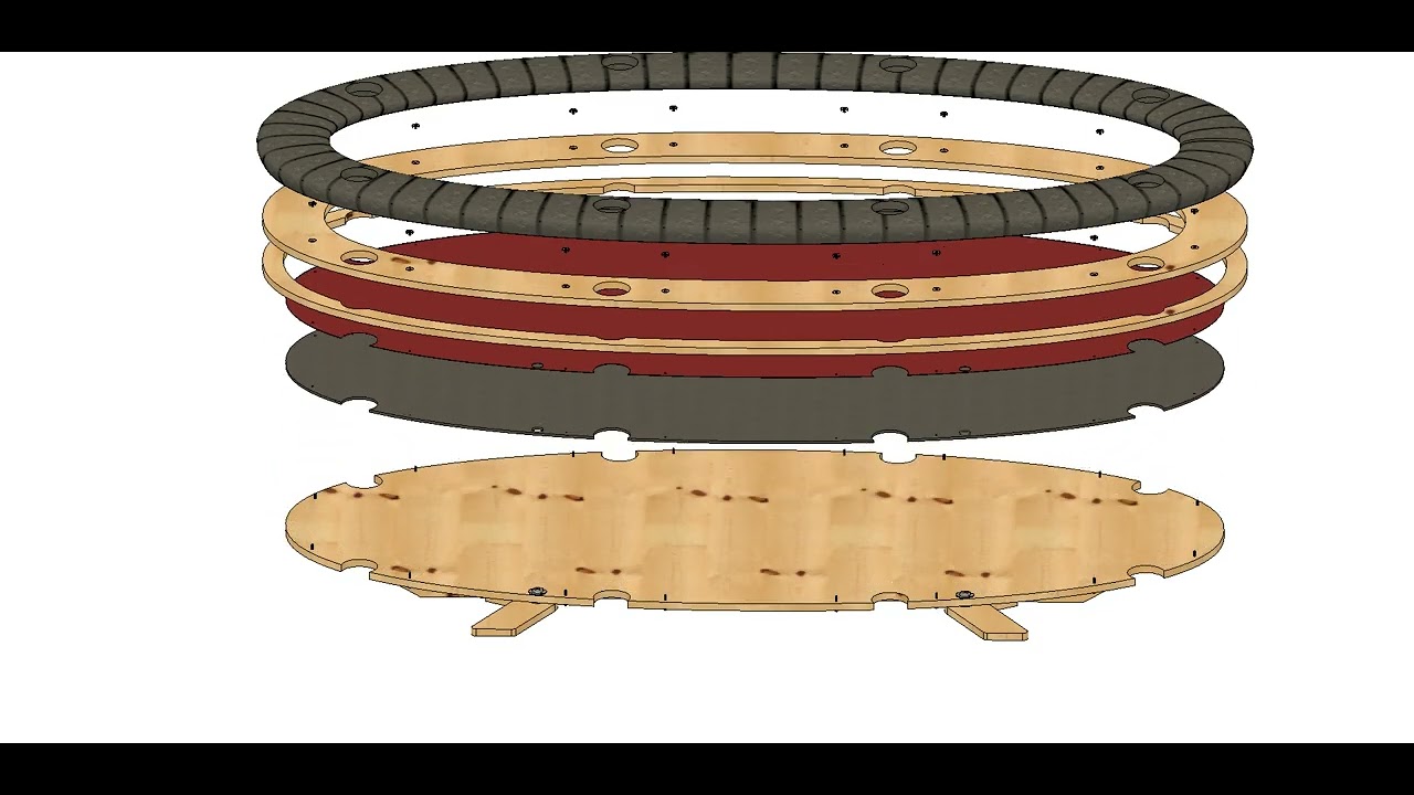

Here’s an example.
In my case, I’m making a custom shaped poker table with a super-ellipsoid shape. I want to be able to change the length, width and shape (n value) of the curve using parameters. I want to also be able to change features like number of cup holders (which affects placement angle), width of the padded rail, height of raised rail, etc. If any parameter changes, it affects a multitude of other dimensions.
The table is made from 2 or 3 sheets of plywood, with holes in each layer that must line up exactly with each other. Then there are minor attachments like bottom layer support gussets and “kickstands” (legs that support the table when it is stored on it’s edge), all of which can change position when other parameters change.
All of this can’t be adequately represented in 2D. I need to create a 3D model that shows all of the components and how they relate to each other. Then I need to change various parameters to determine if there is any overlapping parts and/or other types of conflicts with all of the independent parts.
Then, once everything is confirmed to work together, I select the various parameters for the size and shape of table that I want to cut, and export the individual layers and components as DXF files and use EstlCAM to cut them out.

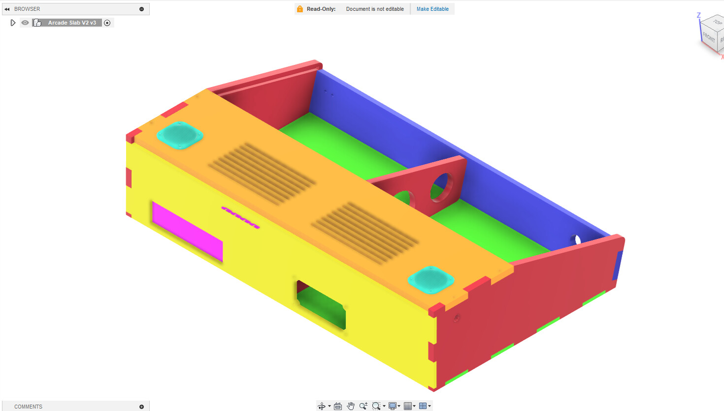

So this is a MAME arcade slab. It hosts a PC motherboard and micro-ATX power supply, a small 12V amplifier and s couple of 3cm speakers. It has a control panel (Not pictured here) that adds 2 player joysticks with 8 buttons each.
If you look, you’ll see some pink bits “sticking out” the back. Those are from the model of the ATX motherboard, and represent the card slots. Since I did not need room for any expansion cards for this project, I did not need to cut the holes for them, so I did not, but I did need/want the opening for the motherboard, and of course mounting holes in the bottom piece for the stand-offs.
The speaker grilles are 3D printed, but mount through the top panel to the speakers below them. The center brace has mounting points for 2.5" and 3.5" hard drives, as I wasn’t sure which I would be using when I started building. (I went with a 3.5")
I went a bit nuts with the colours for this model. I usually don’t but it was to make it really clear how parts were going to be assembled, sand how much clearance I was going to have for controls.
Yes, I could have done it all with 2D drawings for the cutting, and of course every one of those panels has a 2D sketch associated with it, which was exported to a DXF for cutting.

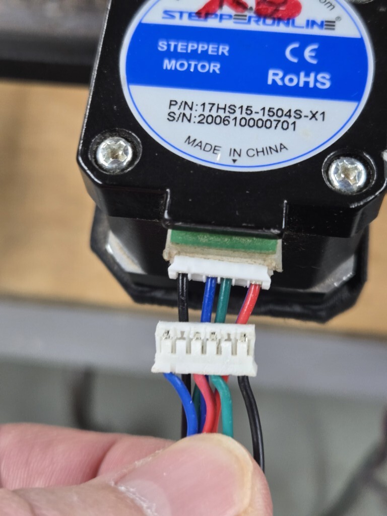

I got in my new extension cables, and ran them this evening.
I fired up the web GUI, and … now nothing works.
My X & Y axes both refuse to travel. They just sort of shiver back and forth, when issued a jog command.
I think the problem may be that these new cables aren’t the same color order as the ones I replaced, although I can’t really see how that would matter. It’s not like the stepper can see the color of the wires. lol
See this image:
The cable plugged into the motor is the new one. The one in my hand is the old one. (I just realized that I’m holding the old plug upside down, but the order is still different)
My first thought was that maybe I had something reversed, and one motor was fighting the other, so I unplugged one driver (X0) from the Jackpot, but that made no difference, so it’s not that.
There’s some other issue.

The setup is now Jackpot → black wires from X1E → new cables from Amazon → stepper motors
“The terrible thing about standards is everyone has their own”
There are multiple ways that motor vendors have wired the connectors on the stepper motors.
You have a cable that was designed for a different termination order than your stepper motors, or for a different pinout at the controller.
Options-
You could re-pin the connectors (release the tabs on the metal contacts, remove, reinsert)
You could order extension cables with the correct pinout.
You might be able to fix it by rewiring the opposite end of the cable (which again means you have to de-pin and re-pin the connector)
What does the opposite end of that extension cable look like?
