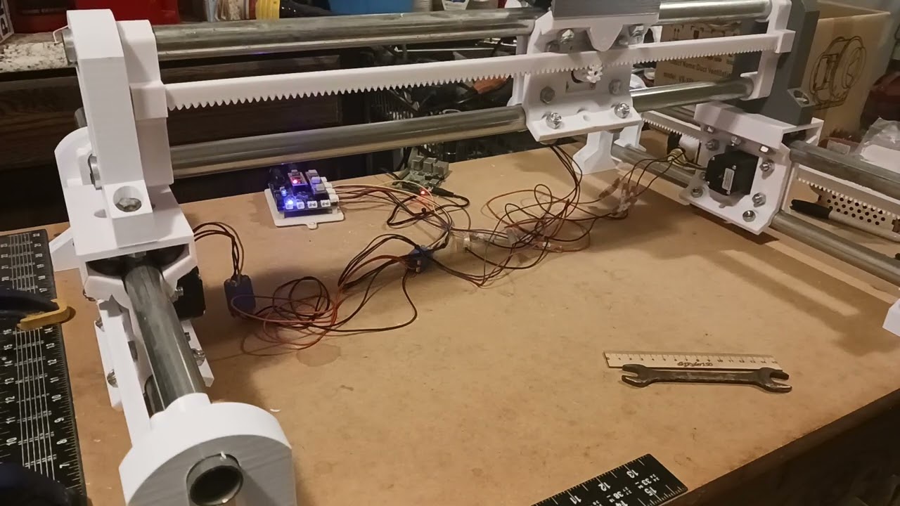

Printed R&P X/Y/Z Platform from MPCNC junkbox

Thanks, guys, for the kind words. I’m doing fit-checks right now and see that I have to design in more allowance for parts that should fit tightly together… ala the light blue stepper “cage” that fits through both the silver carriage/roller halves. I’m having to scrape all the surfaces that must mate… and it ain’t much fun. I’ll have to go back into Onshape and adjust things so that scraping and filing won’t be necessary… :stuck_out_tongue_winking_eye:
OpenBuilds designs and sells modular linear stages that can be stacked together in various ways to get multi-axis motion…
I’ve printed all parts and have assembled and tested the identical linear stages for the X- and Y-axis of MPR&P machine. I’m printing the last gantry support piece to allow for stacking…
I’ve also uploaded the STLs to Printables website should anyone be interested in playing around with it. It’s still a work in progress but any changes to the X- and Y-stages going forward should be relatively minor. The Z-axis is still being worked… :thinking:

Stacked and air-milling a drawing…
I’m now printing some 20-tooth rack segments to expand the Y-axis to better fit the worktable and give a little bigger workarea. Also have an idea for better attaching the Z-axis to the gantry…

As much as I wanted it, I’ve been unable to make the Z-axis “identical” to the other 3 linear stages. I’ve reverted to a reworked Z-stage shown earlier in the thread when I did the pen-plotting…
I’m gonna admit “defeat” on my efforts to make the Z-axis identical to the others. The anti-clamshell roller halves of the other stages just don’t lend themselves to easily interfacing at right angles to the gantry carriage and I’ve already spent twice as much time trying make it fit than I did on the entire X-Y portion of the machine. But the machine is indeed R&P throughout and fully three-axis, so I’m good with that.
I’ll put the required parts for the Z-axis I’ve settled on out on Printables for completeness sake. I did laser-cut the Z-backplate and a couple of shims but it is otherwise completely 3d-printed and built from my MPCNC-centric junkbox. The 1/4" threaded rod for the racks is the only thing I purchased specifically for this project… so less than $20 out of pocket, for sure.

I’ve personally not seen any difference. The rulers I’ve lasered and plotted with this machine seem every bit as accurate as any I’ve ever done with previous belted-driven machines. The calibration procedures I used allowed me to adjust the steps/mm setting in Grbl to get ruler accuracy quite comparable to a commercial steel ruler… and there is a noticeable difference between 152 steps/mm and 152.88 steps/mm with the printed R&P parts on this particular machine.
This and other R&P driven machines I’ve built have never been heavily used enough to determine the effects of wear and tear. And what little I have used them, I’ve never seen any observable decrease in performance. I’ve been encouraged to hear Jim and Jason and Philipp all testify in this thread to seeing machines with printed gears and cams that have been used heavily and are still in good shape. Hopefully, that’ll be the case here.

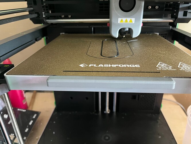

I’ve kicked off prints as I start working a build this weekend.
The 40 tooth rack fits diagonally on the FFCP and clones. One FFCP has a jammed extruder so I’ll work on that.
In the spirit of found materials, the red spools I"m using are left over from the beta program LR4 builds.
The A5M is getting the carriage supports.
