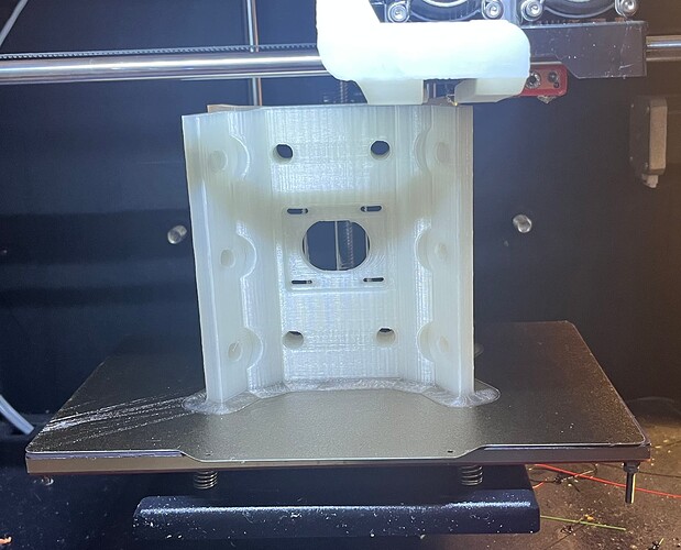

I printed the “clamshell” parts on end… without any support except for some support “vanes” I added manually in the large motor cutout. The bearing bosses are 45 degree chamfered and print fine without support…

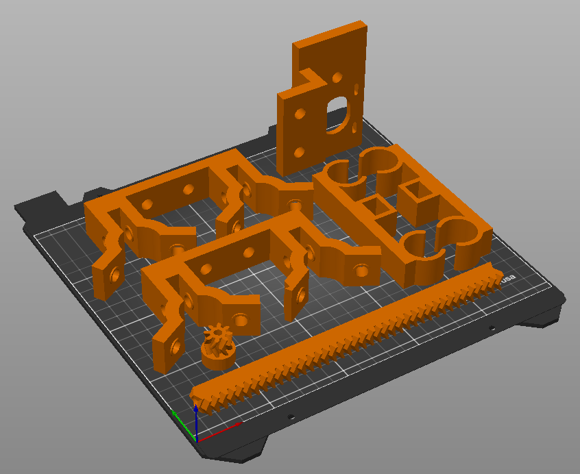

Other screenshots to show how I oriented the parts on the build plate in PrusaSlicer. The many Z-parts on the first screenshot can all be printed without support except the tall Z-motor and bearing mount… for it I used “support from build-plate only”. Also the pressure-bearing “pin” (right-most screenshot) used “support from build-plate only”. Most everything else is printed with no support.

Oh I see that now up thread. Can you export your part with support vanes as a .3mf? Those will go on a printer as soon as I have pushed the carriage supports through the system.
Though maybe with a brim the clamshell parts would be a good candidate to throw on the TAZ. I have some ancient 2.85mm PLA filament (in your signiature white :smile: ) that I’ve been wanting to chew through
Check this out and see if you can use it…
V5-MPR&P-parts.3mf.zip (1.4 MB)

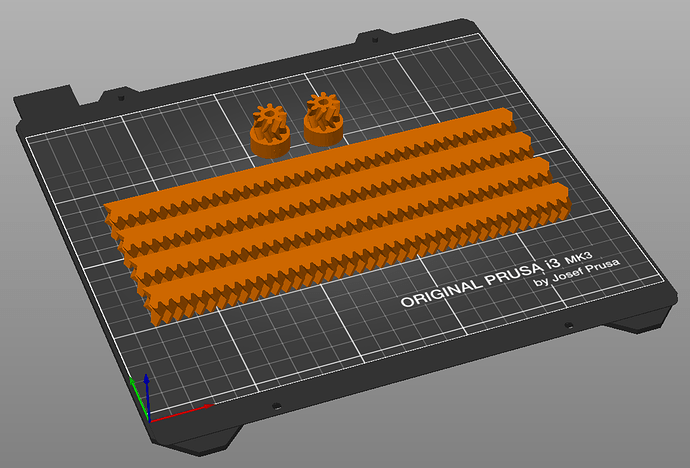

On my Prusa MK3S, I’m limited by the bed size to 40 teeth. On MPR&P, a total of 100 teeth gives a Y-axis linear stage footprint (length) of about 23.5"… and a working length of ~15". For two 40’s and a 20-tooth segment making up the 100 tooth rack on MPR&P… the 1/4" threaded rod through the middle of the rack segments is cut to 21-1/8".

Two of the FFCPs were busy spitting out 40 tooth rack segments. 12 in total, 11 in red and 1 in fuscia. One of them also spit out a plate of motor gears. I realized in looking at the TAZ that those looked suspiciously similar. In fact, I reached into the TAZ parts bin and dug out a partial extruder kit and low and behold: it fits the rack like a glove.

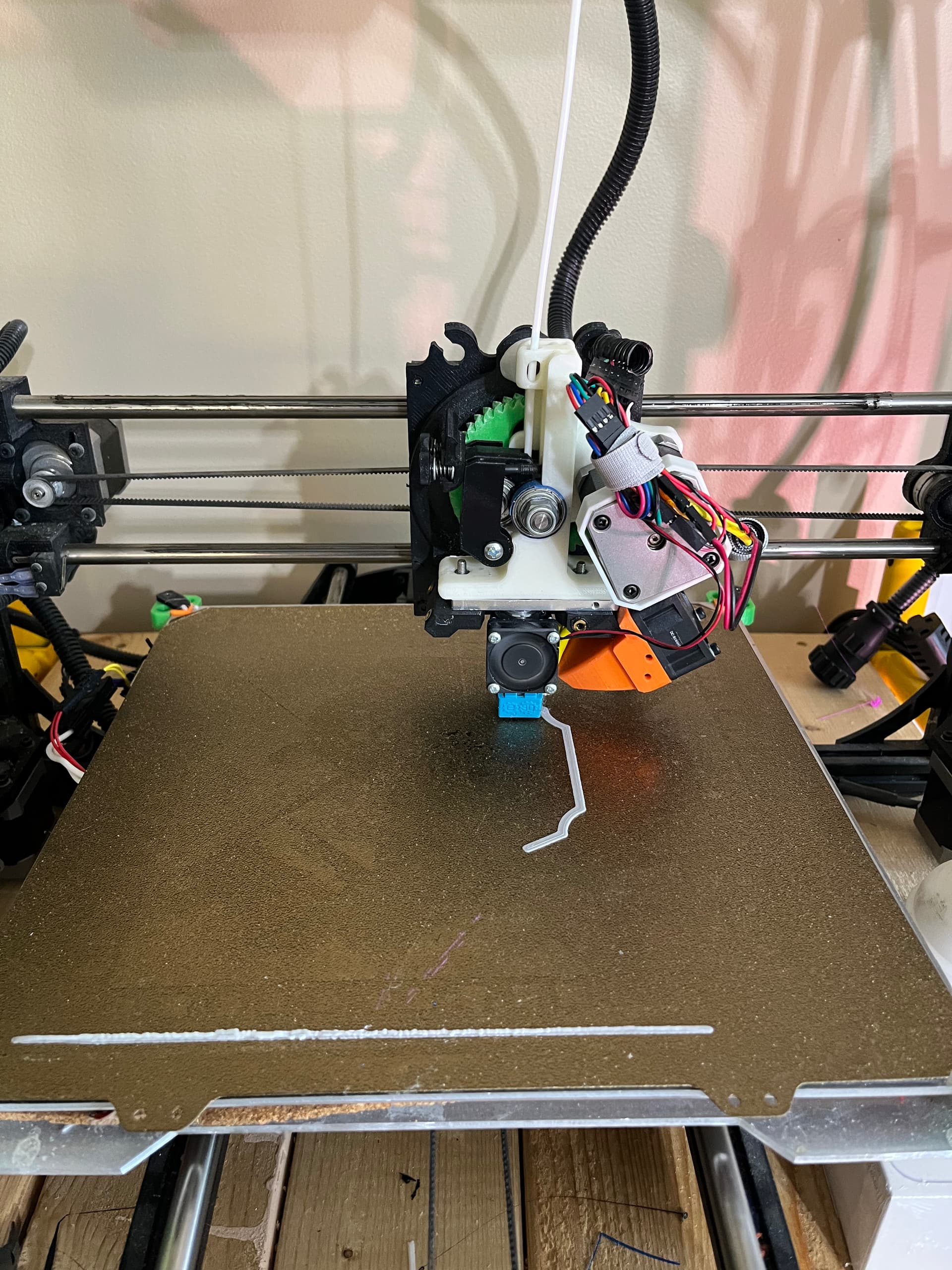

TAZ was chugging along, about 4x as productive as the FFCPs at big parts. But, Octoprint froze mid-job. No idea why. It just froze there. and octoprint log had zero indication why Octoprint blew up.

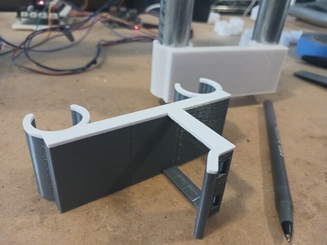

Here are a couple of quick and dirty tool mounts… nothing heavy as they just clip to the bottom of the Z-rails. One is blank, the other for pen. I haven’t actually used the pen holder yet… seems pretty stiff but stylish. :roll_eyes:
STLs and .3mf file…
Z-tool_mounts.zip (201.0 KB)
