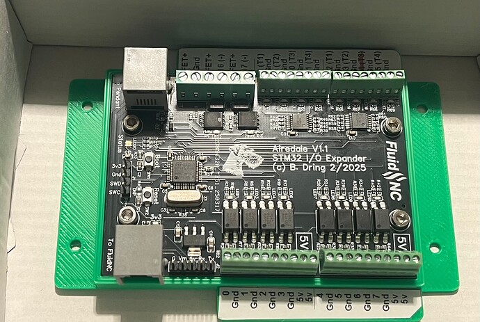

I’m also still thinking of having modular, interchangable controllers. One thing experimental that will go in this build is an…
Airdale.
It is an STM-32 FluidNC UART-based IO expander. What does that do? It lets you attach multiple UART peripherals (Like a FluidDial pendant or a CYD), but also adds multiple additional IO channels to an existing FluidNC system.
This is going to go on one of my spare Jackpot boards for experimentation. A jackpot with one of these could support LOTS of additional IO that isn’t really suited to the existing IO coming off of an ESP-32.
The Airdale has a cousin that should be coming as well, it’s a slightly different breed. If it works like I think it will, it will probably sway my decision about whether or not to use closed loop steppers.

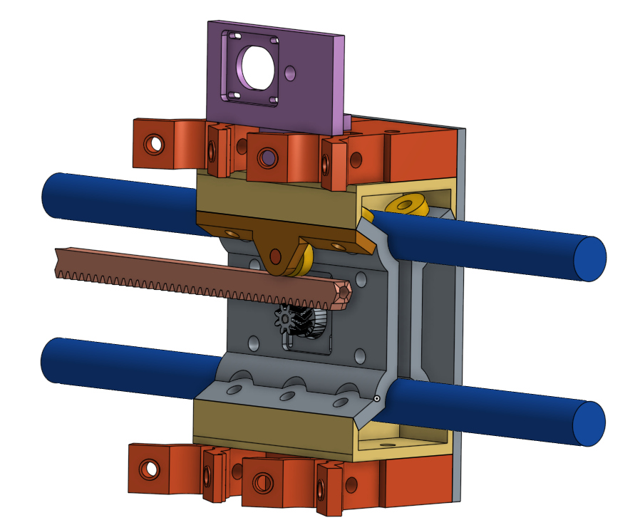

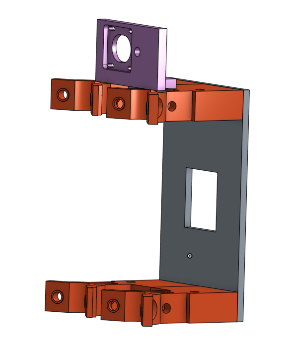

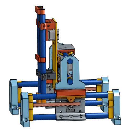

I think I have simplified and improved the Z-axis to make it more rigid by reducing the amount of out-front cantilever. It is more compact and “wraps around” the X-carriage rather than all hanging out front. It removes a couple of parts and modifies a couple of others… a new, smaller, Z-backplate will need to be lasered and the upper and lower roller assemblies are now the same, symmetric, and more beefy. The new Z-axis parts (left) and in place over the X-carriage…
The cantilever has been reduced by 32mm, which should make it a little more rigid… currently (left) and the new on the right.
It should look something like this…
and operate like this…
I’m printing the new parts now. Sadly, it’s a 9-hour print so I probably won’t be able to assemble and fit-check until tomorrow morning.
