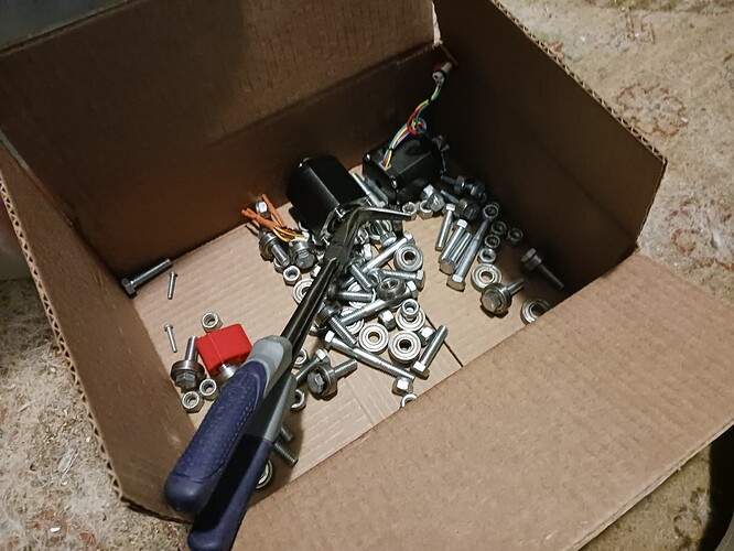

Printed R&P X/Y/Z Platform from MPCNC junkbox
With @jhitesma’s recent reappearance in the forum and his plan to build a LR4 – and reminiscing over past projects – I’m really tempted to attempt another machine build. My initial thought was to build a small-ish LR4 (I’ve never built an actual LowRider :thinking:) but as I continued to ponder the idea, I realized I have enough dismantled MPCNC- and LR-inspired machines/parts stashed away, that I should be able to easily build another complete machine from my junkbox. I also enjoy fumbling around in Onshape and with the success of my previous R&P MPCNC still fondly in mind, I’ve decided that rather than a LR4 (that I don’t need or have room for), I want to give printed R&P another shot on a generic machine design that I can build entirely from my junkbox and at any convenient size… just for the fun of it.
Drawing from my previous X/Y drive for the R&P MPCNC and FoamRipper carriage ideas, I’ve started designing and printing parts for a generic R&P X/Y/Z machine. I’m using Onshape and have some first-SWAG parts in work to start figuring out how to incorporate R&P on the X and Y axis… with Z to come later. So far this is what I envision. You can use your mind’s eye to supply the missing parts :wink:
The printed rack is printed in sections and threaded on a 1/4" threaded rod… and seemed to work well on previous designs.
I’m printing all new parts so progress is slow… but I’m having fun. :grinning:

As I started working on the gantry ends and Y-axis support feet and thinking about how I was going to start mocking this machine up, I realized I might be able to reduce the number of unique parts by reusing as many parts as possible. After fiddling around for a few hours in Onshape I was able to make every axis end support similar, with the conduit and rack ends all captured the same way. That necessitated ditching the tractor configuration of the R&P MPCNC and using a stretched MPCNC-conventional tractor, altered to incorporate a near-identical motor and R&P relationship as in the gantry carriage.
As most of the prints take a few hours, in addition to the Onshape activity I’ve also started gathering up tools and rummaging around in my junkbox. I found an old MPCNC 525(?) core and a couple of tractors which yielded a lot of 5/16"(8mm) bolts and 608 skate bearings. I also found another big box of bolts and bearings that must have resulted from all the machine dismantlement I did prior to my moves to San Antonio and then back to my home here in East Texas.
After I had printed enough parts I started prototyping the gantry carriage assembly…
and stuck a 40-tooth rack section into relative position for a photo.
As I built only a couple of R&P machines prior and gave one away to Jamie, my junkbox is apparently lacking 1/4" threaded rod for the segmented rack so I will probably have to break down and buy a few 3’ lengths from Lowes. I’ve got tons more parts printing to do and I’ll start cleaning off a work table to assemble the machine on. Unfortunately I also ran out of my “signature white” Sunlu PLA+ filament so I put a couple of rolls on order from Amazon… and the prototype machine is gonna be an ugly gray. :roll_eyes:
