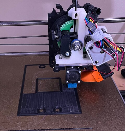

I’m still printing some red endcaps, and I kicked off a print on the Taz a bit ago:
We’ll see how the back plate works when printed. I made a mod to help it out a little bit.
After the back plate prints, I’ll fire off a pen holder mount.

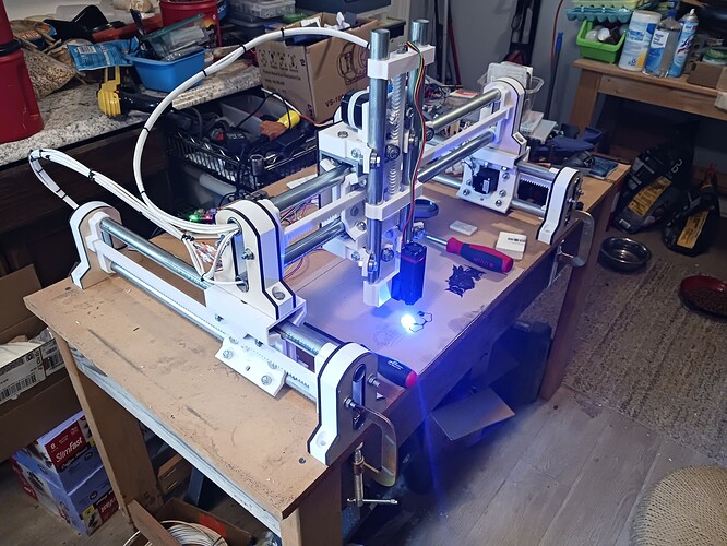

Printed a laser mount and checked it out…

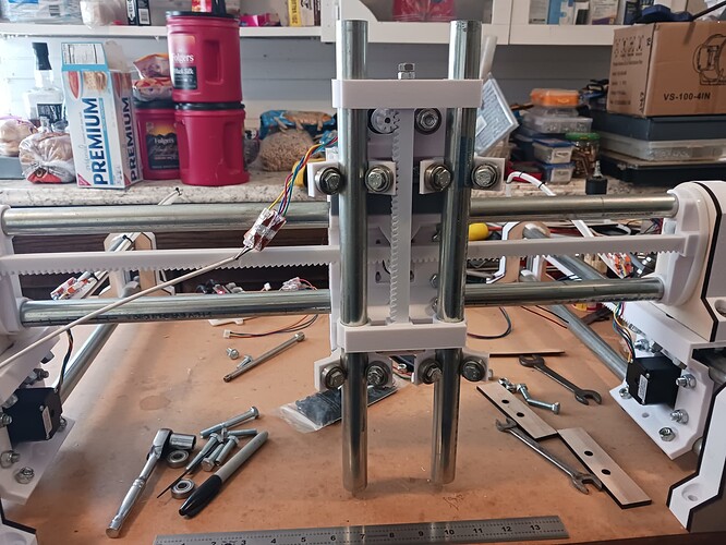

Friday I did some more mockup assembly. I’ve had a bit of difficulty making parts fit as the bolts I’m using are all spare from LR4 beta builds, and they’re not really sized correctly for this.
Below you can see some of the mockup, this deliberately with the bolt in the upper left the wrong way round to explore clearance. This was still very crudely assembled, but it made clear that the spacing is really tight in this spot. It appears to get this to work, the carriage needs to be assembled before the rack is installed and end caps put on. On my machine, when more fully assembled, there’s an bit of interference between the bolt head and the rack when the carriage is at either extent of travel of the axis.
I’m going to go find some button head hardware in the right lengths to continue assembly this weekend.
I eventually got far enough along in mocking things up to have a sense for how to assemble tihs.
One question I have is about the pressure pins in the bearing that rides on the rack. All of the pins I printed snapped, which means the orientatioun I printed them is just wrong, but further I’m not sure why that bearing isn’t just retained with a button head screw from the inside.
I’ll be fiddling with that a bit more as I go this weekend.

Yep… they’ll snap if printed on end. I printed them lying down with “support from bed only” so that the “grain” of the plastic runs the length of the pin. I printed a bunch of pins separately with support and have plenty of spares…
Clean-up of the pins wasn’t difficult at all… I use a sharp straight blade knife to scrape any support cruft off the pins… fit on the bearing from the little end up to the “knob” and then tap/press the pin and bearing into the mount. The slot in the pin is unnecessary (initially the pin and mount were one piece) and I didn’t have button-head screws to test fit. The plastic pin should be fine for a slow-moving pressure bearing and the clean backside/outside of the bearing assembly when installed retains the flat outside surface of the whole carriage assembly.
Tiny bit of clearance needed for pressure bearing…
All the junkbox bolts for my MPR&P are 5/16" (8mm) hex from Lowes and Bolt Depot(?) online… of various lengths, but mostly shorter (< 1-1/2"). Each carriage has 4 bearings between the carriage halves, 4 each on top and bottom flanges of carriage, and one pressure bearing… for a total of 13 bearings.

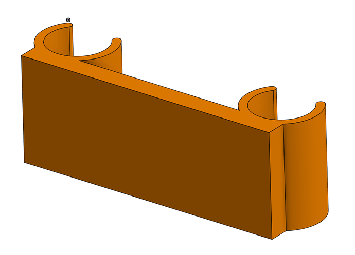

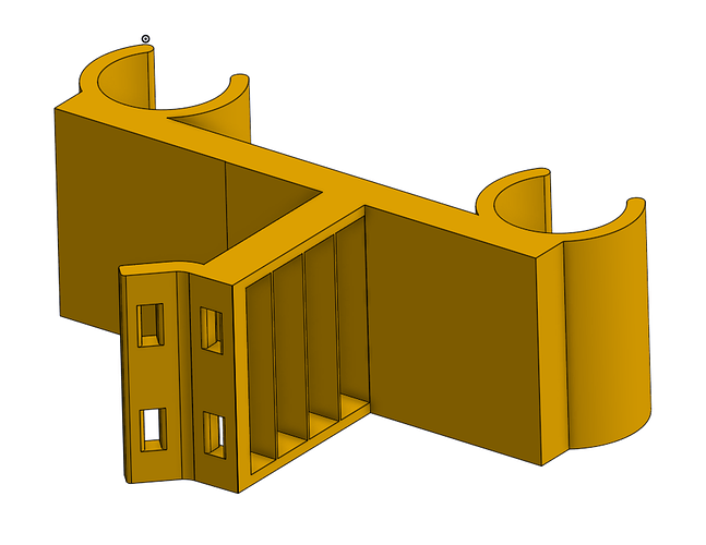

An assortment of tool mounts… blank, Neje laser, pen, and 775 motor mount.
In reality, I suppose these should completely surround the conduit in a clamp configuration… similar to the 775 motor mount. But for very light loads the snap-clamp seems sufficient and convenient.

I’ve debated mounts that use a wrap around clamp and am still noodling on that. This looks completely fine for pen/laser/drag knife use. I start to wonder with the 775 mounts whether it needs better retention.
Machine motion is great, very solid machine. I am going to add fender washers to the 1/4-20 rod clamp points, then will tighten them all up “for flight” :slight_smile:
Pen holder is ready to go. iPhone refuses to take a good picture of this filament while in the printer under its’ LEDs.
If things go really well maybe it’ll be moving in the next day or two.

No doubt the wrap-around clamp is the proper way to go. I just like the convenience of the snap-clamp while doing the development… and since it is sufficient for the light-duty stuff I do, I’ll keep using it. I’m gonna depend on “youse guys” to harden it and make it a real product… :wink:

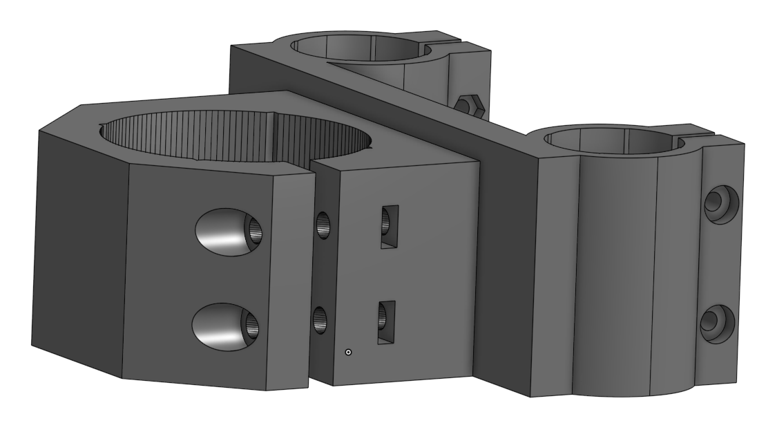

I knew you had a CNC3018 machine or similar, so you have a 775 “spindle” setup for it. So do I, so I figured why not make a tool mount for it? I remembered seeing somewhere a printed tool mount STL for that machine, so it’d be simple to find it, download it, and merge it with my blank tool mount. If this machine was ever destined to have a “spindle”, I figure this is it! That spindle mount also has notches inside the clamp area to hold IIRC a small 30mm x 30mm laser module… and I once used it exactly that way.

I haven’t printed this yet but if you want to try it, let me know how it goes…
775-motor_mount.zip (249.8 KB)
I’m going to put that on a printer in a couple of minutes!
Thank you for the kind words, Philipp!
Does that need a counterbore so the screw head can be flat against it? Or is there one that I can’t see.
Uh-oh! That’s the part I liftedstole… borrowed from this TV model (thanks, @kochmax!). I didn’t inspect it closely and trusted that it was okay; i.e. I just wanted the motor surround-clamp part to merge with my tool mount. I’ve got it in Onshape so will do what I can with it. Sorry 'bout that…

Looks like M4 dimensions on those holes… so added 8mm diameter counterbore.
I should have checked that… and made the same sized holes for the conduit clamps. Instead it’s M4 hardware for the motor-body clamp and M3 for the conduit clamps.
That’s what I get for not actually printing and fit-checking before posting parts. I’m gonna need to print one now…
