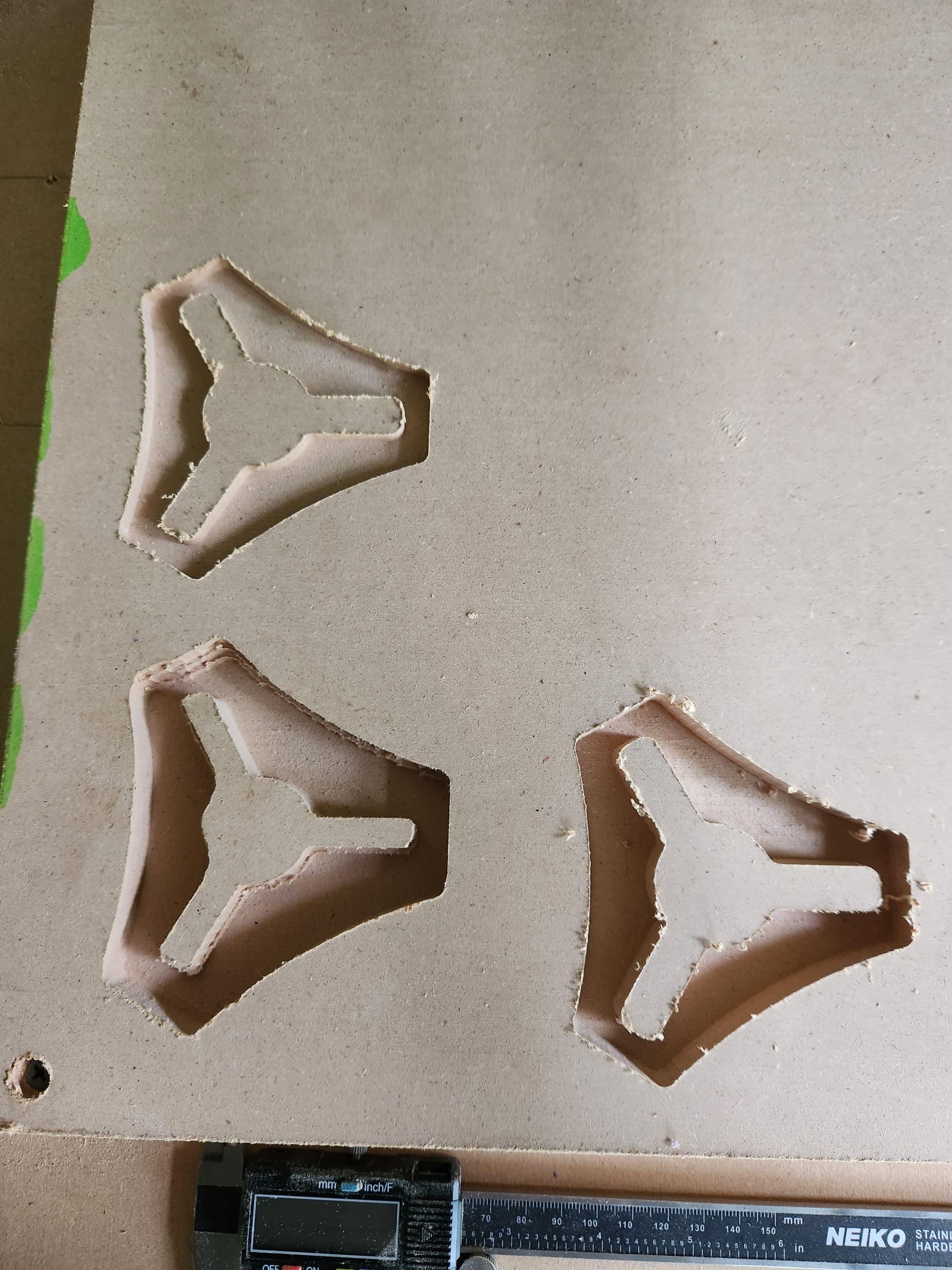

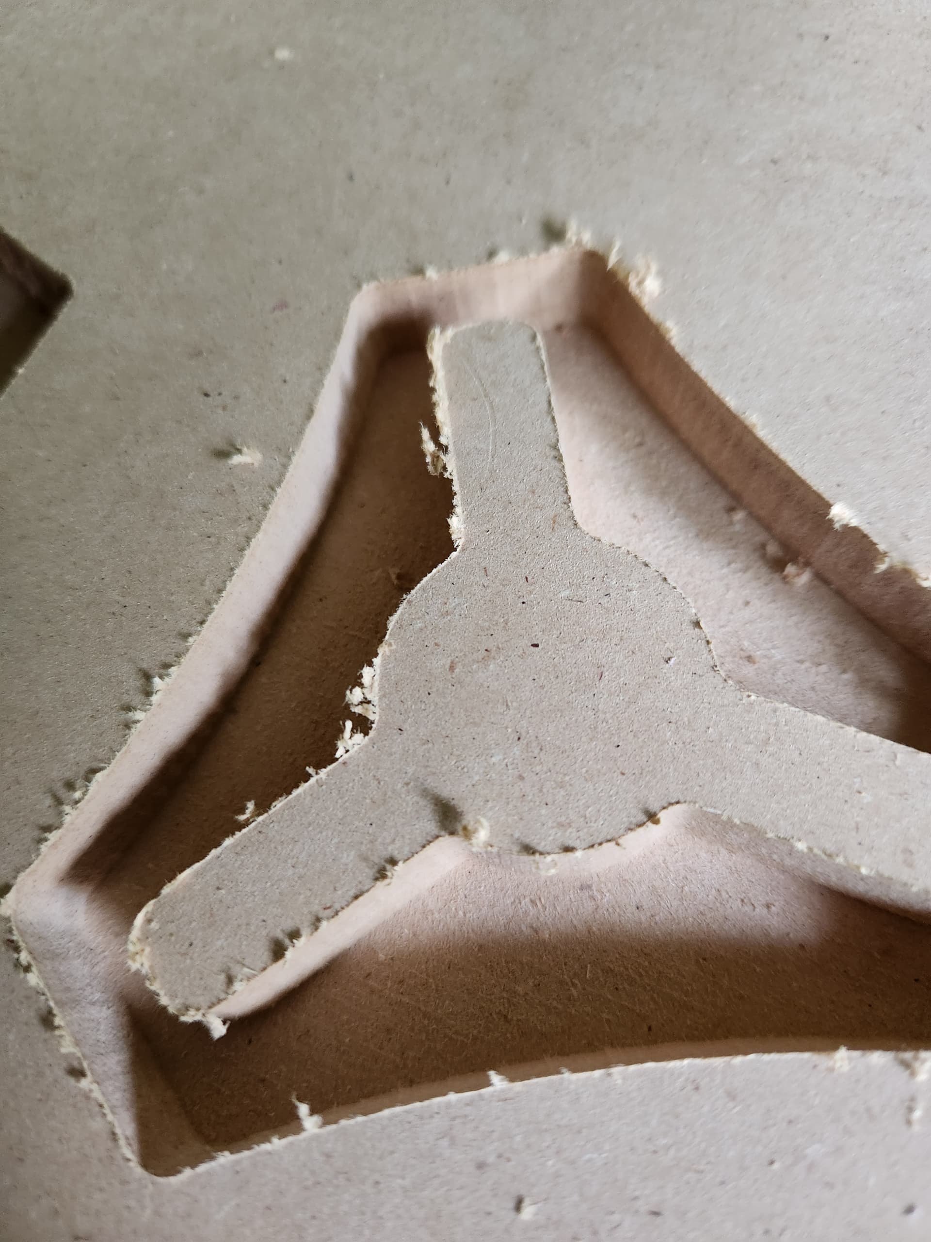

First cut is pretty ugly (bottom left). I had just run @jamiek square and ruler tools with a pen and it looked great. So I tightened the belts a little and upped the current to 1A. I noticed when I was putting the router in there was a little play. I used advice from another thread. The core clamp was tight, but the bearing was not touching. I loosened the other bearings, ended up removing them and reaming out the holes because they were pretty tight. Reassembled trying to use the slop to force the non-clamp bearings to engage. The bearing still freely rotates, but the slop is gone.
Second cut(upper left in first image), skipped steps on z after second pass. Turns out the roter was rotated a bit and interfering with the core, but the XY looks really good.
Third cut, success! Well, at least much better. Dimensions were slightly low, 98.6, 99.2, 99.4. Depth was spot on 12.02. Happy to finally be cutting something besides air and foam.

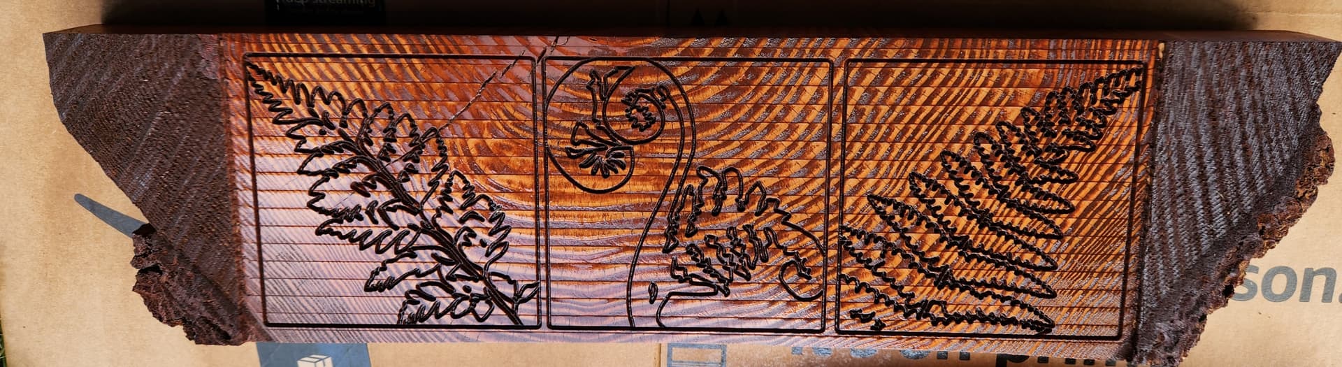

Nice work! What’s the first project on the drawing board?
Here is my first real project. I was pleasently surprised how dark the stain made the carving.
Great idea, looks really nice. You might want to check the tramming though, you can clearly see the ridges the endmill left (or was it on purpose as a design element?).
Yes, definitely need to look at tramming, but I did not mind the effect on this design.
It is a cool look with the dark carving. :sunglasses:
