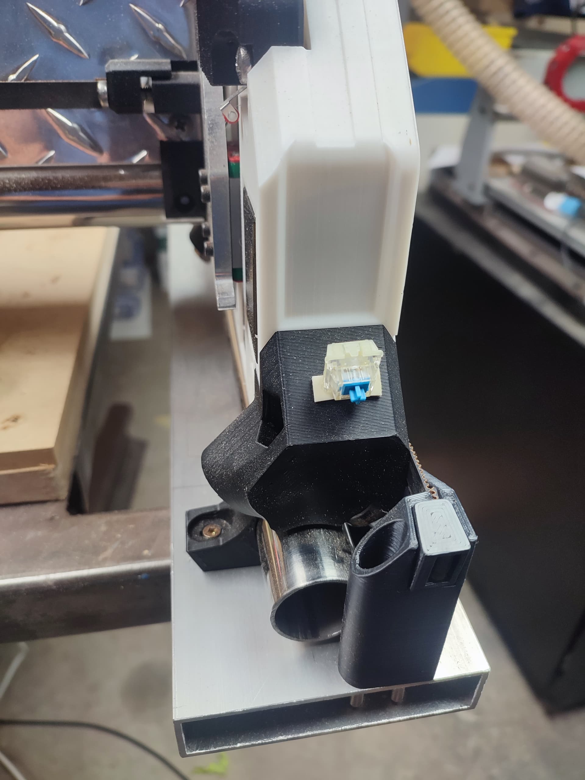

remix using cherry mx switch anybody ? :wink:

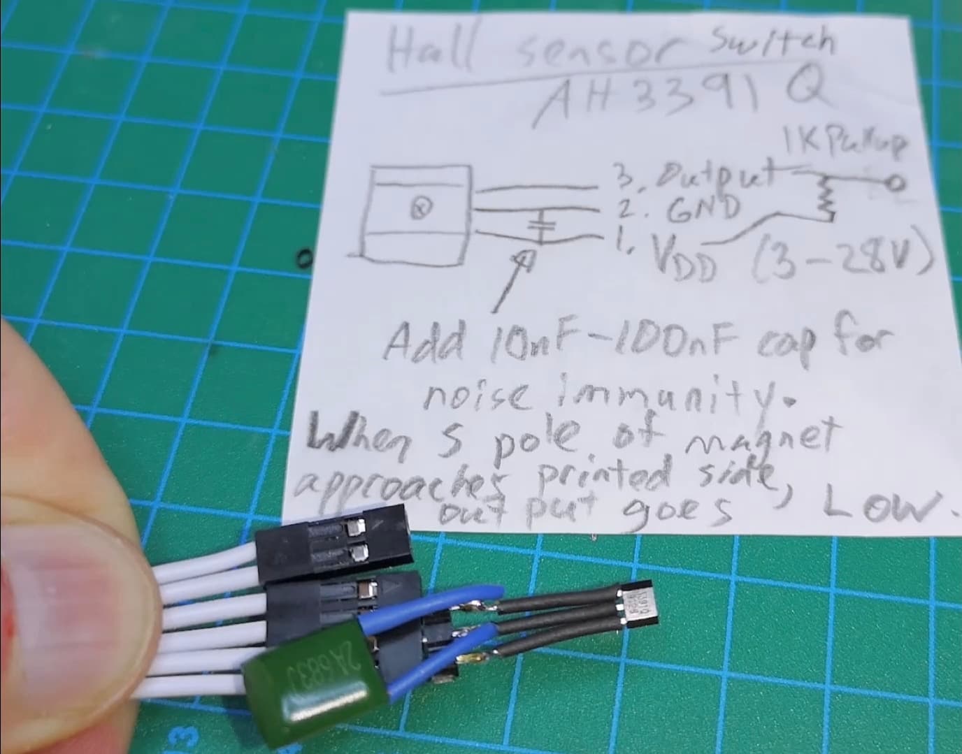

As mentioned in other posts, I use Hall switches, which are COMPLETELY trouble-free. These go low when a magnet’s South pole comes near. No debounce needed, no levers to break off or catch on things. Repeatability i measured: 15 microns. I pull them up to 5V with 1k, and add a 100nF cap as recommended. They are less than a dollar each. AH3391Q-P-B HALL EFFECT SWITCH, UNIPOLAR, SIP-3, 60 cents each at Farnell.

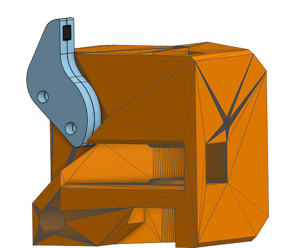

Anyway I drew up some mounts for SIP-3 hall effect sensors for the y axis, I expect they’d need a 5 minute tweak to use on Z or X. Here’s the onshape document for anyone interested. It’s also a decent example document of making an assembly with existing components then making a part studio in context of the assembly. hall effect sensor mount
Way to go, David! Much nicer than my “blob of glue” approach.
I don’t understand why anyone still uses mechanical switches. They break and wear out, get dust or water in them, need debouncing code, and can too easily be triggered by accident. Hall switches are what the auto industry uses. In case you didn’t watch it yet, here is the part of my MPCNC video about Hall switches. I note that these are not to be confused with Hall sensors, which are analog.

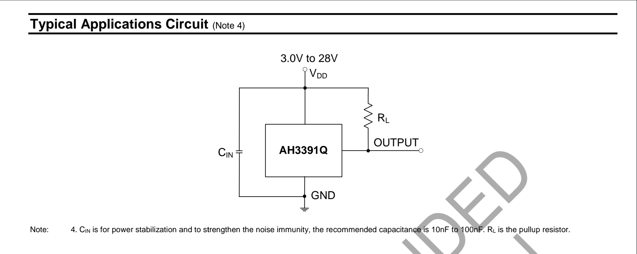

Looking at the schematic, it seems one of the outside leads is for the “voltage,” i.e. power input, while the other outside lead is the “output” i.e. signal — but this raises another question: is that based on having the flat side with lettering on it facing up or down? Sorry to be so naive on this thing.

Here’s an image from the datasheet. You can picture poking the 3 prongs into the ground and looking down at the part. The taper points to where the sensor is. So you want the taper pointing to the south side of your magnet.
Blockquote 1. do I connect to the two outside leads/wires, isolating the center lead/wire?
Ground should have a capacitor between it and your voltage, and output should have a resistor between it and the voltage.
Blockquote 1. does it matter which lead/wire gets attached to what? Or do I have to be careful, treating the thing like a “one way only” type device?
Yes you can think of it as a one way device. Output and ground cannot be swapped. The device needs the relationship between vdd and gnd established for the switch to work properly and allow output to be pulled down.
