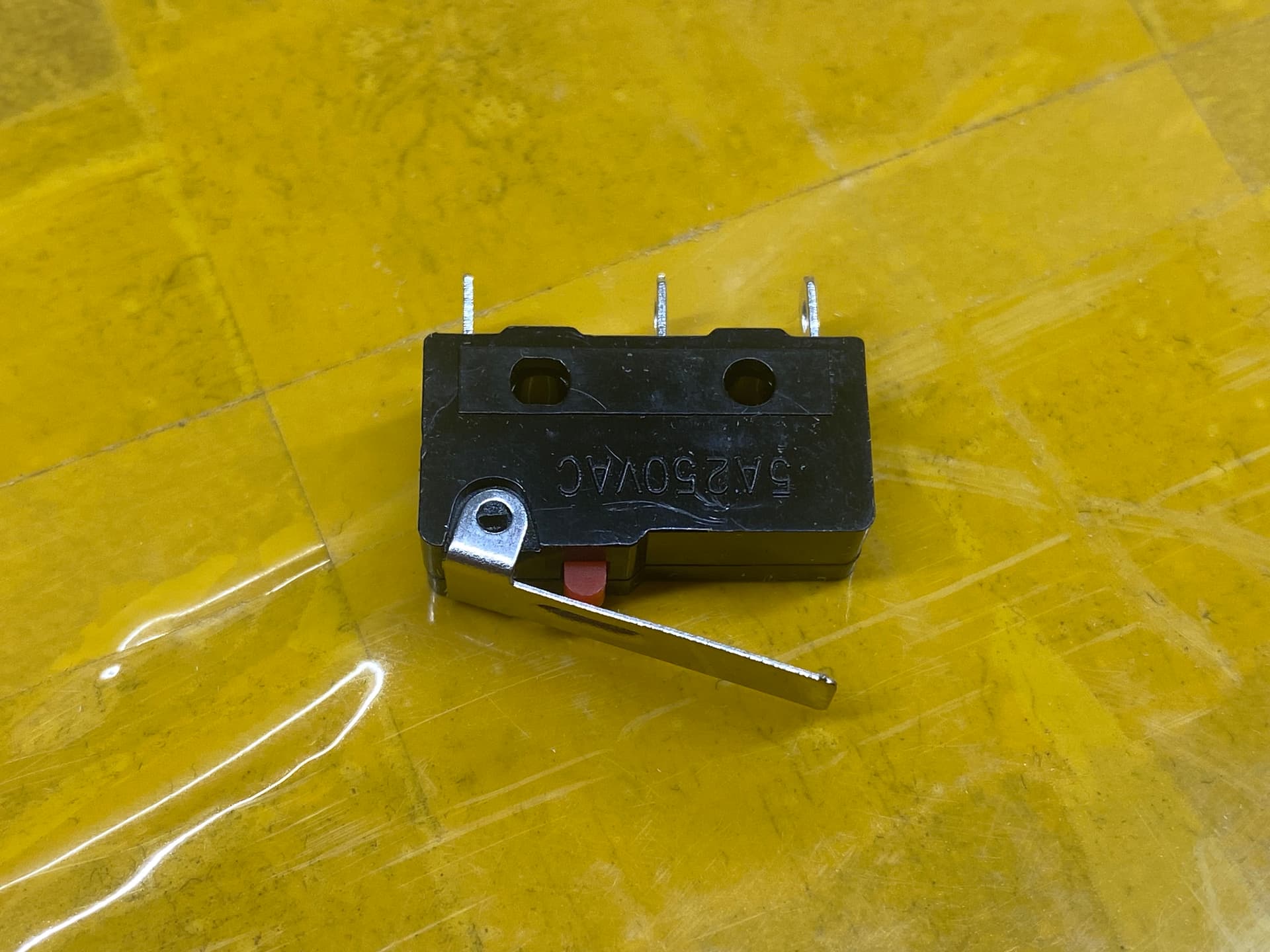

I just desoldered and replaced the original one that was missing the blade. I had some other switches that are similar, but slightly different:
Instead of the blade getting pinched to mount from within, this one clamps to the outside, and its blade is straight, lacking that little “hook” bend at the end.
From a standpoint of repairability, I’m thrilled with how easy it was to: detach the belts, flip the gantry, unscrew the old switch, de-solder and re-solder wires, reattach the new switch, de-flip gantry, reattach belts. One key for me in making this repair so quickly was that I was able to pull a little spare wiring though the side assembly, and push it back in when done.
The only fly in the ointment so to speak, is the new switch’s blade is not the same, so technically I should do the re-check for square headache. But I’m under a time crunch on an Etsy order and I’m just skipping that for now!

Well, I just now tried to home with that different switch / straight blade and it did not trigger. Too short! I will now try bending it out some.

I got it homed (got the new switch to trigger). Because I am using superstrut and custom “table extenders” related to that, my endstop / belt tensioners are a remix. I was able to do a real quick tweak to the end stop to get it closer to the LR4 side, and I’m back in business.

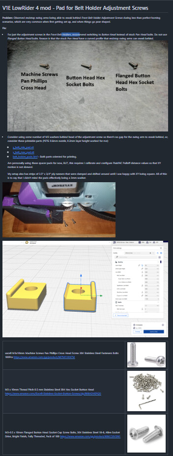

Made/shared some small pads that help, but they’re still fallible. .STLs and details at https://github.com/aaronse/v1engineering-mods/tree/main/lowrider4/mods/belt-holder-pad:
